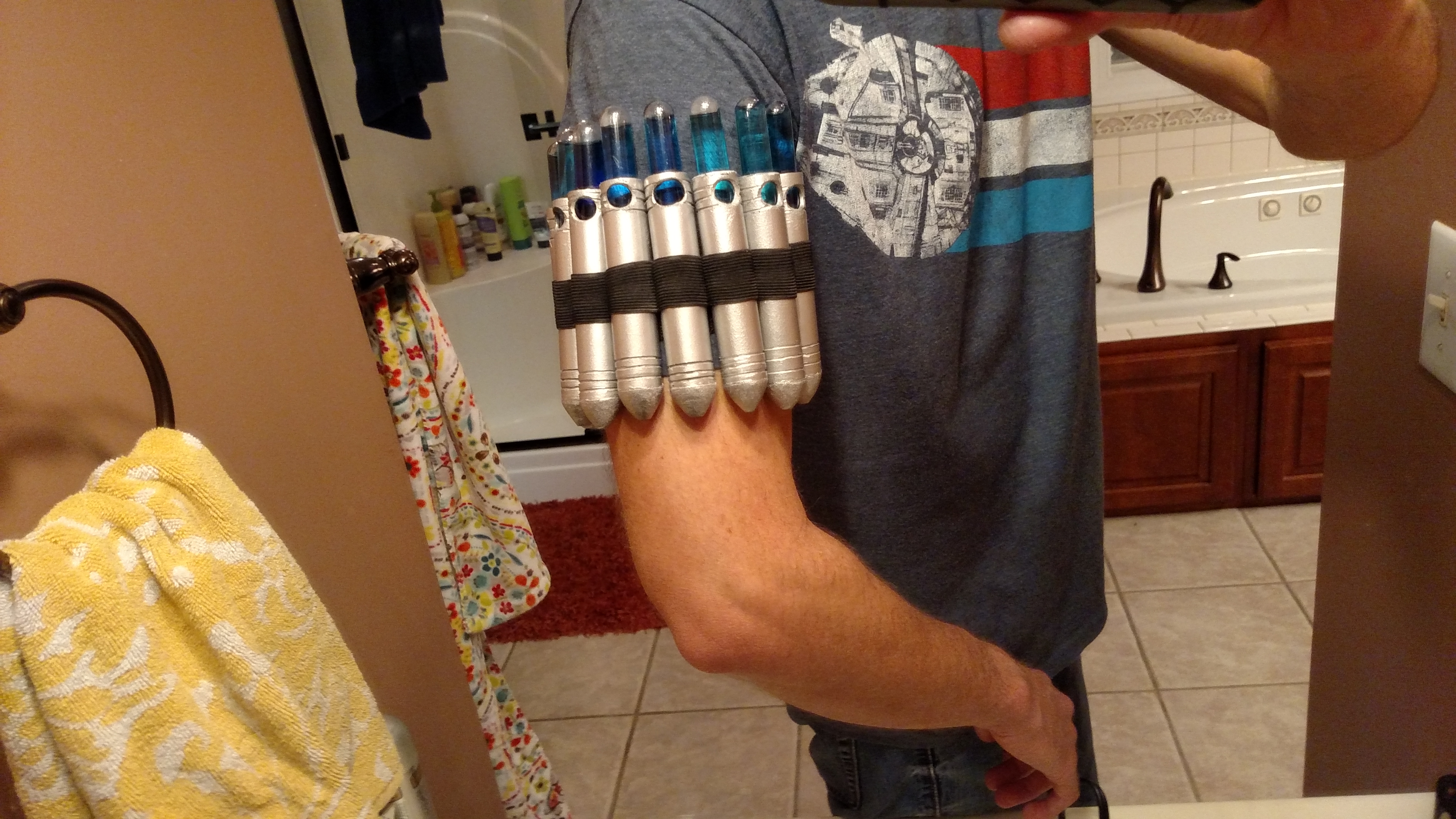

for the armband I used 2 inch webbing, 1 inch elastic and 2 inch elastic on the ends with Velcro to attach them.
blue food coloring in cheap plastic test tubes from amazon
plasti dipped and painted silver metailic.

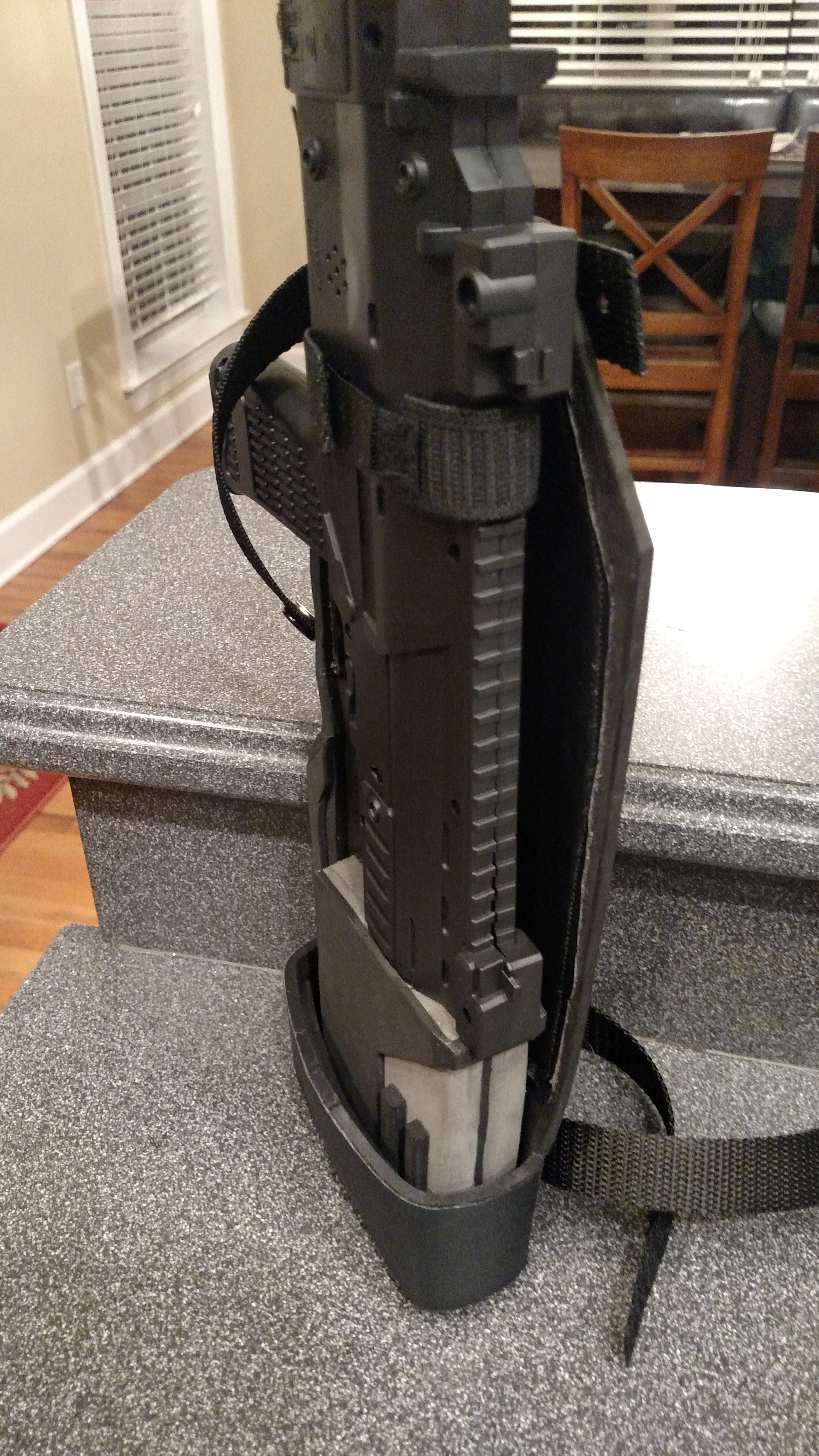

I made a piece that snaps on the outside of the top piece and the inside of the lower backpiece.
it wraps around the sheath and velcros.it in place. I put the back side of a snap at the bottom with a elastic the comes through to secure it.

sheath holder open and unsappped and closed and unsnapped
closed and snapped in place

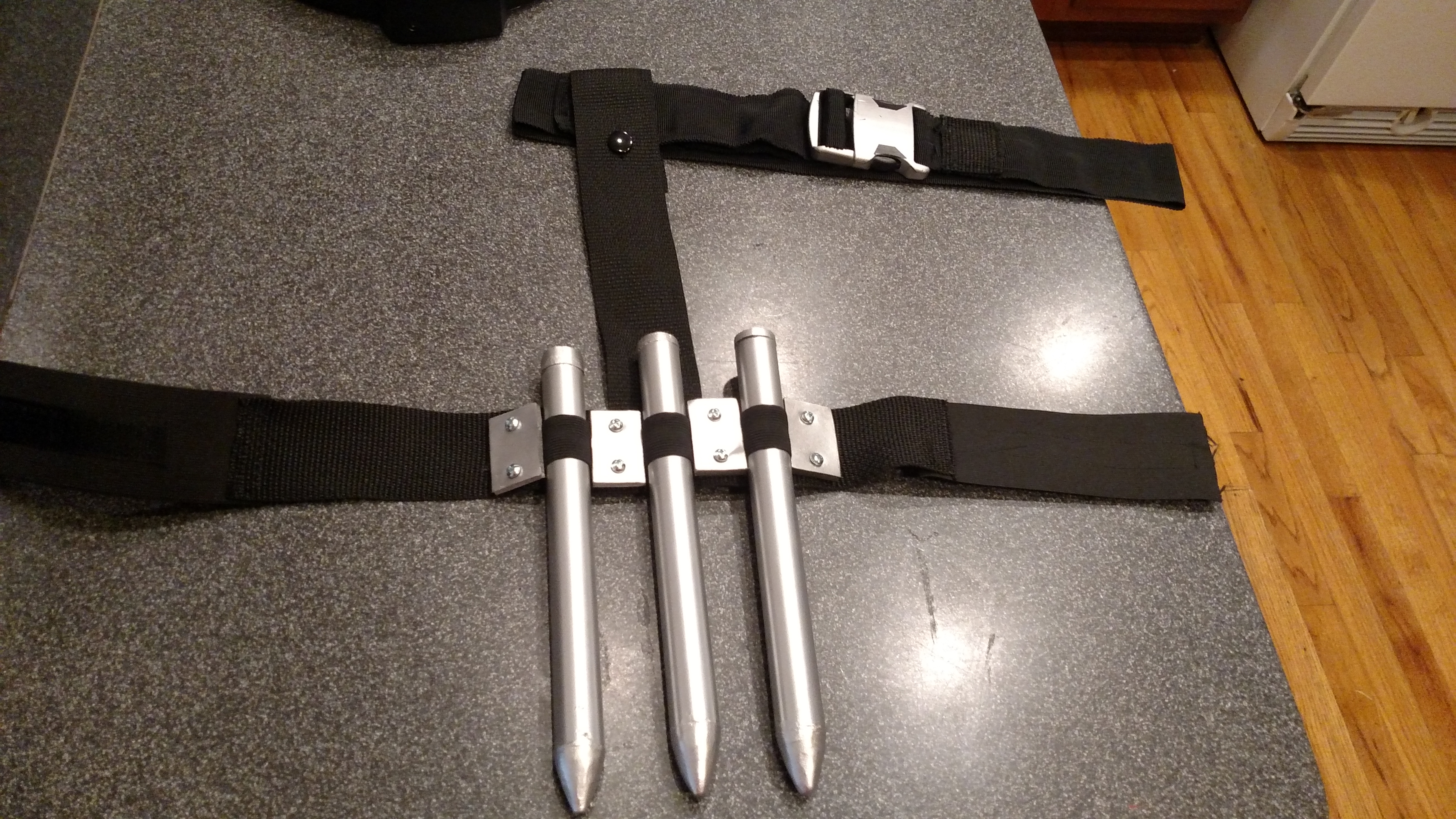

finished the leg spikes and holder

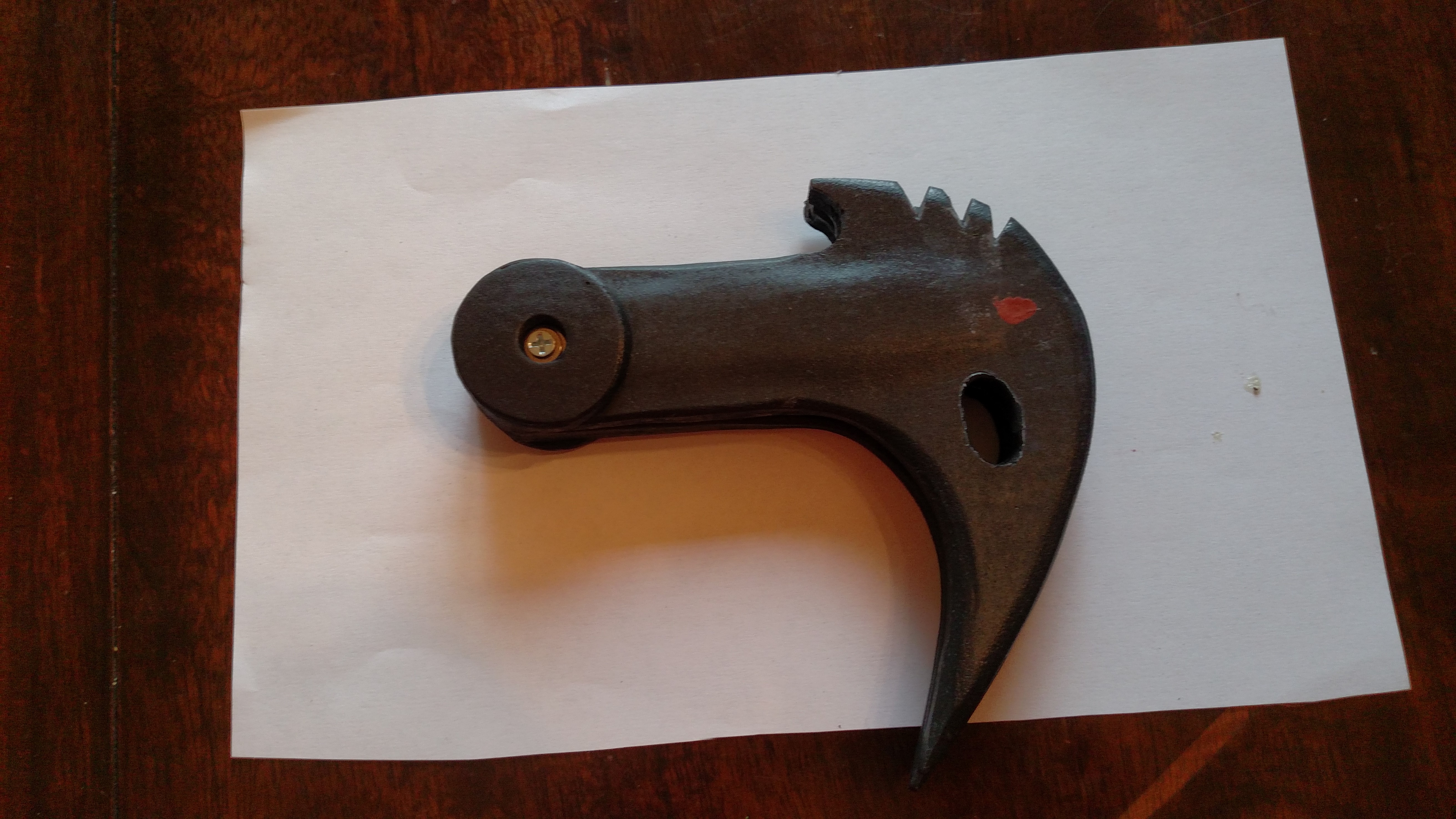

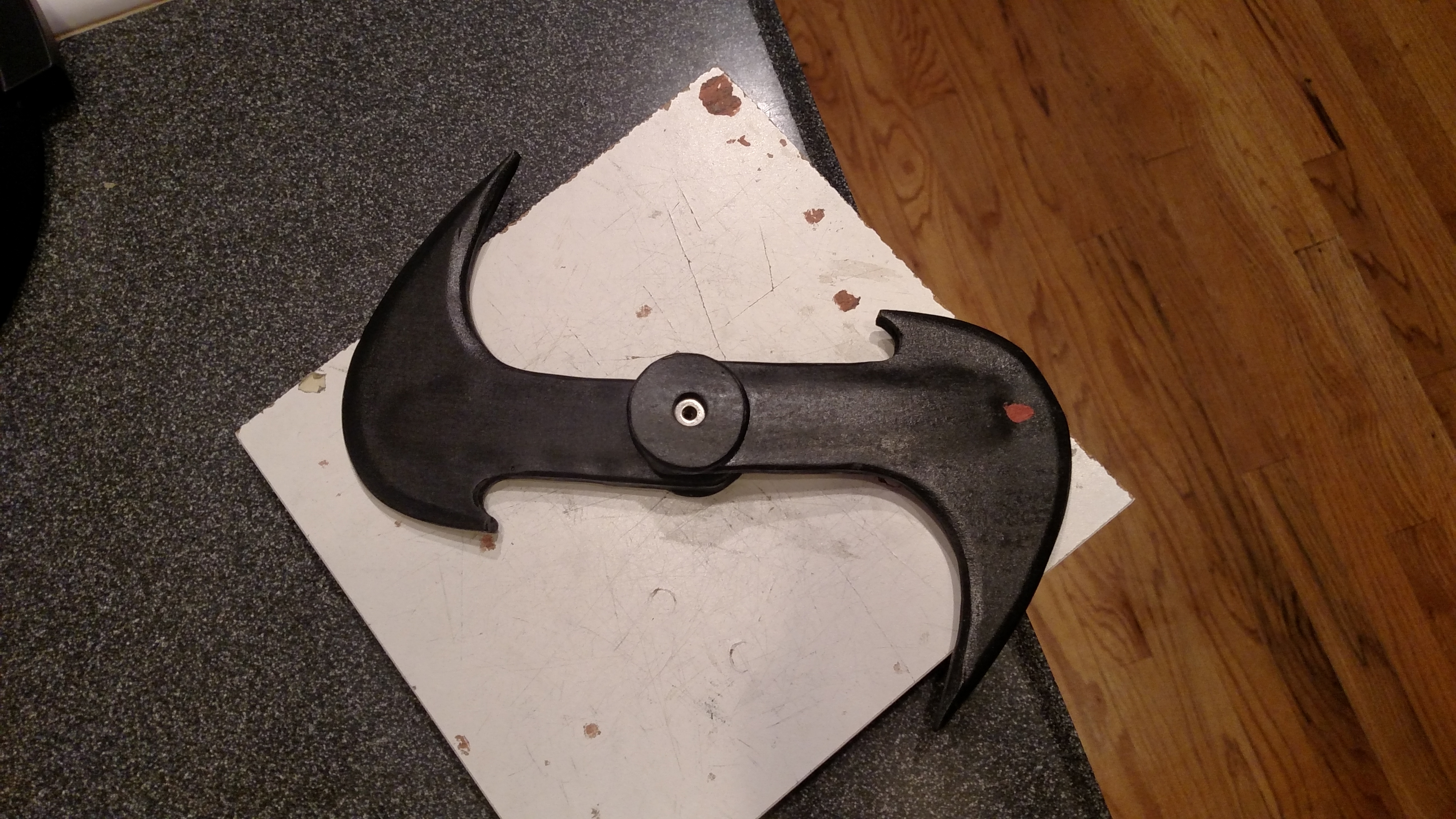

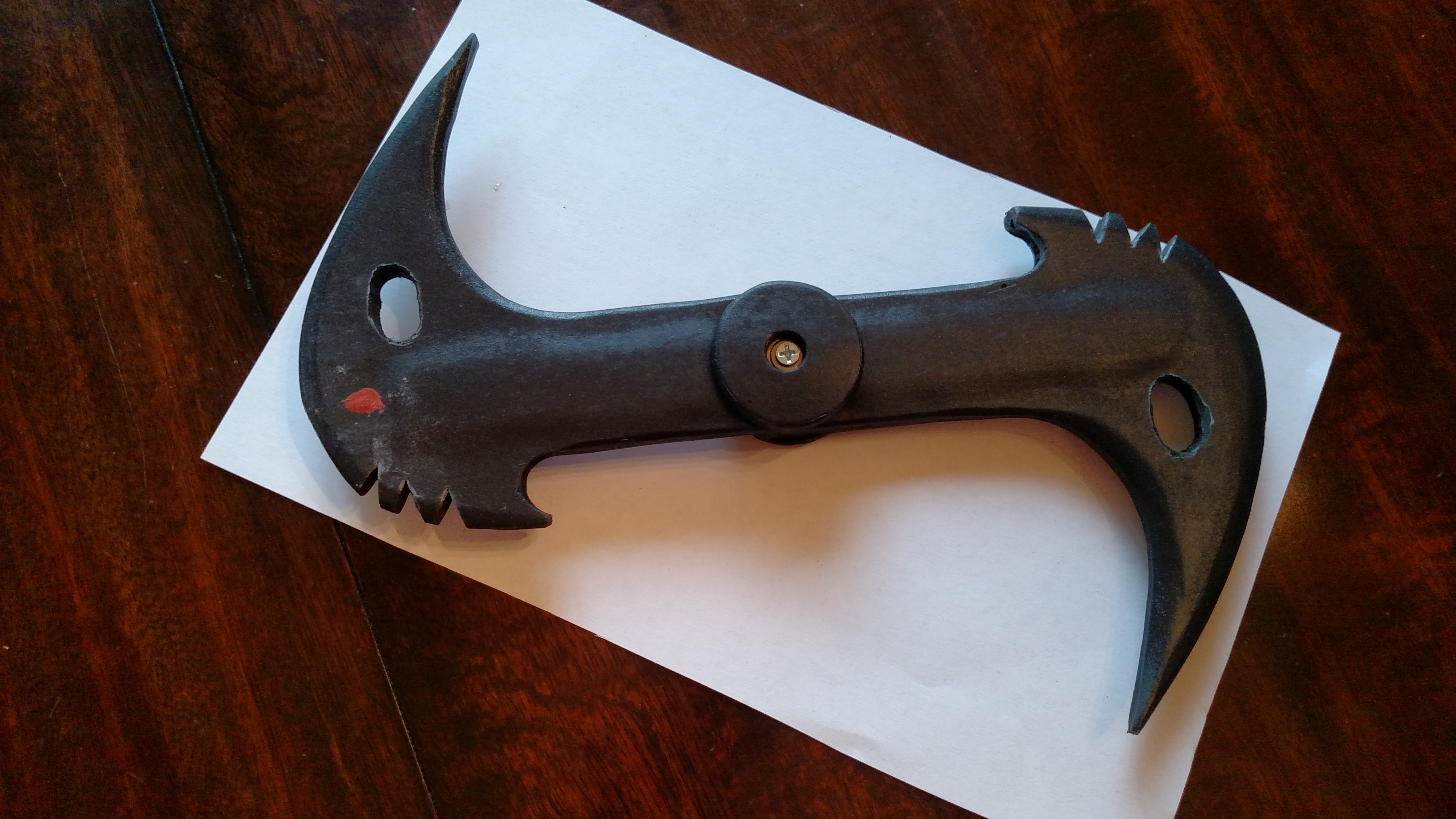

I had not really considered the glaive but its just a simple hinge and some foam
I need to paint he glaive, and have the mac 10 to complete.
so does the glaive lock into an open position?
No it doesn't.. A screw goes through. I reinforced the foam in the middle with some craft popsicle stick type things
The washers sit against the wood and I put a lock washer in as well.
There is enough friction to hold it in place but also allows for the closing and opening motion.

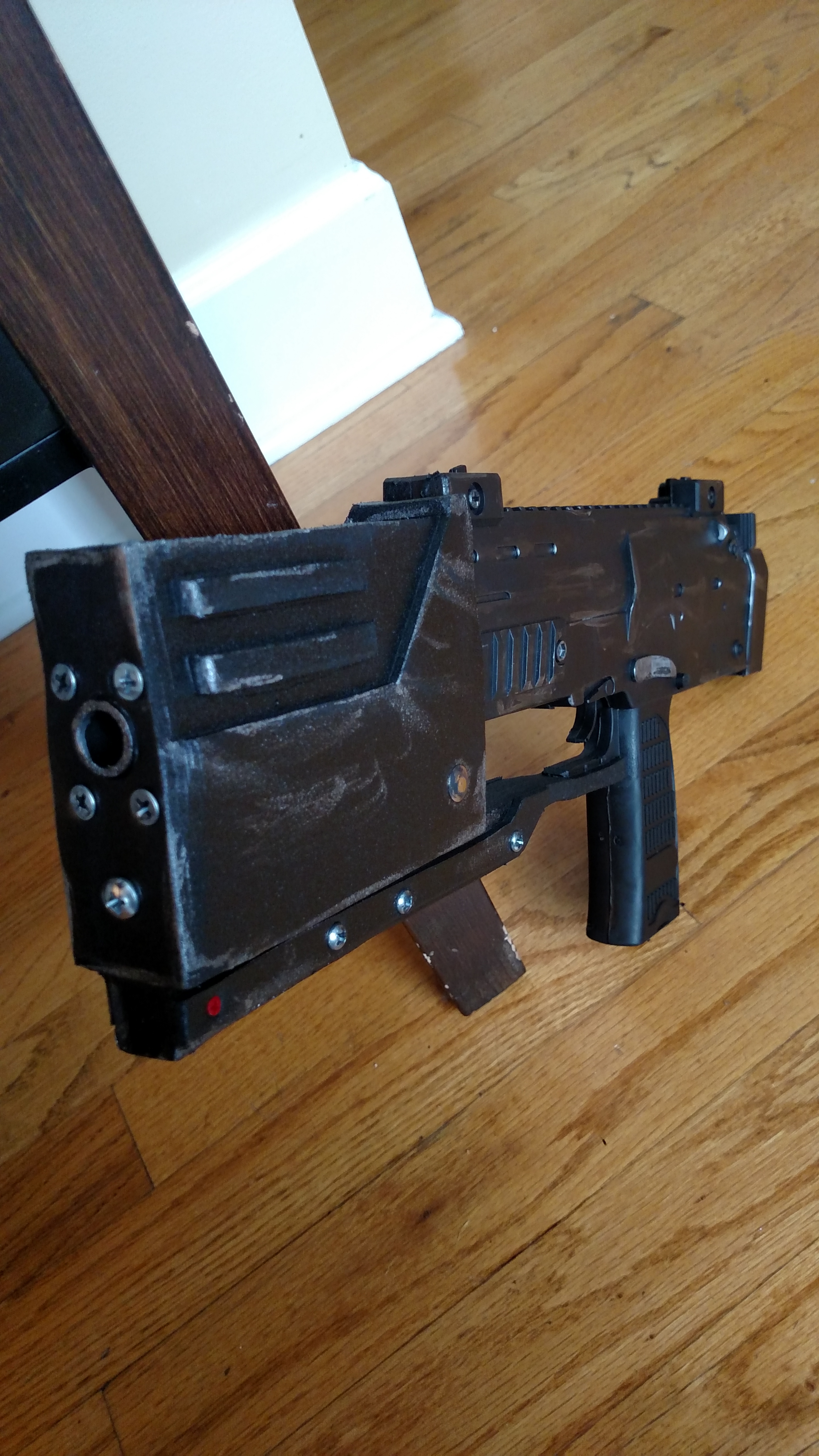

Blade gun.
Not the right base gun but it will get the job done.

Painted the Glaive
Weathered the gun. The gun isn't perfect but it was a $3 dollar store find with scrap foam,screws, and pvc, as cheap as it was I am happy.
