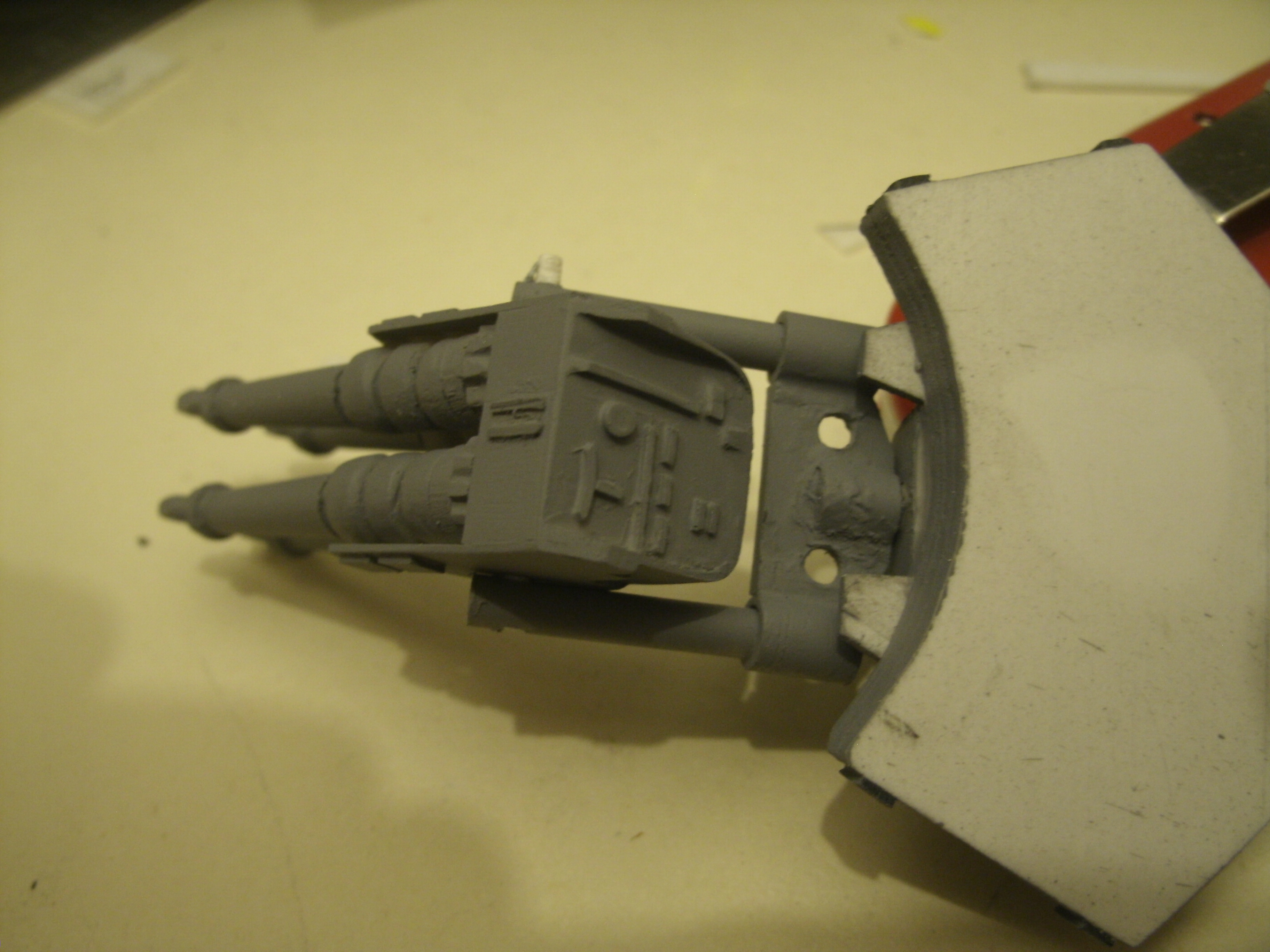

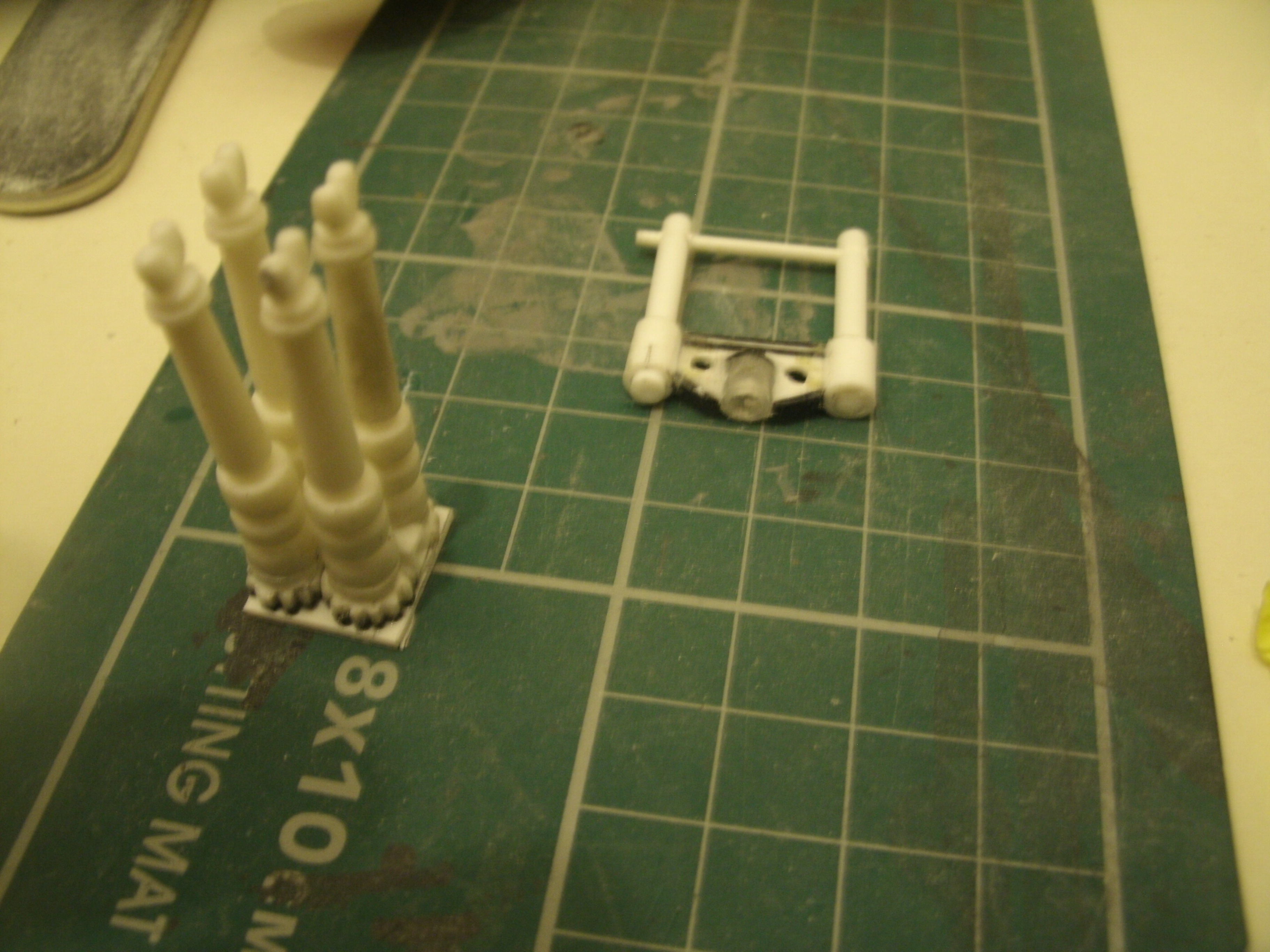

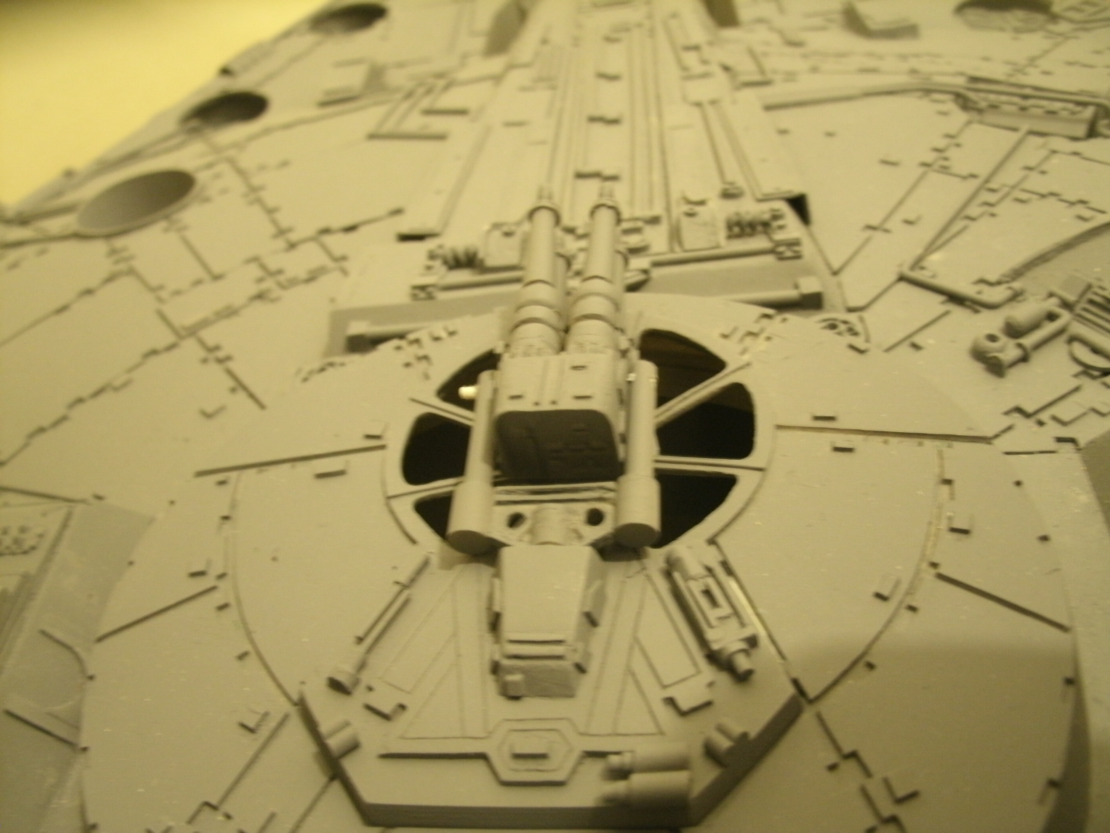

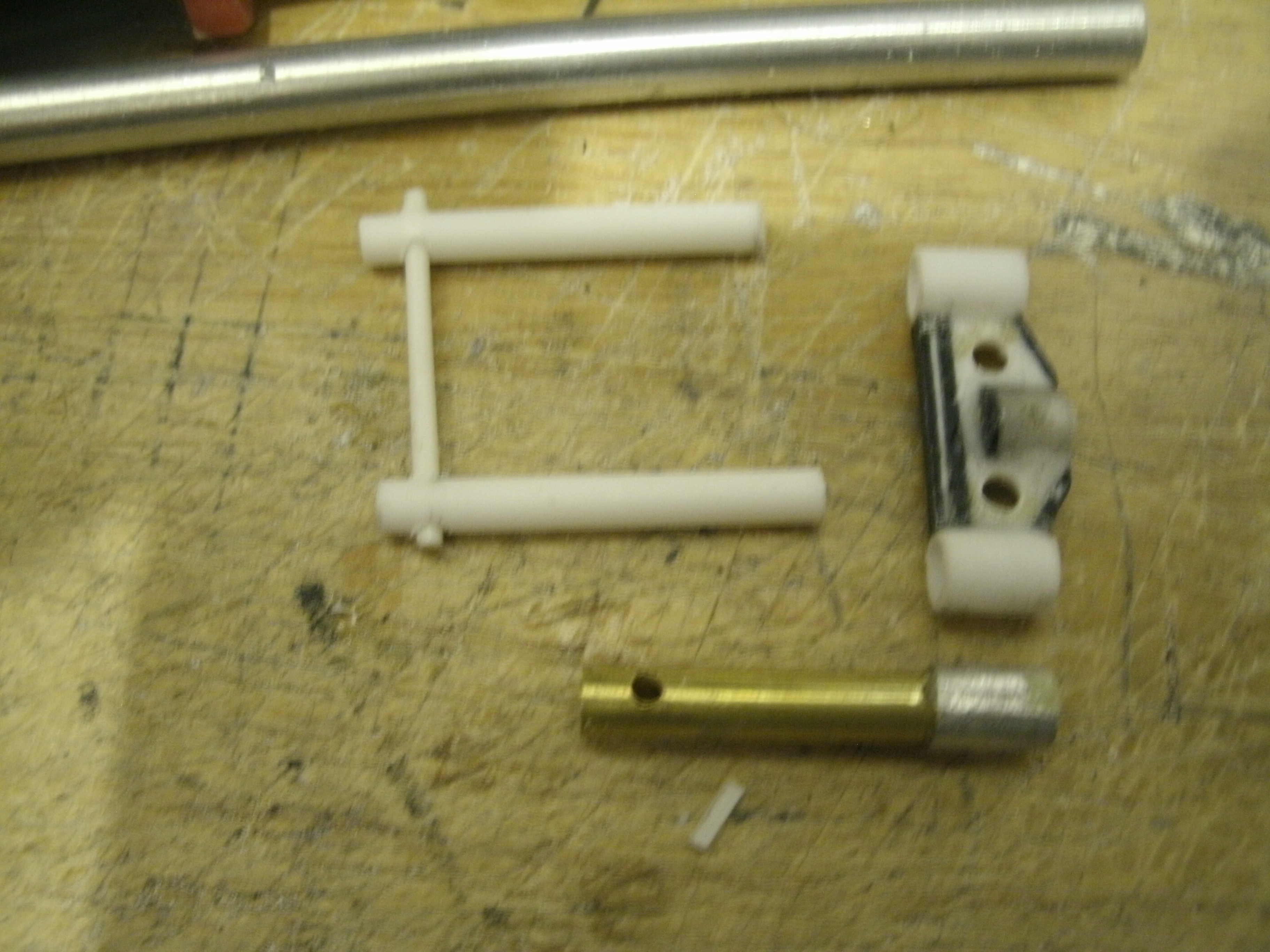

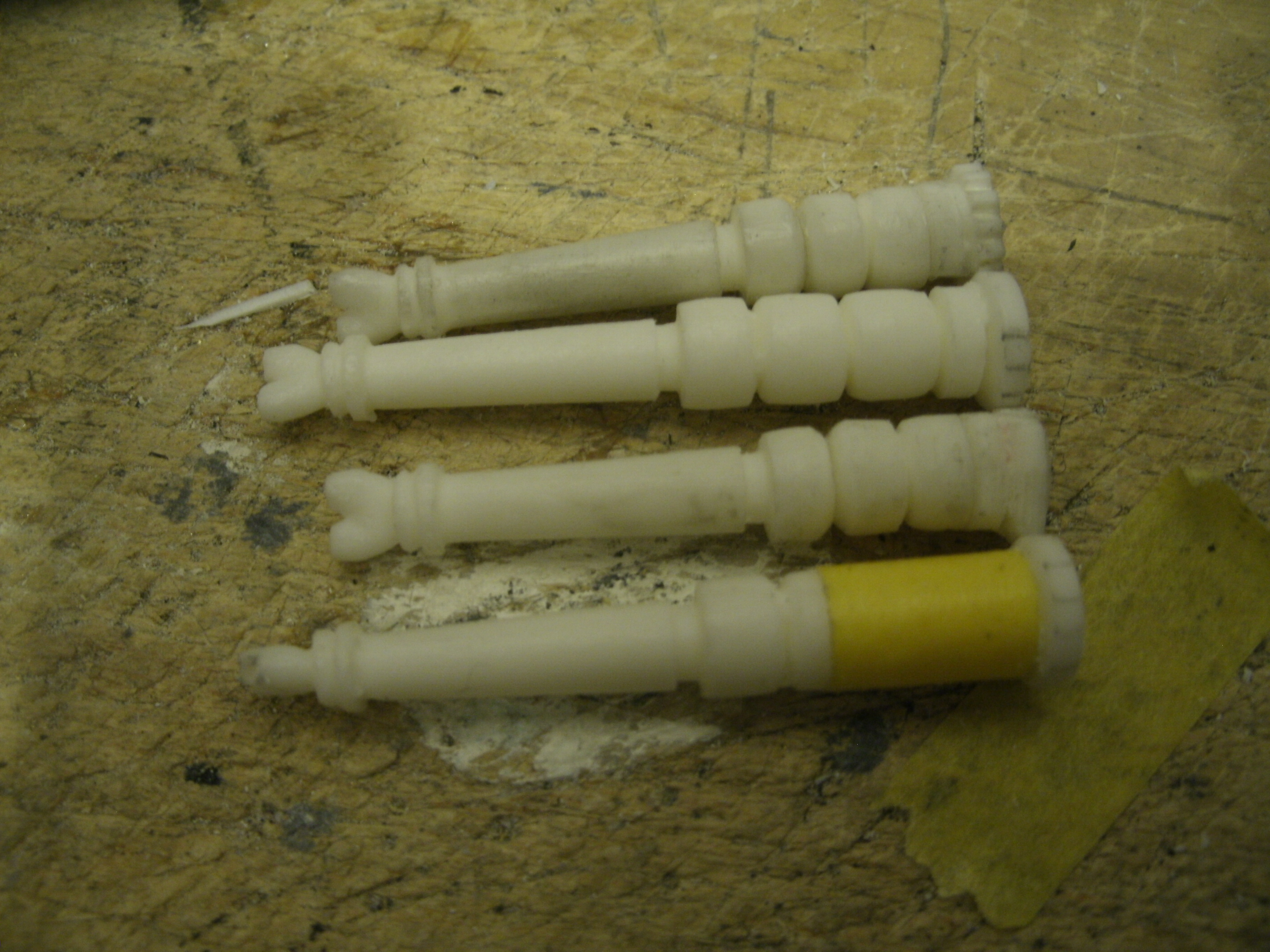

firstly i got my cast cannons back and after mocking them up 2 things happened,firstly i broke the mountings for the cannons(arms)
and i noticed that the guns were 4mm too long. so to fix the first problem i remade the mounts this time using styrene rods and tubing
which i should of used the first time:facepalm
on this first image you can see that i've cut down 2 and 2 are original,i had to cut down the 3 segments at the back of the cannons
as the rest of the cannons is either tapered or i'd lose detail.
attachment.php
i'm very impressed with jaitea's castings......and he did warn me that they looked abit too big!
my second problem i just remade all together.
attachment.php
i just couldn't get a decent bond with the metal and brass.

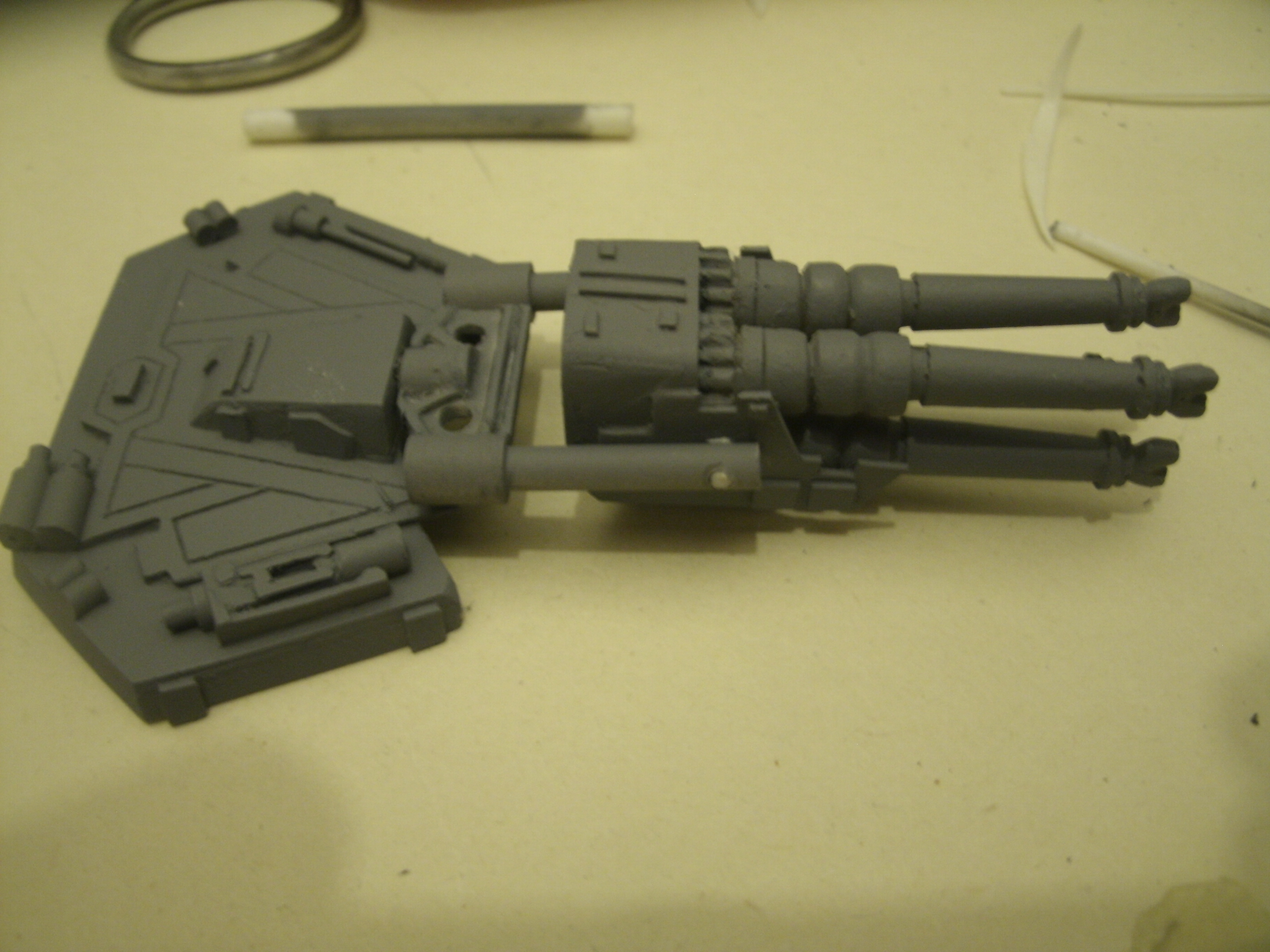

next i got the 4 cannons mounted on a backing plate with some evergreen box tubing inbetween to allow it to articulate,but i found that all it wanted to do was lie
flat and not in position so my simple fix was to put alittle blue tack inside the box tubing and it worked a treat.
attachment.php
after doin all this with the front of the cannons i decided to remake the back section of the cannons as i wasn't that happy with the detail and look of them,
so after making the cannons i gave it all a coat of primer just to get a look on if there was any bits that needed filling or repairing,but it all looked ok.
so here are some images of the finished cannons as yet,i still have a few little details to add on but you can get the jist.
attachment.php
attachment.php
attachment.php

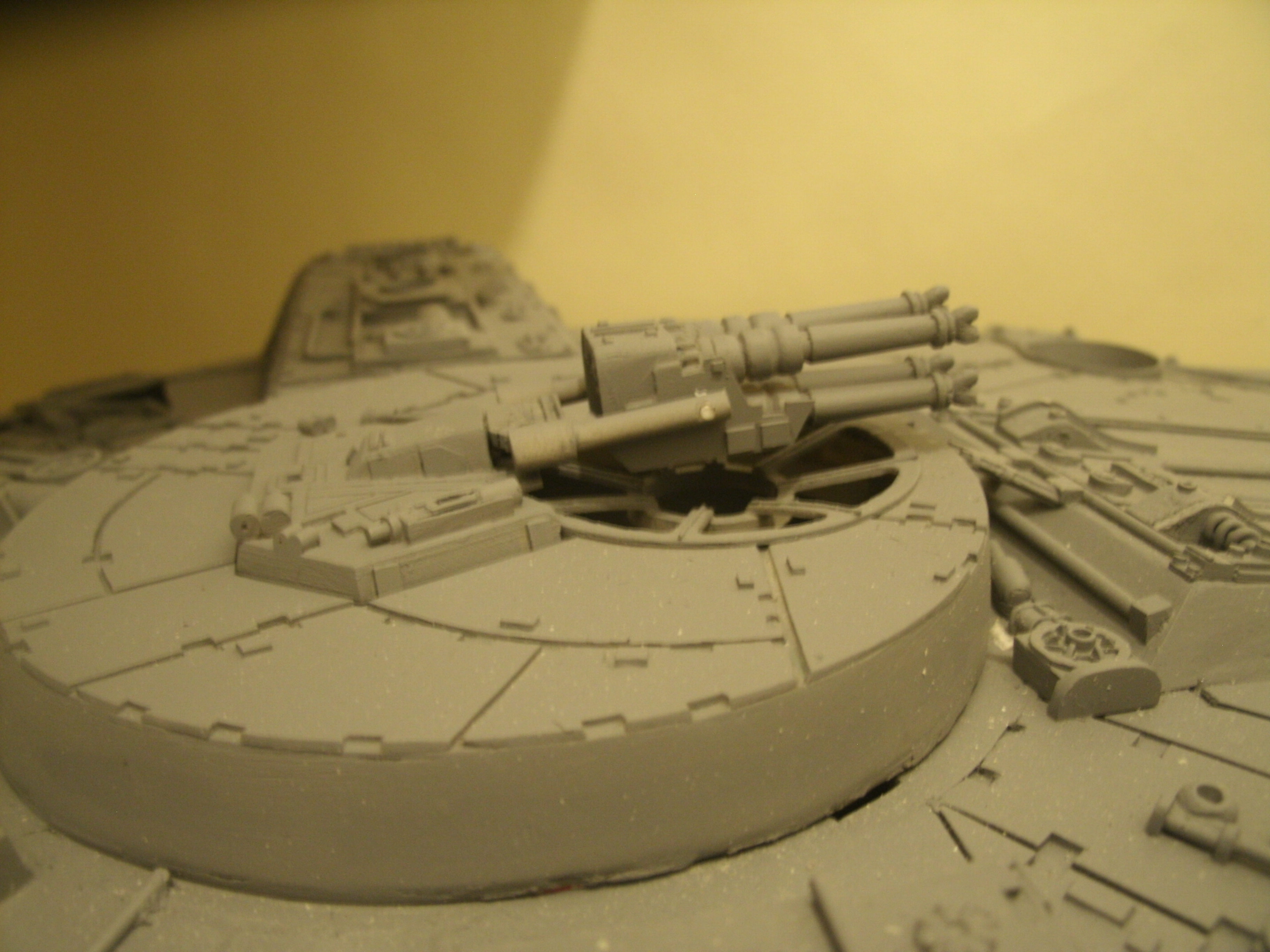

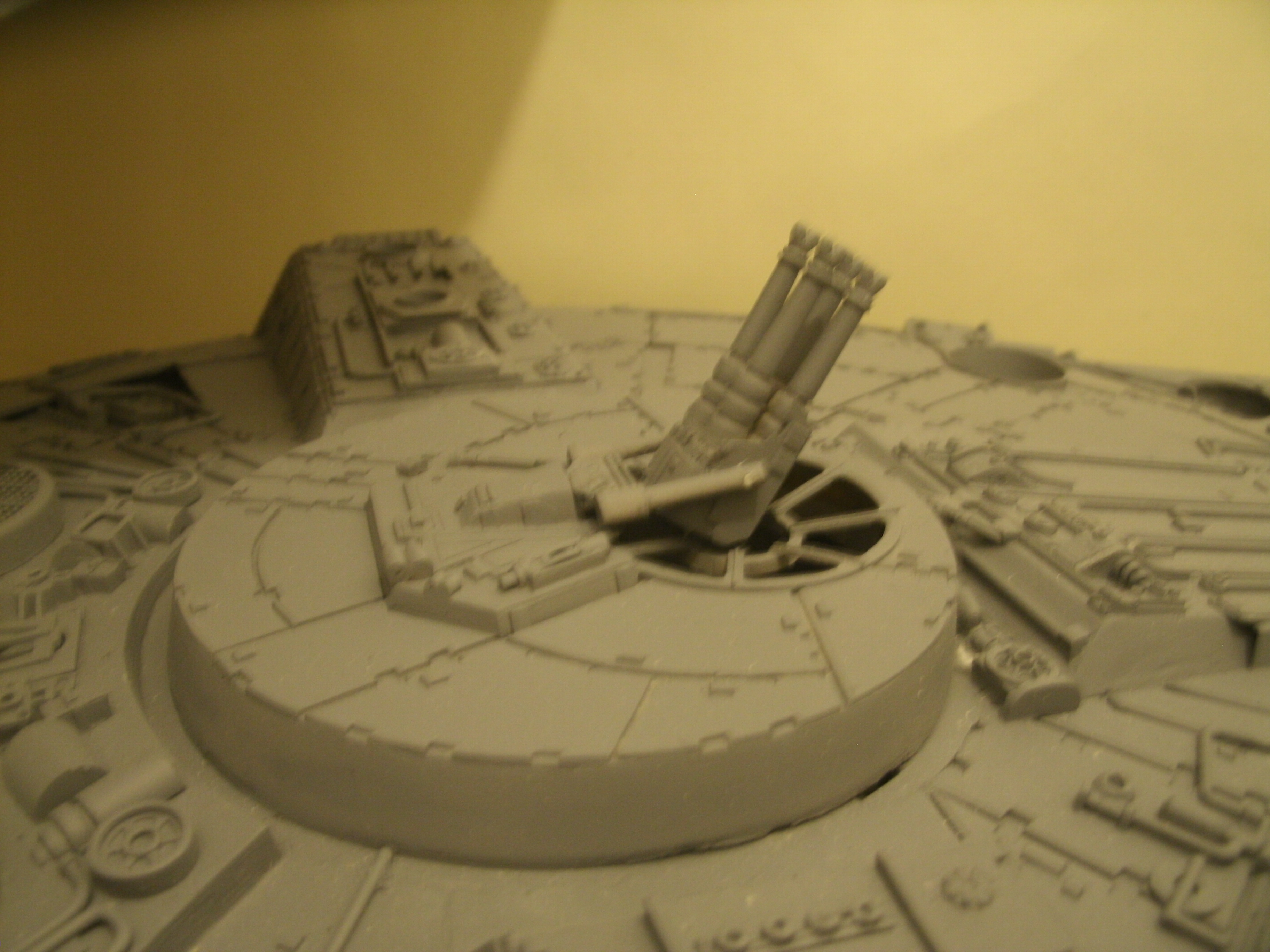

and finally here are acouple of images of the cannons mounted in position.
attachment.php
attachment.php
attachment.php

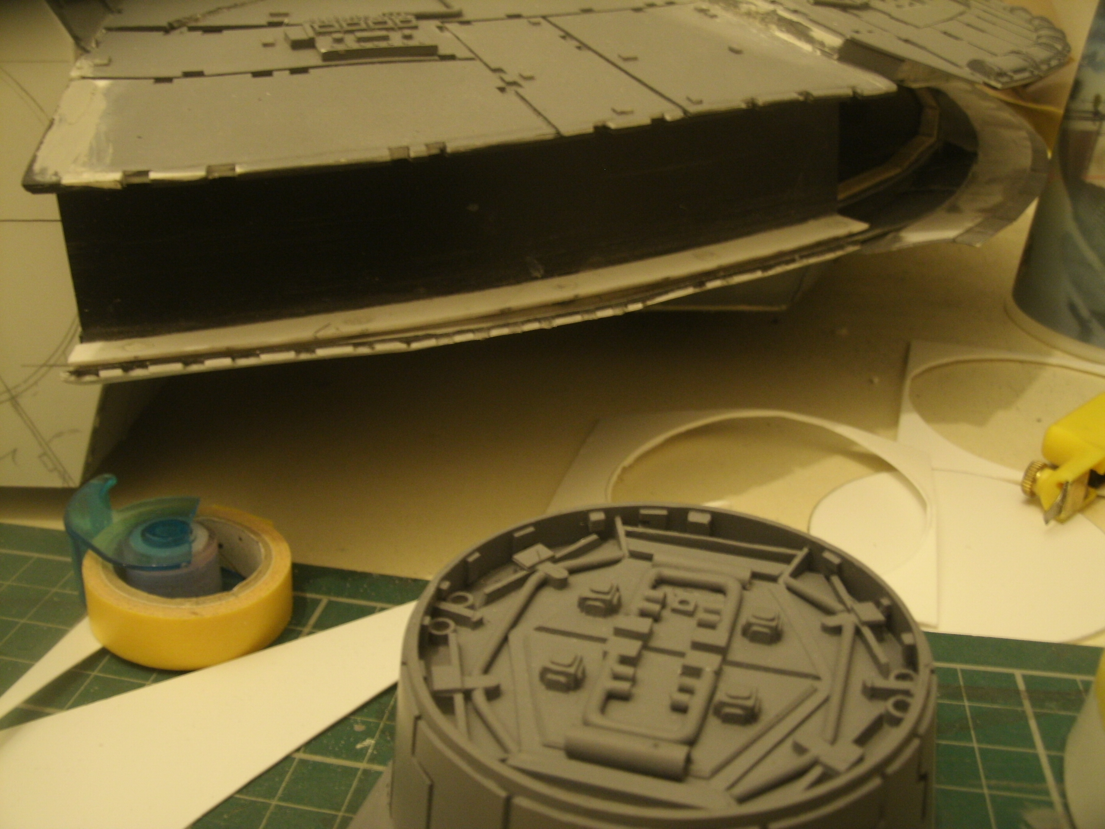

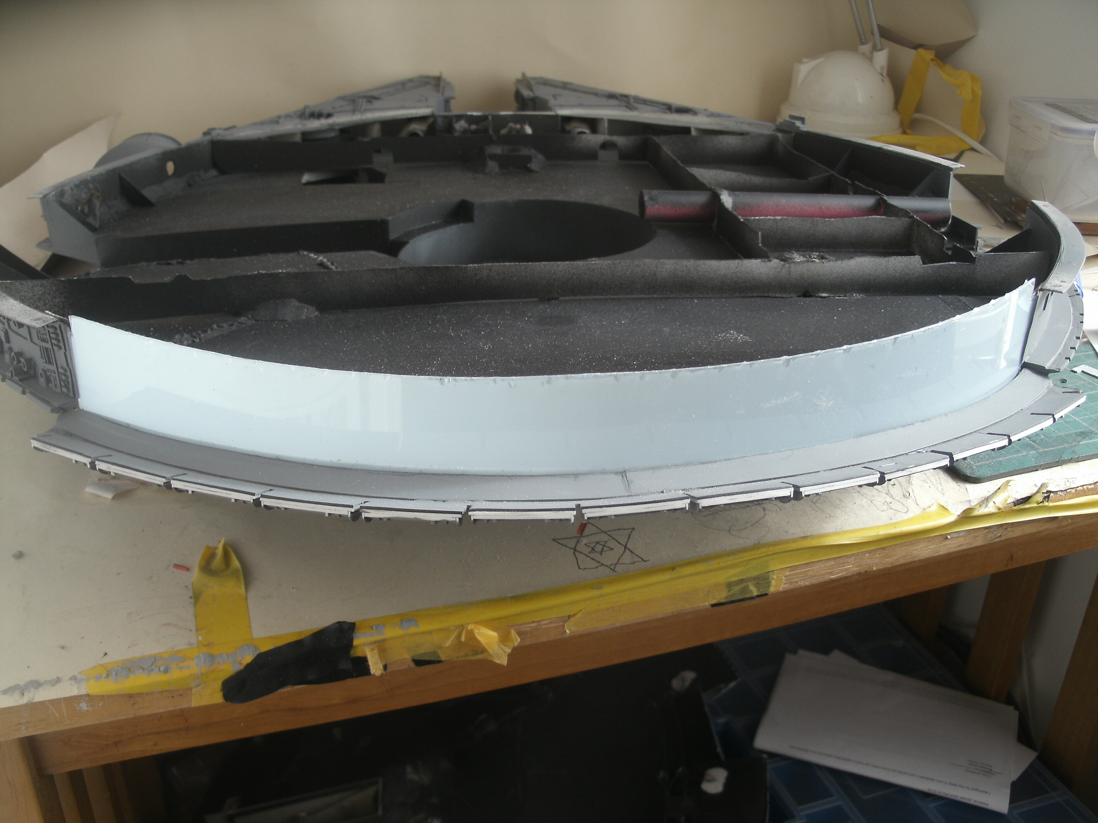

well i,ll get started on the updates,first off i get the sides done,well skinned and the magnets in so it seals up.
attachment.php
attachment.php

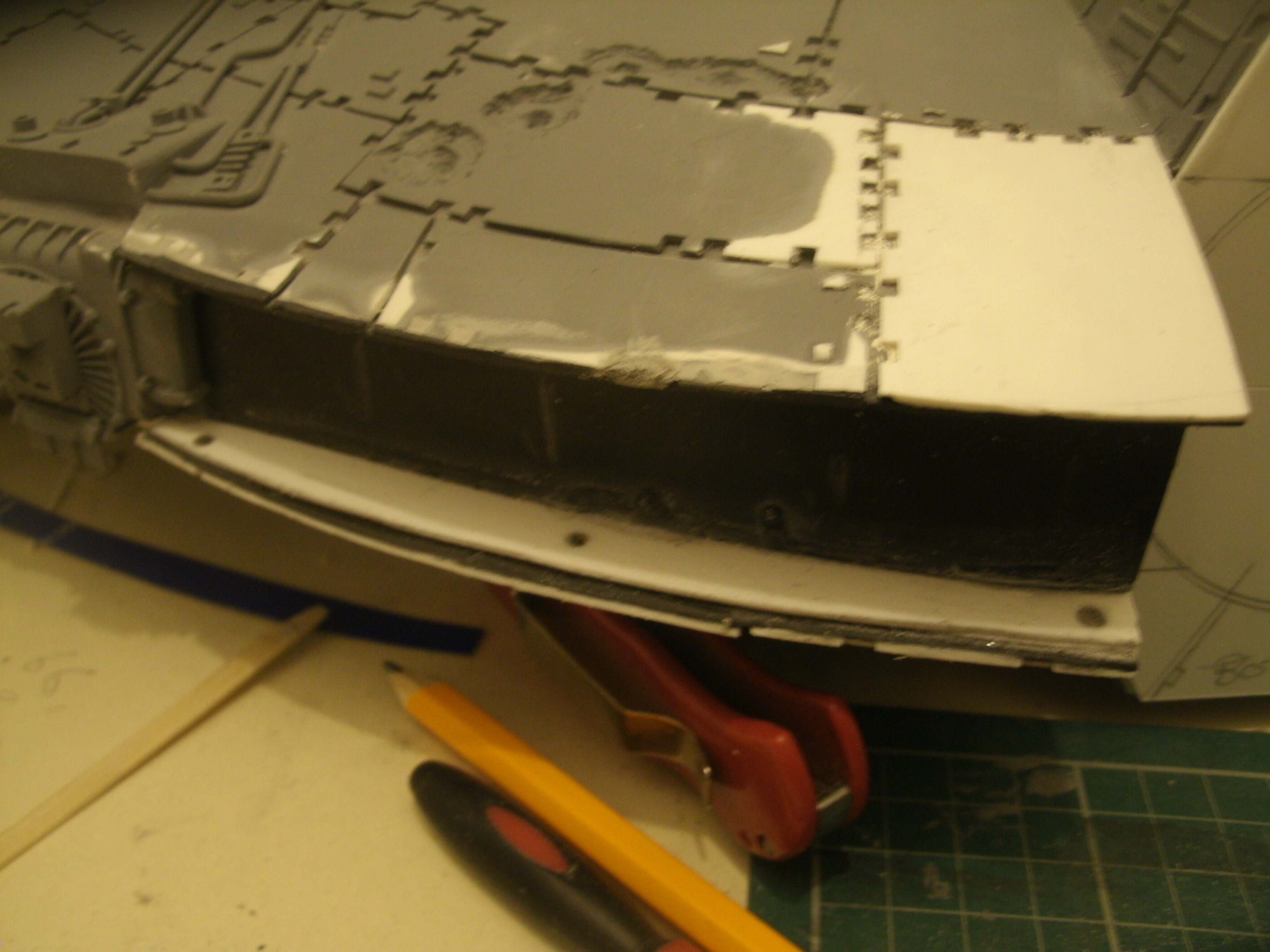

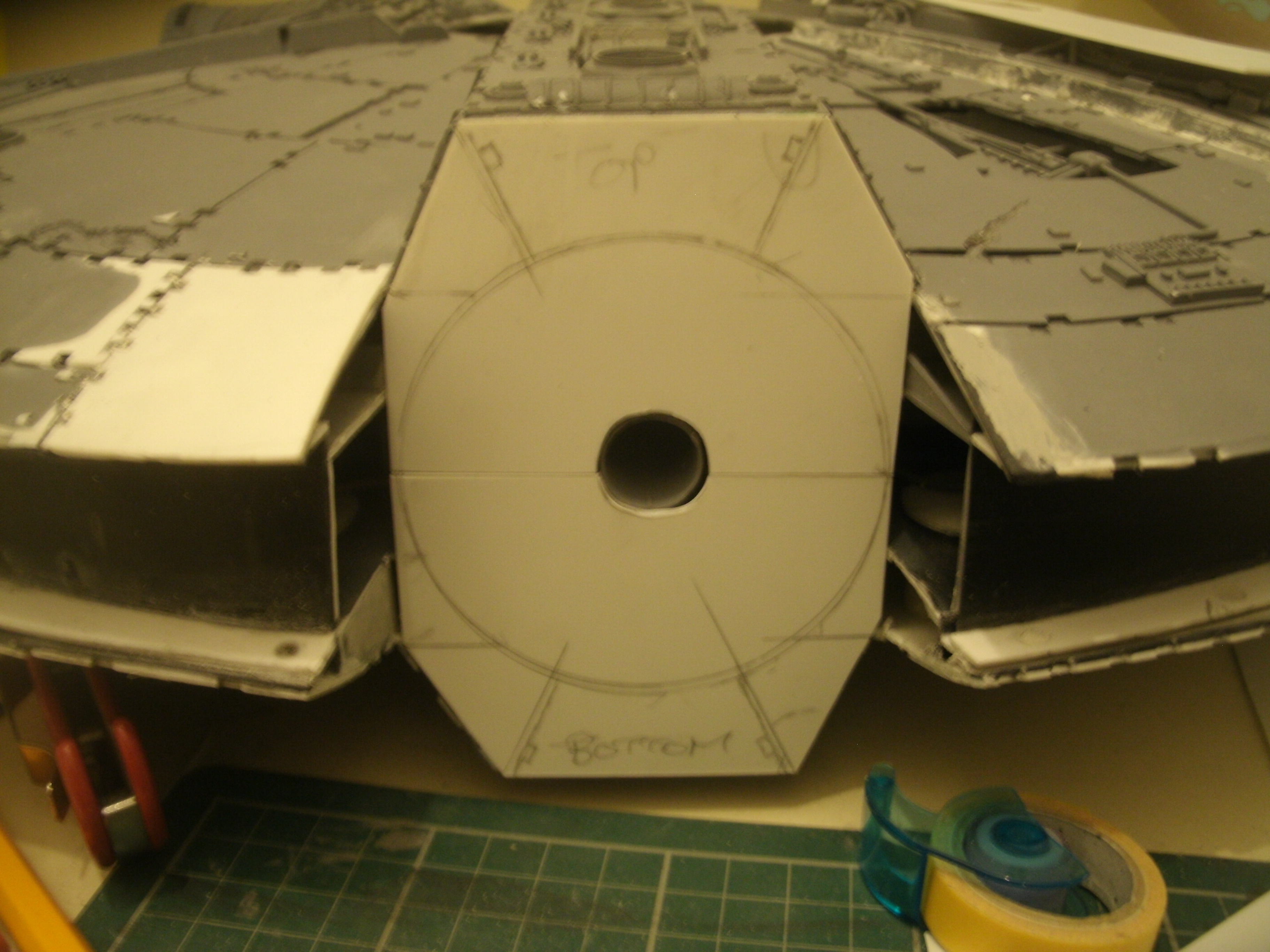

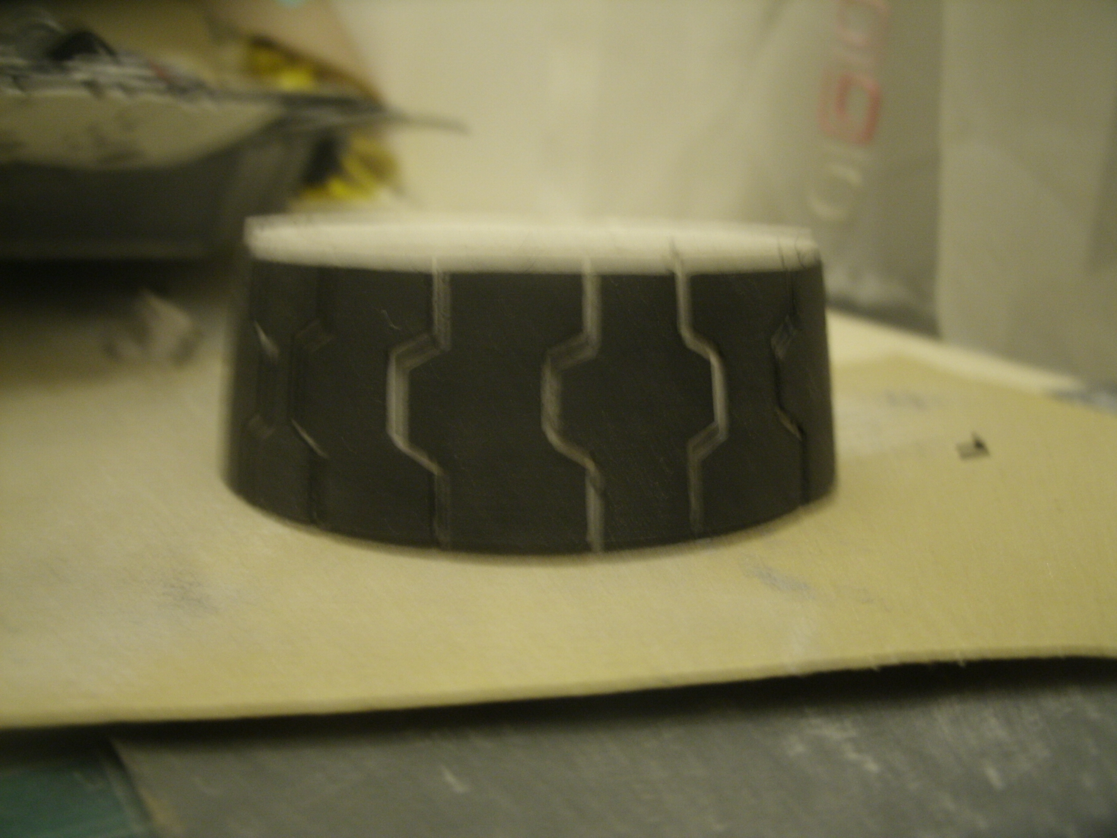

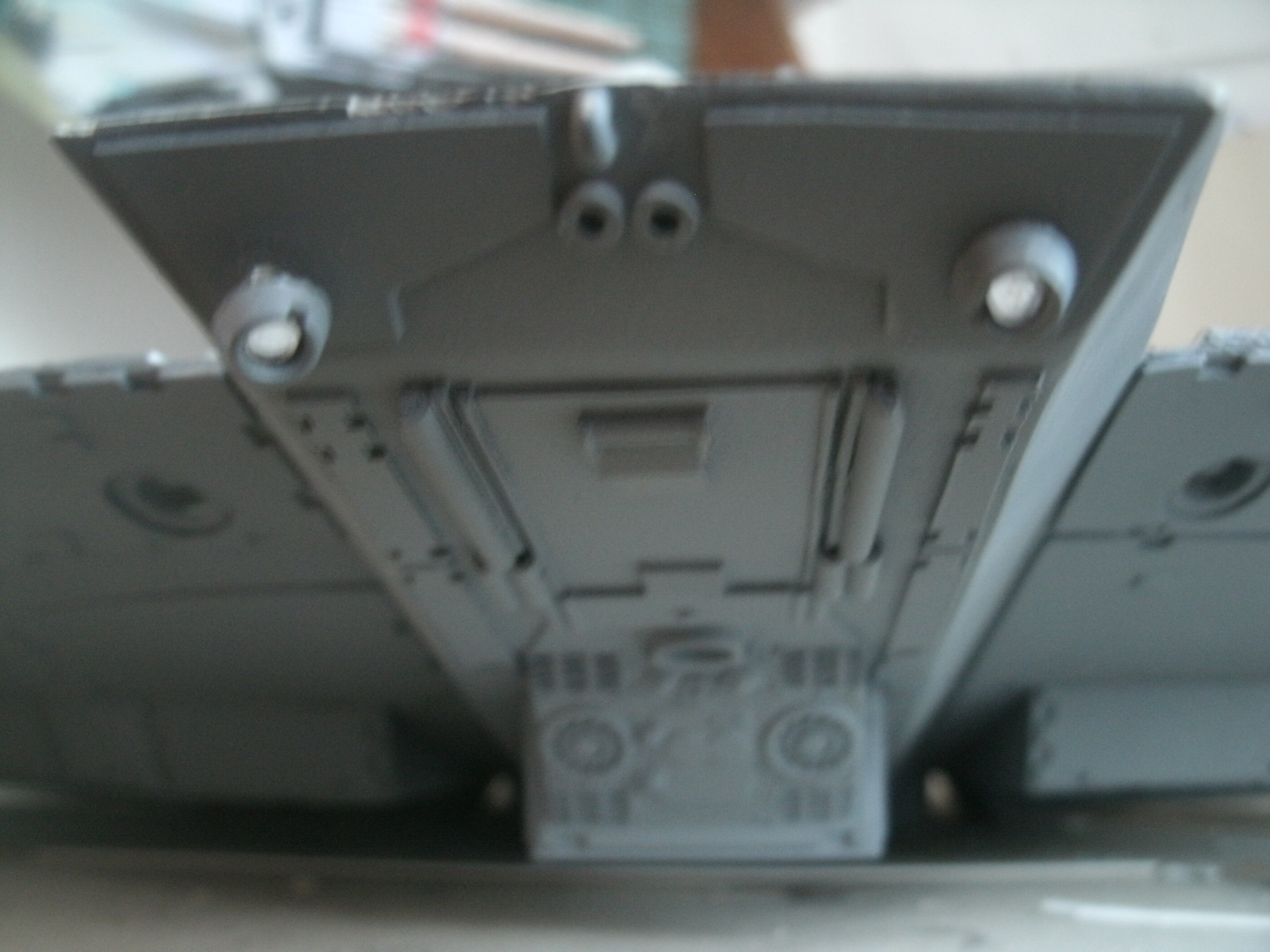

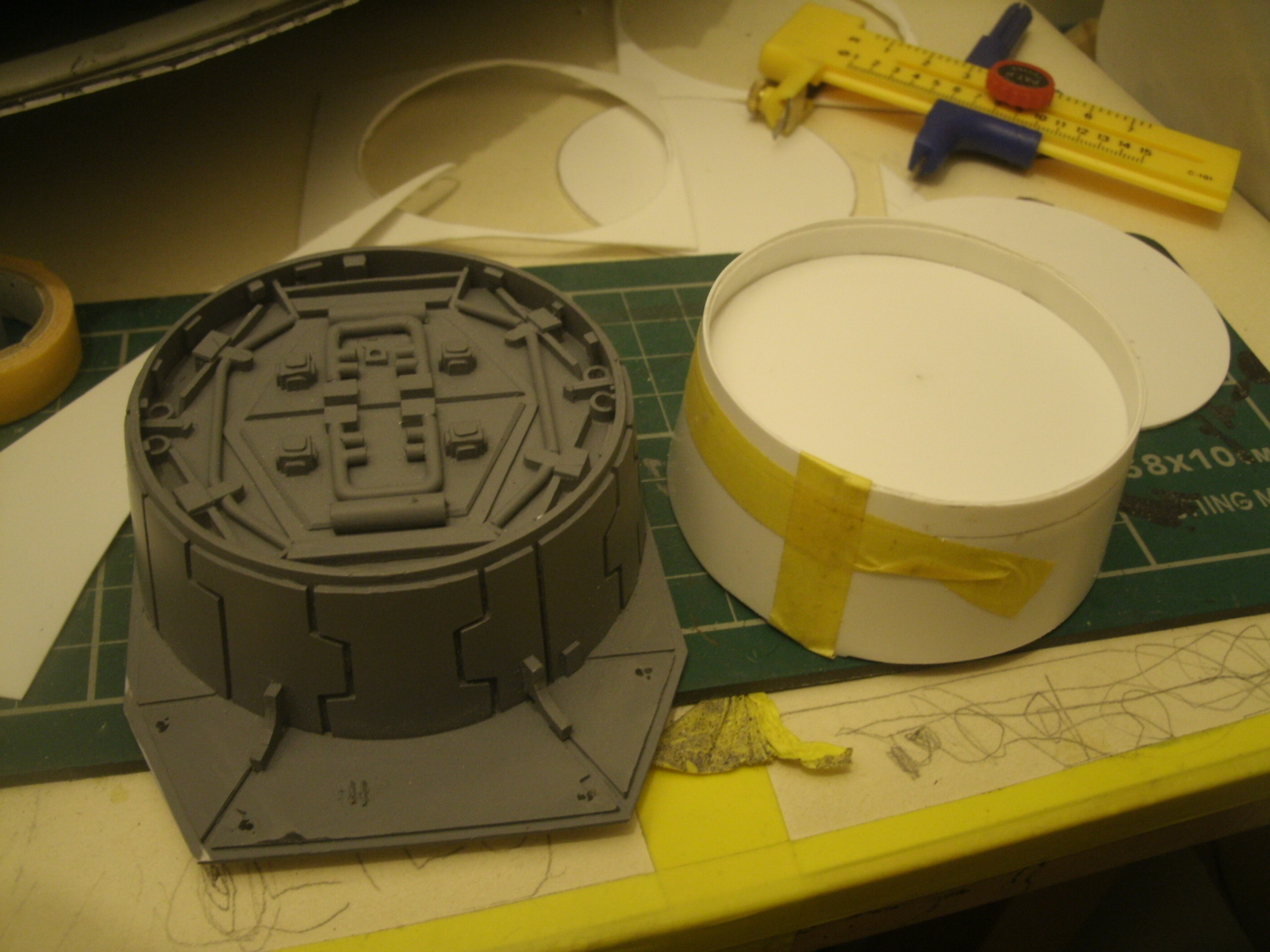

next i made a start on the other docking ring,which due to the armature i had to make changes to in the way i built this one.
first off i made the backing plate and mounted it on to the model.
attachment.php

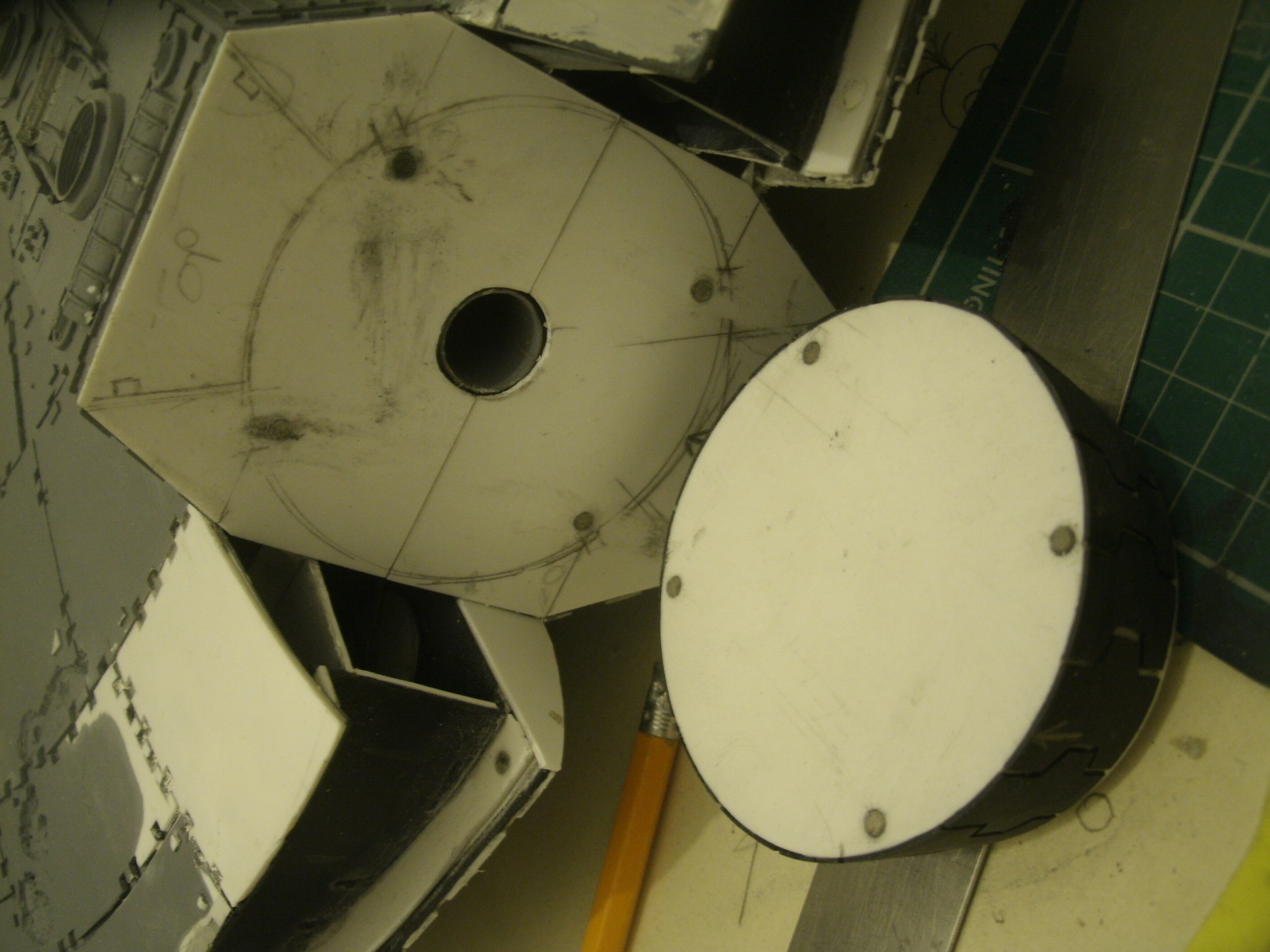

next i cut it in two for the top half and bottom and made the docking ring shape using a Mc,donalds becker again.
attachment.php
next i skinned it and put the magnets in the back.
attachment.php
attachment.php

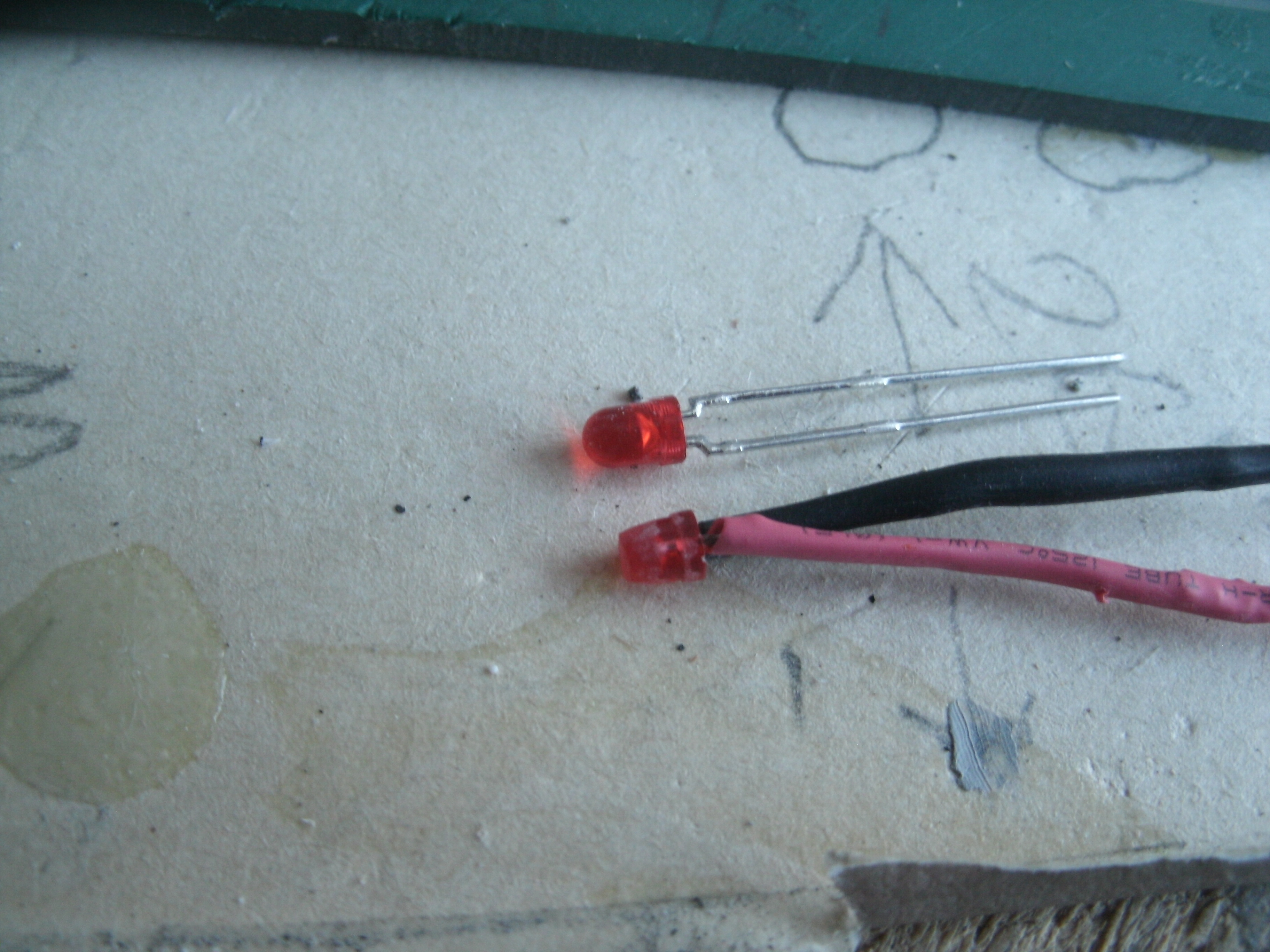

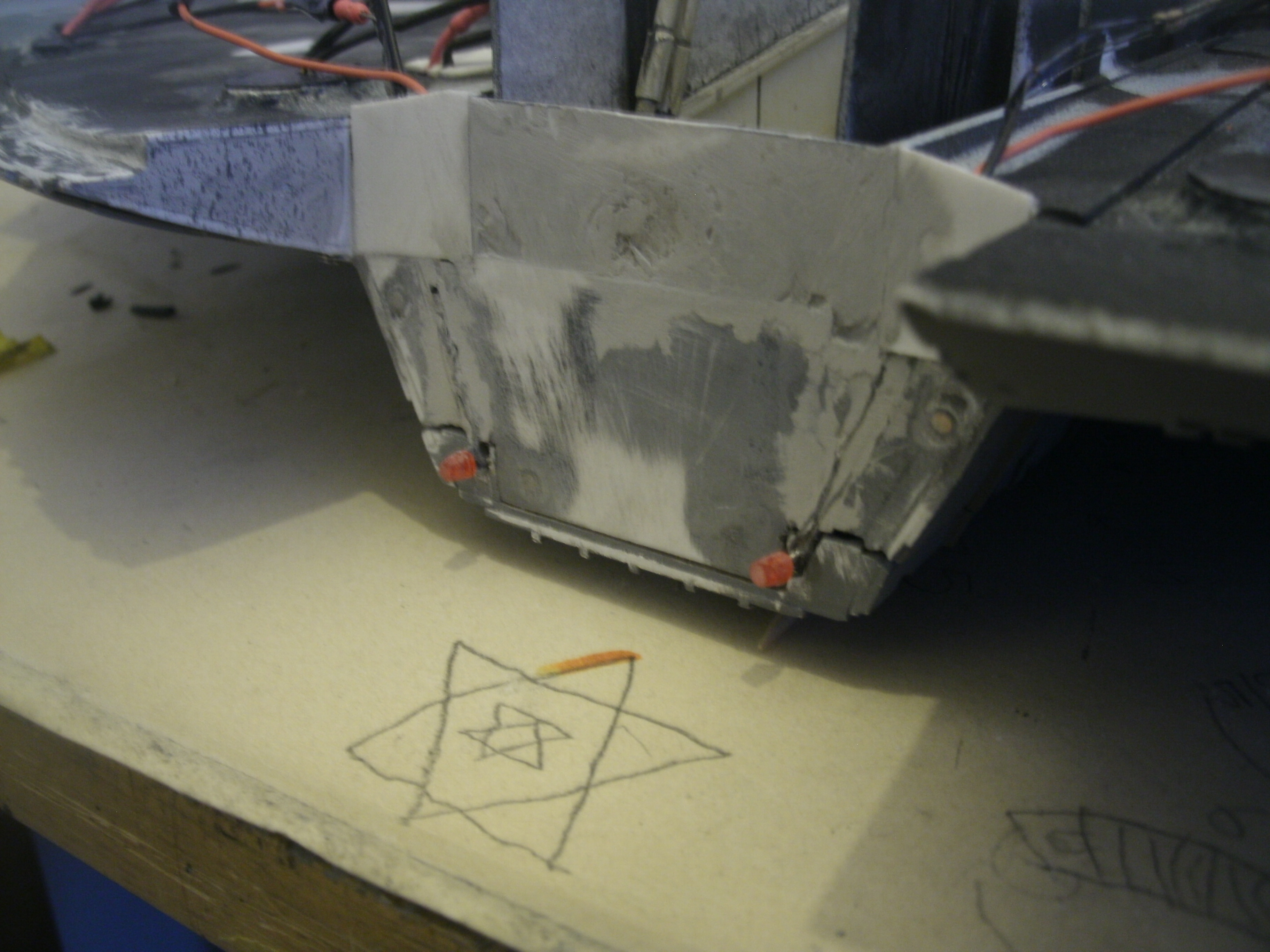

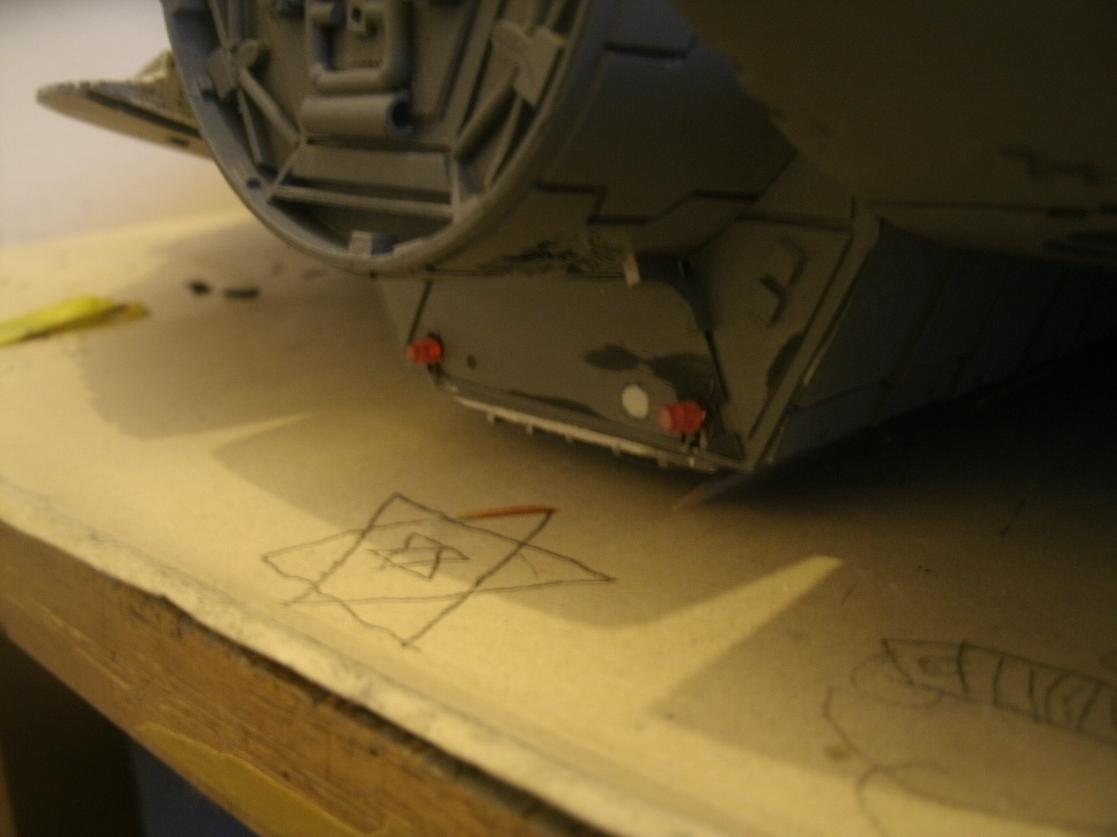

i was doin some tinkering and snapped one of the LED landing lights so i had to change one,but i desided to change the lot due to the old ones were old out of a torch,so i got myself some new LED's.so i changed all the landin lights bulbs,and then thought i should do the mind ya head lights while im at it cos i wanted the two to run off the same circuit.
first off i was gonna use some 2mm fibre optics,but in the end i used some 3mm red LED's,which had to be filed down and shaped up.
attachment.php

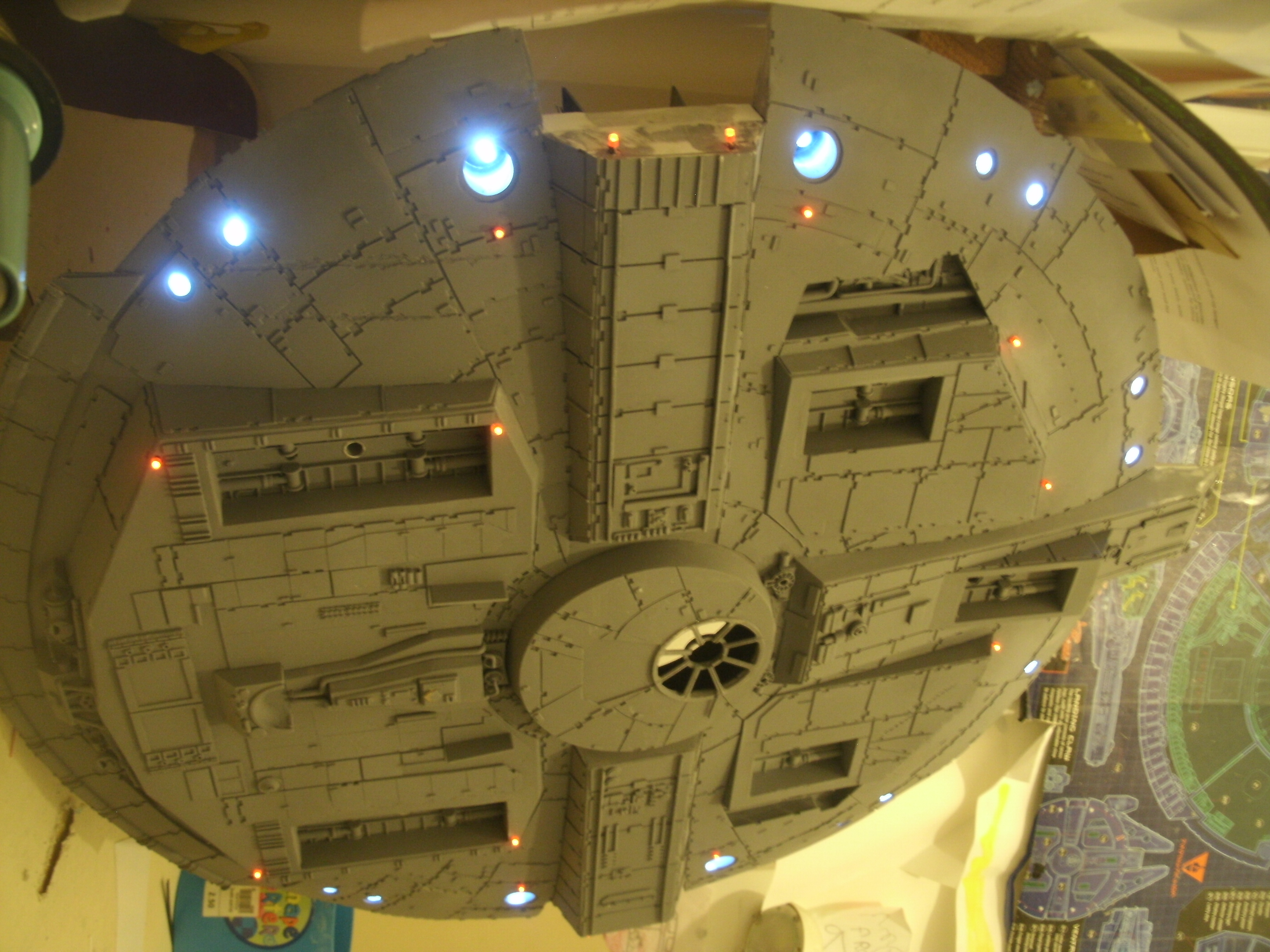

here you can see all the lights workin both the landin and the mind ya head ones,i have got two more to do on the front landin leg bay but run out of bulbs at the mo:facepalm.
here on the next image you can see all 31 bulbs in action.
attachment.php
attachment.php

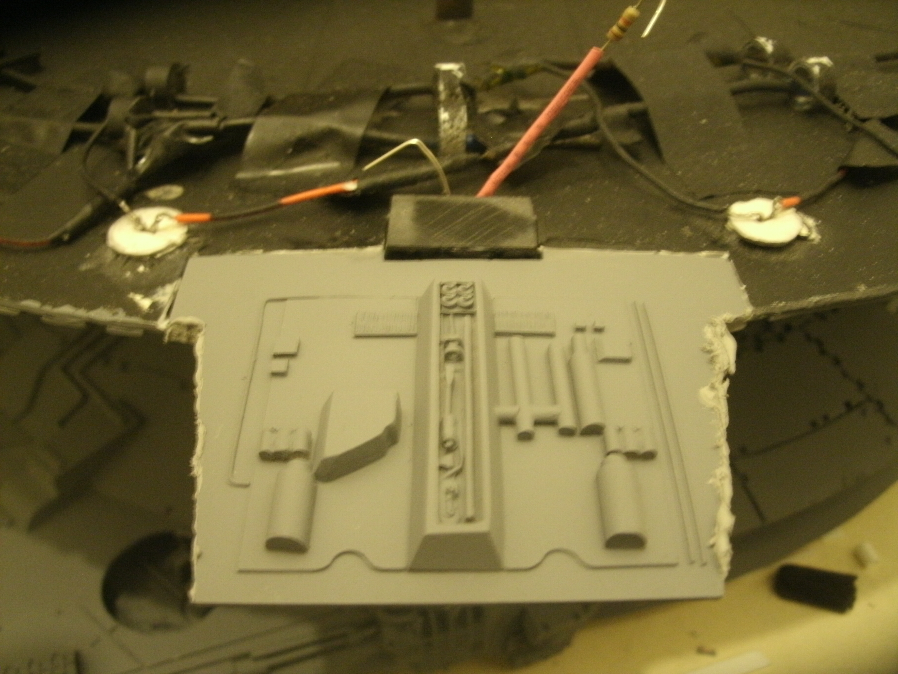

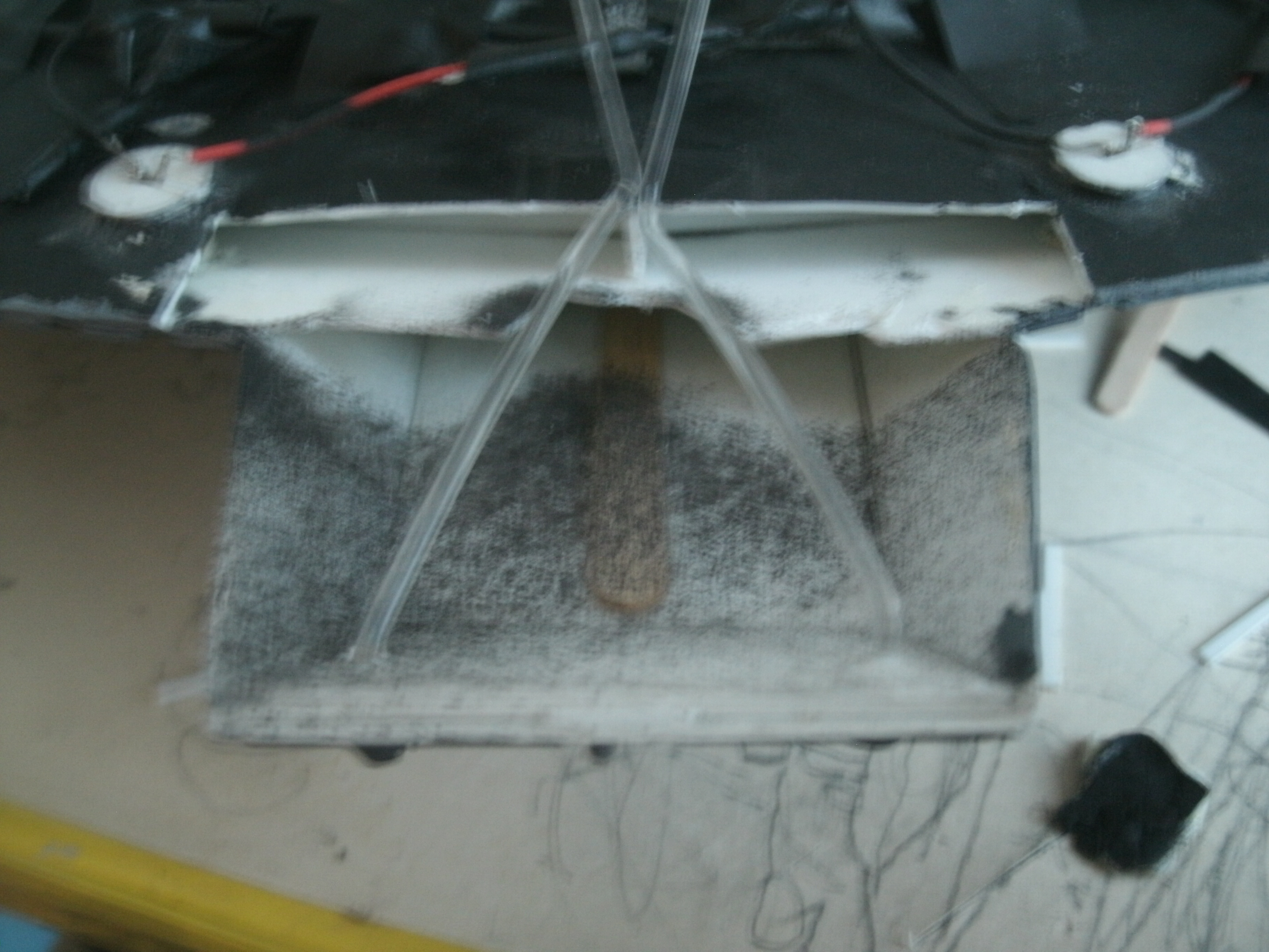

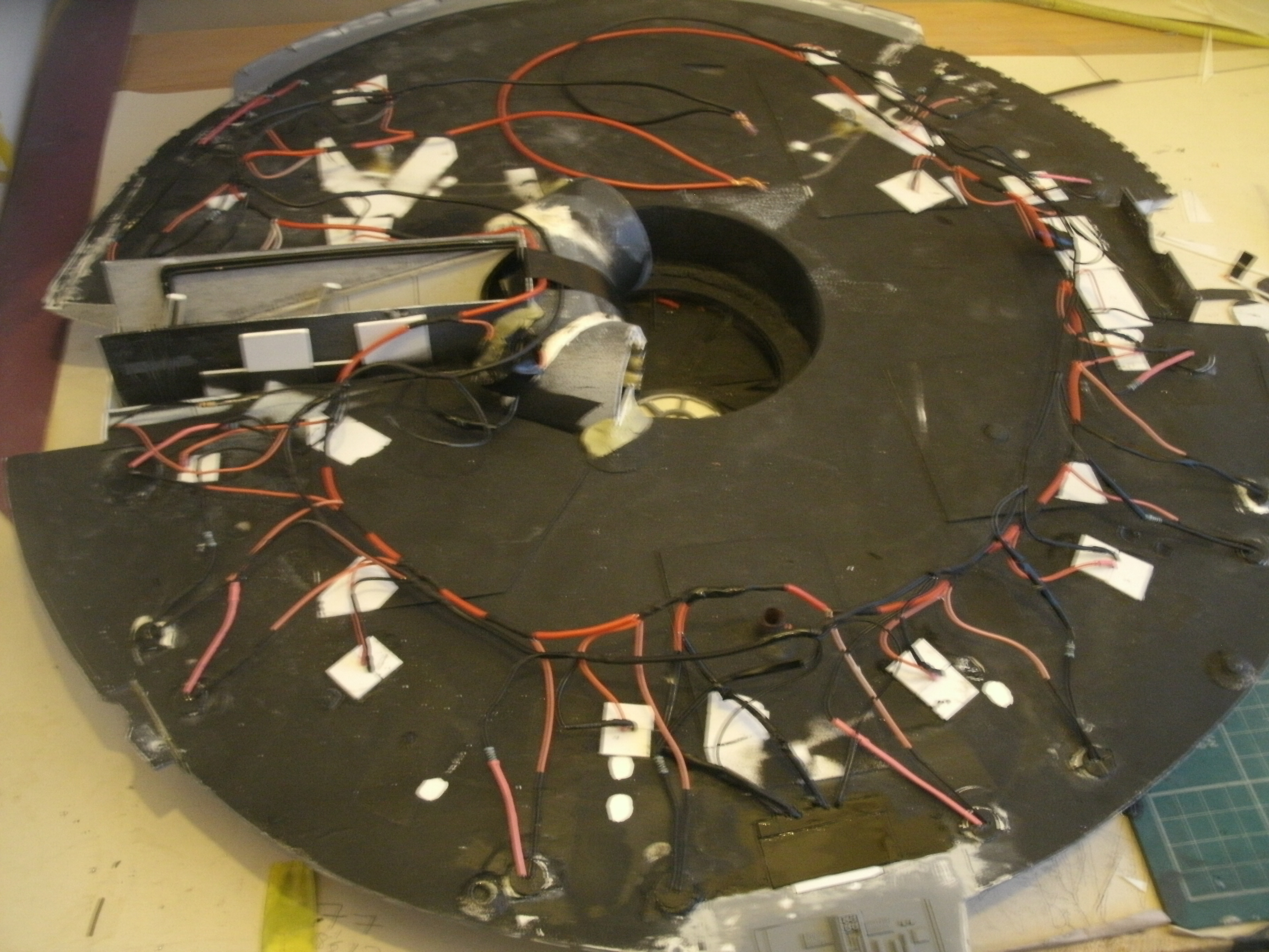

finally here is the wiring circuitry on the inside of the model all new,even the boarding ramp got a new bulb.so the final count of bulbs so far...........33
attachment.php

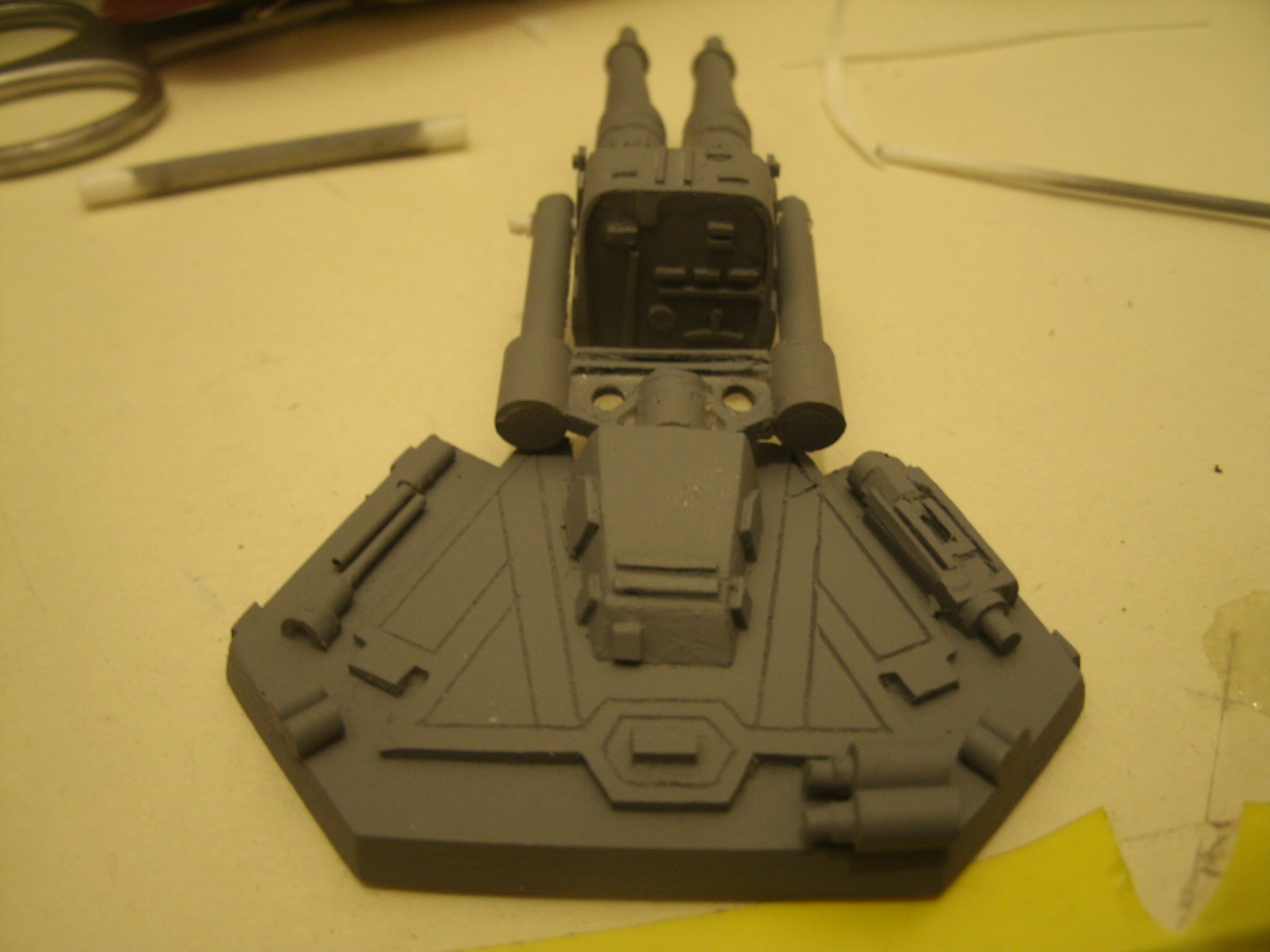

and finally i started to work on the cockpit,first off i made a base for the cockpit and for the back wall,out of some 2mm styrene.
next i knocked up the back wall with the doorway cut out.
next i started on the door and the doorway.
i started to make up some panels for the detail,using some half mm styrene so i could pierce pin holes in for my fibre optics and also put 2 clear pieces of styrene for the lighted areas on the back wall.
here you can see the fibre optics in on the first image and workin on the last image.
and finally here you can see the back wall in and workin.
yeah so all i need is to colour up the different lights with some tamiya clear colours.
and the last thing i started on was the side bits of the cockpit.
well it's it for now i'll post some more when i get a bit further on,hope ya like the progress...cheers peza
