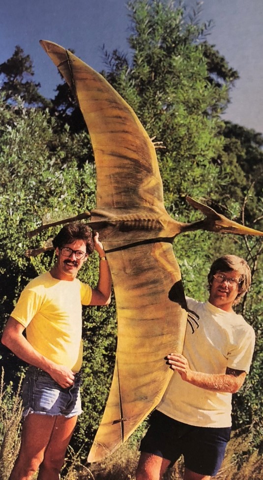

Westways magazine 1984
This is one of the original models. Three were built. Bill Watson, my employer and designer of the bird on the right and Martyn Cowley who coincidently was my supervisor years later when I worked at Aerovironment. Small world!
This how I want my model to eventually look.
