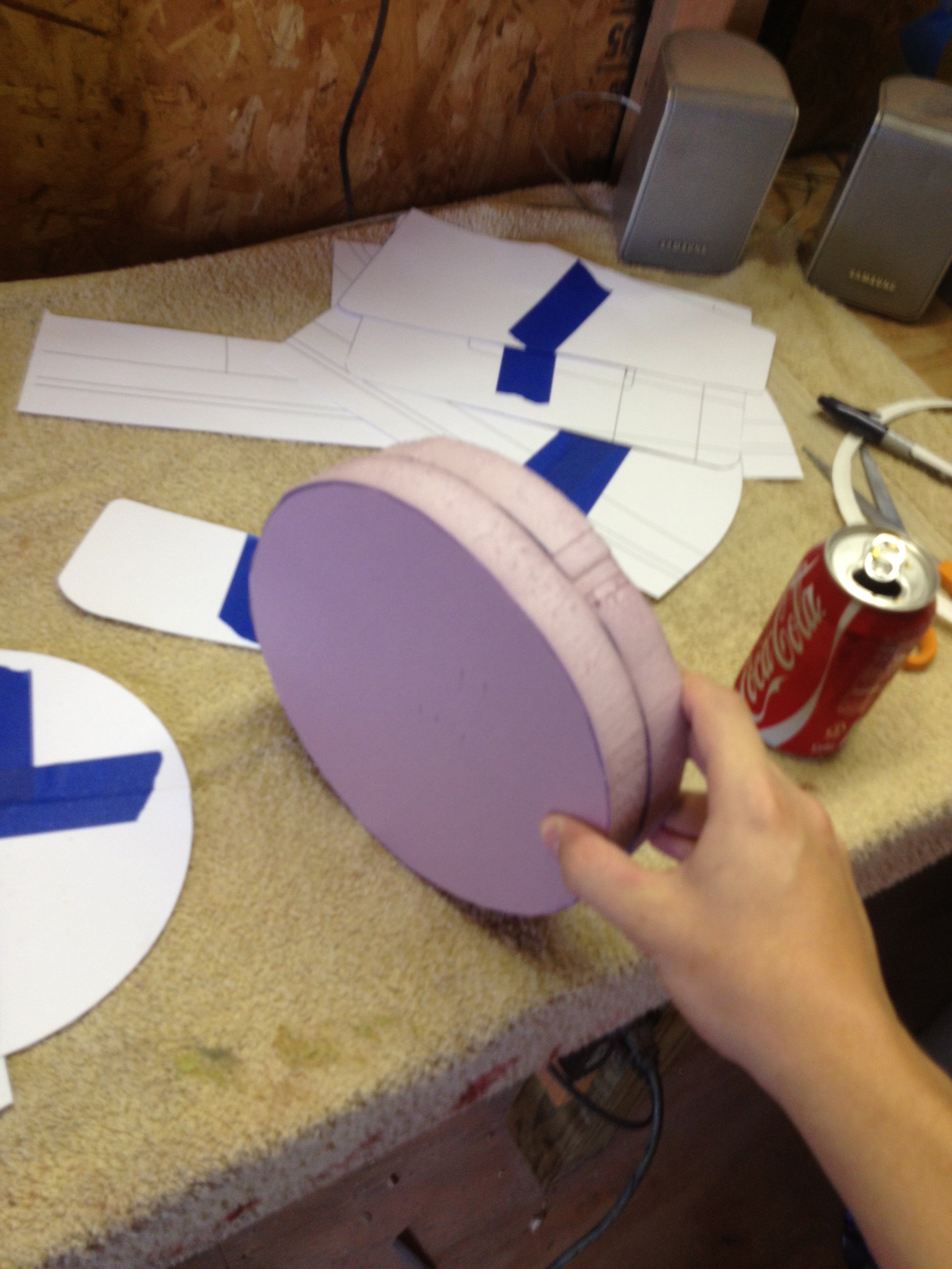

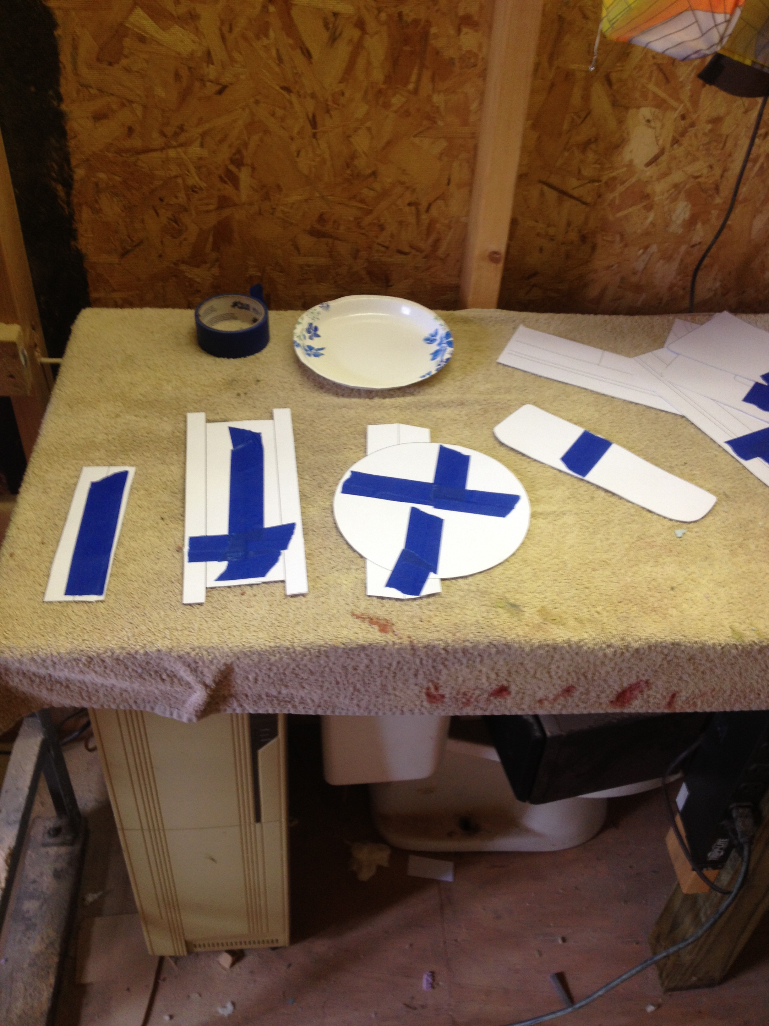

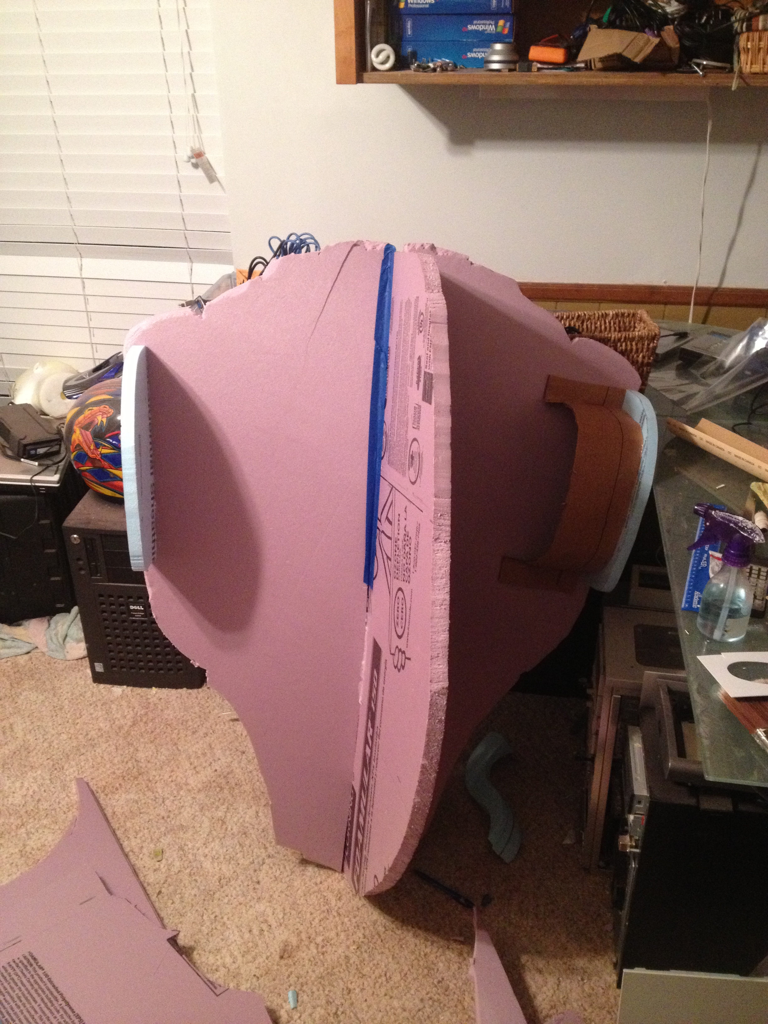

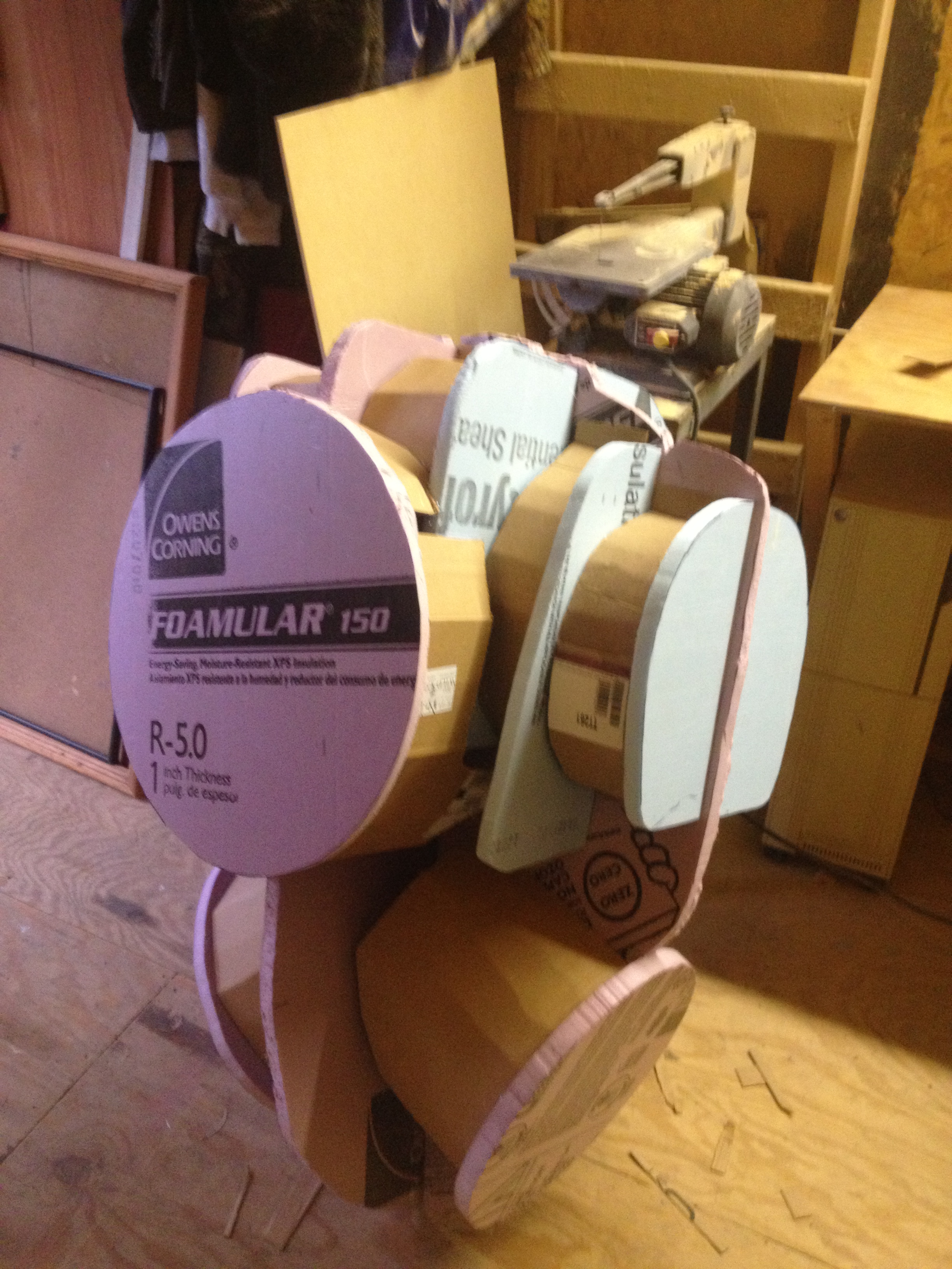

the first step i did was to make sort of a scaling frame skeleton? thing. it was made out of insulation foam board and card board, using volpins blueprints of cores

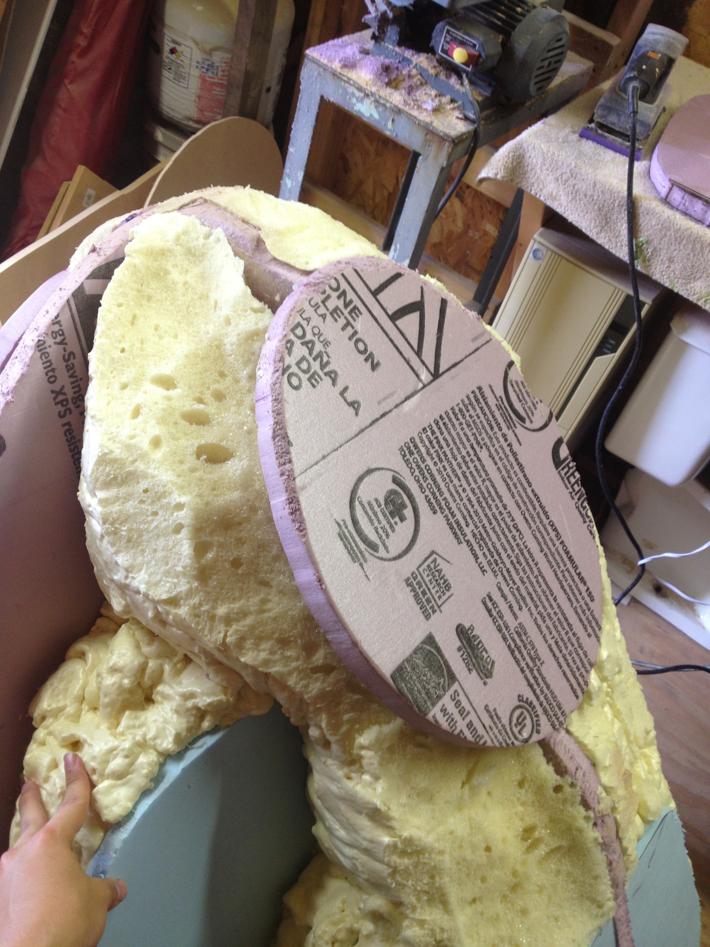

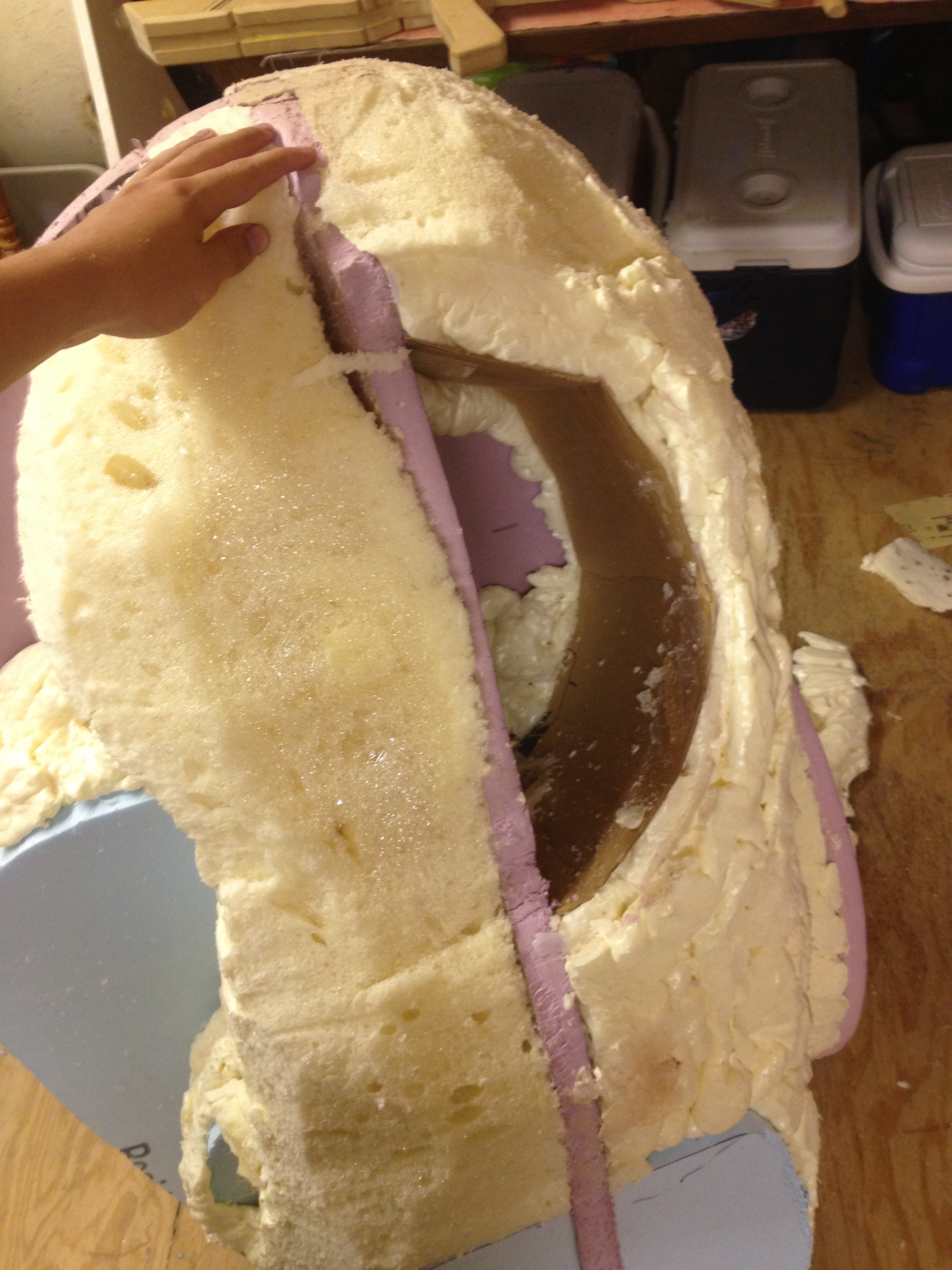

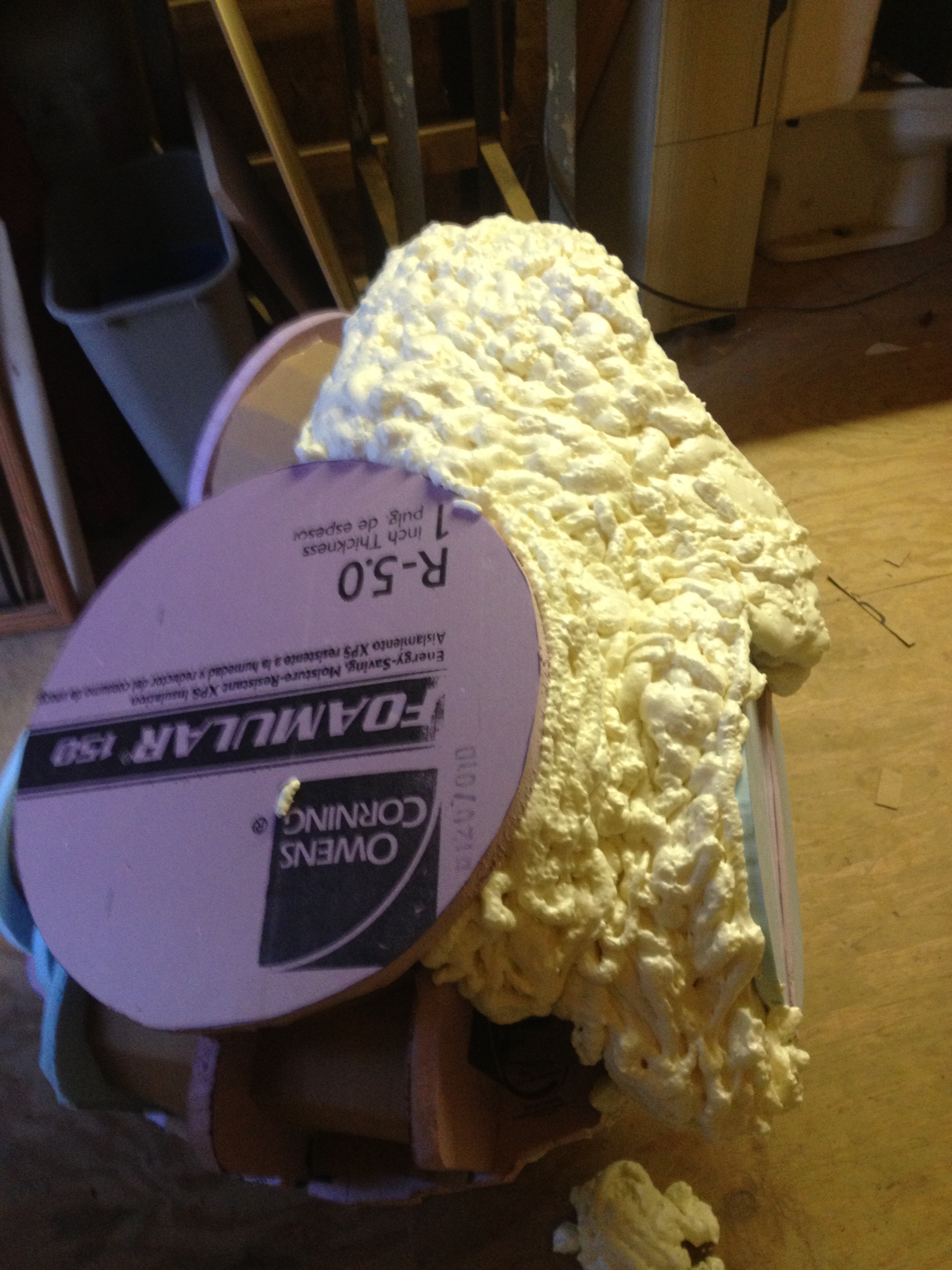

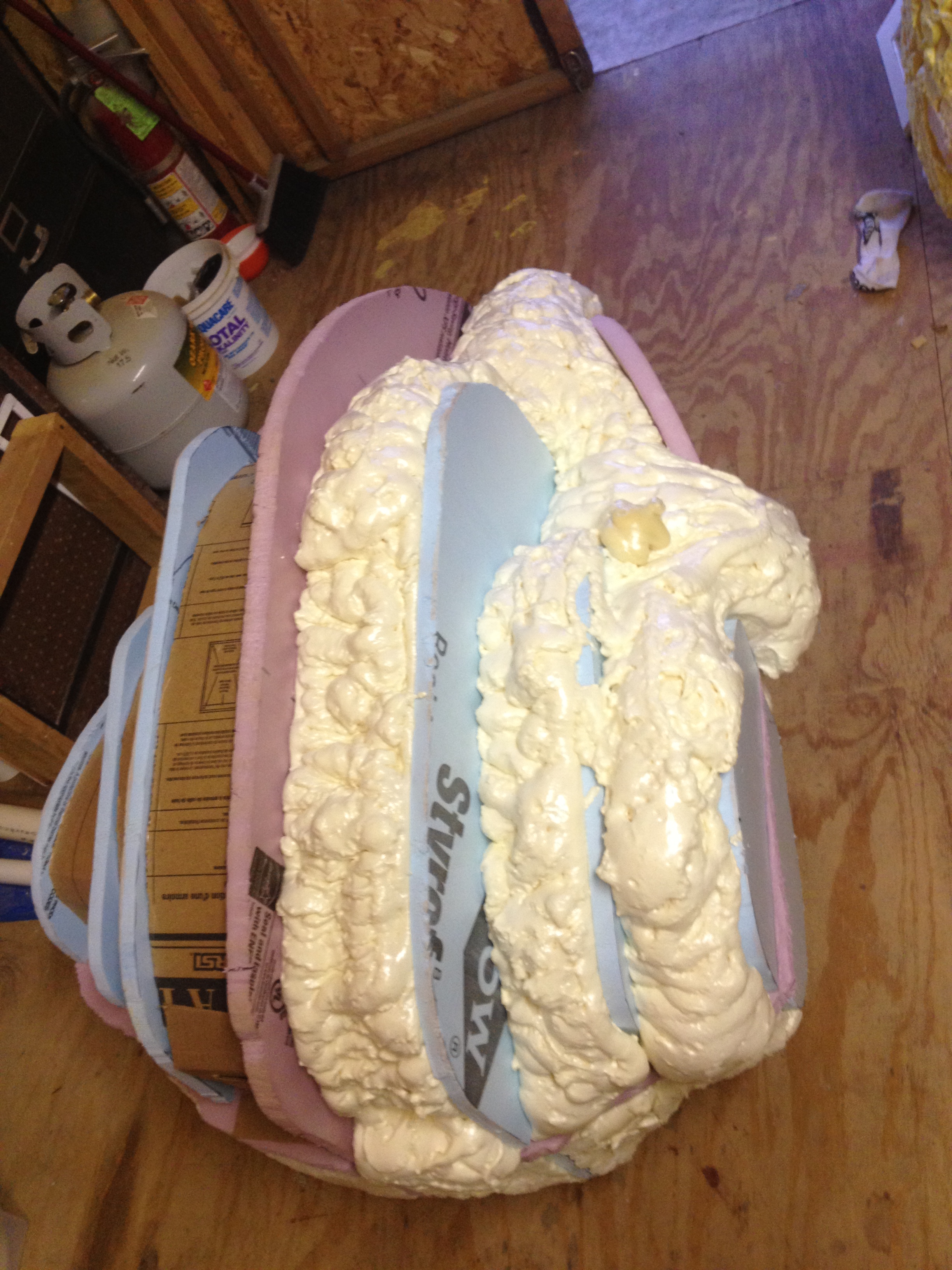

the next step was to spray expanding foam in those empty cavities. there was alot! of expanding foam, so much im still needing some more. but until then ill show you what i have so far
i finally got some more expanding foam to do the other side
the left side needed some more filling
the right side needs some more filling

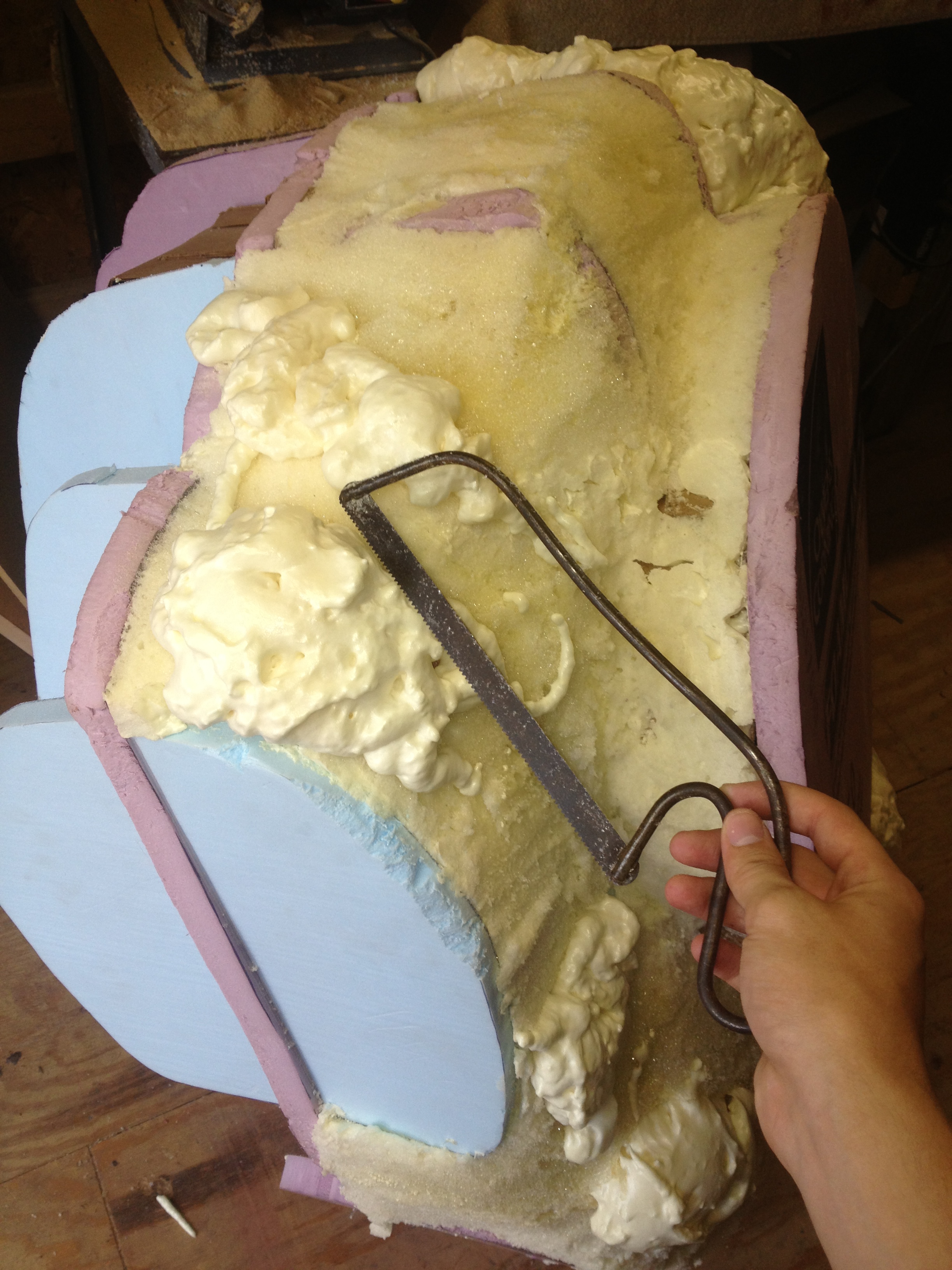

i found a scary surgeon knife in my shed, who knew its good for carving foam

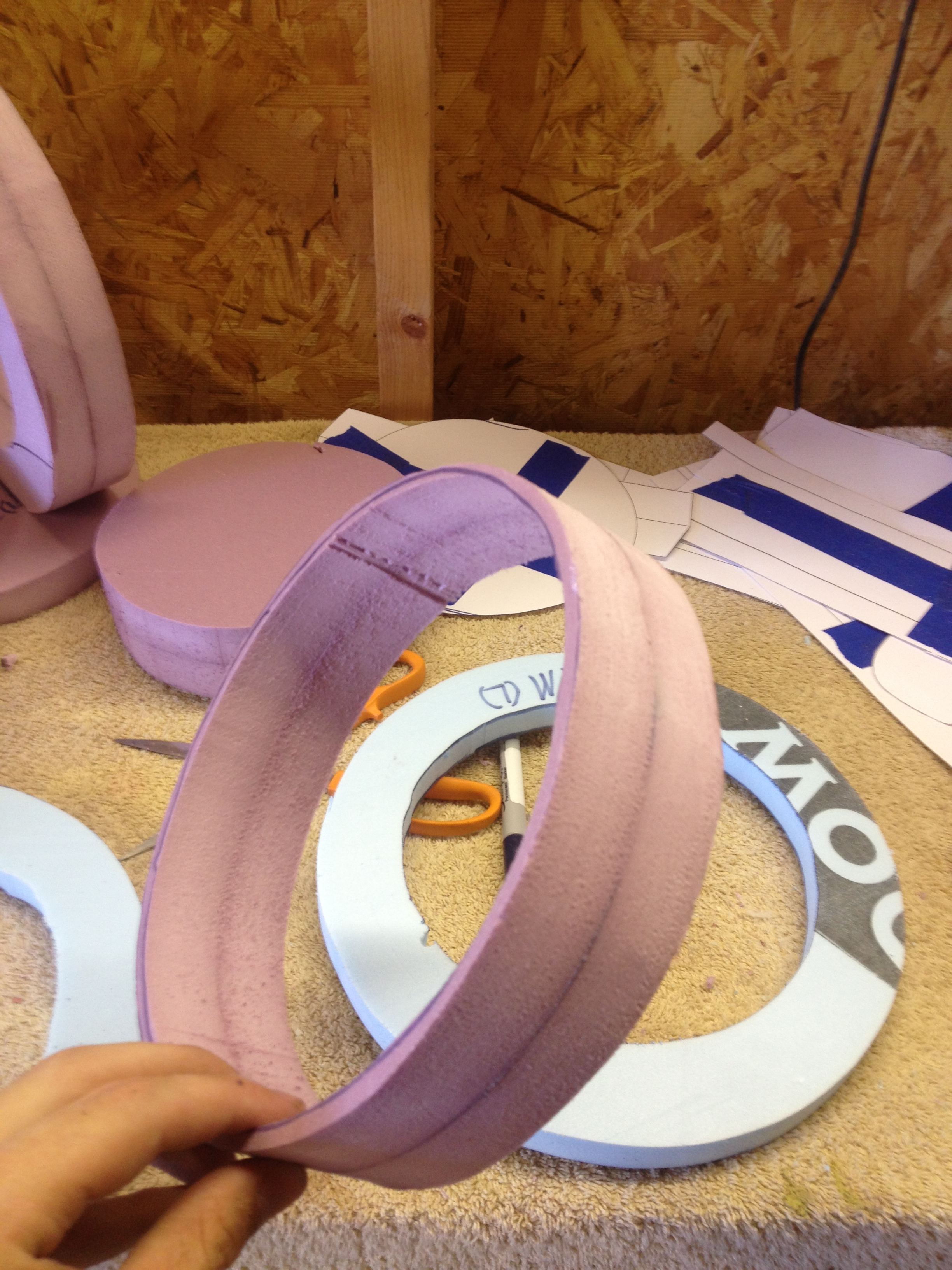

i started cutting out volpins plans

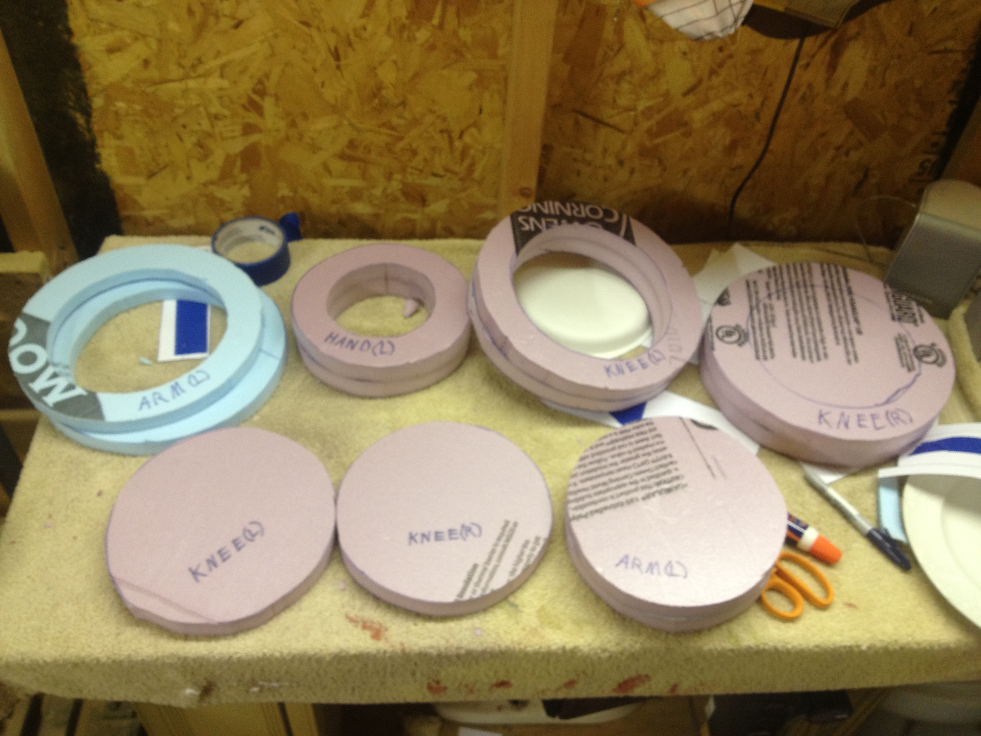

then i started cutting the peices

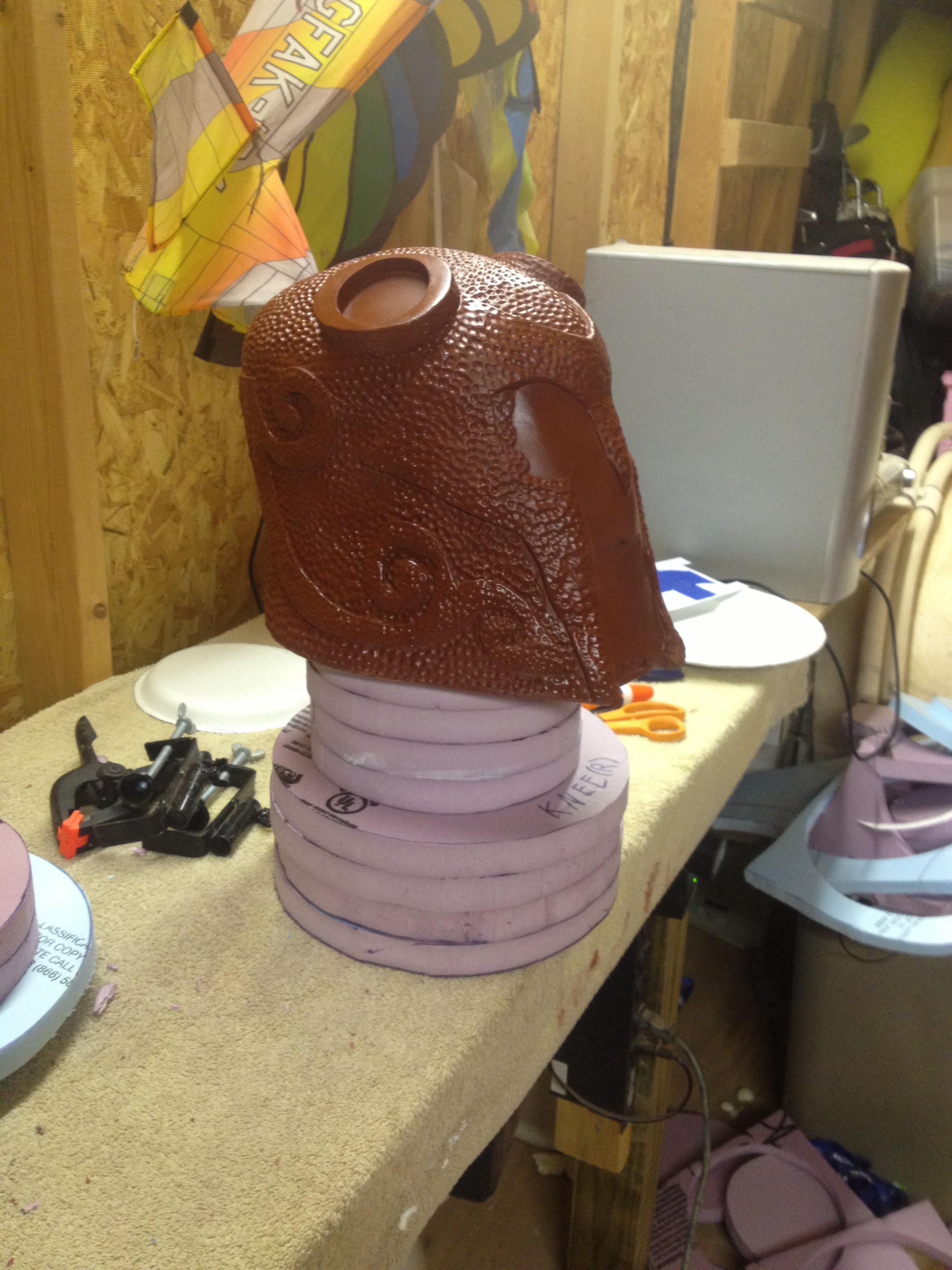

i had to glue some pieces so i used my skyrim mold to add weight

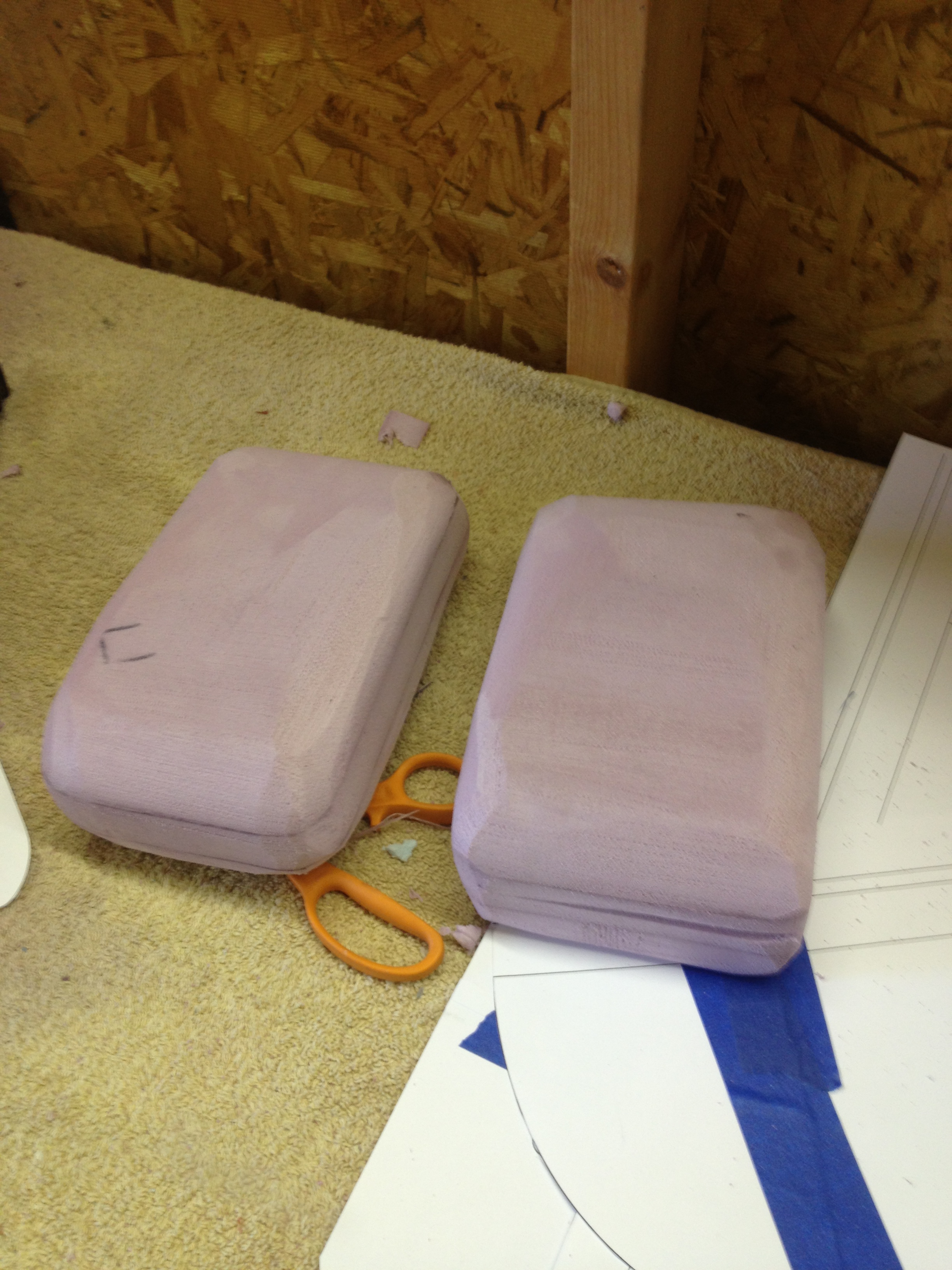

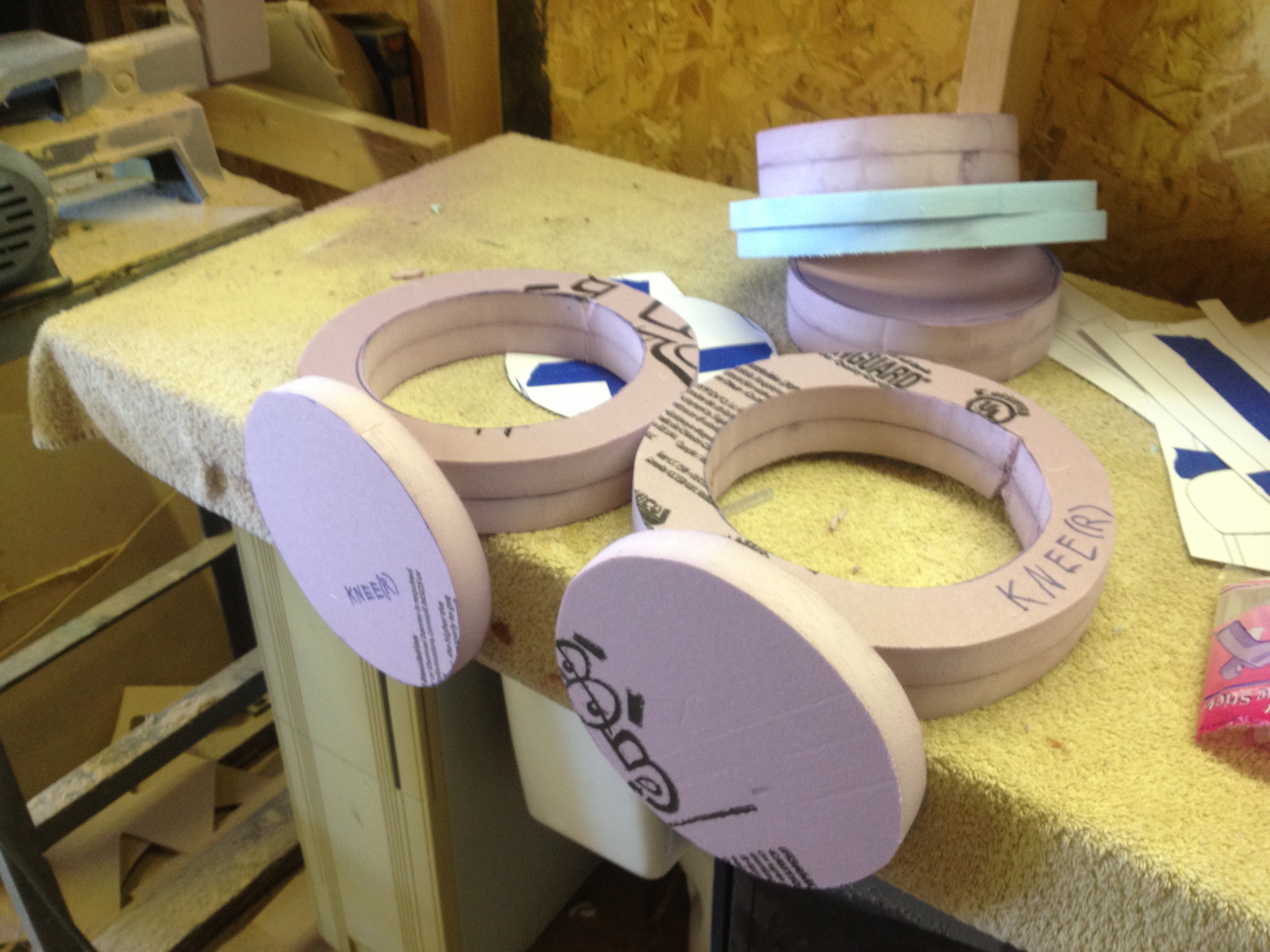

when all the pieces were dried i started sanding. i used my belt sander to make each piece even
then i glued some pieces together. these are the knee pads

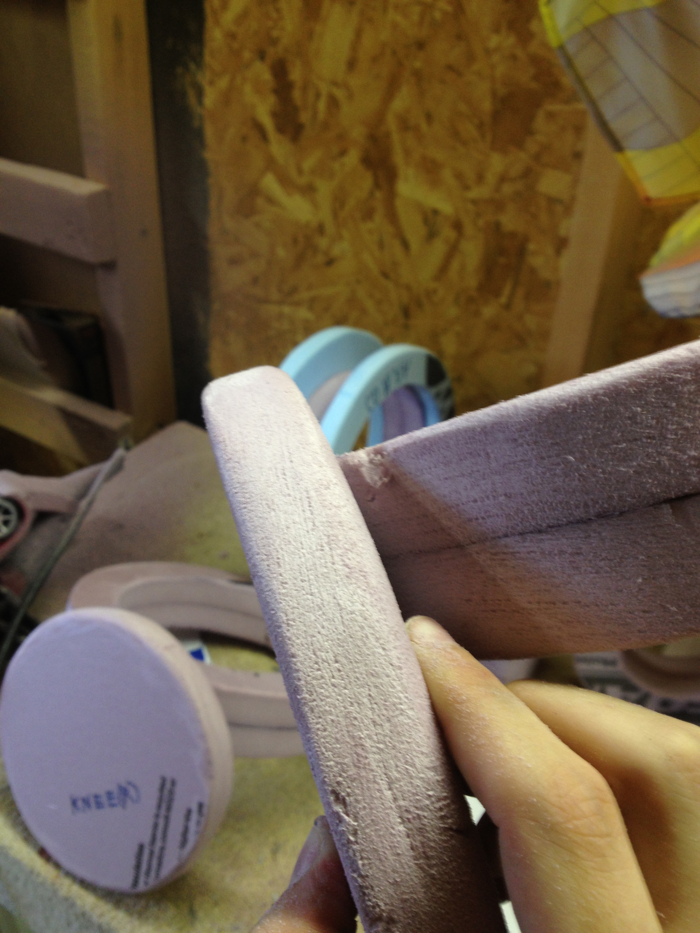

then i started making the piece that goes on the arm it took some trial and error but i got one done
i also started working on the side packs that big daddy wears on his belt
i sanded down the eges to give them i nit so new look to it

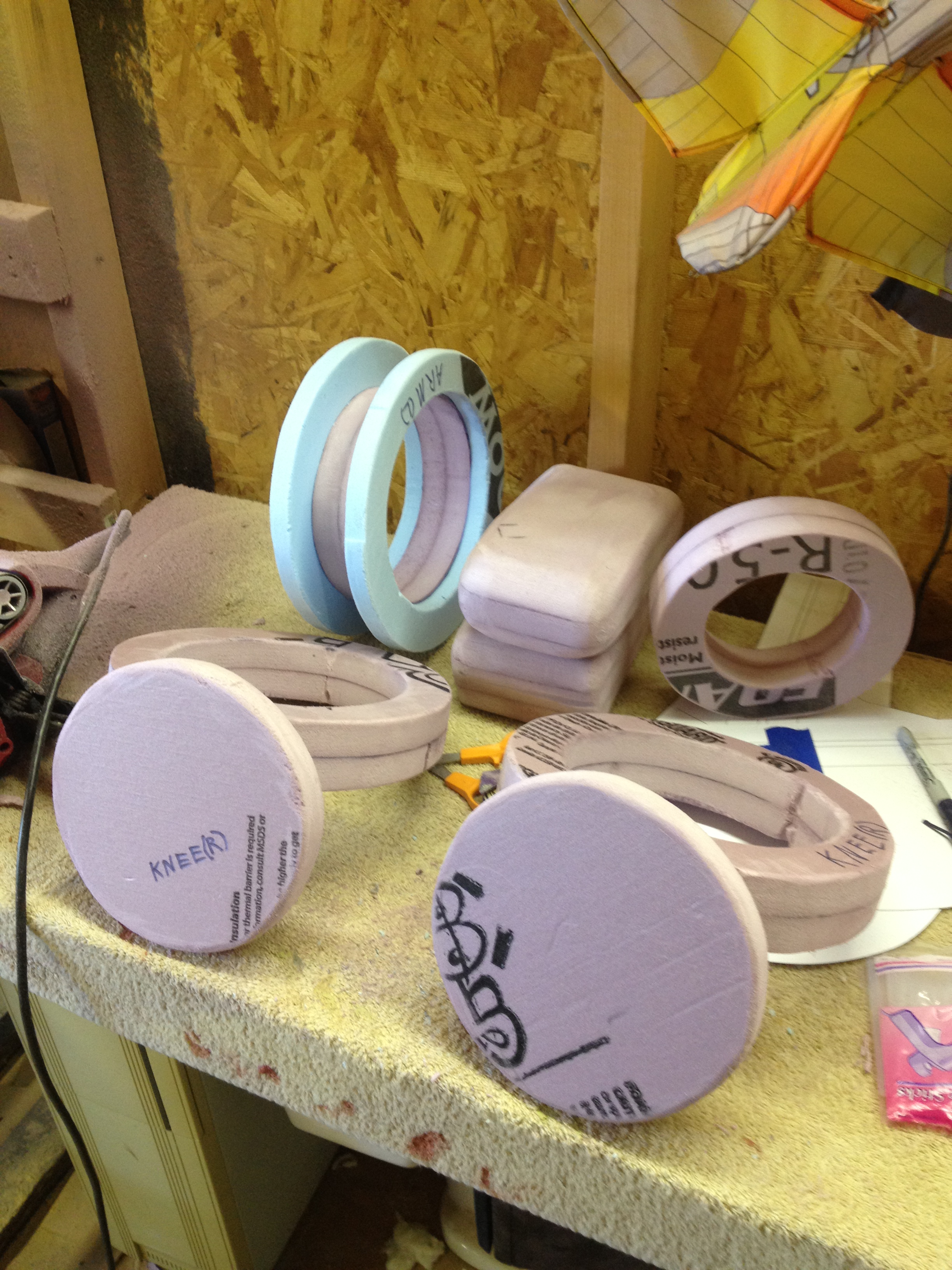

these are all the pieces ive made i will need to make more but i ran out of foam board and im going in vation in less in a week so ill update soon after that

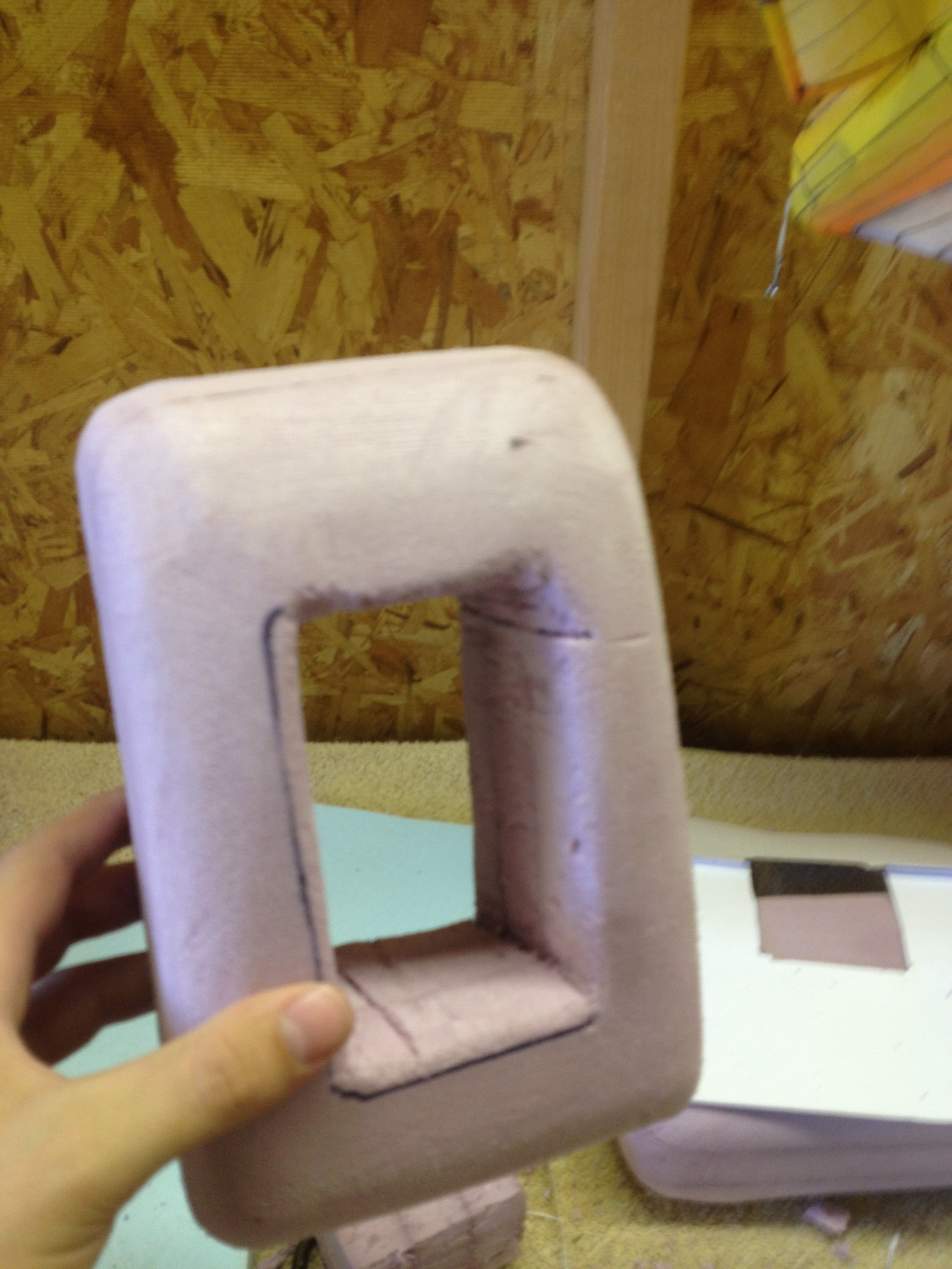

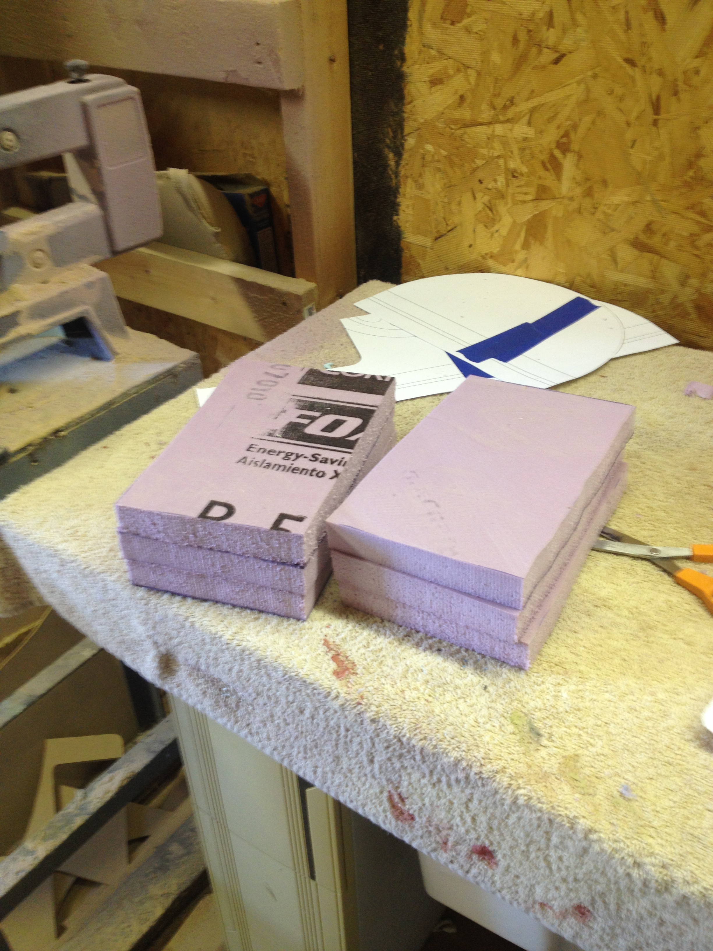

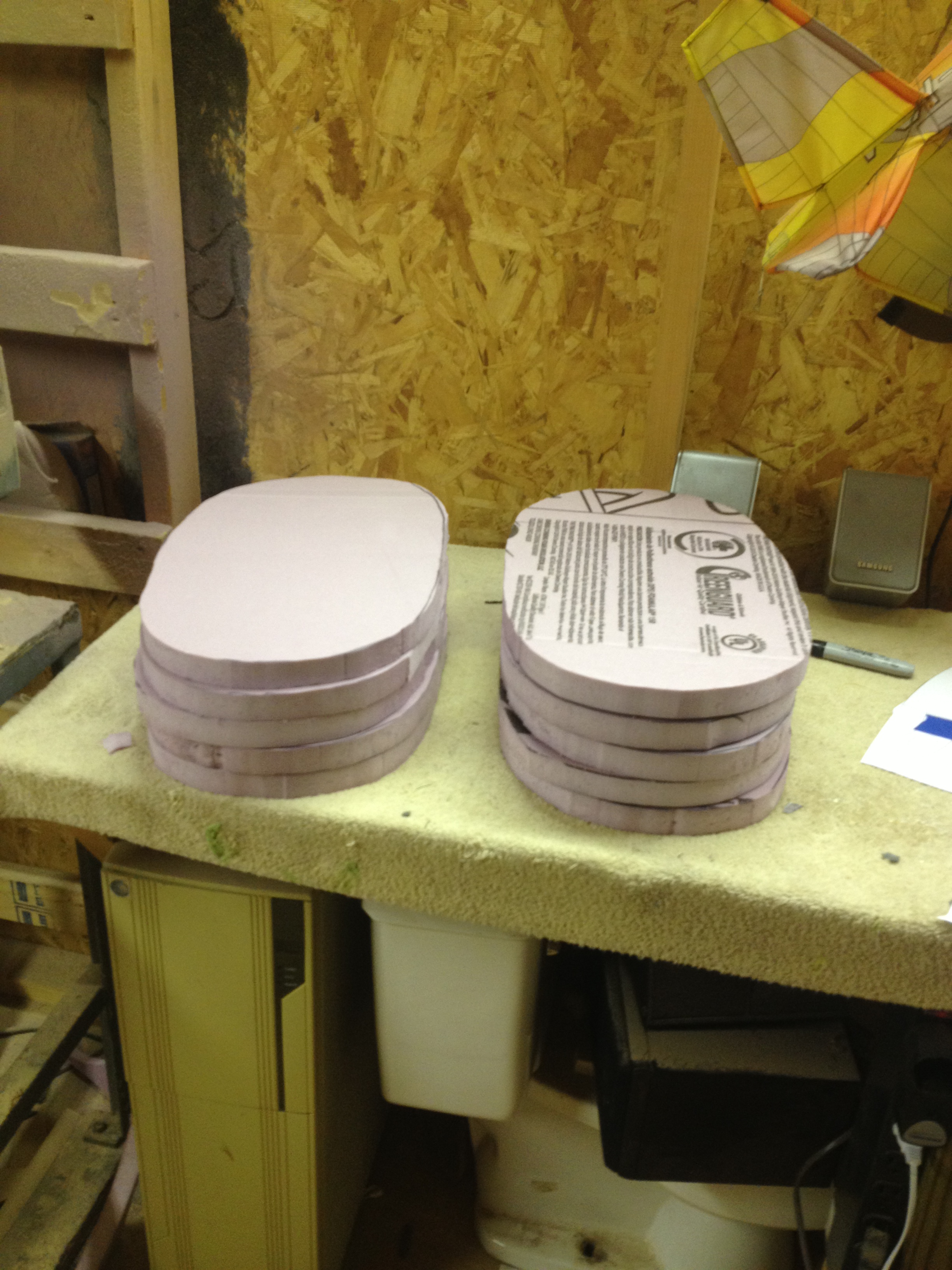

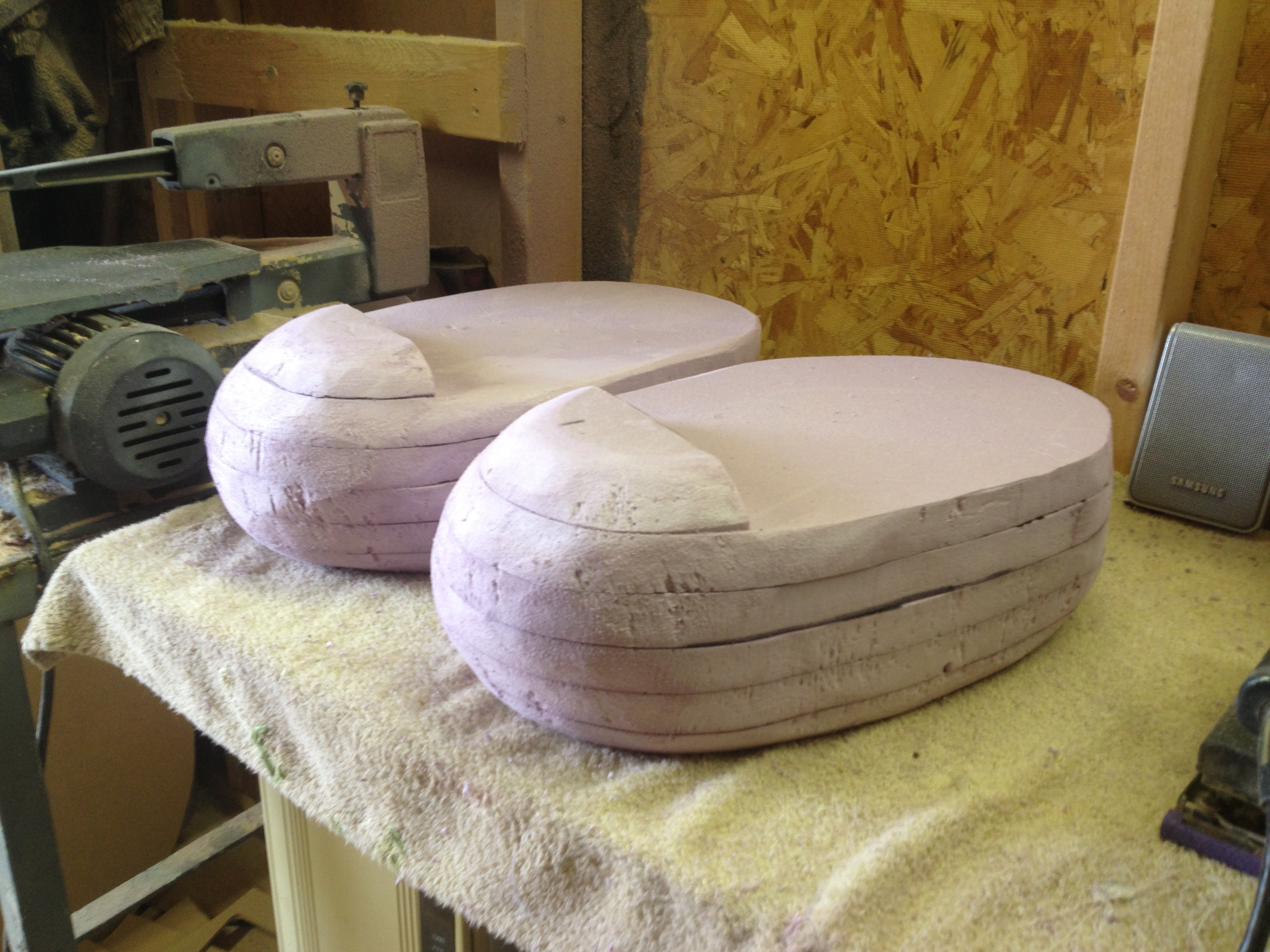

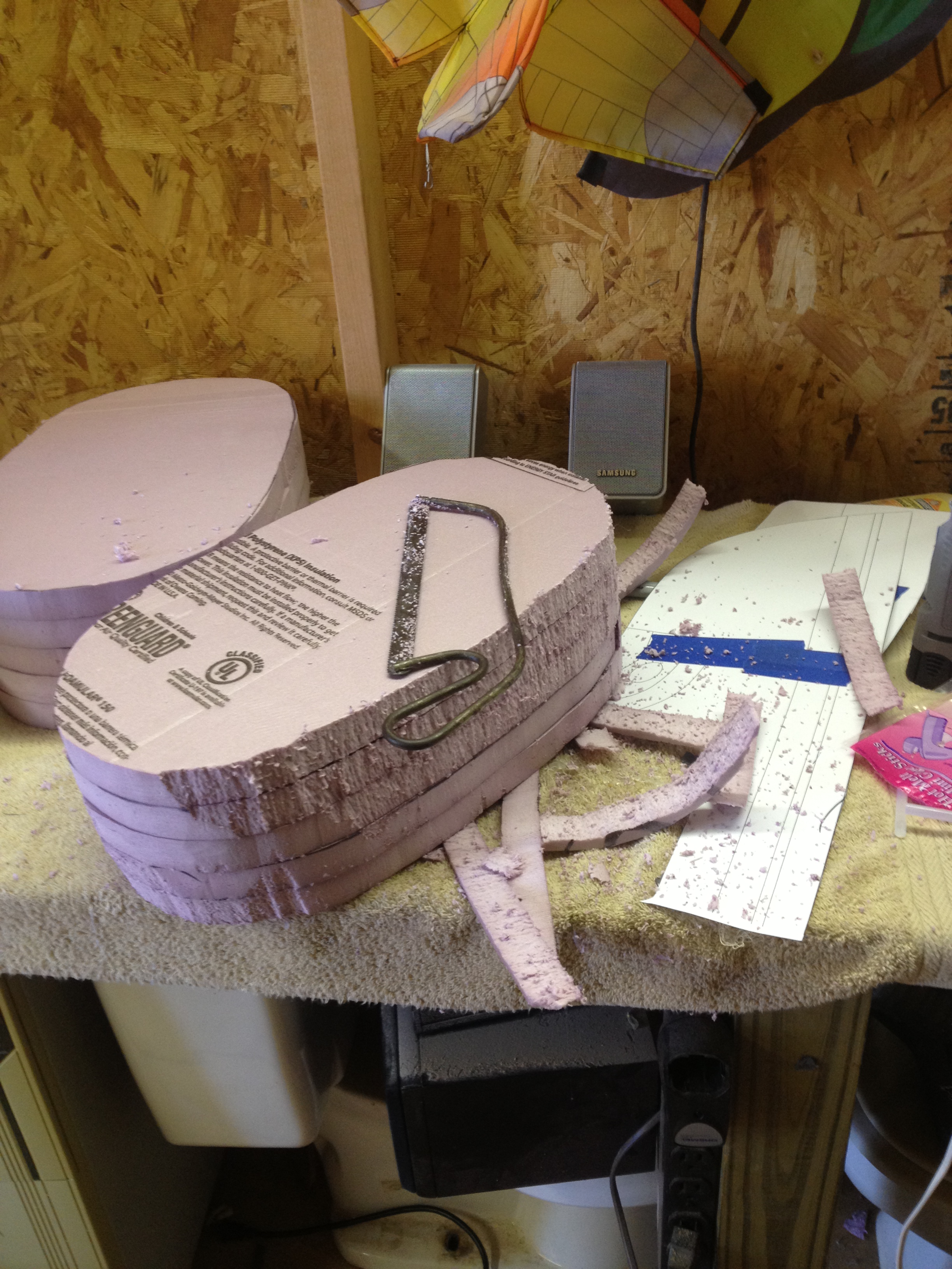

so after that mess i started working on the shoes using insulation foam board
alot of carving
facebook.com/slaydogprops
Re: Bioshock big daddy costume
Looks great so far, just be careful you son't make the soles of the boots too round, you still want some traction and support!

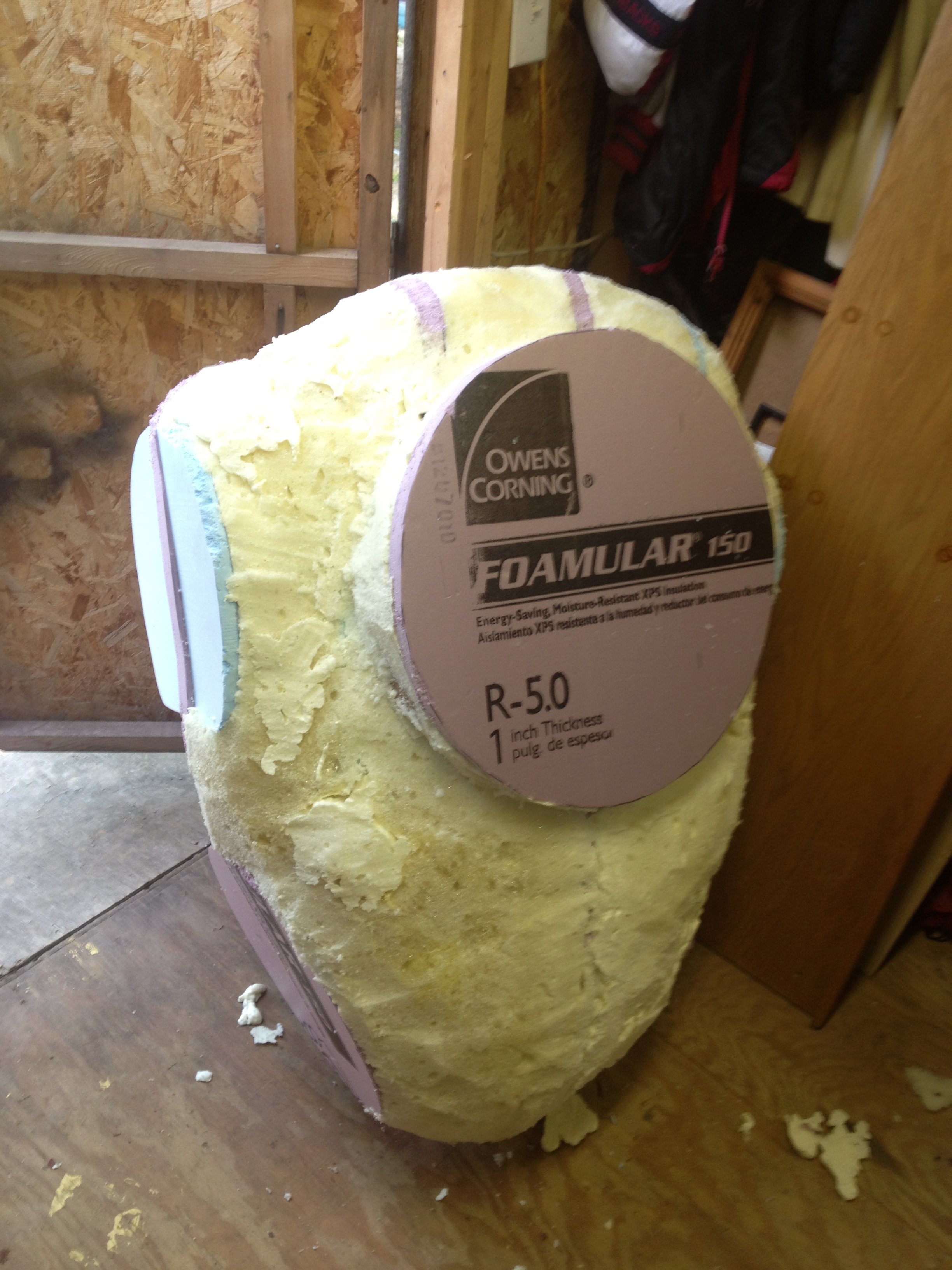

I added more foam to carve out the main body
After the main body was sculpted i covered the whole body with some stretch fabric
Then i added some accents on the legs, arms , and the top of the form
Then i coated the accents with ureshell then the whole form with fiberglass resin
Then the seem lines of the fabric was covered in spackle

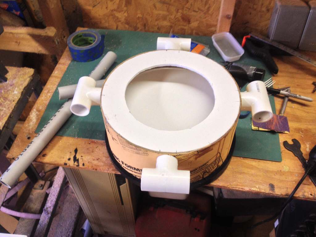

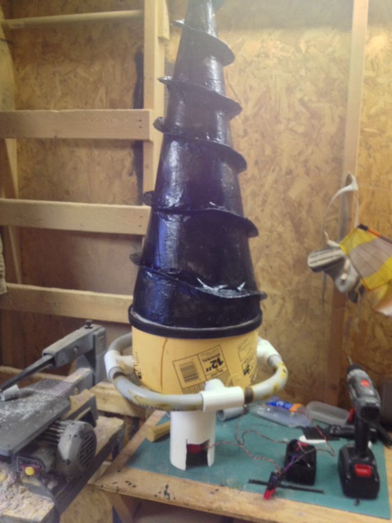

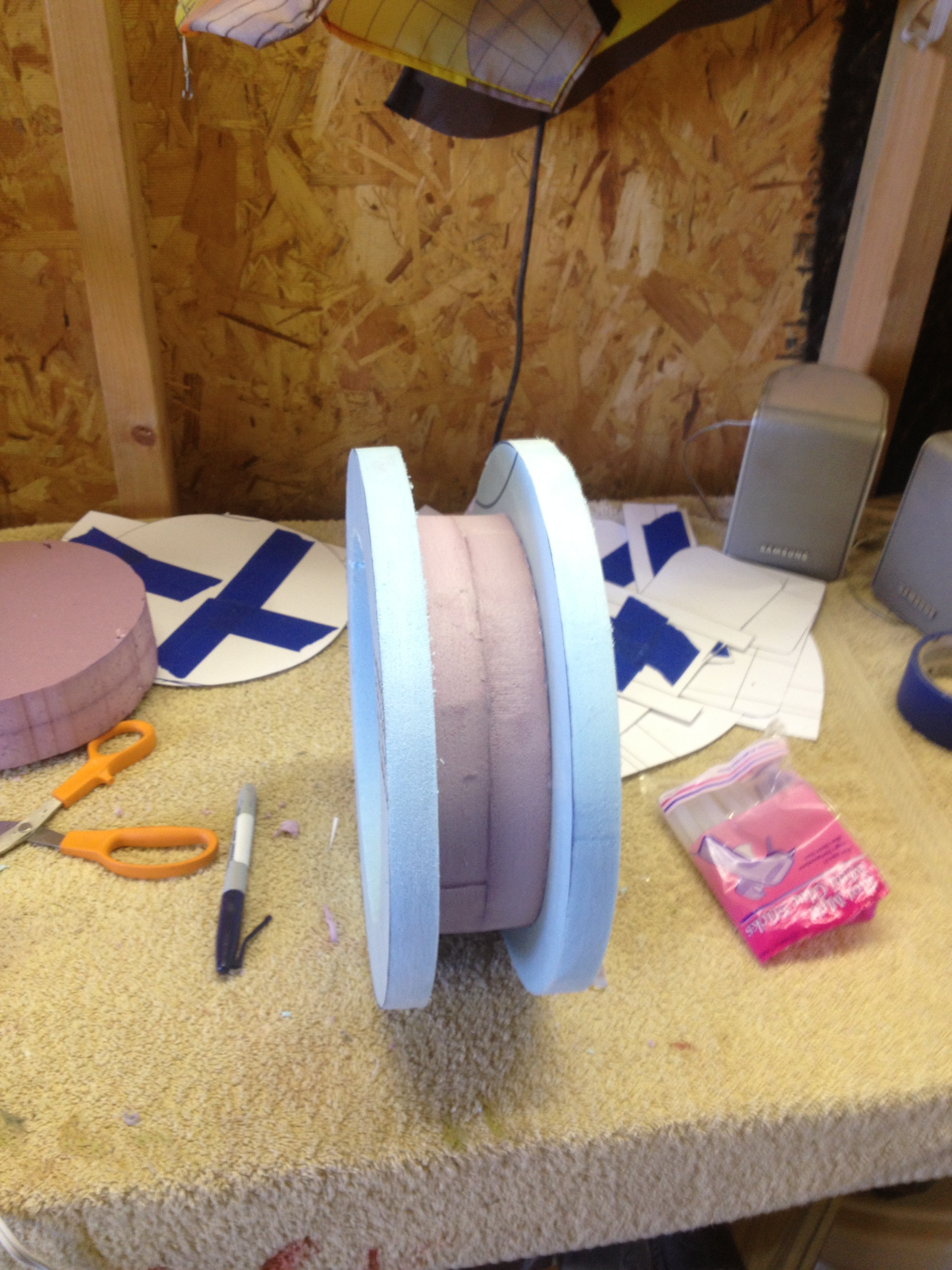

For the dome I found a 20 inch acrylic globe on amazon then i cut it in half the added the ring out of foam
Then i started working on the portholes. Since i dont want to make 8 portholes and it being a weight problem i started making the master mold. i started with pvc pipe, styrene and some mdf

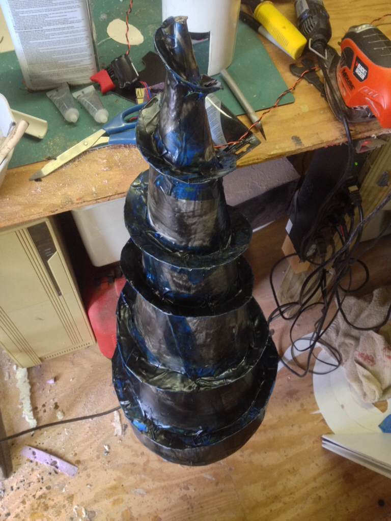

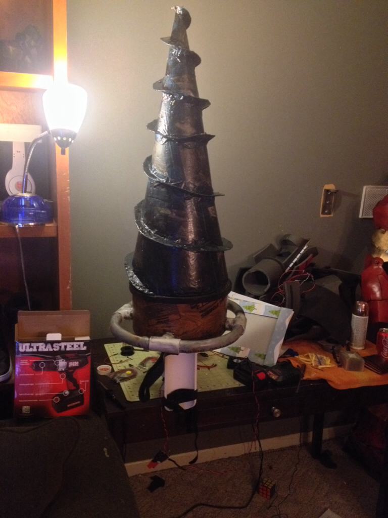

And i thought id work on the drill as well
I started with some poster board with a rod in the middle
Then glued some insulation foam and expanding foam
Then covered in cardstock and the blade also made in cardstock
Then added some masking tape to the blade
Then coated in resin
I coated the drill about 3 coats to make it more rigid and it seems to be durable

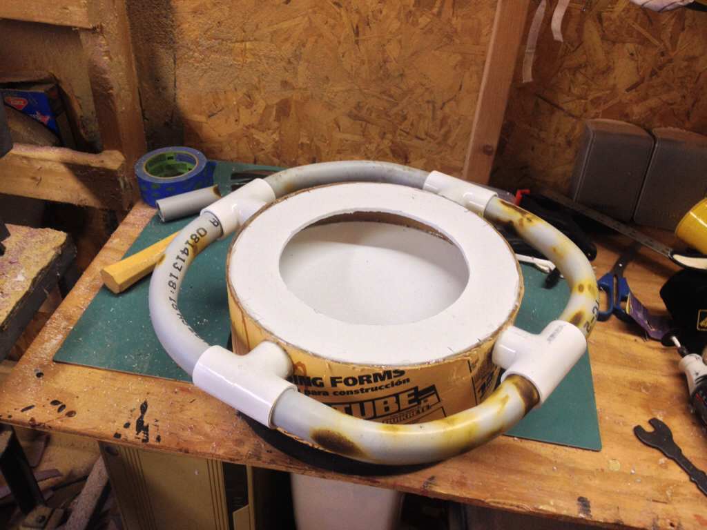

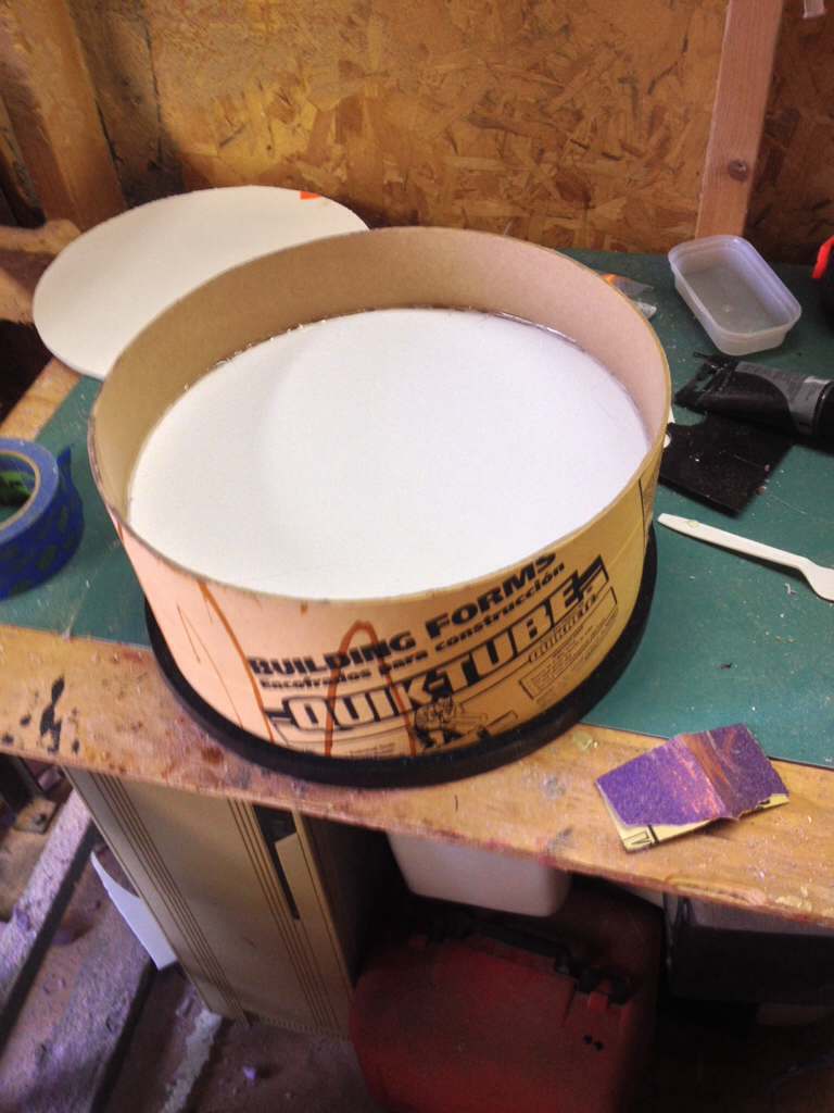

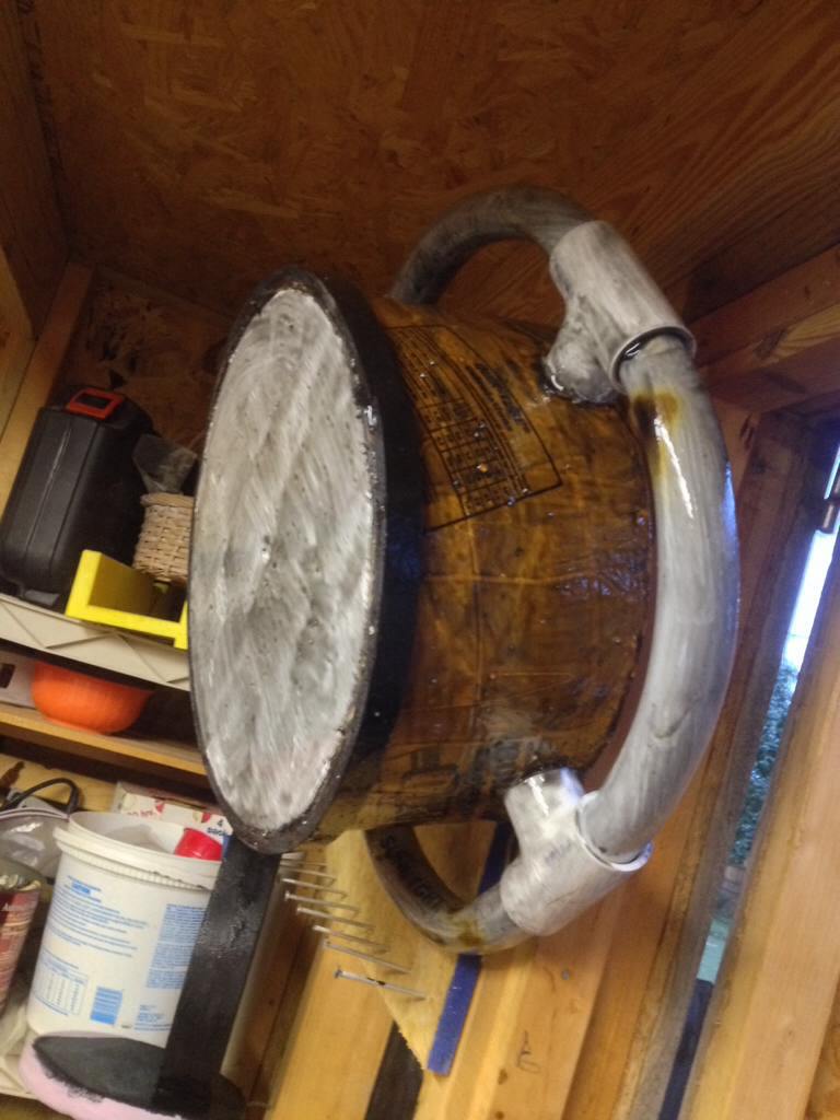

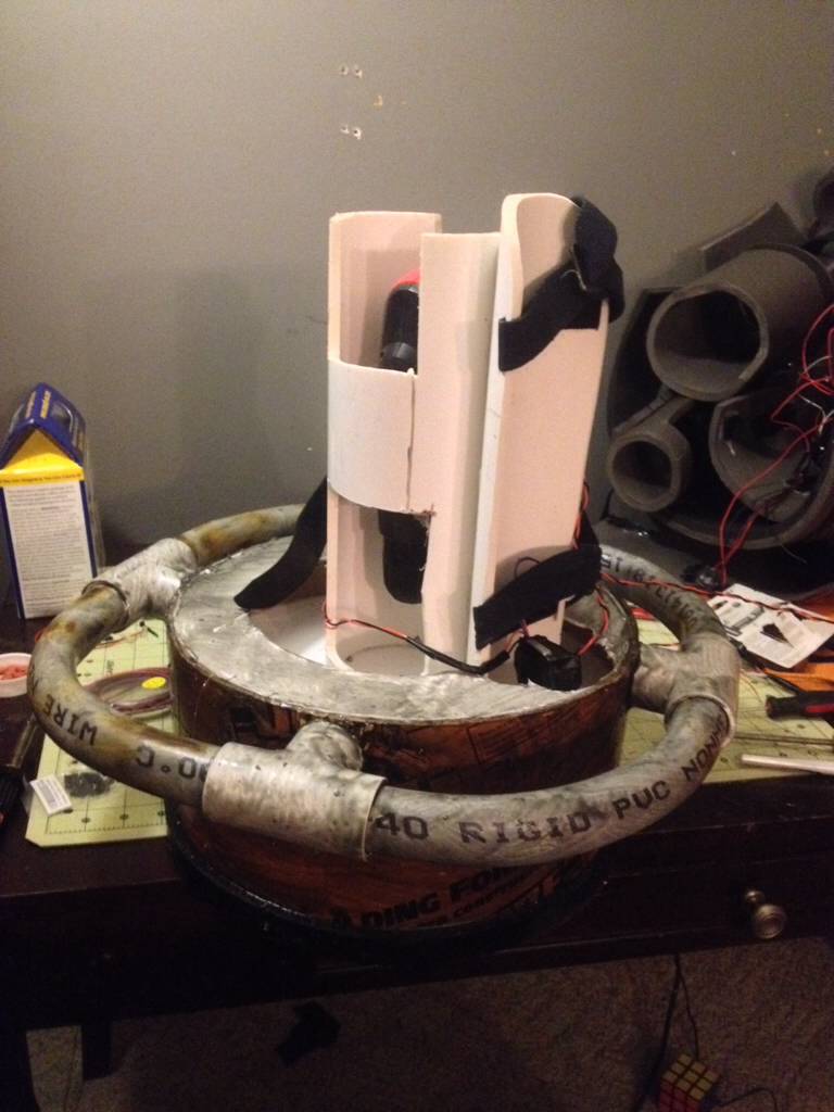

And then i started on the base which is made out of concrete tube and some detail with foam tape and some foam board glued in side
Then i heated some conductive pvc and some Couplers
Then coated in resin with sawdust and other particles mixed to add texture

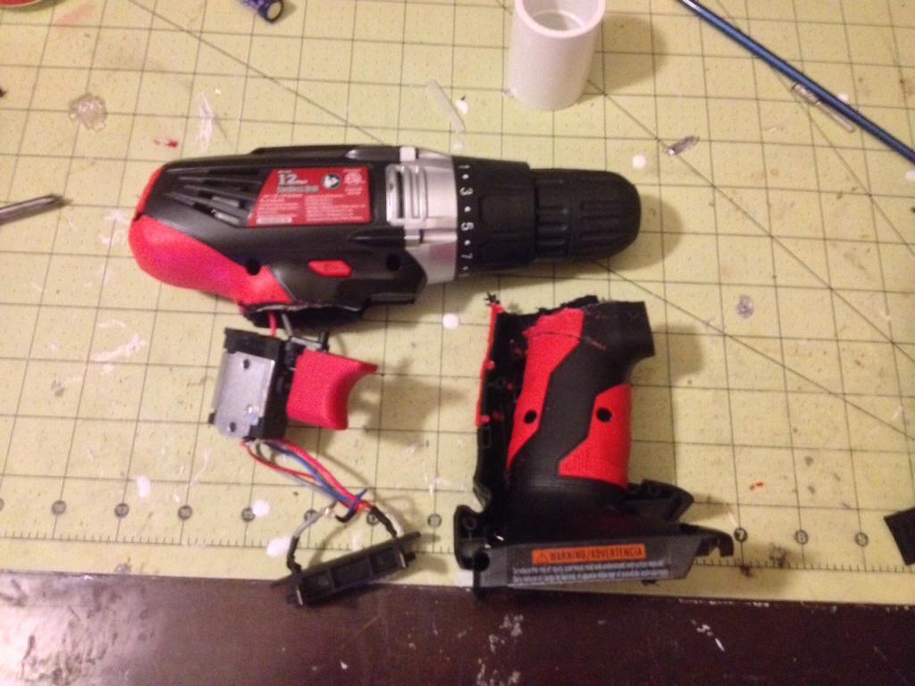

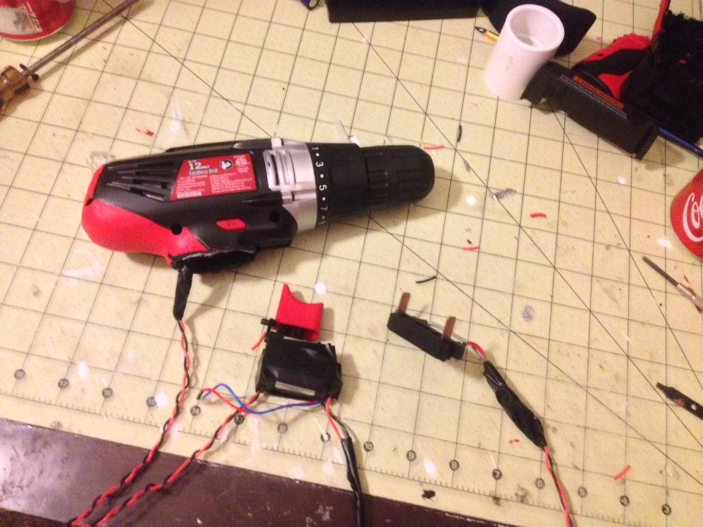

To make the drill move i end up using a cheapo 12v drill i found for 20$ but i needed to mod it a little so i open it up and i cut the handle out and added more wire on the trigger and the battery clip
And then i enclosed it in 4" pvc pipe and added a strap thingy to strap my arm on
Its not as comfortable as i want so im gonna make the arm strap longer and add a handle and glue the trigger to make it easier to use and more comfortable
But other than that the drill is down time for a mock up
Heres a video of the test run
