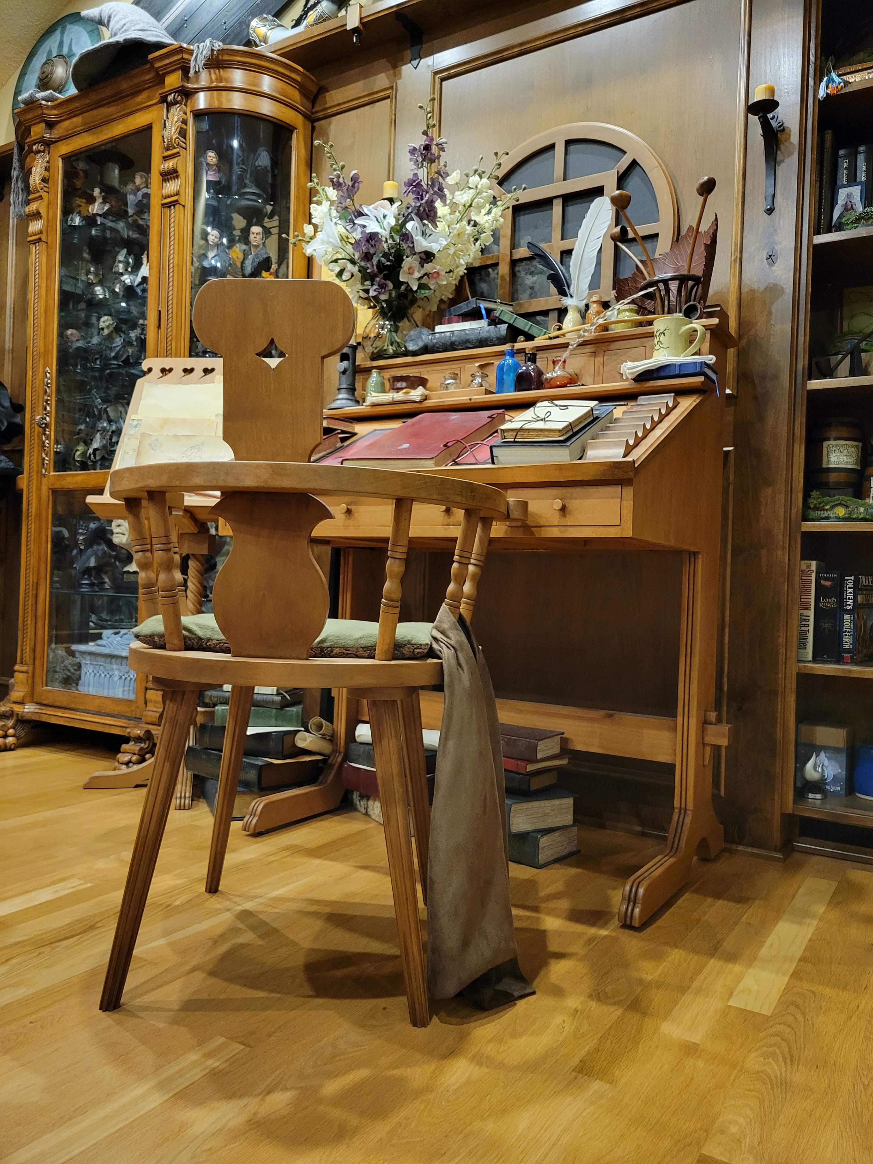

Bilbo's writing desk build 1:1 from LOTR
Thank you!
I found a fellow woodworker who was selling plans here:
Hobbit Writing Desk Plans — bearkatwood.com
I made a few modifications to get a bit closer to the LOTR version of the desk as the plans were based upon the one in the Hobbit movies.
I designed and built the bookstand and chair myself to fit with the desk.

How it looks today. Still just as happy and amazed that I made this thing into reality.
