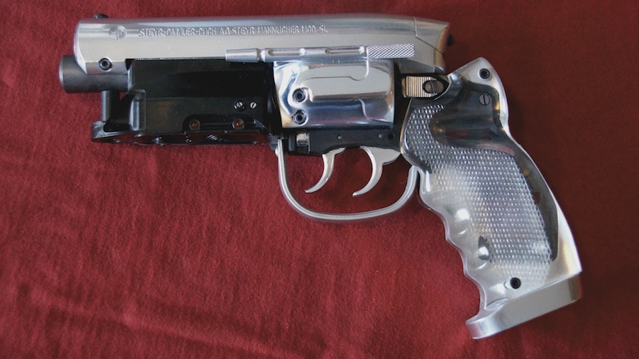

Now silver...that's another story. I've had great results with cheap, rattle can spray paints. I use primer then wait 24 hours to cure. Then a generous amount of gloss black. Wait 24 hours to cure. Finally, any brand of "chrome" silver. I just spray thin coats over three days. I let this cure fore a week. My results are very good and it genuinely looks the part of silver, like a knife blade. Thin layers of silver over a few days and letting the whole thing cure for a week is key. It keeps the silver from being tacky or rubbing off while handling. Under NO circumstances should you spray any type of protective coating or clear coat. It will immediately turn grey.
