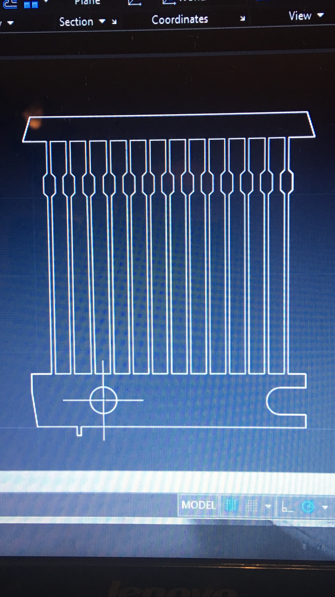

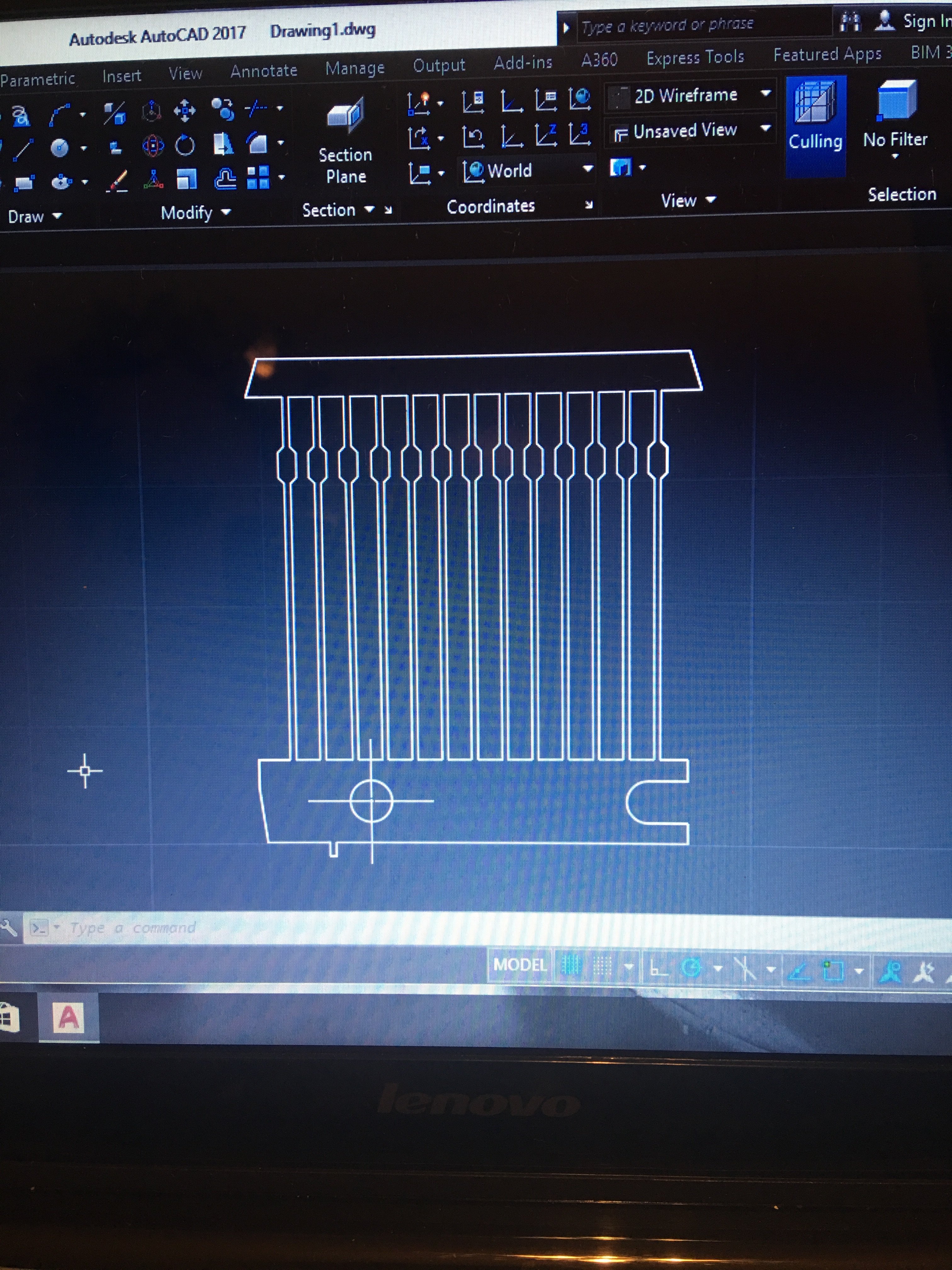

Been very busy at work but I had to find time to play a little drawn up on autocad the vocoder part
I will try and send it off to the photo etchers for a price on Friday if I've time
input please does does this look ok ???
For those who have one of these, before I get in touch with the photo etching company what would you say on the correct thickness ??? looking at it I would say no more than 0.5 mm they have stainless steel and nickel silver they also have brass but I want to keep it a natural metal colour so not to add more work having to paint brass
imput please on thickness and metal would be appreciated
thanks
Good work my friend!That looks awesome!
It is very,very thin...I would say not more as 0,3mm.And it is not brass.I would say as it was new it was like nickel silver.Now about over 30 Years its still silver but not more so shiny.;)
Ok so I've sent them the cad drawing 0.3 thick on nickel silver all I can do now is wait for the quote back fingers crossed it's not too expensive or it me and you splitting the bill :lol

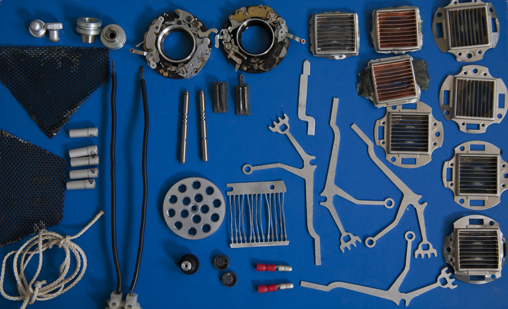

I totally forgot I already have this part ... oops sorry ... still I'd like to share the picture of all my Reveal stuff ... makes it easier to see what's still lacking :
The dynodes have been replaced with the proper copper ones from sskunky :)
Chaïm

Yeah I received a lot of spare parts with the mask from Reel Fakes . . . here is his second build : http://www.therpf.com/showthread.php?t=190863 . . . still need to find or purchase some more parts from you . . . I'm just waiting when you have all those parts I seek, which are hard to find in the wild, to purchase in one buy :)
Chaïm
what other parts are you looking for ?
I'm not at home right now ... perhaps if you have some patience by next week I can measure it for you ... no problemo :) By heart ... I still need those 'ear' parts you made and all those vintage dental expanders in 2 sizes . . . some wires and those 2 metal 'crocodile' teeth or what-ever-you-call-them parts ... and many more -sigh- I'd love to collect them as real vintage found parts ... alas I'm afraid that might be a mission impossible unless your name is kurtyboy :wacko

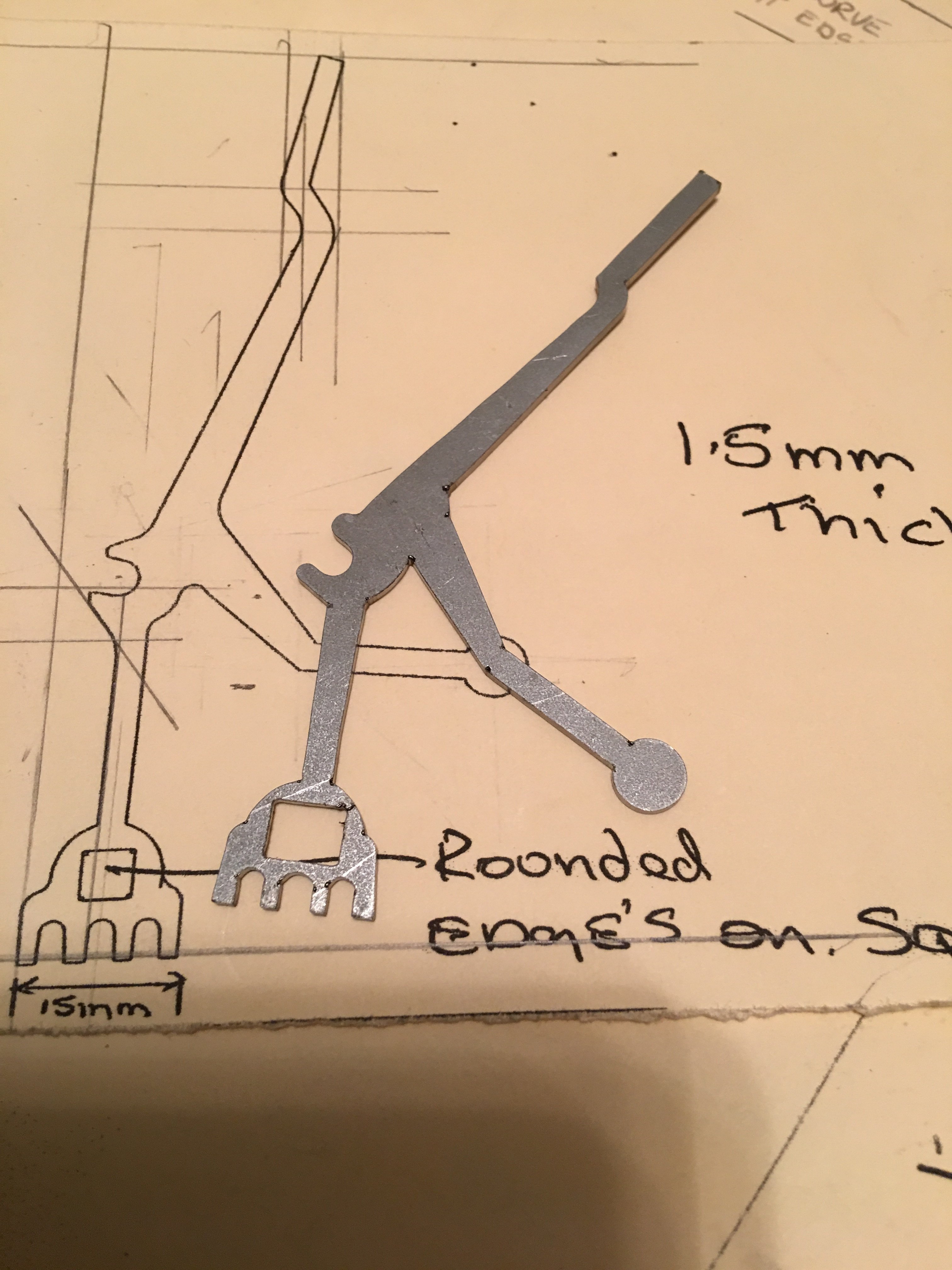

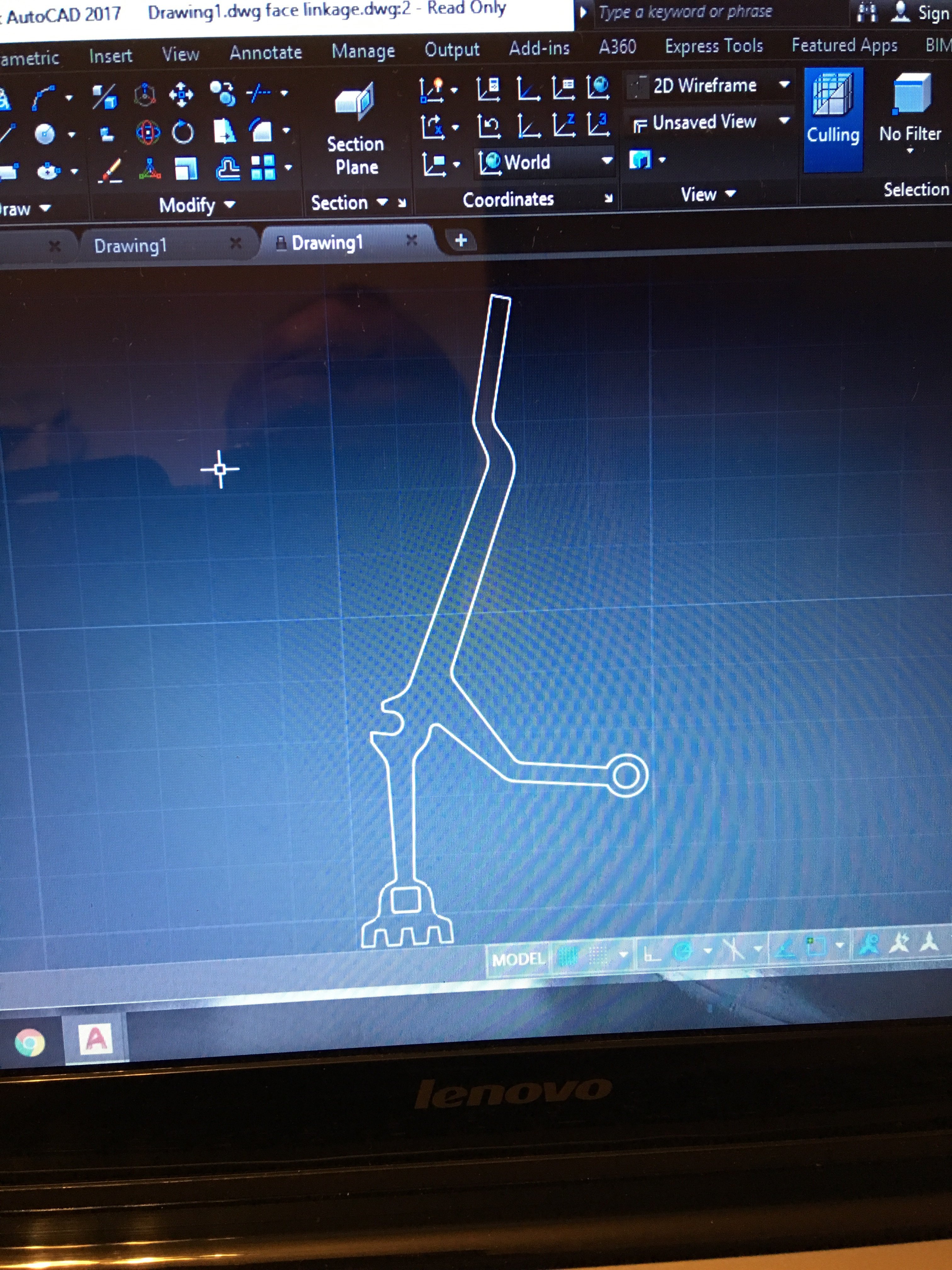

im having a little trouble drawing up the linkage on the reveal mask
I've drawn this from pics on the internet and other forum pics BUT I'm getting all sorts of different angles from different builds this is the third attempt and I'm going to send this off for a sample cut tonight but what I really need is a flat drawing off somebody who has an original one if possible anybody who has a copy of an original just a drawing is all I need if your willing to share
This was my other attempt
