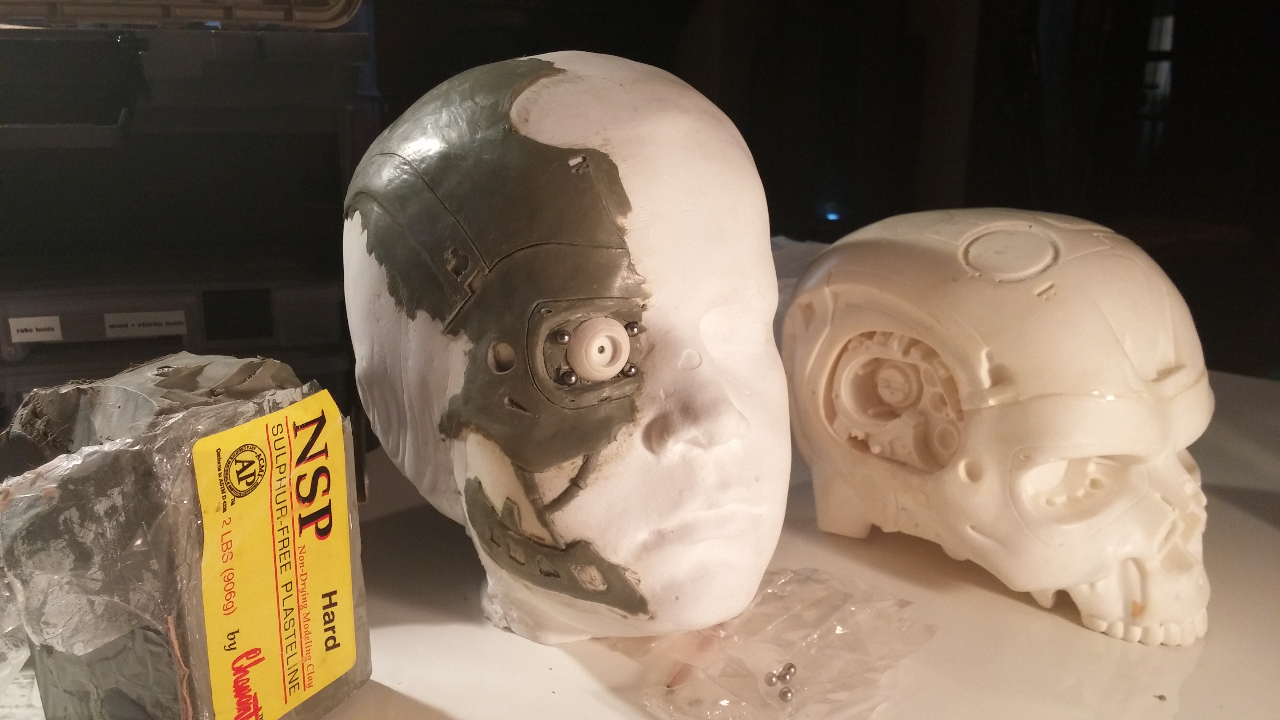

First thing I did was make a life casting of his head then started sculpting the terminator parts to fit only him:
![20141019_101007[1].jpg 20141019_101007[1].jpg](https://therpf-f28a.kxcdn.com/forums/data/attachments/155/155277-5a119c673efe8bc8c6d1a2da6a9894fa.jpg)
