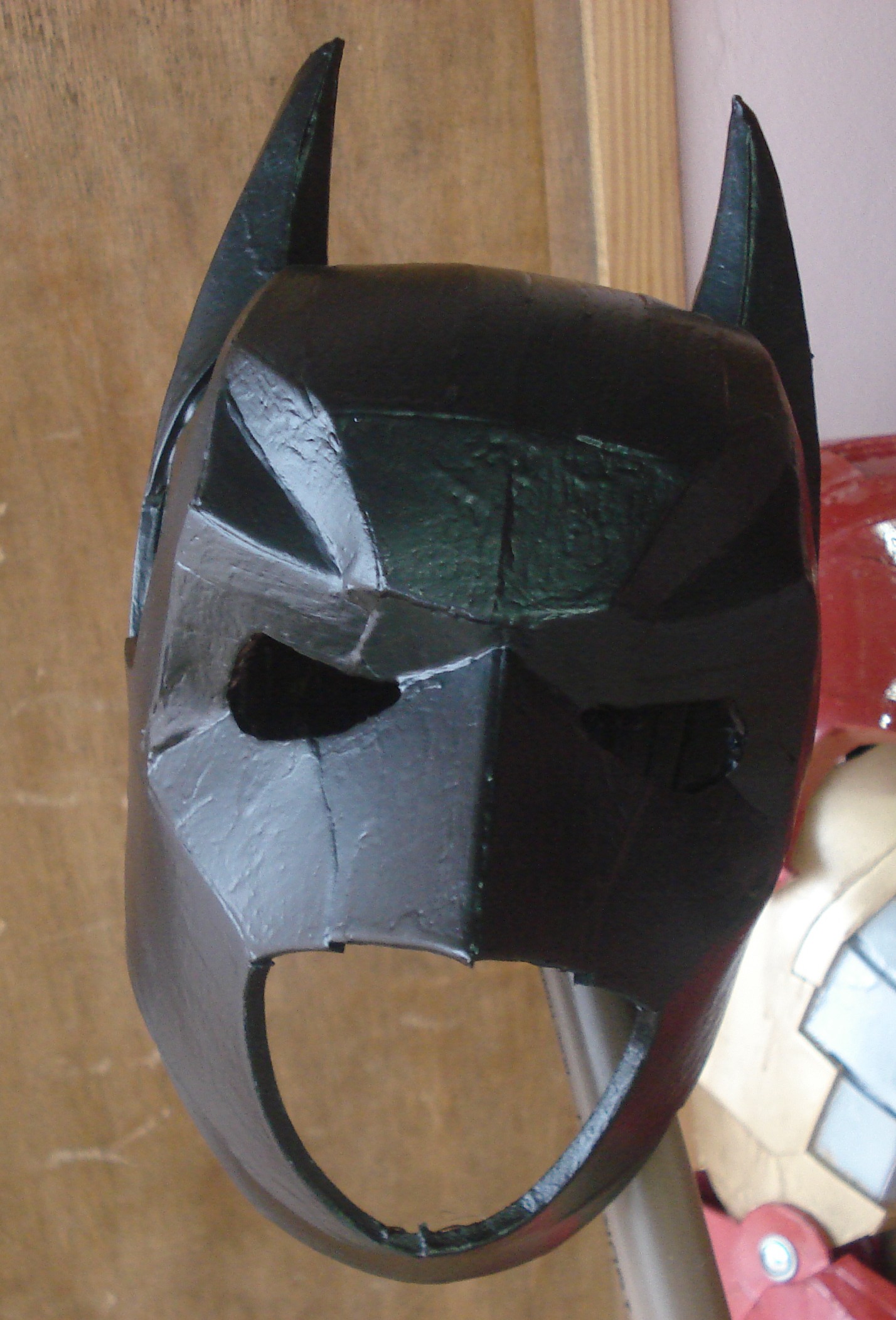

Well, I've been working in the cowl, and tried to build it with 2/3mm foam. Here's the result. There's no finishing yet, I'll work on that.

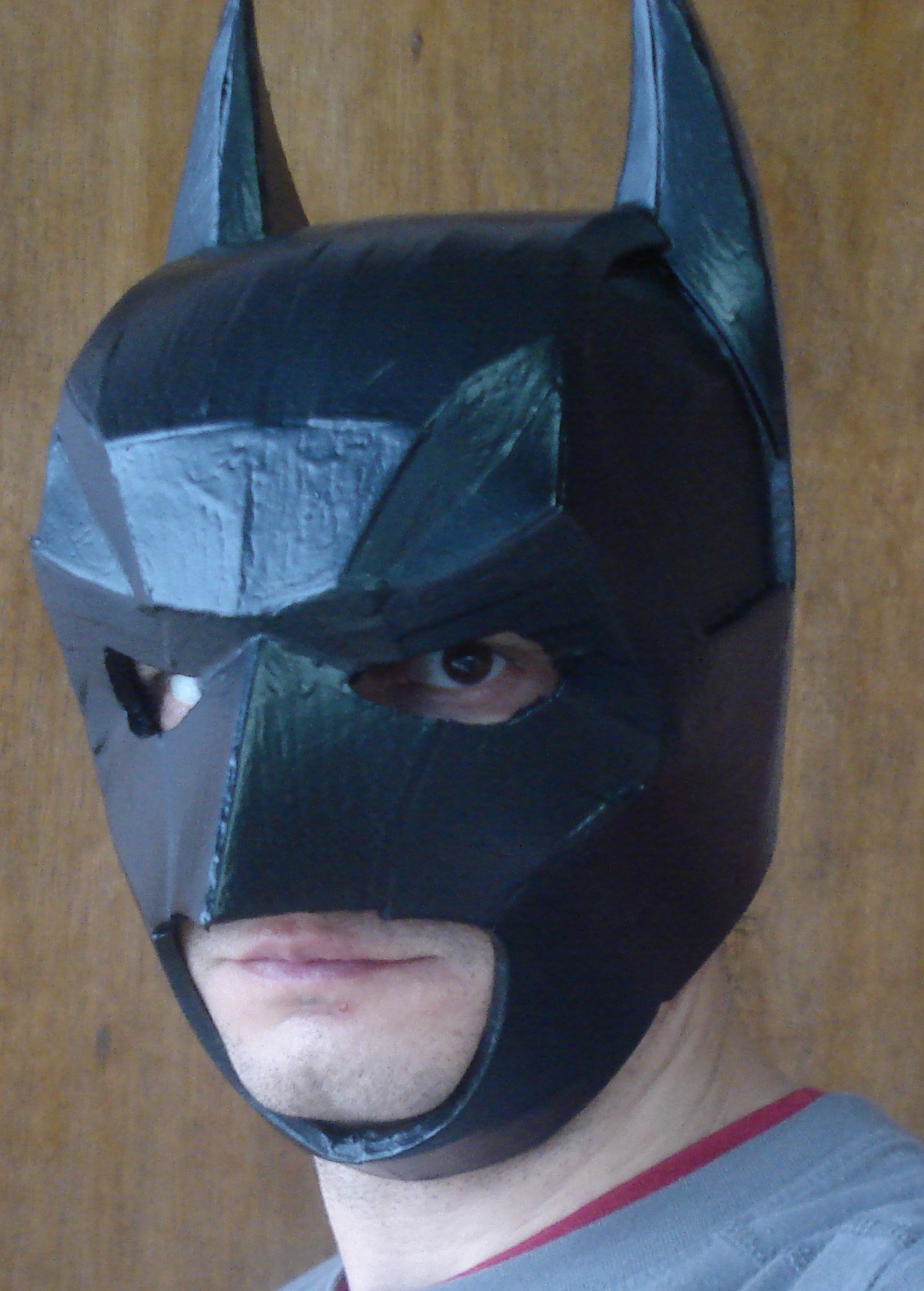

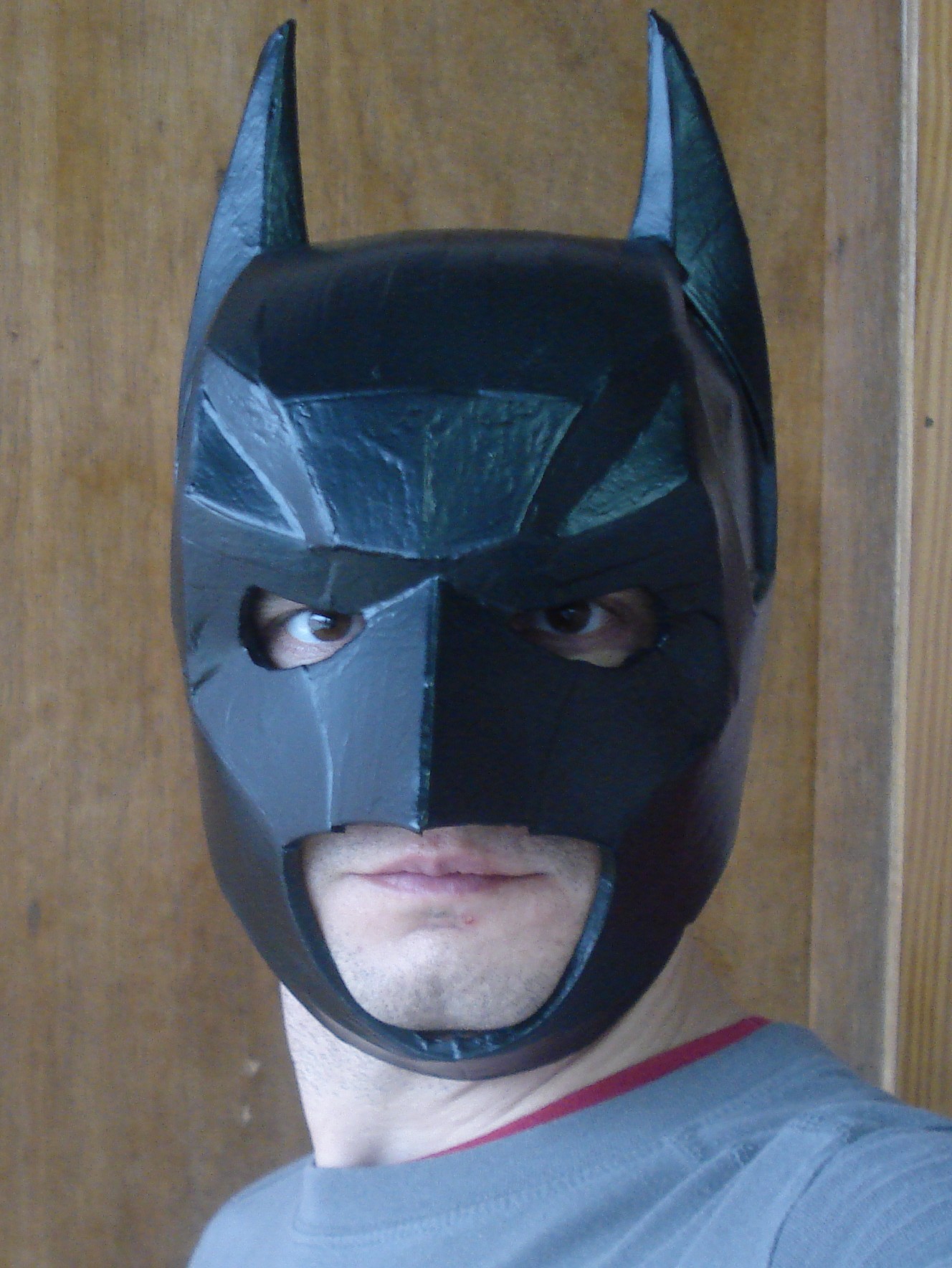

This is my first attempt at pep and my first experience with fiberglass resin and filler. Great pep file, thanks! Think I went overboard with the filler, but I think I'm getting there ! Great learning curve. Family, friends and a couple of builders who found me working on this on my porch were quite interested/confused. Not even close to finished but wanted to share! First actual contribution to RPF! photo (3).JPG

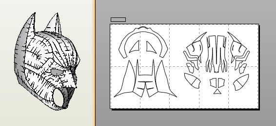

What's the difference between a "foam unfold" and a non-foam unfold?
Foam unfold is intended to be built in EVA foam. Some of the intrincated and very thin parts of the 2D model are not used into the build, because of the foam thickness take the same role of these parts. The "non-foam" actually is intended for paper builds. If you take a look in any model around here which has both versions (Iron Man helmets, for example), it will be clear. Cheers!
Got it. So you can't just build from foam using a paper unfold? When you do the unfold, do you tell the program the thickness of the material to be used and the software takes care of the rest?
Well, you can theoretically build with foam with a paper unfold. If you use the file "as is", it will be tremendously difficult (that's why foam unfolds exist). Alternatively, you can do a personal foam unfold. With Pepakura Designer, you can separate the thinner parts as you wish.
Which leads to the second question: the software does not understand the thickness. There are two versions of the pepakura software: "viewer" and "designer". With Viewer, you can only view and print the file. With Designer, you can make many adjustments, including scale (Height, width, etc...). But not thickness. To achieve the proper dimension of a piece (a helmet, for example) , you have to measure your head, and take in account the thickness of the material you're working with. There are many ways to do this, make a search, you'll need to take a look in some tutorials as well. I like trial-and-error :D

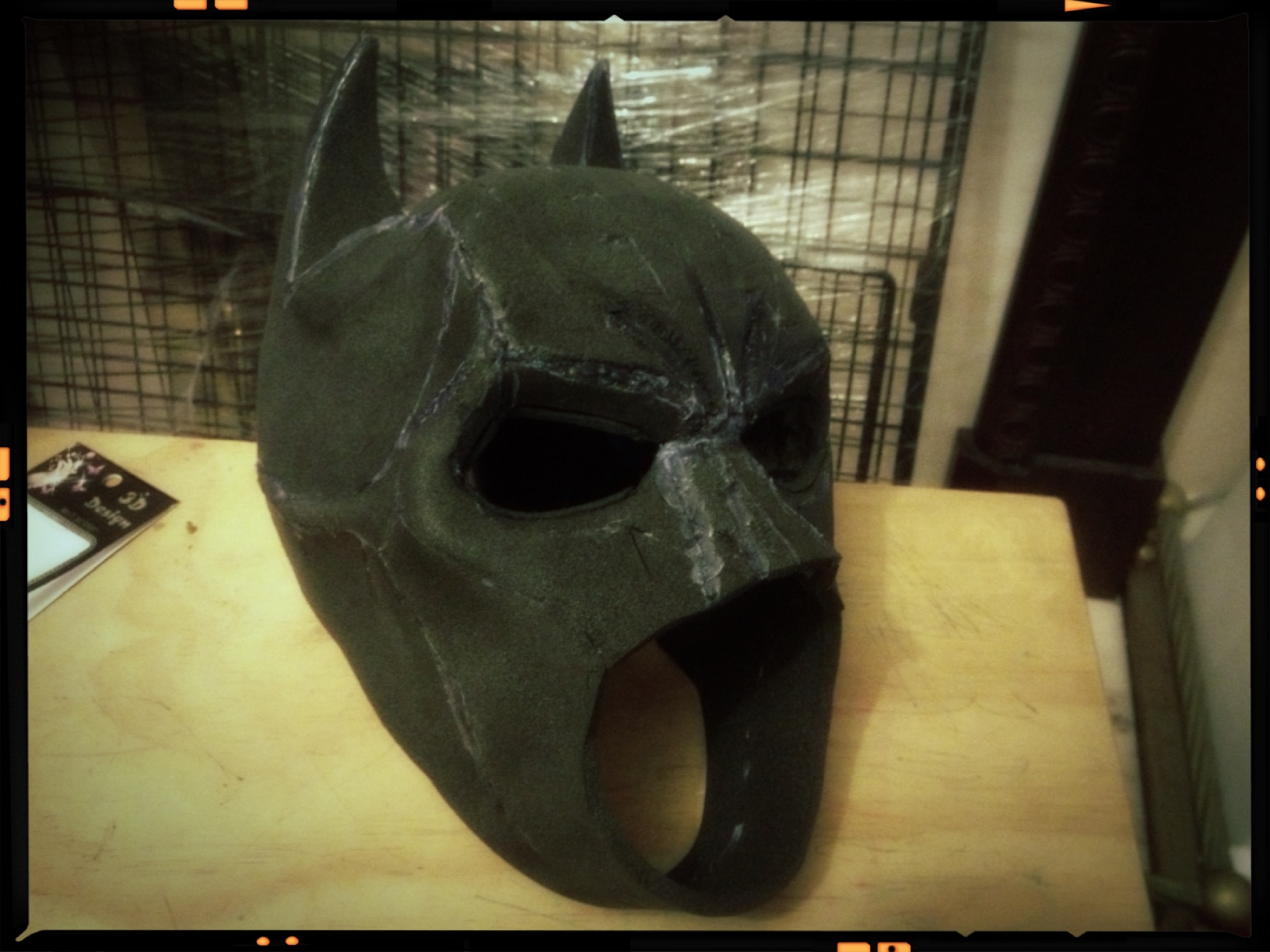

still a WIP, so far its been resin-ed and fiberglassed, added talc+resin to the outside instead of bondo, sprayed on a thin coat of paint to see its imperfections, will be sanding this down tomorrow. I am so excited!!!!
