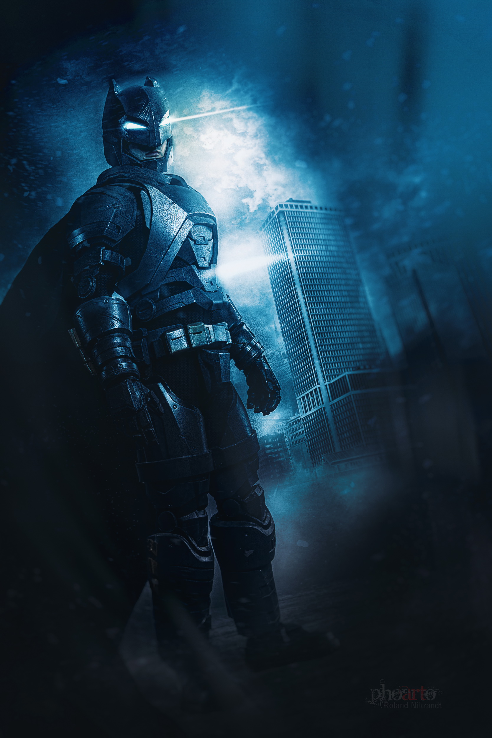

Here is a new picture from sunday. I had a great shooting with PhoArto (https://www.facebook.com/Phoarto/) from Germany.
