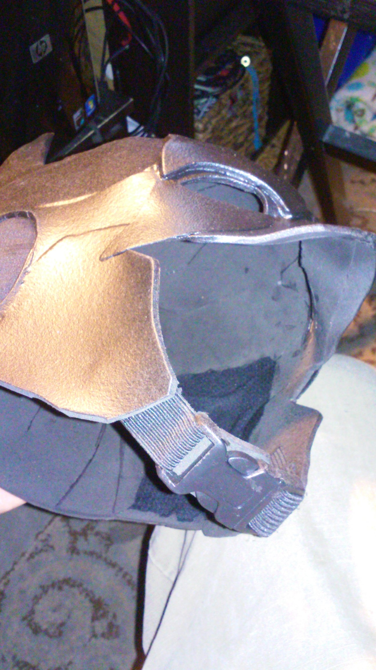

I had the same problem! getting in/out of a batcowl can be no fun. One way to fix that is to cut out the chin section, glue in elastic bands and a side release buckle.

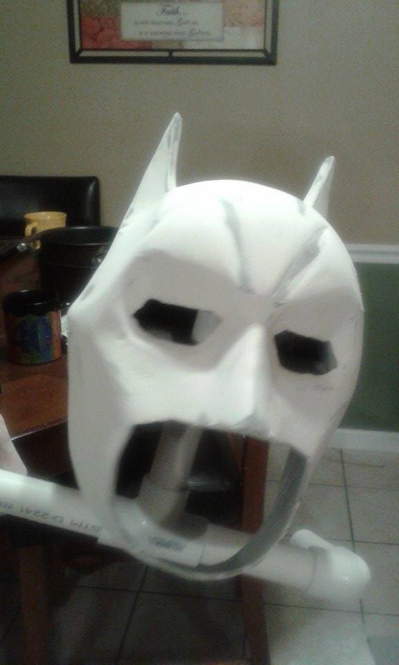

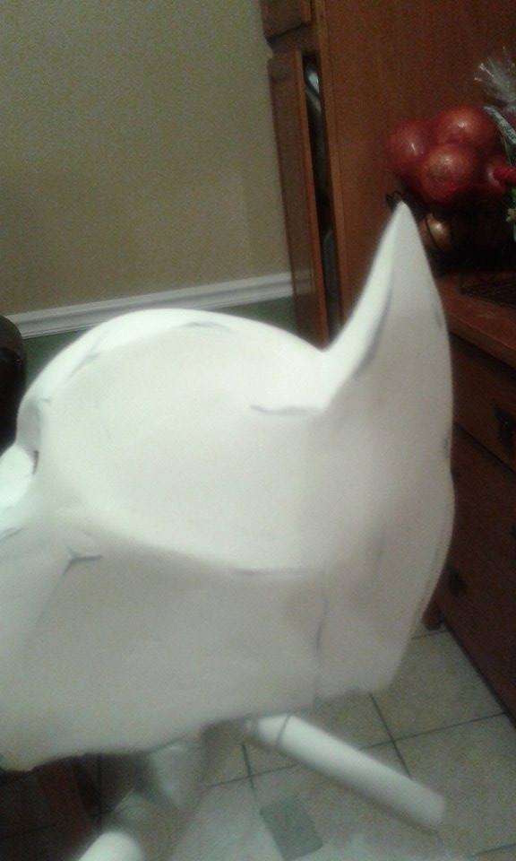

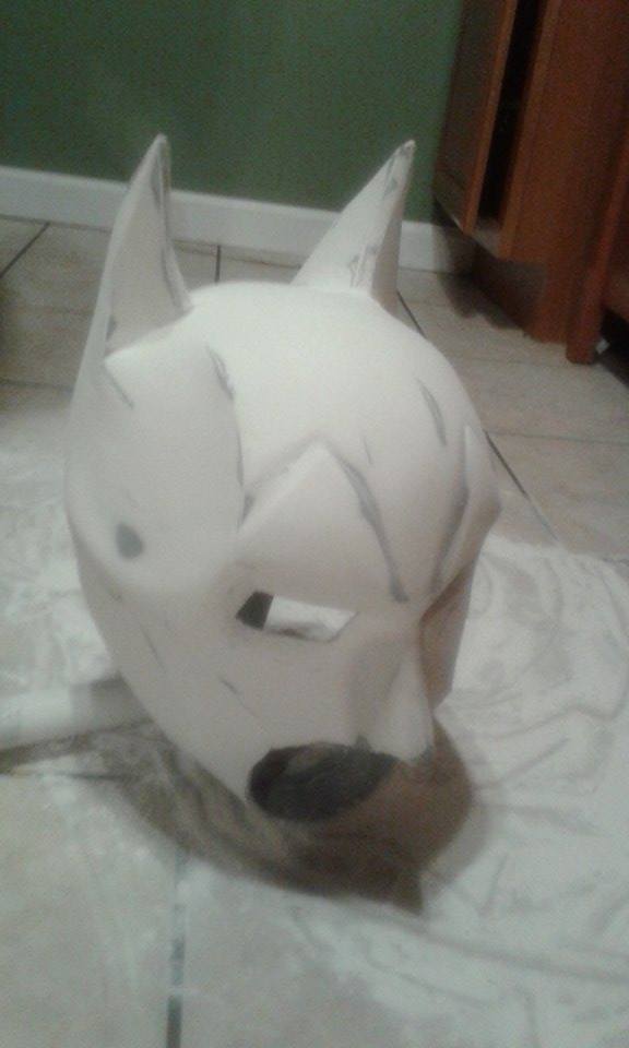

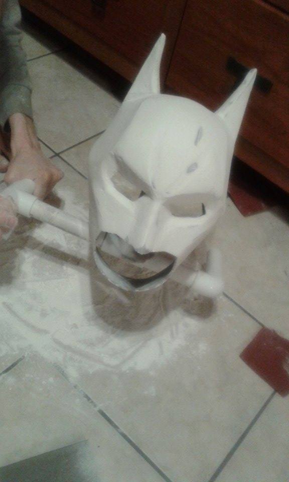

I used the Pepakura TDK Cowl Foam-File using 3mm EVA foam from Hobby Lobby. After it was built, it is indeed blocky. To fix this, you have a couple of options. One, is using Silicone Caulk to smooth the lines. I've never done it that way, but it is an option.
What I did, was cover the cowl in the pink Dry Wall putty. After the putty is dry, I sanded it down. I am in the process of applying Bondo Resin and sanding it down until I get it super smooth. After that, I am using Rebound 25 Silicone Rubber from Smooth-On. I will make a mold of the cowl and cast it in Vytaflex 40 Urethane Rubber.
