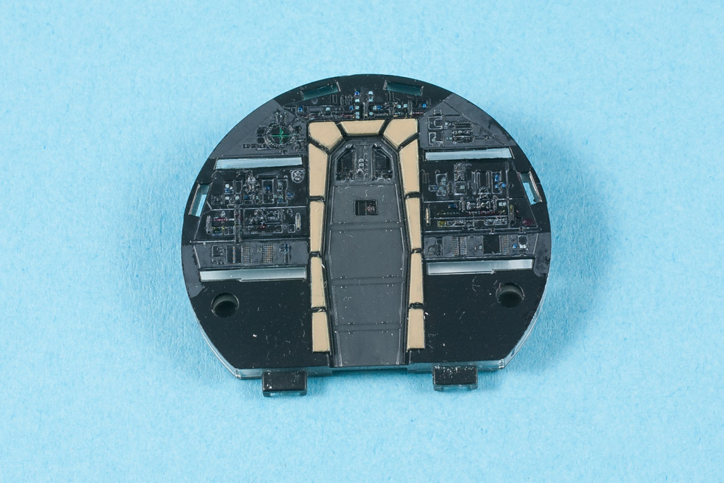

I started with the cockpit (I wish I got a dollar for every time I wrote that in my life). I blackbased and handpainted it with Vallejo colors. The bright strips are made from aluminum tape. I hope to reflect some of the backlighting forward with them (tip from Bashing Kits on Youtube).
The back wall is clear. To backlight everything I rubbed the paint off the switches and lights and painted them with transparent colors.
From an old plastic bag (vintage, Nike, 2015) I cut a diffusor.

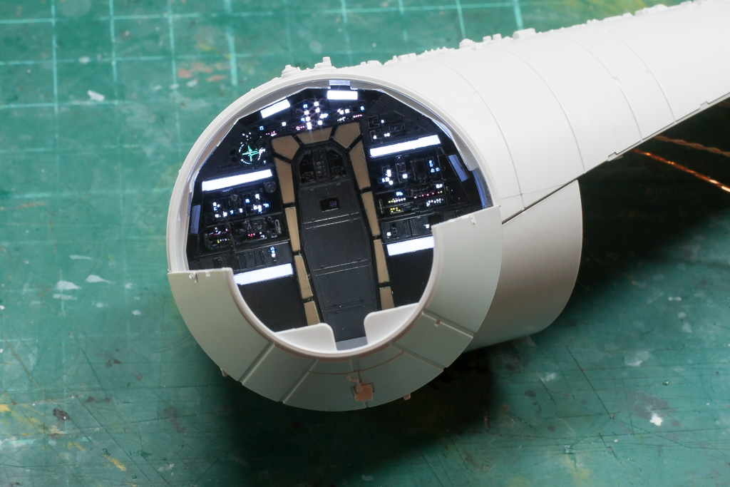

Only the upper light strips are actually lighted in the kit. That’s not enough for me. To light the whole wall I had to remove quite a bit of the wall of the cockpit tub.

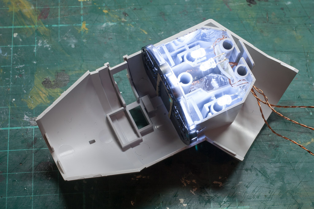

Without being forced to use the lighting kit I could install three LEDs behind the back wall.
First light test: I like!

I like what you did for the back wall. I might have to try that on mine
If this turns out anything like your smaller "test" version it is going to be stunning!

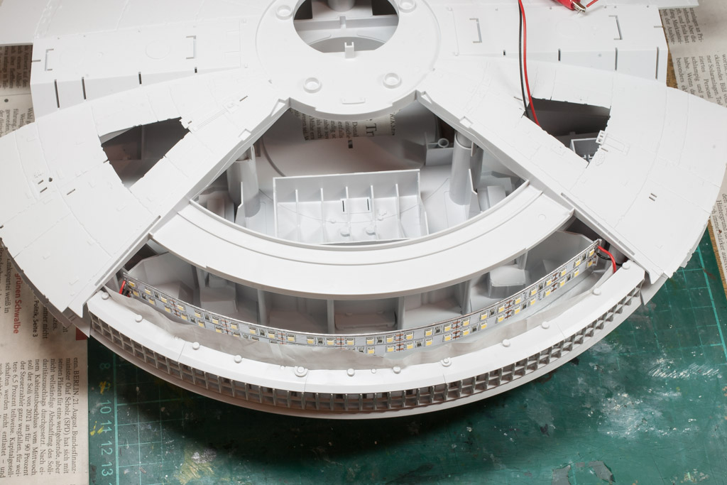

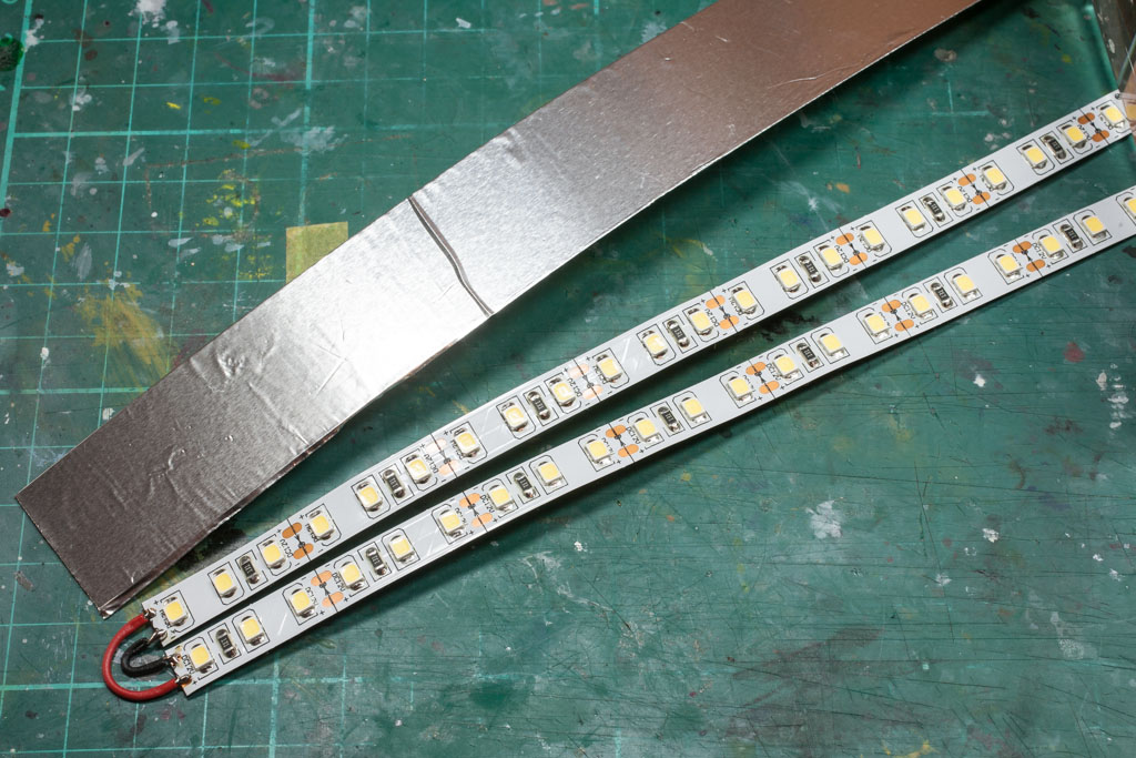

Back with a little life sign - I am playing around with the engine lighting. The kit lighting is crap, so I used LED strips to pimp it.
As a diffusor, I am using the infamous Nike bag.
Lights on!
And much better than the kit lighting.
