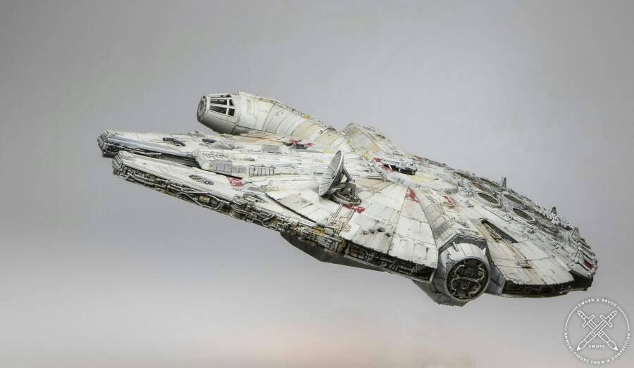

Bandai 1-144 Millennium Falcon ANH version
You're better off thinking closer to white as a base to start from than grey. Not sure there really is a consensus from reading the many RPF threads on it. The weathering and aging will bring the white down quite a bit. I believe I've seen people around here guess it was Floquil Reefer White http://www.microscale.com/Floquil Color Chart.pdf - same as on X-wings, Star Destroyers etc. Essentially pure white with a small amount of warm grey mixed in to bring it down a touch, then a ton of weathering.
Personally I think Vallejo Insignia White is pretty damn close, if a little bit too warm, but only by a touch. I'm looking at building my third MF, not having done one since the 90s and got the bug again after seeing the 32incher at the Star Wars Identities. I was amazed to see no sign of washes used at all, a lot of cheeky masking to fake extra panelling, a lot of spattering and dry brushing mostly. The recesses in the panels were clean and bright, the exposed convex areas grubby - which is counter to most efforts I've seen online by other hobbiests here and on Youtube.
Yeah, i was going to start with a primer (couldbt decide in black or grey, but astroboy suggests black so Ill give it a go), then light grey coat, then painging the darker grey panels then the colored markings followed by rust and the dark grey scorching.
However , i was mainly curious about the color of the main light grey body.
Whats the consenus on this?
does the actual model have a sepia tint to the grey or is it just grey.
Some photos show it grey and other show a slight yellowing.
Here is my finished product. The As-20 (or even flat white) won't look correct right off the bat. But when you apply controlled oils, rust, streaking, and spatter, you will get layers that add up to the warm grey that you like.
Sent from my Nexus 7 using Tapatalk
View attachment 708662View attachment 708663
Damn, nice work!

All the equipment is on the way.
Airbrush and compressor.
I decided to go with the Vellejo black primer and Vallejo air grey/white for the base.
I figure I could add a drop of tan but ill tests it out first.
Got the falcon today, and did some of the gashed and blast marks with the dremmel.
One more question- i was planning on doing the oil drips and streaks with the airbrush but after seeing how fine i would have to focus the airbrush stream i dont think ill be able to get lines that thin.
What do you guys suggest?
Dry brush Pastels, or acrylic watered down brushing?
Cool,....I used oils,.....easy to add, then streak,....if it doesn't look right, remove it & try again
J
I use pigments. And I apply them using tape as a ruler.
I use fine tipped q-tips
Sent from my Pixel using Tapatalk
Thanks guys!
Im debating whether to modify the falcon abd remove the landing gear boxes on the underside.
Nore accurate to the five footer but i dont think in there yet in terms of skills.
Looks like i would need some kind of convex plastruct styrene.
I want to add one thing I did that I believe helped my model. Because it's tiny compared to the studio model, I went a shade lighter on the panels.
I also only did about half of the streaking. I didn't want it to feel too heavy handed
