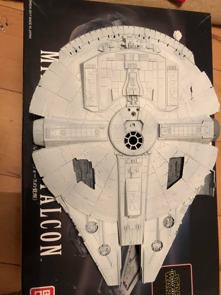

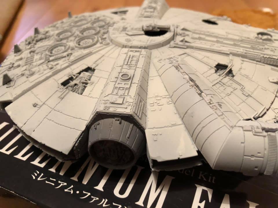

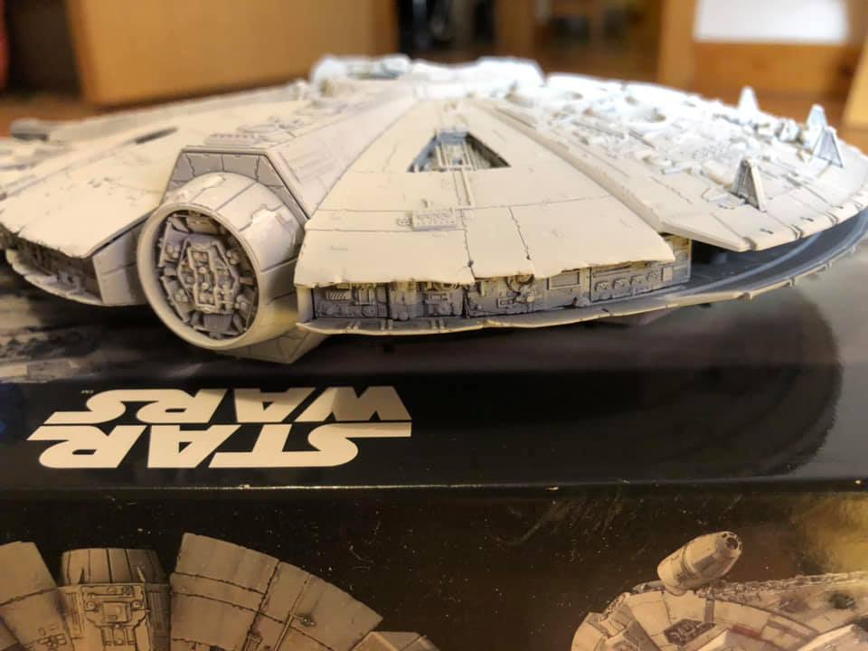

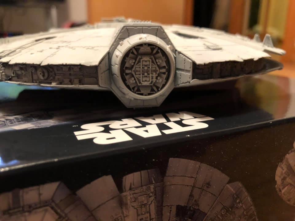

Hi J,
Can you describe how you replaced the underside panels? Did you use putty, styrene, both? I am preparing a similar mod and am looking for help with technique.
thanks,

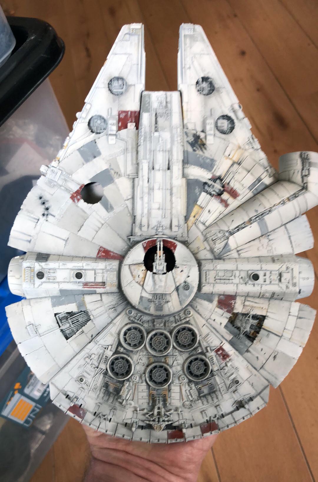

Hi i am leaf,.....I cut away the sections,....used styrene plasticard to re-do the cut away area,...making the new surface smooth with fillers, this new surface would be slightly lower than that of the finished panelled surface,...this allowed me to use thin plasticard to re-panel with the notches around the edges....it was great to use the 1/72 model as a guide
This is where I am now with the commission, using NK Guy's 3d printed side walls
Thanks for looking
J
