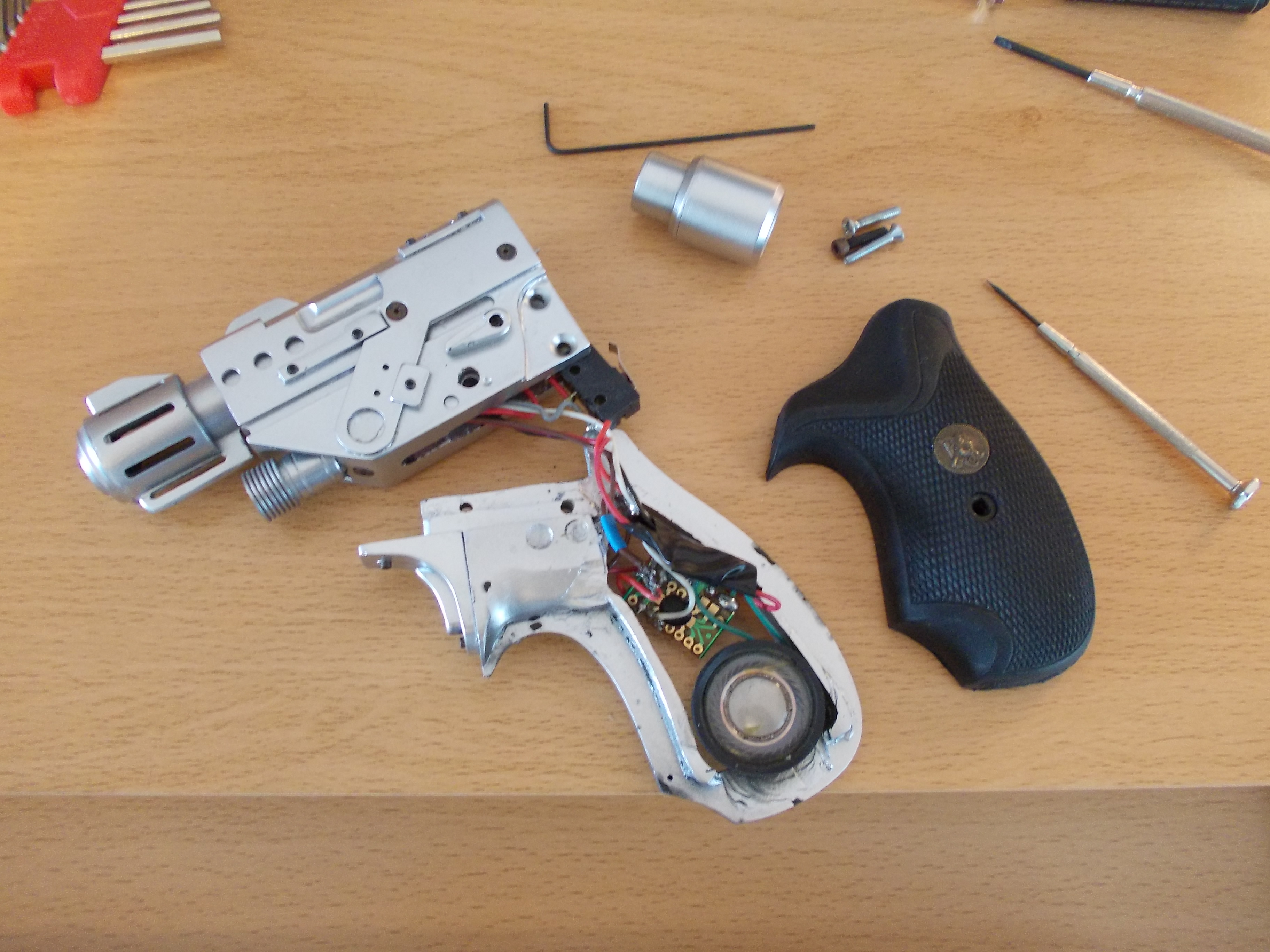

Hi All,
Has anyone had experience with changing the battery, or more importantly identifying where it is, on a Richard A Coyle light and sound PPG from Babylon 5?
I have taken mine apart and can't find it at all, short of actually destroying the prop to find it I am at a loss.
Mine still has power, but it is greatly diminished, would love to have it performing at its former glory.
I dropped RAC Props a message and he kindly replied, but he said it is in the ammo clip (I assumed Powercap) but it doesn't appear to be there on mine.
Any help would be greatly appreciated.
Andy

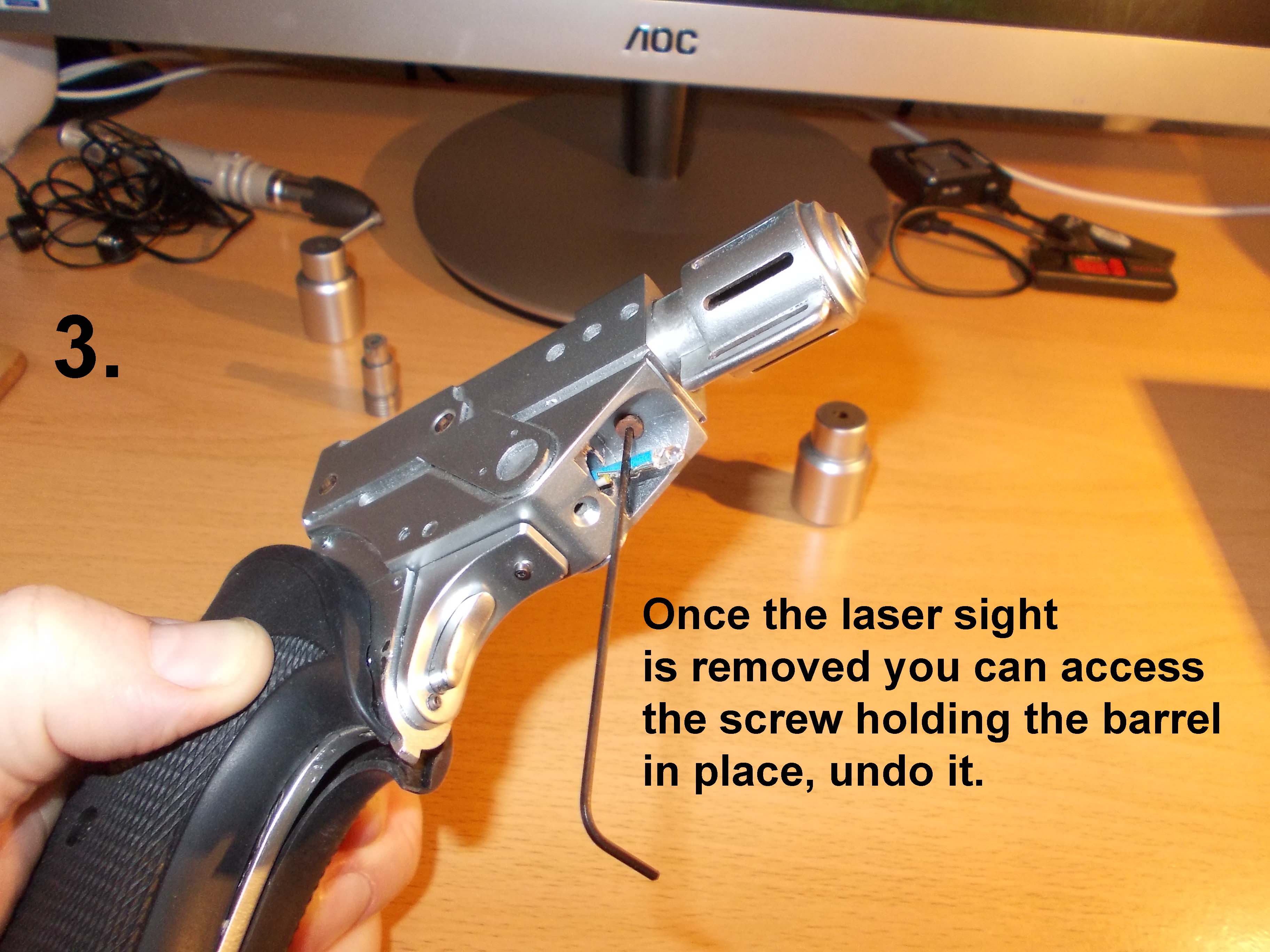

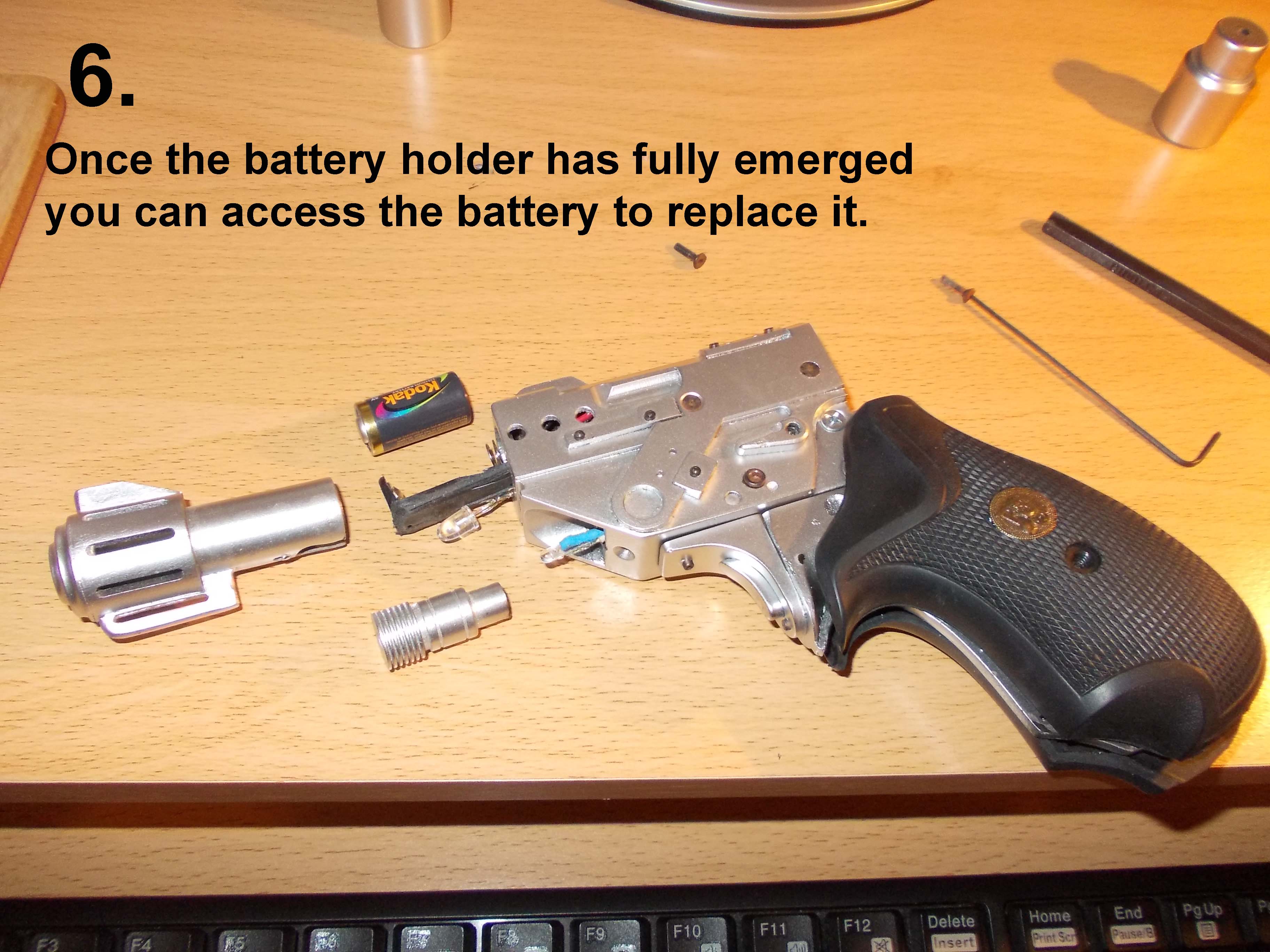

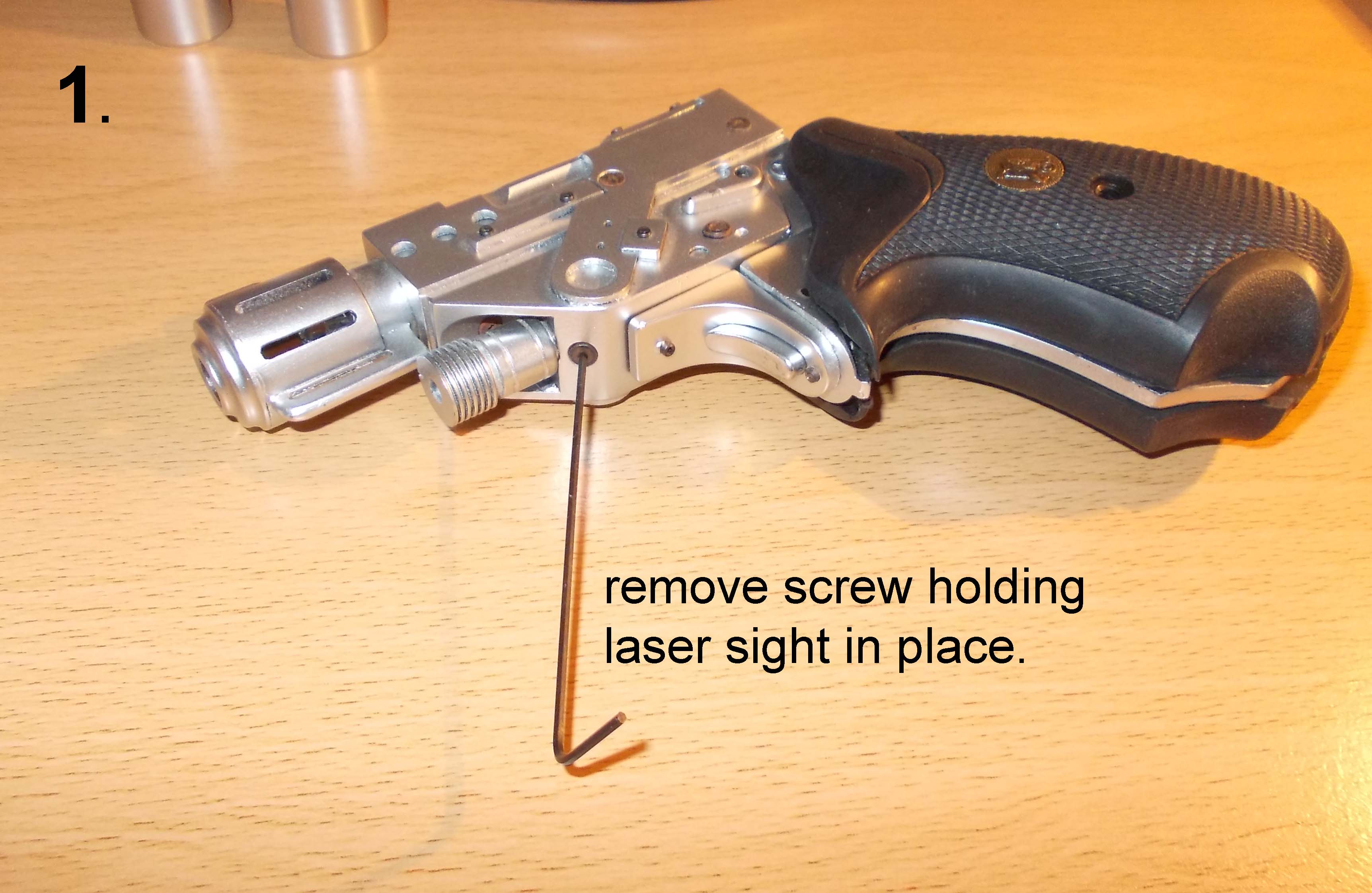

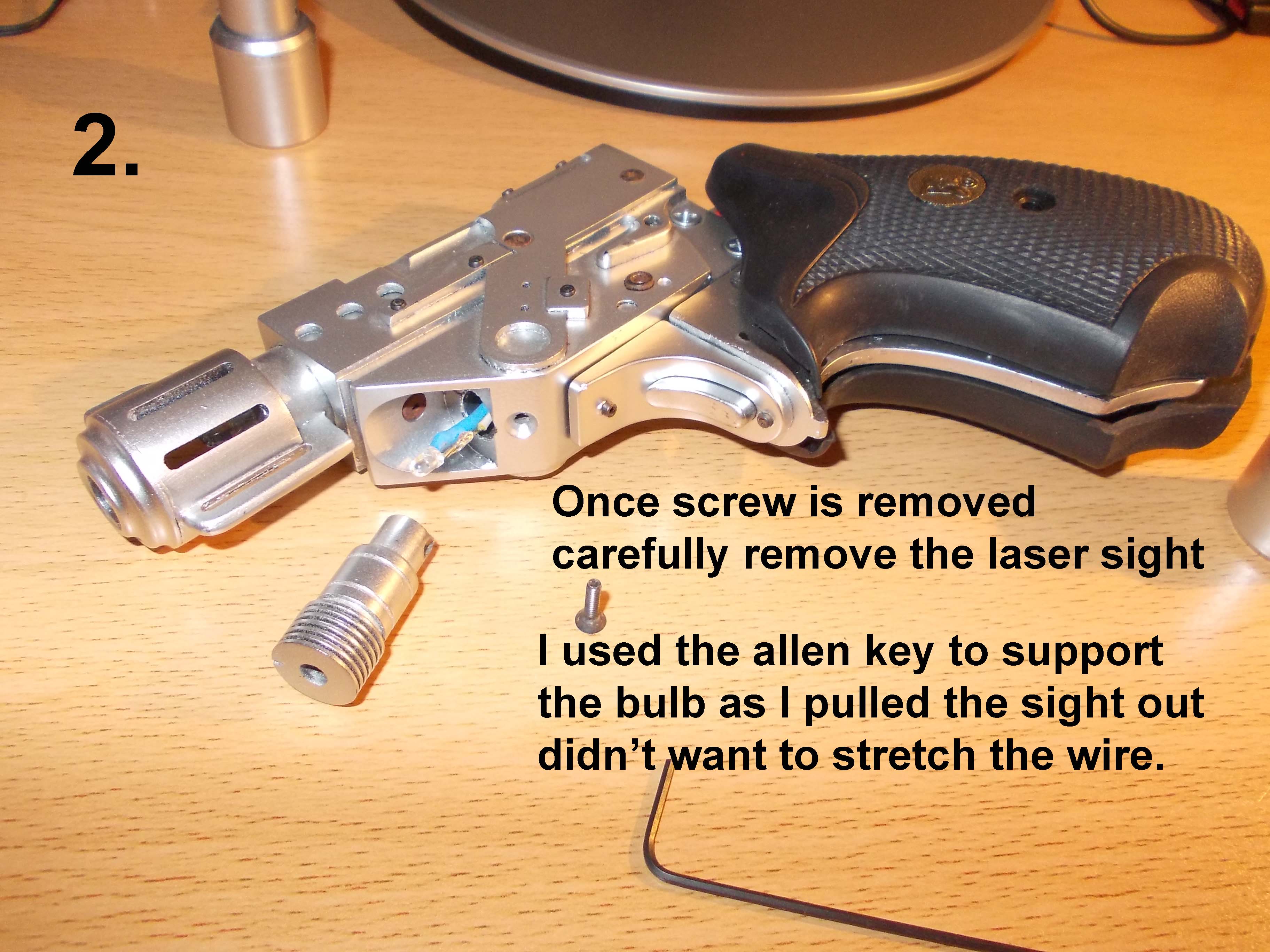

I have heard back again from Rich at RAC props and he has very helpfully, and kindly, given me instruction on how to replace the battery, which I have just done.
I took images as I did it to hopefully help anyone else who needs to do this.
I'd like to thank Rich again for his help, there is no way I would have worked this out on my own.
Hope they are of interest.
-Andy
