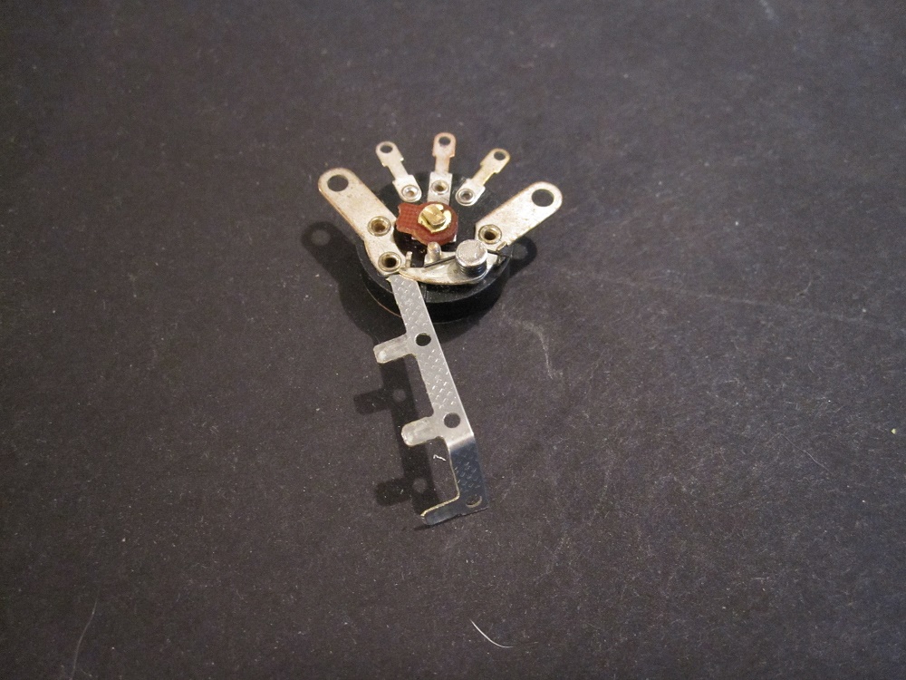

Ok, the potentiometer is still available ...it's the slightly rarer 15 mm body variant . ( 12 mm ones are really cheap and available from china, ten for a few quid ( dollars) .
The 15mm ones are a bit harder to find, but I got two genuine 70s ones for under ten pounds . They have rust on the legs ... added patina !!! But brand new ones are available cheap .
Edit ... the potentiometers are 16mm ( thanks to zombie killer for measuring correctly !)

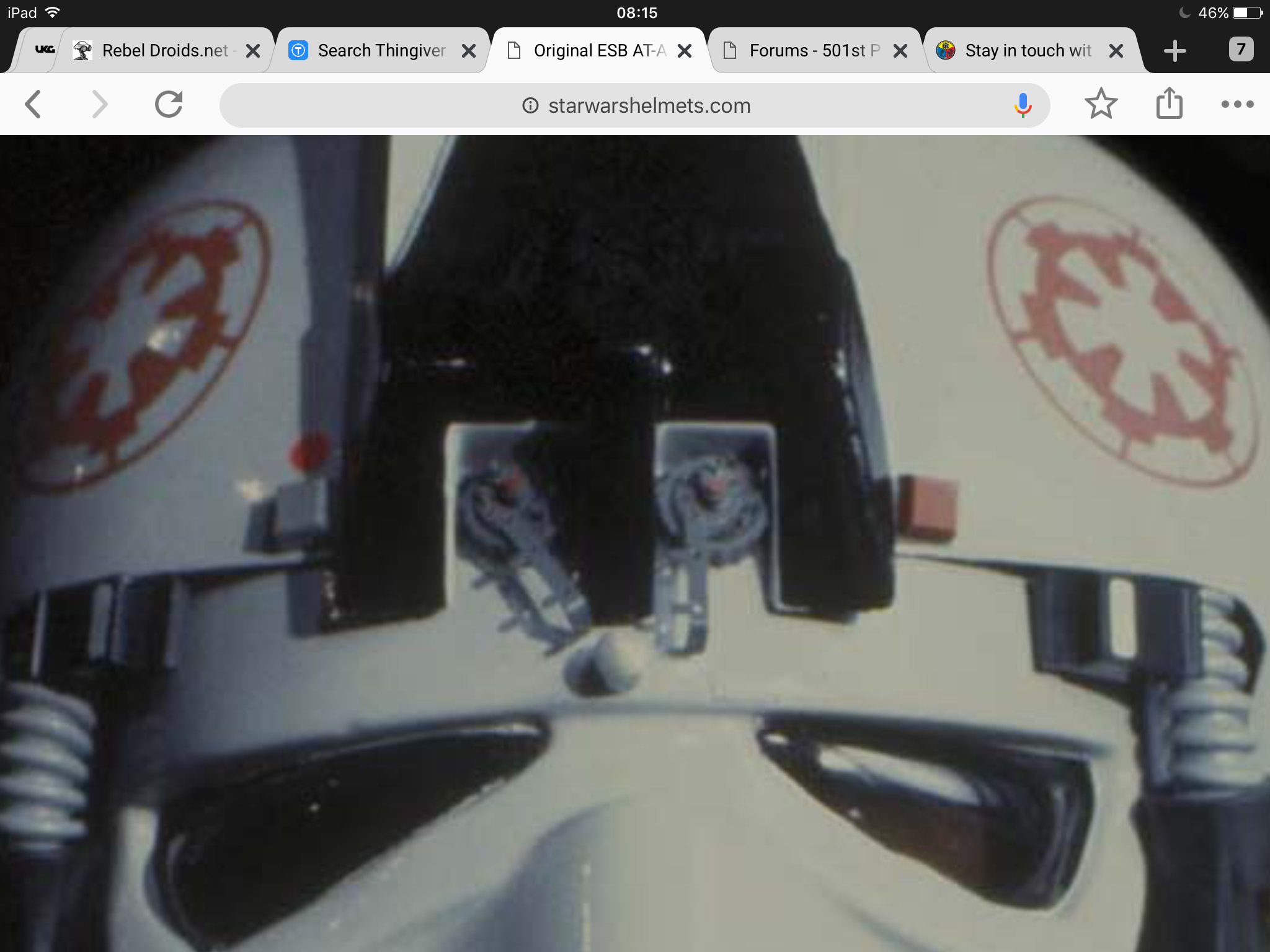

On the original two helmets , the adjuster knob for the potentiometer is still there , glued against the helmet itself .
And of course, the potentiometer contacts are bent upwards .

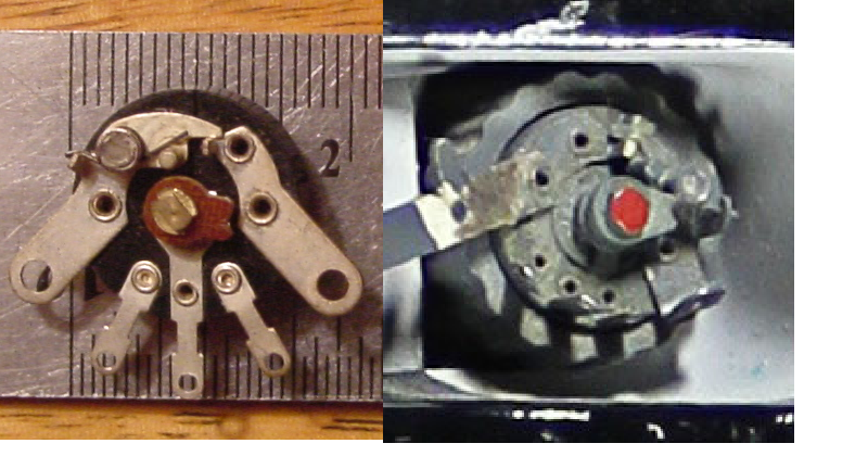

The potentiometer these helmets have are a very rare reverse rotation pot. The switch is on the full clockwise position unlike 99% of the ones out there. Lastly I was under the assumption the pots were 16mm diameter. The 15mm ones seem a bit small. Here is a 16mm compared to the real ones. Obviously mine are not reverse rotation.
Excelent hi res photos !!!! Thanks for sharing !
You are correct about 16mm , I measured mine and they are in fact 16 not15 . I guess 16 is a standard size. 16mm is 5/8 of an inch for the Americans out there

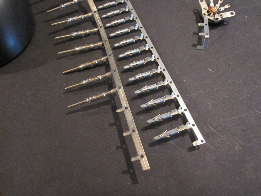

So ... any clues to the sticking out bar with holes and tabs that is soldered onto the large contact ???
For a temp arm I am going to use this stuff. AMP 350561-1 Its not the right stuff but looks the part, I still need to thin down the legs a little though. The real part is not from any pin strips. I have bought a lot of pins and this particular one is the only one I have found that the holes are about the same spread. Difference is on the real part the last hole is not in line with where the pin would be so it is not from pins since the hole on pin strips is to register where the pin is when using automated crimpers. I heard from a birdy that someone may be making some proper stuff, not sure of timeline though. Maybe he will chime in. ( if you decide to buy the pin stuff from ebay , make sure to tell them to keep the pins on the strips or they will send you pins cut off in a bag.....ask me how I know..lol
Ignore the left pins, they were the last stuff I got that was wrong.

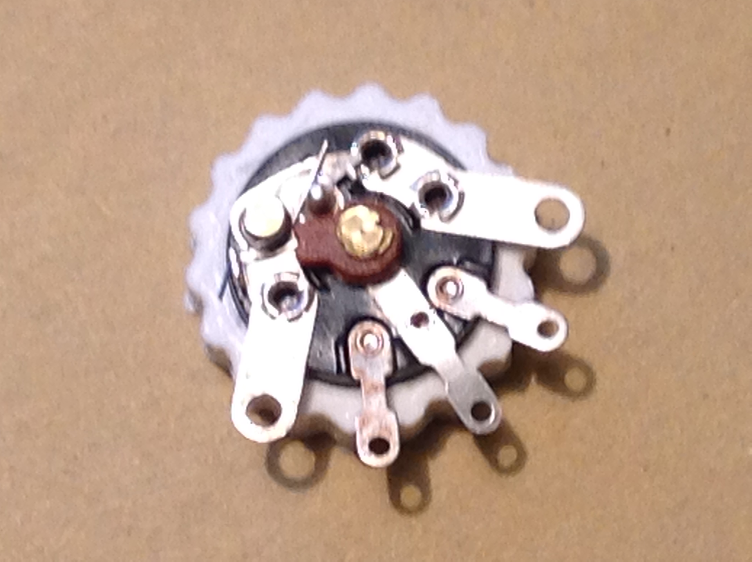

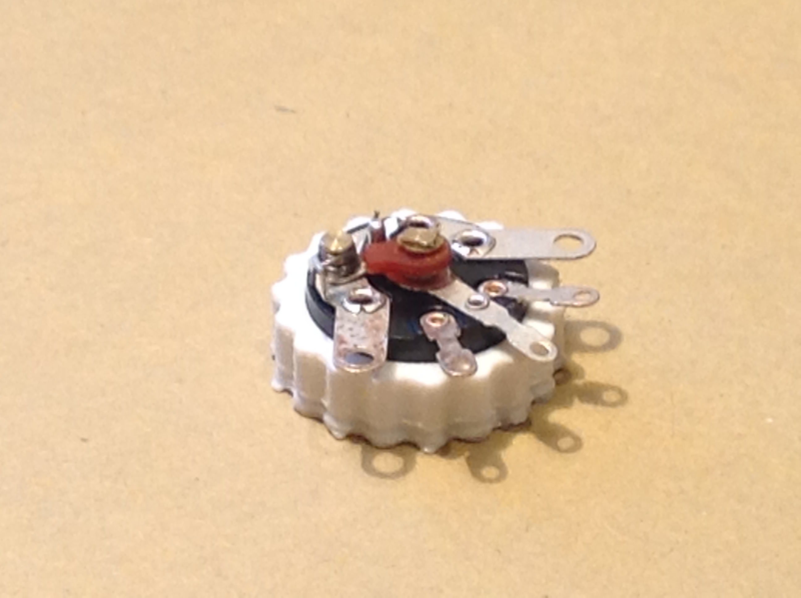

View attachment 941130 View attachment 941131 Ok, the potentiometer is still available ...it's the slightly rarer 15 mm body variant . ( 12 mm ones are really cheap and available from china, ten for a few quid ( dollars) .
Are those parts under the pots casts of real parts or 3d printed?
3d printed , but look pretty close to me . They are straight off the printer , not cleaned up or sanded yet .
I haven't located any correct real knobs yet . ( and possibly never will )
I also have the pin terminal strip for the arms, but intend to superglue them on ....just in case I need to remove them , although after several years of searching , I've not seen originals .
