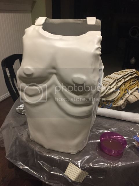

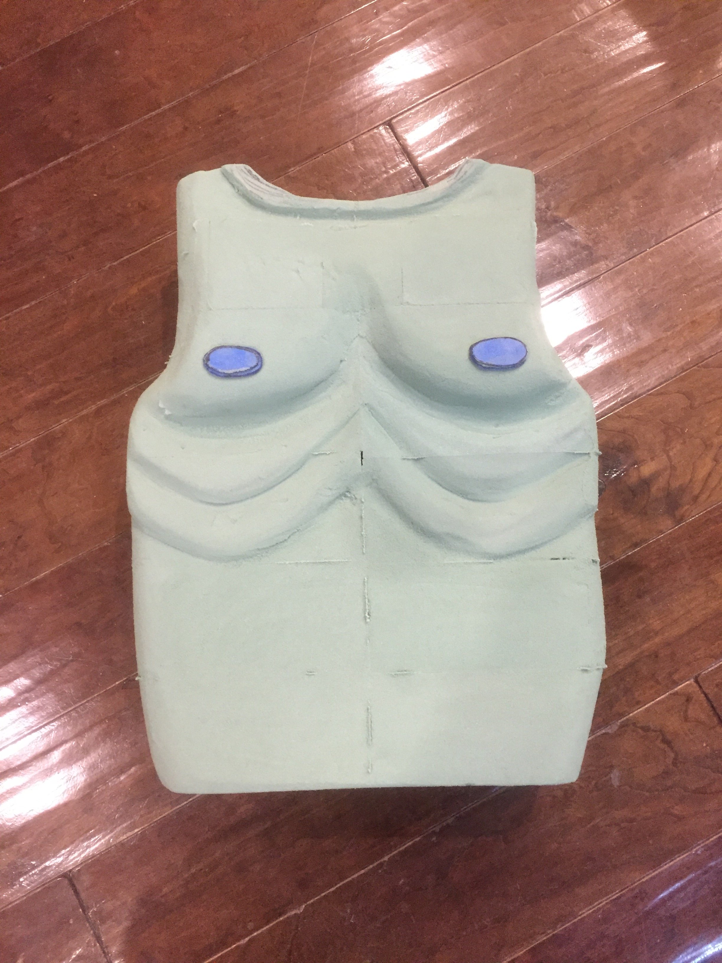

Started off with simple craft sponge foam for the chest piece
Carved out the chest and back the same ways...

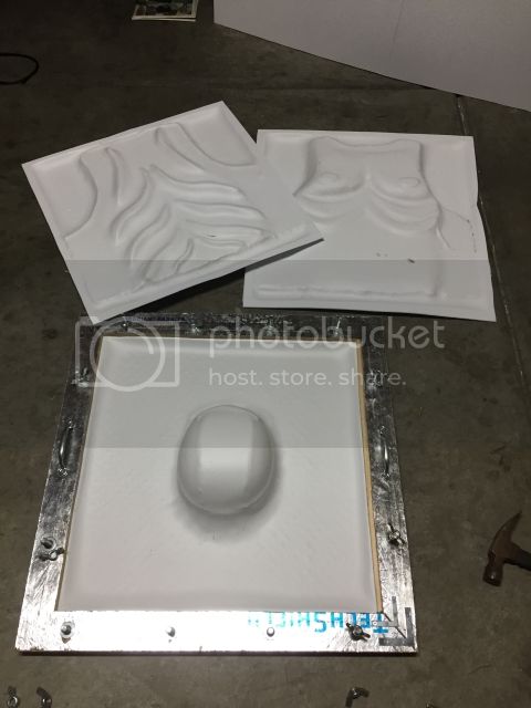

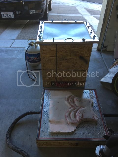

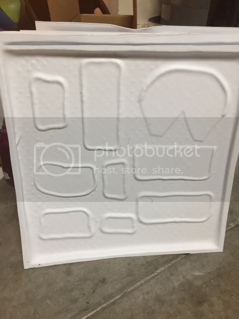

Prepped Both with Bondo for better shaping...getting ready for vacuum molding

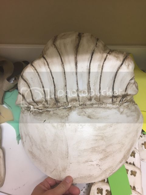

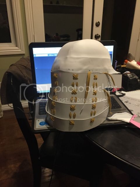

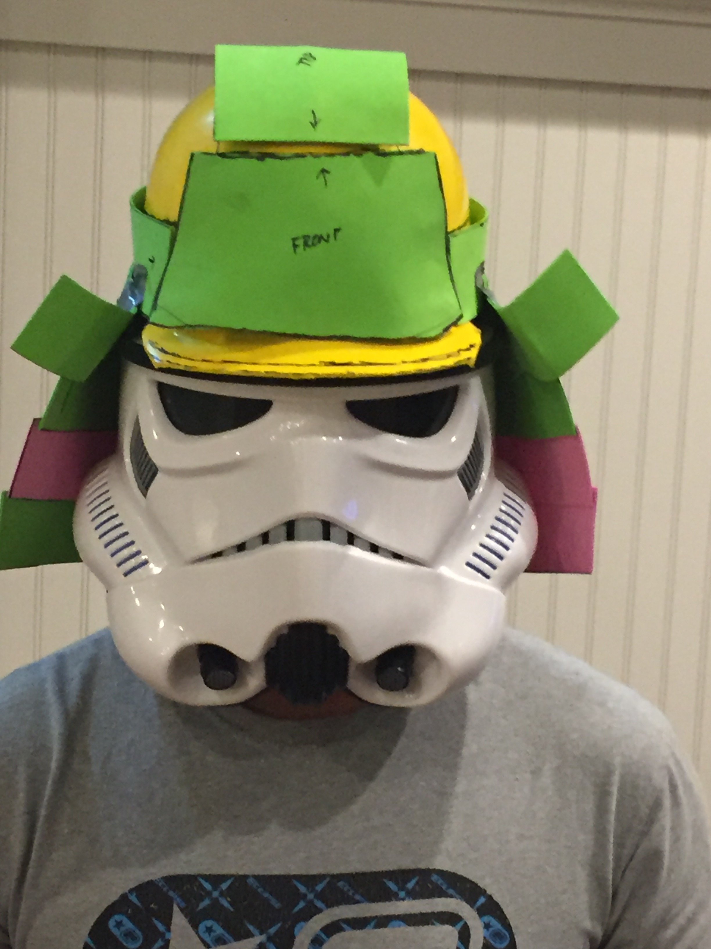

Next started with a construction helmet, reformed it, and made it into the helmet

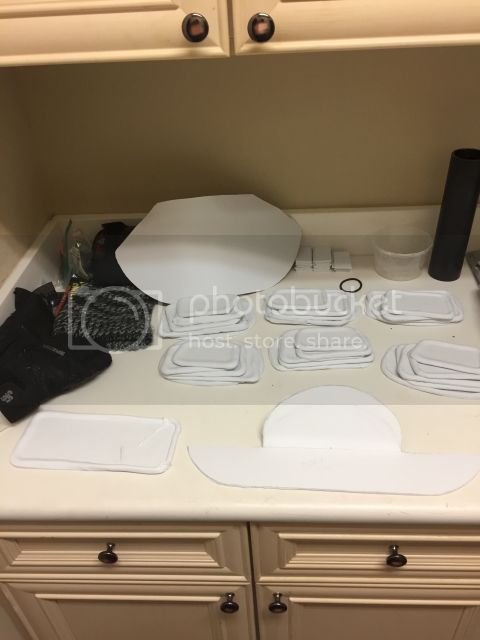

Took some craft foam for stencils and started to make the lower helmet armor, (just for fun put on a Stormtrooper mask only for looks, not going to be a part of the final costume)

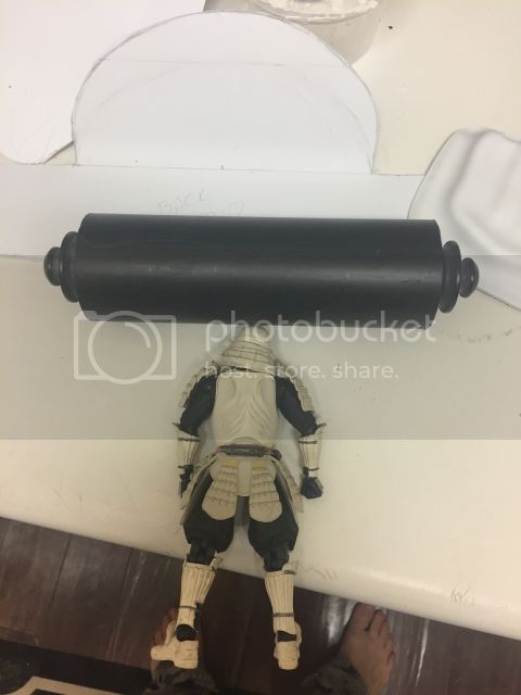

Thermal Detonator work...

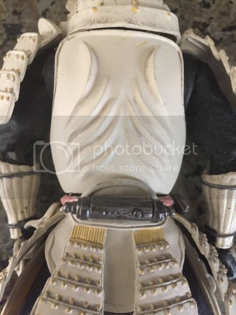

Original
Took some 3" pipe and some Curtain rod ends...

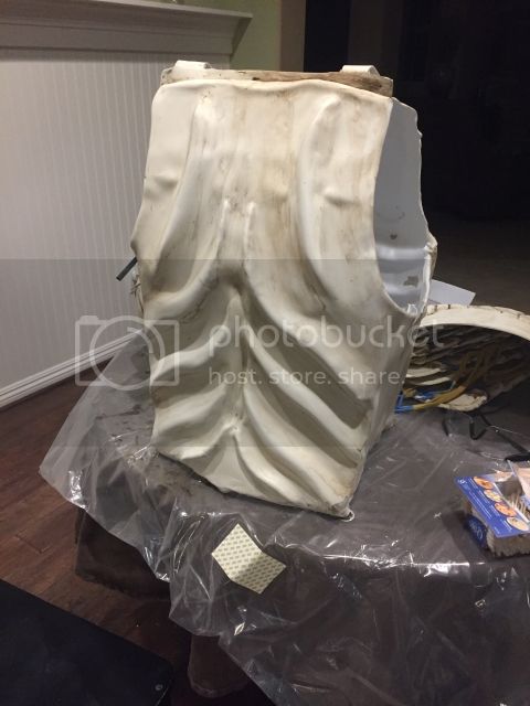

Chest Armor Before
Chest Armor After Weathering

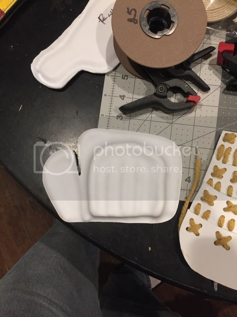

Gauntlets

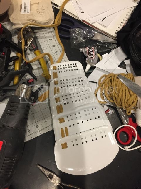

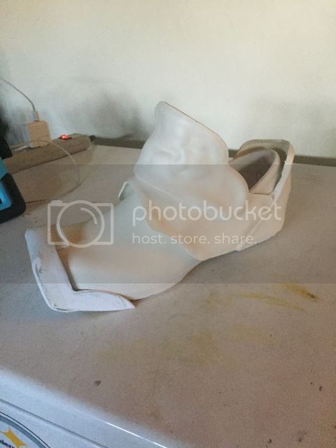

Shoe Armor

Here is the Chin Armor (trying to pick up every detail (even the inside)...
The first fittings, chest, back and shoulder pieces...

Shoe Armor completed...

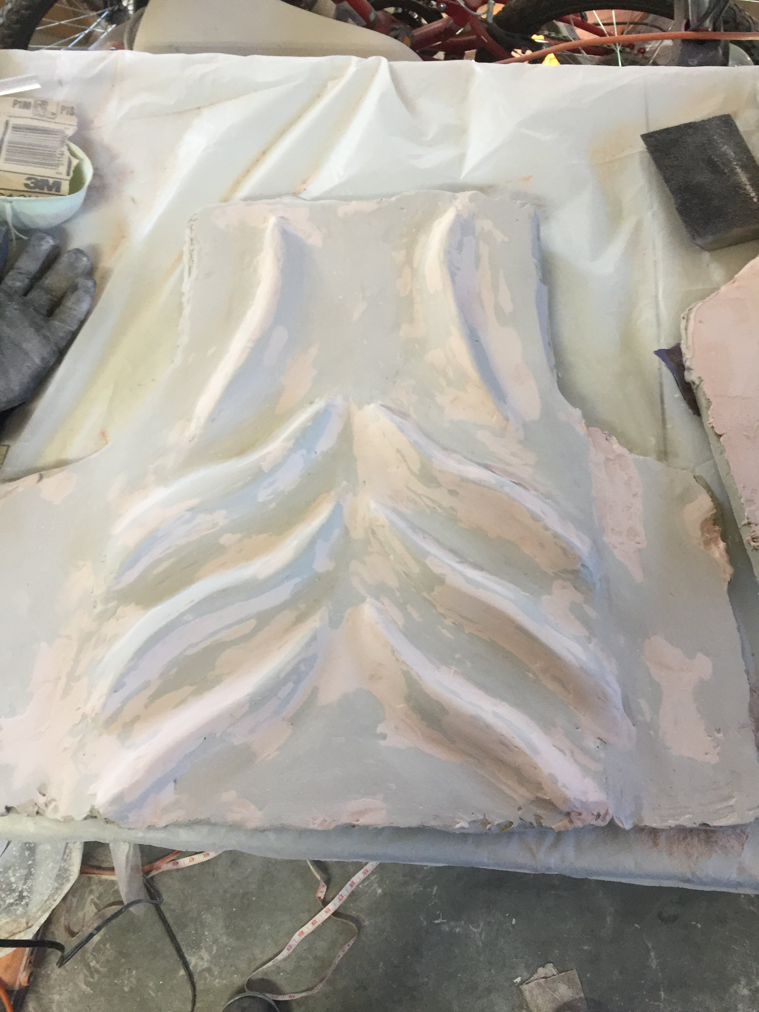

First mold done...FAIL, tightened the joining bolts to tight and warped the inner mold, hense warped cast...
Second cast done, much better not warped and just need some cleaning up...
