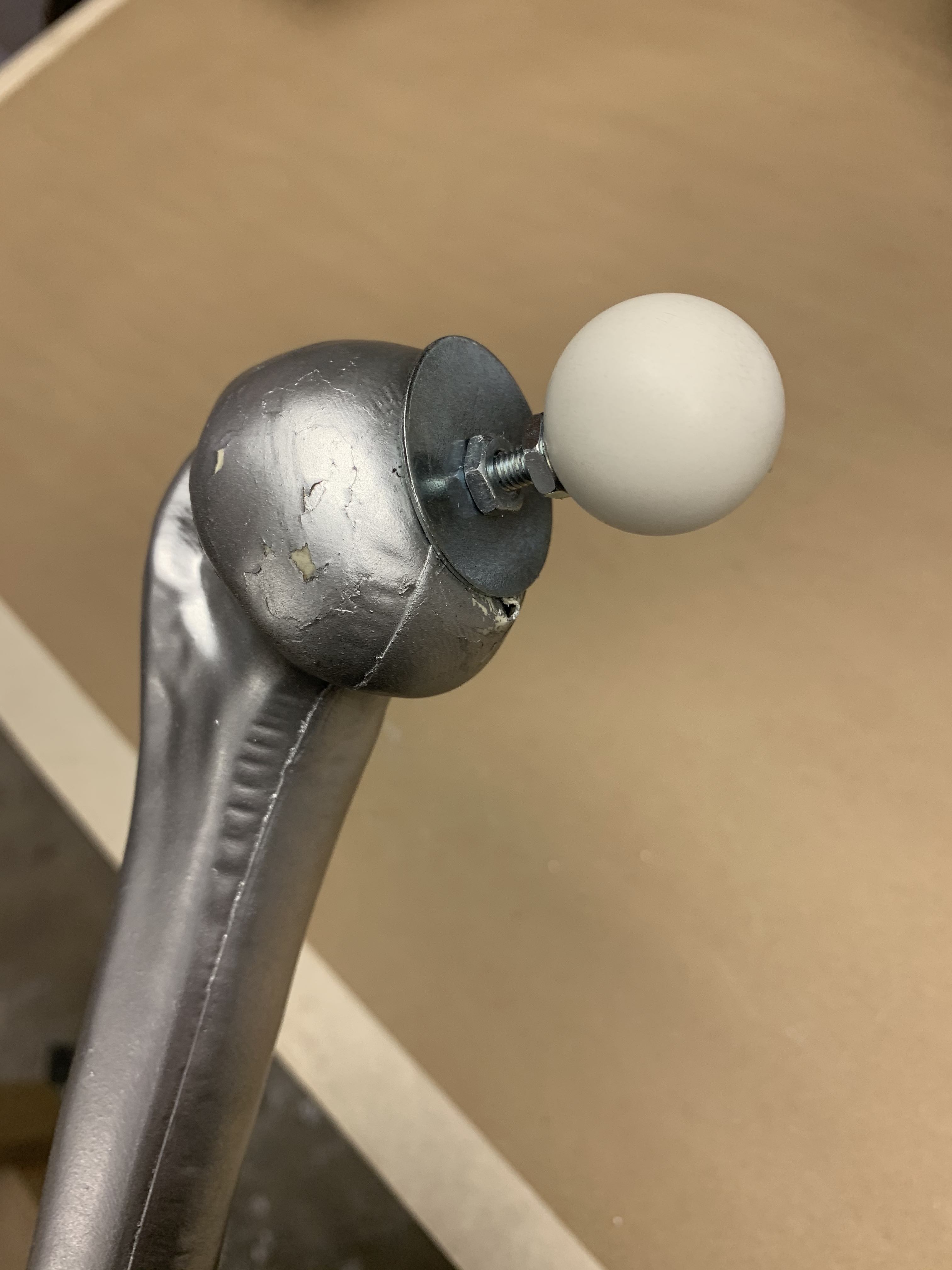

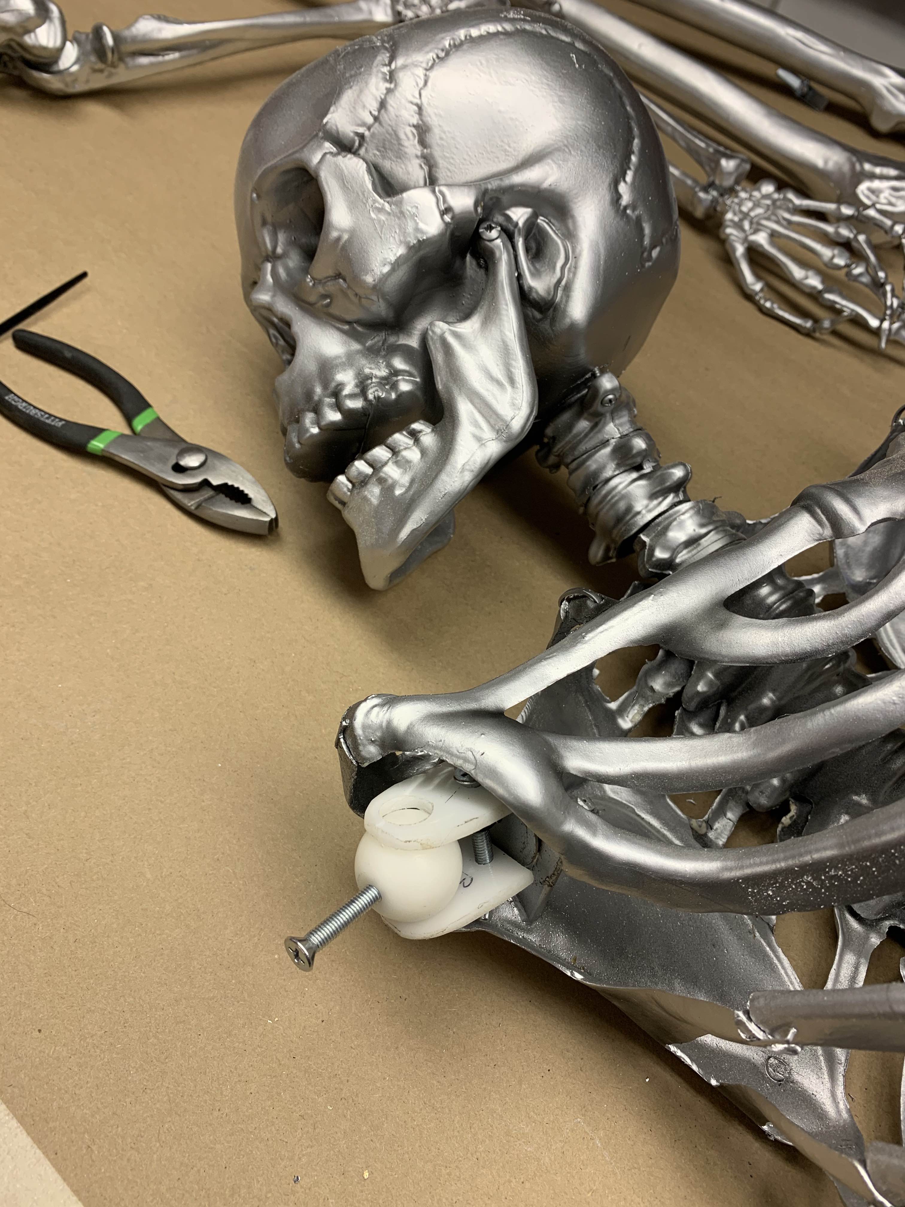

I wanted to make some relatively free holding ball and socket joints. The challenge was a worthy one, first time making ball and socket joints, additionally the nature of the skeleton meant I had to walk a delicate line between the size/function of the joint and the appearance.
I ended up using delrin as it seemed something I could "machine" with the equipment I have.

The shoulder joints and hip joints were made in the same method.
