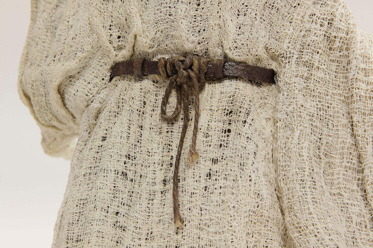

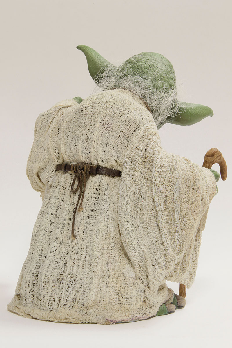

CLOTHES:
I finished painting the visible parts of the figure (head, hands and feet) and, before starting to dress it, I dyed the fabric -which was white- so that it took on a slightly tan color. For this I prepared a cup of coffee and immersed the fabric until it was well soaked. Then I washed the cloth with clean water and the color I wanted remained. The rag was made up of four thin layers that could be easily separated by cutting its four sides. And I saw that it was going to be easier to dress him in layers instead of using the full rag. I did some tests and found that it was easy to apply the pieces of each layer by wetting the fabric with water and shaping it by generously applying white glue with a medium-sized round brush. With this technique I could easily make the folds of the clothes and it was also very easy to hide the unions between the different pieces of fabric that I used for each part of the figure. Once dried, the fabric is almost completely rigid and can be handled without any problem.

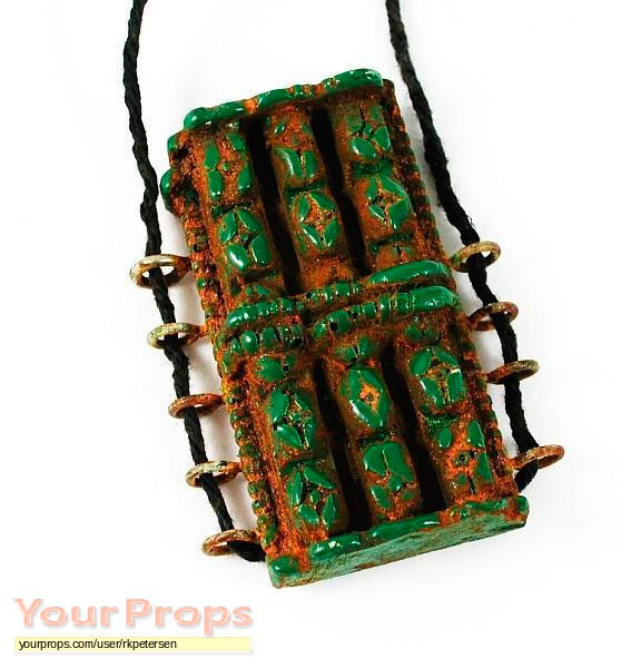

BELT, POUCH AND PAN FLUTE:
I made the belt and bag using fake leather from an old purse. The flute is made with styrene, Milliput putty and a few pieces of wire.
This image corresponds to the pan flute prop Yoda carried in the movies.

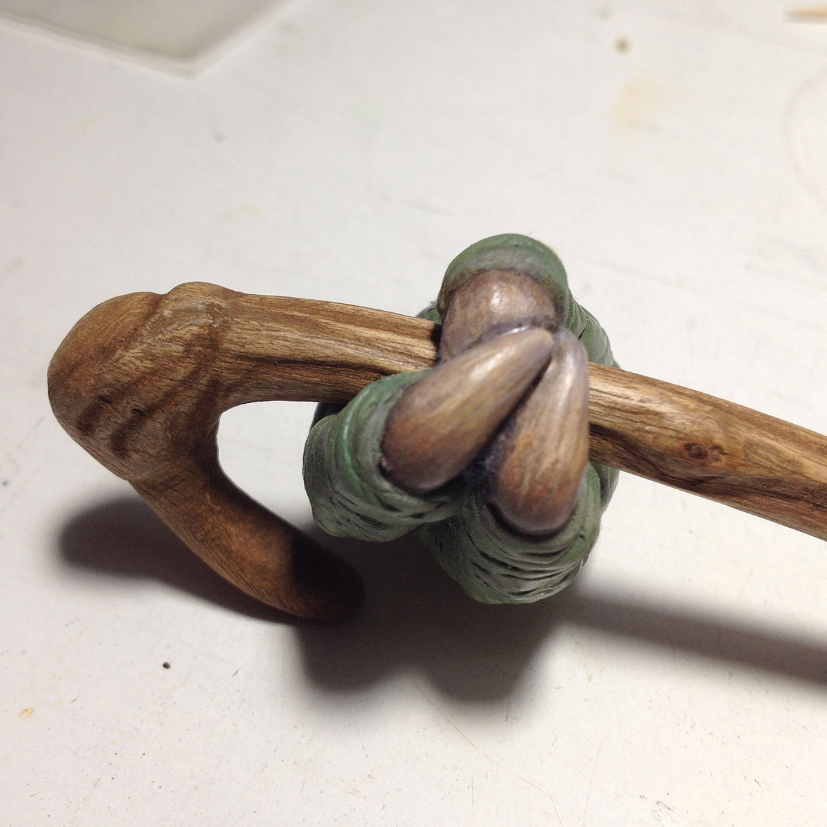

CANE:
I picked up various twigs from different woods looking for them to have the most similar shape to the cane that Yoda used on screen. In the end the chosen one was a sprig of beech that I modeled lightly with my Dremel to make it more similar to the original.

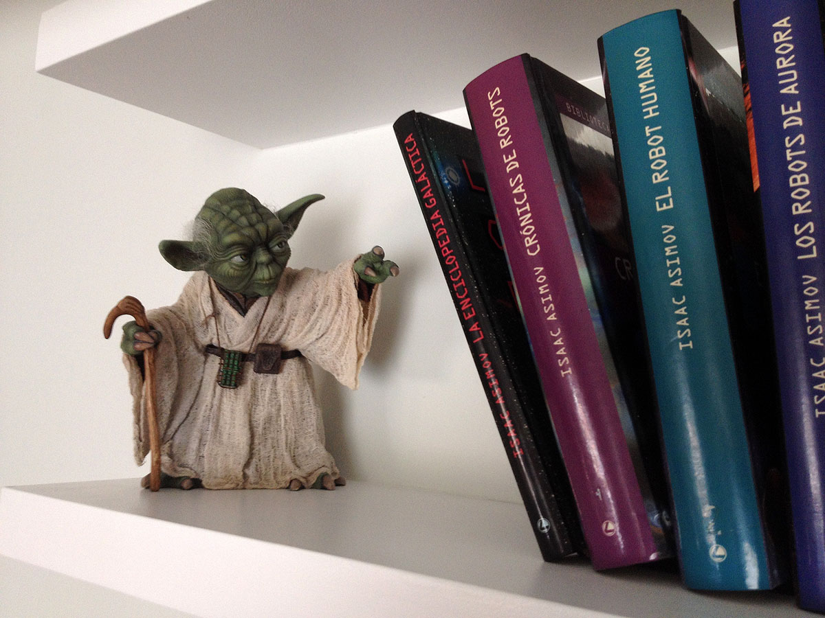

The final result I think is much better than the one proposed in the kit. Both for the new posture and for the realism of the clothes.
BTW, the type of fabric I used I think is called TACK CLOTH.

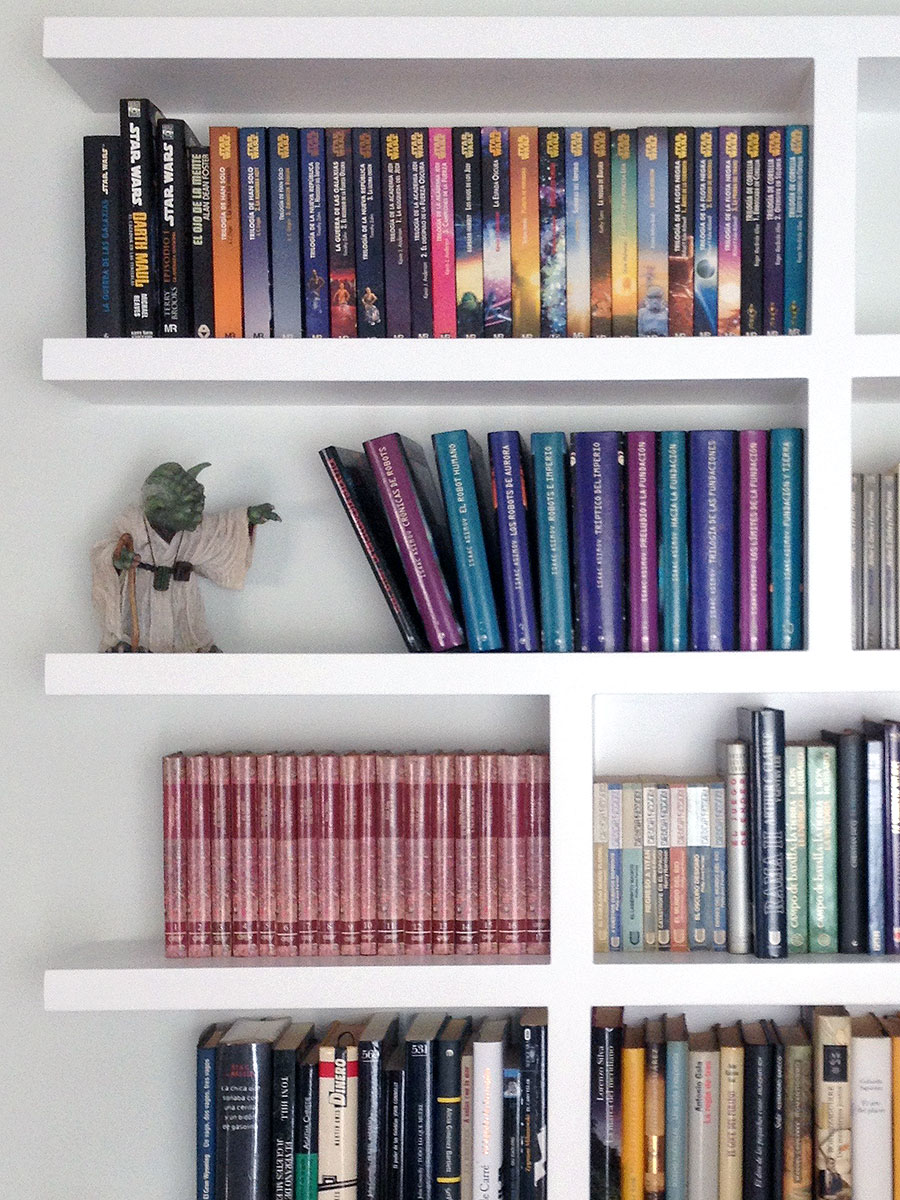

Once finished, I couldn't resist the temptation to place it on a bookcase in a way that Yoda would “use The Force” to prevent the books from falling. Now it is a point of attraction for everyone who comes to visit my house.
