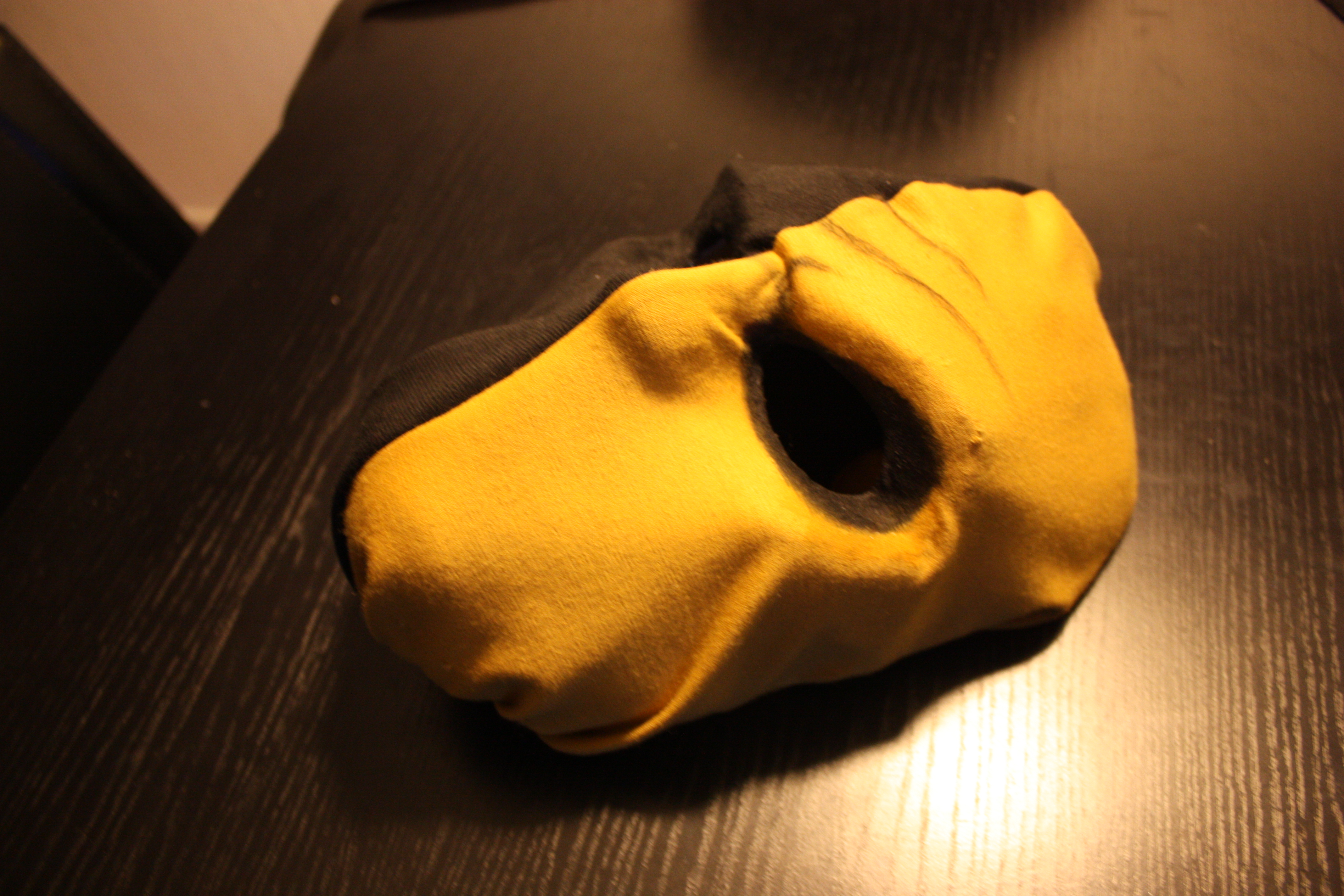

After chatting with Tvayumat about the island mask that Wintergreen and Slade wear, I decided to do a "quick and dirty" build of one. The goal was to do it with stuff I had on hand, in a couple of days.
To start, I sculpted it out of wed clay on a resin sculpting armature I had.
Untitled by stormtrooperguy, on Flickr
Then I molded that with some leftover rebound 25 silicone I had from prior projects. Despite being over a year old and literally scraping the bottom of the bucket to get enough out, the mold was good. I've never tried molding wed clay with silicone. I wasn't sure about reactions, so I coated the whole thing in thinned down vaseline first. I don't know if that was necessary, but it worked.
I didn't want to waste any of my freeform air on this, so I made the mold jacket out of plaster of paris. I then proceeded to make a positive casting, also out of plaster of paris. If I decide to do more than a handful of these, I'll re-do that with a stronger plaster.
Casting complete, and holes drilled for the eyes. The plaster is about 2" thick, with embedded fiberglass drywall tape (again, using what I had on hand)
Pulled in 0.080 HIPS. The droplets are from rinsing it off after sanding.
Then I made up a quick covering for it, attached with contact cement.
There are a few changes I plan to make:
  • I'm going to smooth out the plaster casting a bit, so that the final surface of the mask isn't quite as bumpy.
  • The pattern I drew up for the hood is a bit too small, so I'll be enlarging it by an inch and a half or so.
  • The hood is going to have a hidden zipper in the back, both to make it easier to wear and easier to glue to the shell.
  • I shouldn't have cut the eye holes out completely... Leaving a lip around the edge would have matched the reference better, and made it easier to assemble.
So far though, I'm really happy with it.

Thanks! I'm continuing to improve the technique. I just ordered more black plastic, so the next will have a dark shell, which should darken up the yellow. I think that will be the final touch that makes me feel like it is finished!
Re: Arrow: Wintergreen/Slade's island mask
Awesome work! You really have captured the look of the actual mask. I'm looking forward to seeing how the color changes on the yellow with the black shell. Great job!
