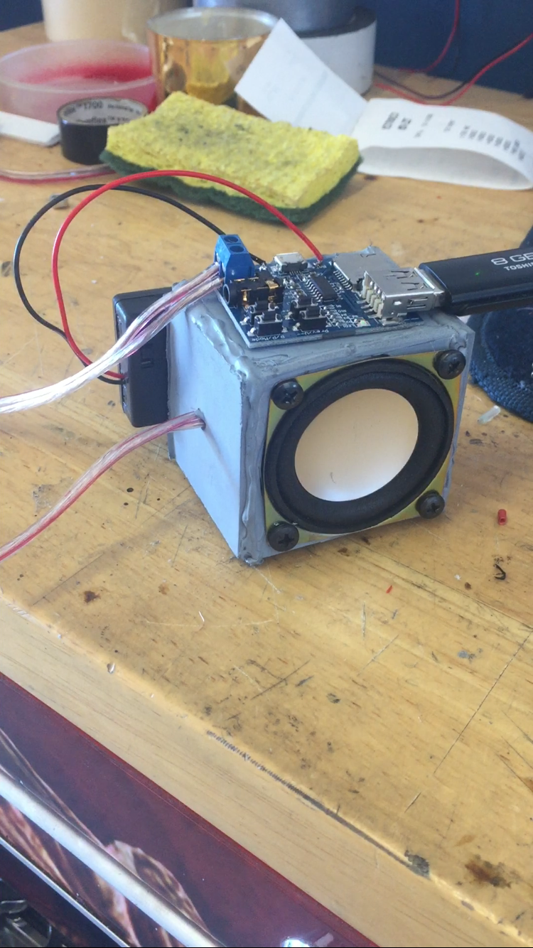

That looks great..Drac,how much space do you have?I am not sure if I missed it..are there any color of leds you will like specifically?..Reason I am asking is because I made an small speaker box with the soundboard and the battery holder,size is around 2 1/2 x 2 1/4 (in inches),it sound really loud...

cool..I think if you do the kit that propmaster told you about(the sound to light,with an small speaker and the sound board with an usb,you have exactly what you need,when doing the sound to light kit dont add the leds to the board,your best bets would be to put longer wires to install the leds wherever needed..Now all you need is how to add the proximity or motion sensor to turn on everything at once,since i am not sure if the sound to light kit has a sensitivity pot,so it can just turn on with the music or sounds..anyways,not sure if you need it,but I am attaching a list of parts I used for the small box,and for the structure I used the foam backing 1/8 thickness and hot glue.(bought at any store,even walmart or target has them)..I will get back to you if I can figure out the motion sensor.

You could always find out..like Amazon sometimes have the same stuff but is a bit more expensive,but might be worth it since its faster..Now if you used the kit propmaster told you about,you could make the box even a bit bigger to fit everything in there or glue it on the outside..good luck,and if i figure something out ill let you know fo sure!
