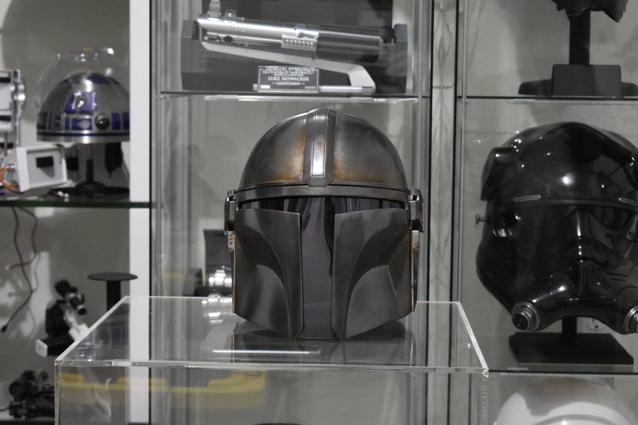

Someone on FB posted photos of their newly delivered Anovos Mando bucket - and it's pretty damn nice. The only major thing that sticks out to me is the vertical visor cut seems too wide compared to the actual screen used helmet. It seems pretty significant. Also not a big fan of the weathering - but I could live with it.

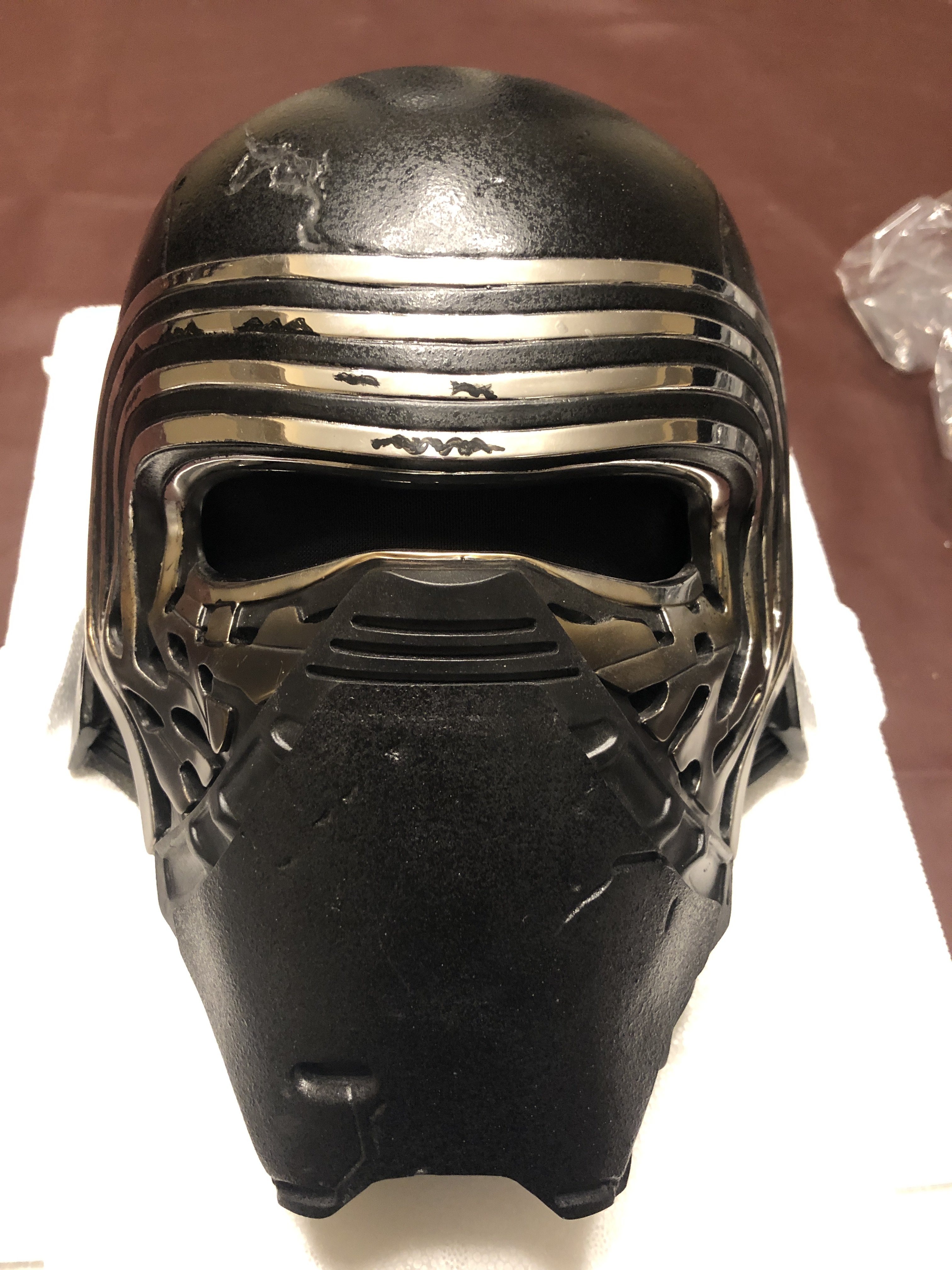

Thanks for the tips. Isopropyl alcohol didn’t touch it. Oven cleaner was kind of working, but it started to take off the chrome on a test piece. So I could try acetone next.
I had similar experience doing the same to a Kylo. Alcohol wont get it. I think acetone got it but only after lots of rubbing at it. I mentioned oven cleaner because i know it will work. I was trying to strip the chrome on mine. The chrome was completely unaffected by acetone IIRC.
Acetone should remove the black marks but not any chrome. But still the black was tough stuff.

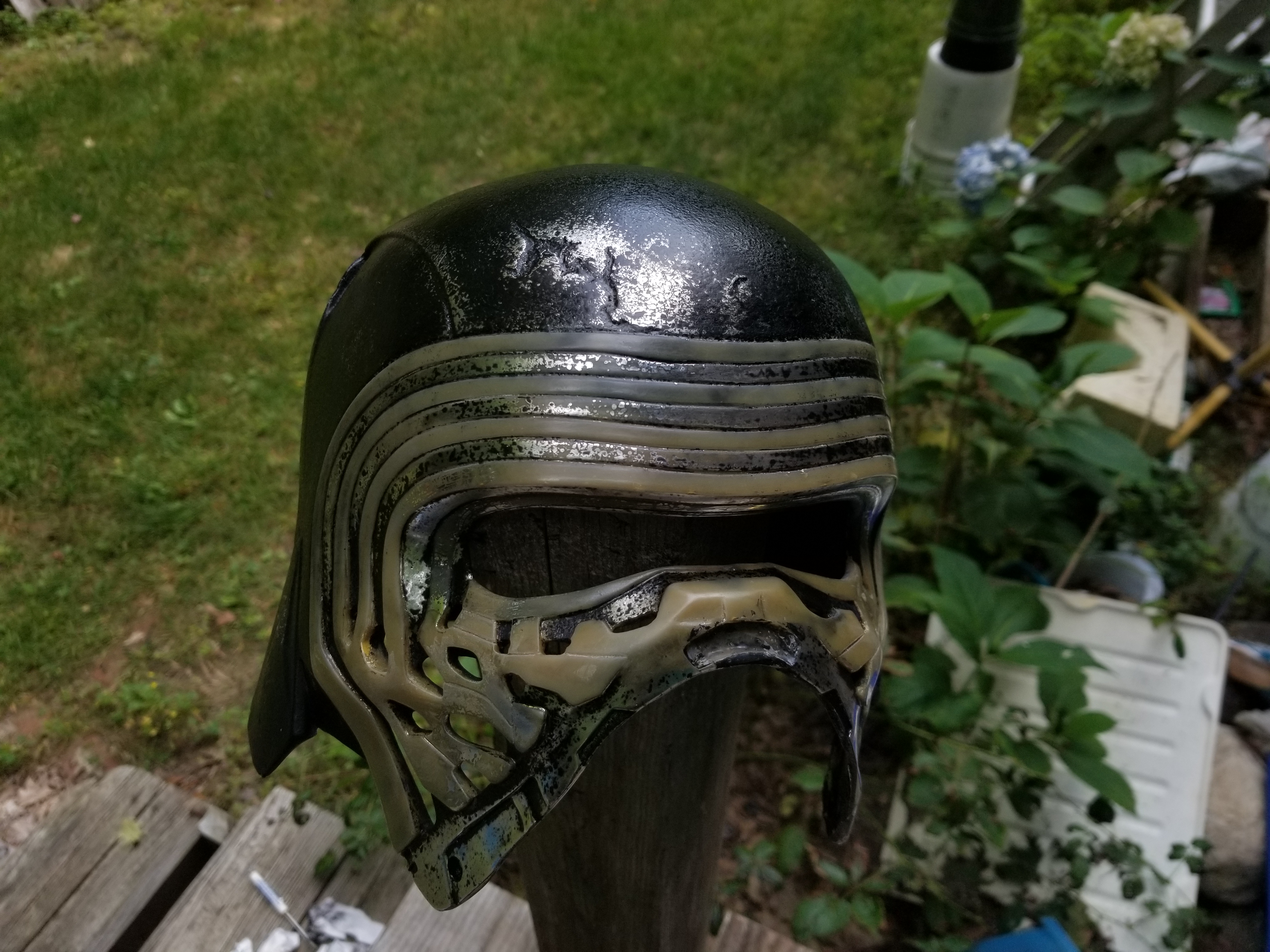

Heres what spraying oven cleaner directly on it does.
Wow! Yeah, that's wild. I'm going to try acetone tonight. I think I'll avoid oven cleaner for now.
honestly, it would be easier to get some black paint and simply improve the weathering patterns.
I agree – the only reason I haven't resorted to that is because there's too much paint already for it to match the screen-used helmet. So adding more paint would even out the lazy weathering, but it's not the look I'm going for. I'm going to carefully try acetone tonight, and if that fails I might just go for that evening out option.
Yikes. One of the distinctive features of the mando bucket is the tapering vertical portion of the visor. This looks closer to Fett than Mando.

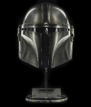

Will be interesting to see how the EFX turns out. Also wish EFX released higher-res versions of their Mando helmets in progress - especially this "final production sample".

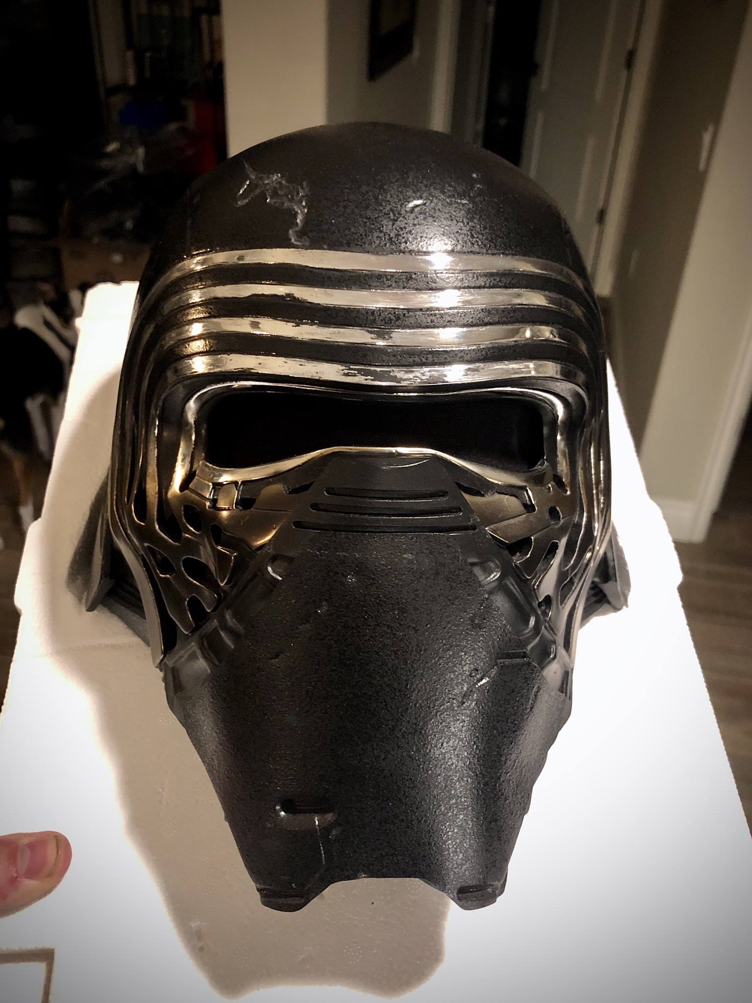

Well, acetone and a little re-weathering did the trick. Before and after photos attached. Acetone does start to eat the chrome, so you have to be SUPER careful. Much happier with the look now.

looks more realistic is the black on the Bottom band in the middle paint or the exposed black under the chrome? How did you apply the acetone? Did much chrome come off

Thanks. That's actually a black paint effect on the bottom middle band, so I can pull that back if I want. I tested a little bit of acetone on an area of chrome I knew I would cover with black – it ate down to an off-white base pretty quickly. So the key was being very quick with it, and wiping off excess with water immediately. I used a Q-tip.

Ideally I’d like the bottom band black free so you think it’s possible with a quick light rub of acetone and then a light wipe with a cloth ?
