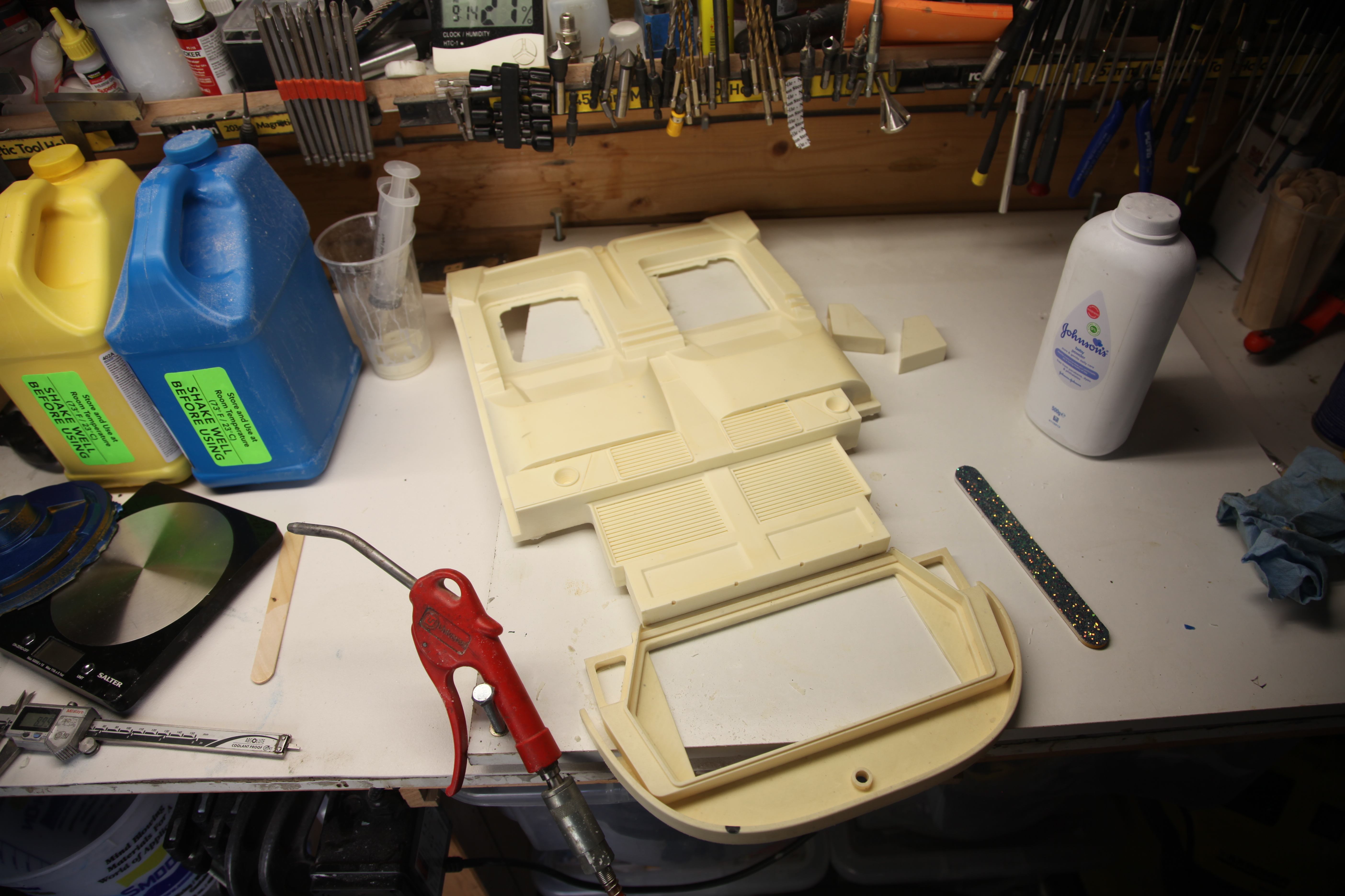

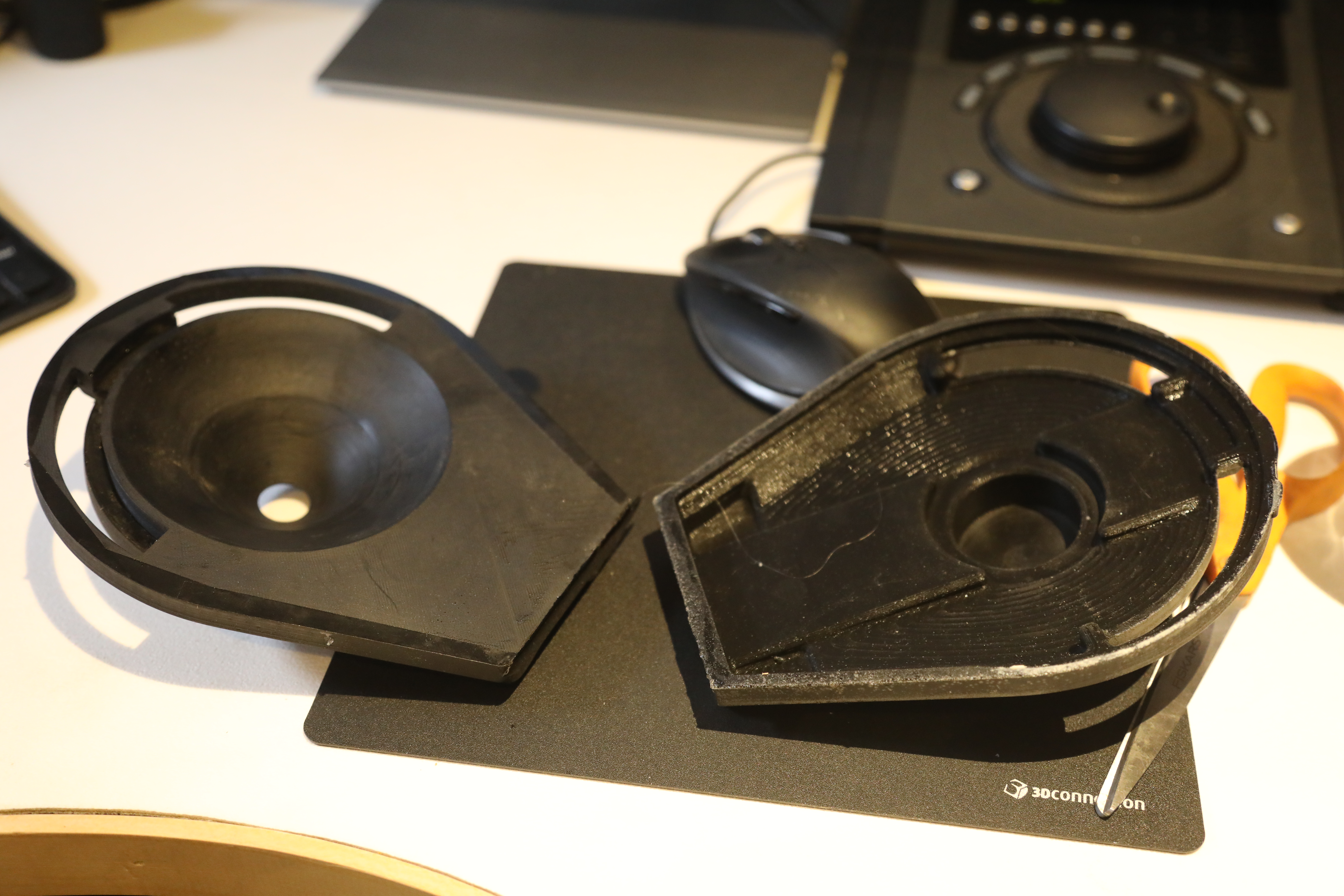

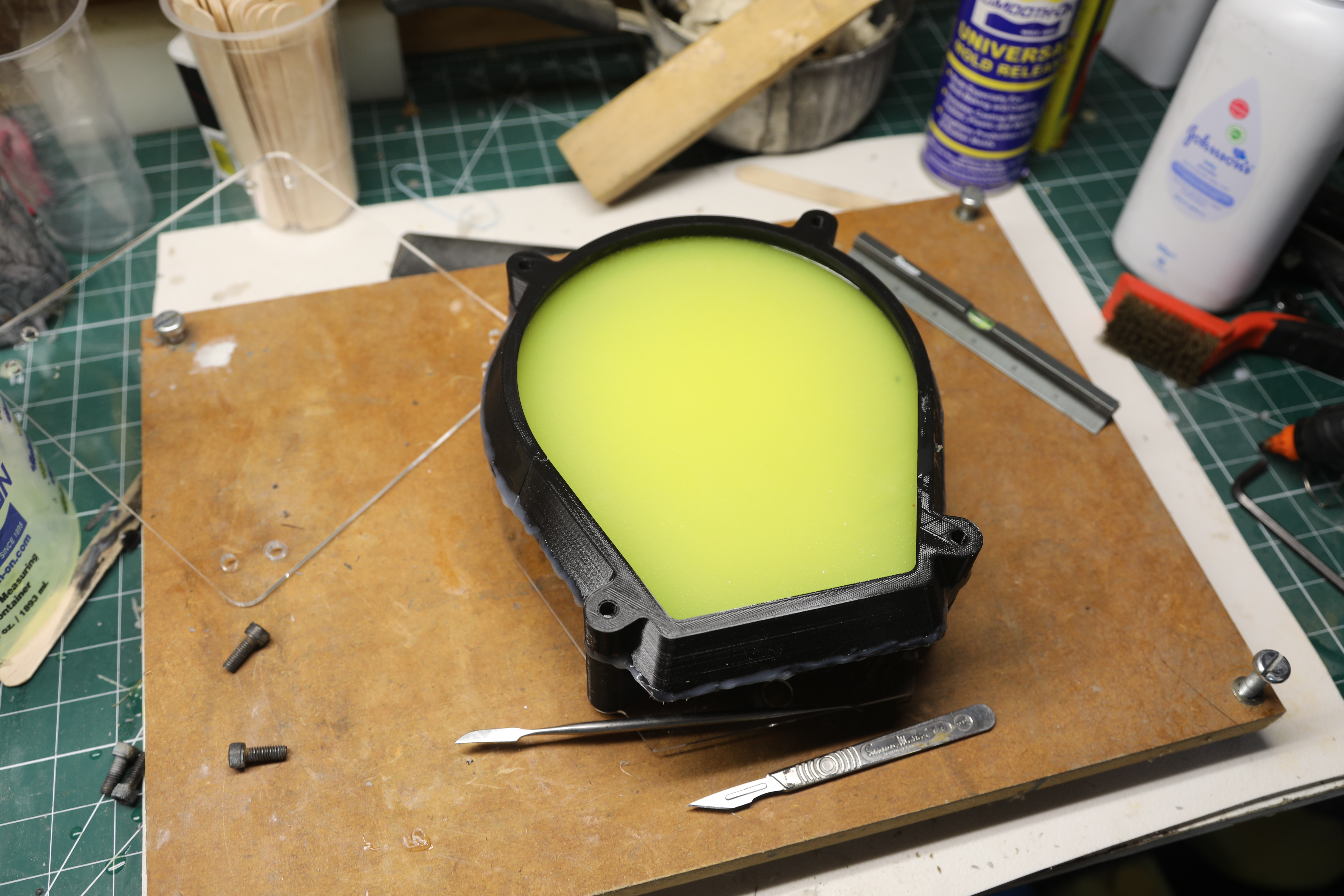

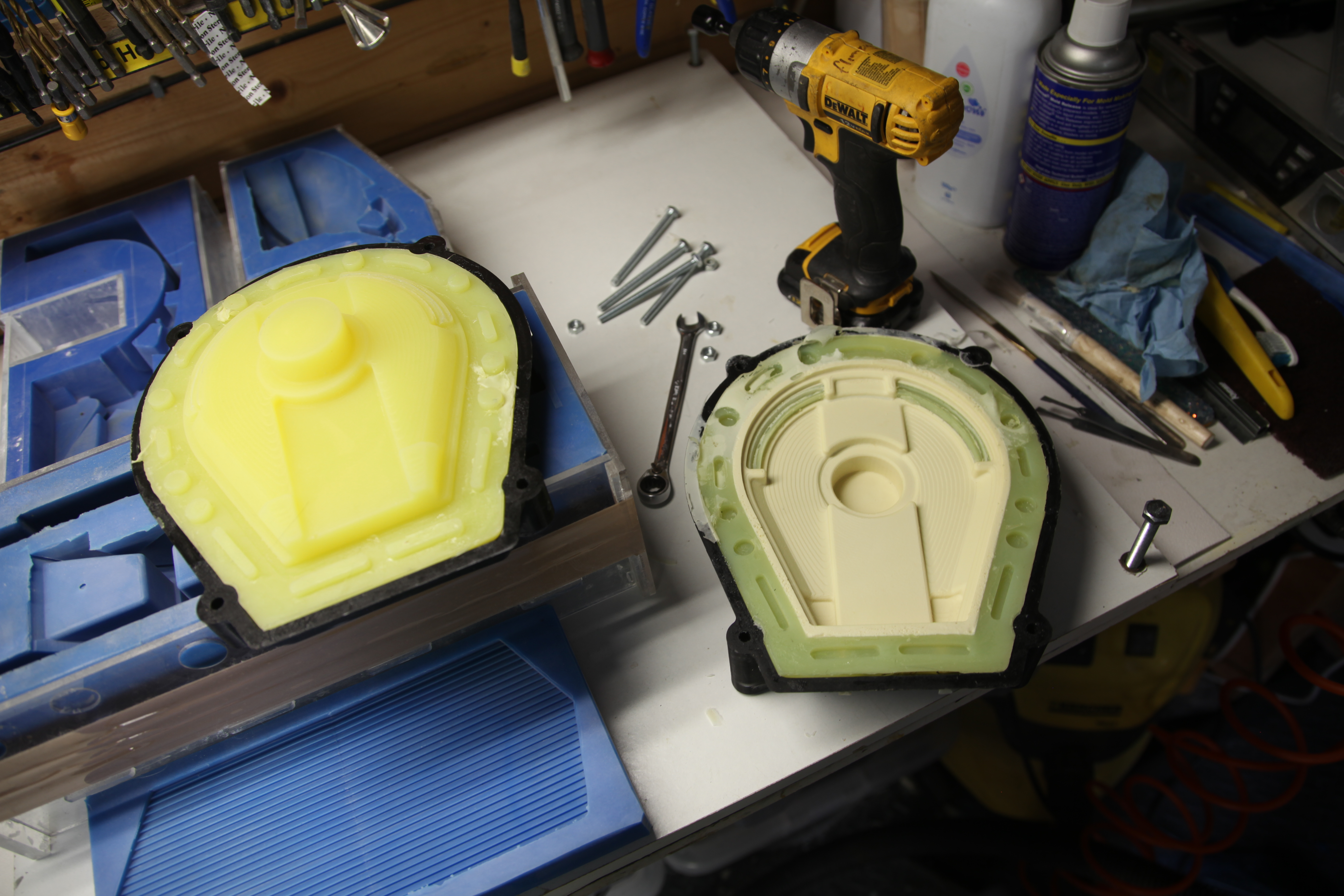

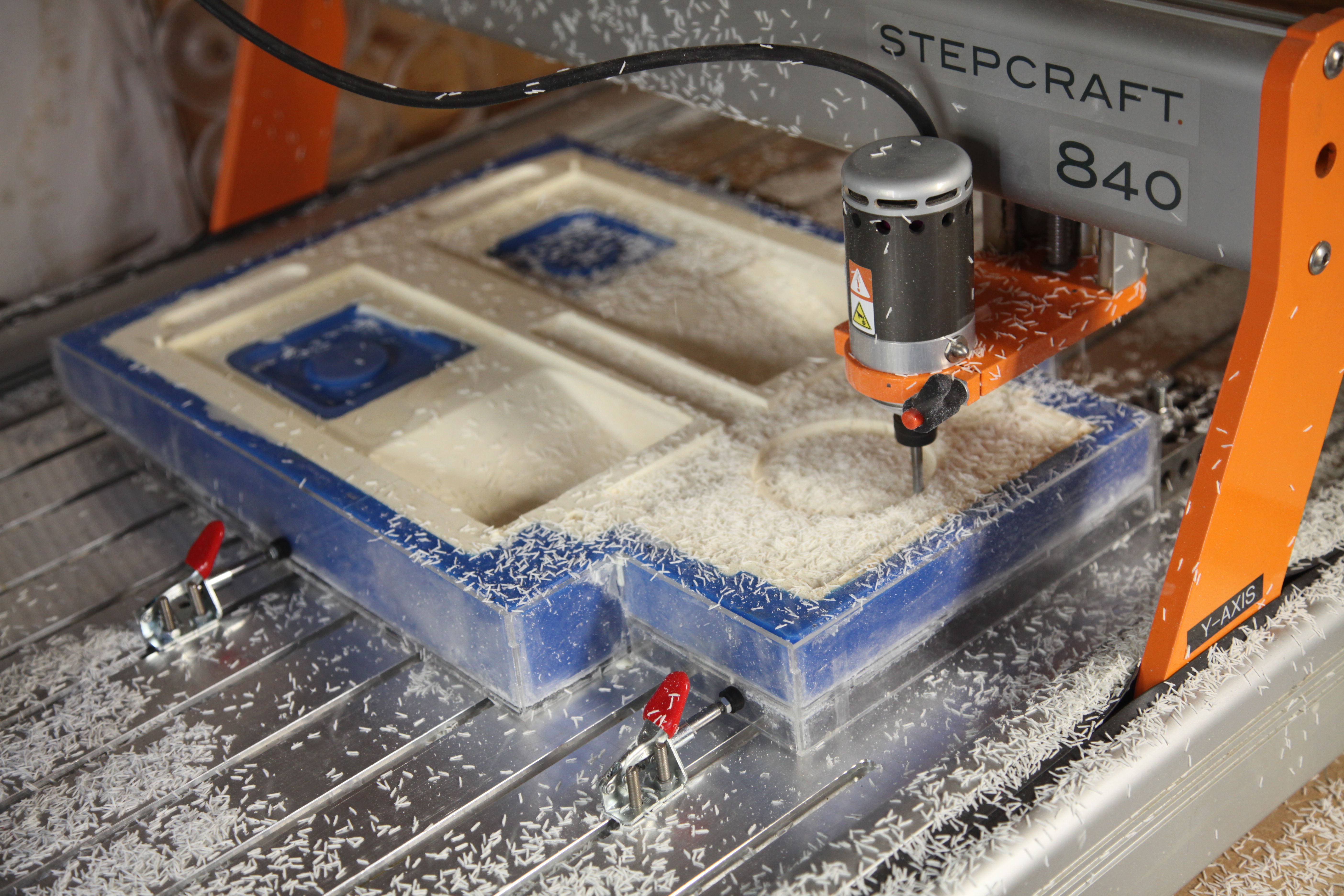

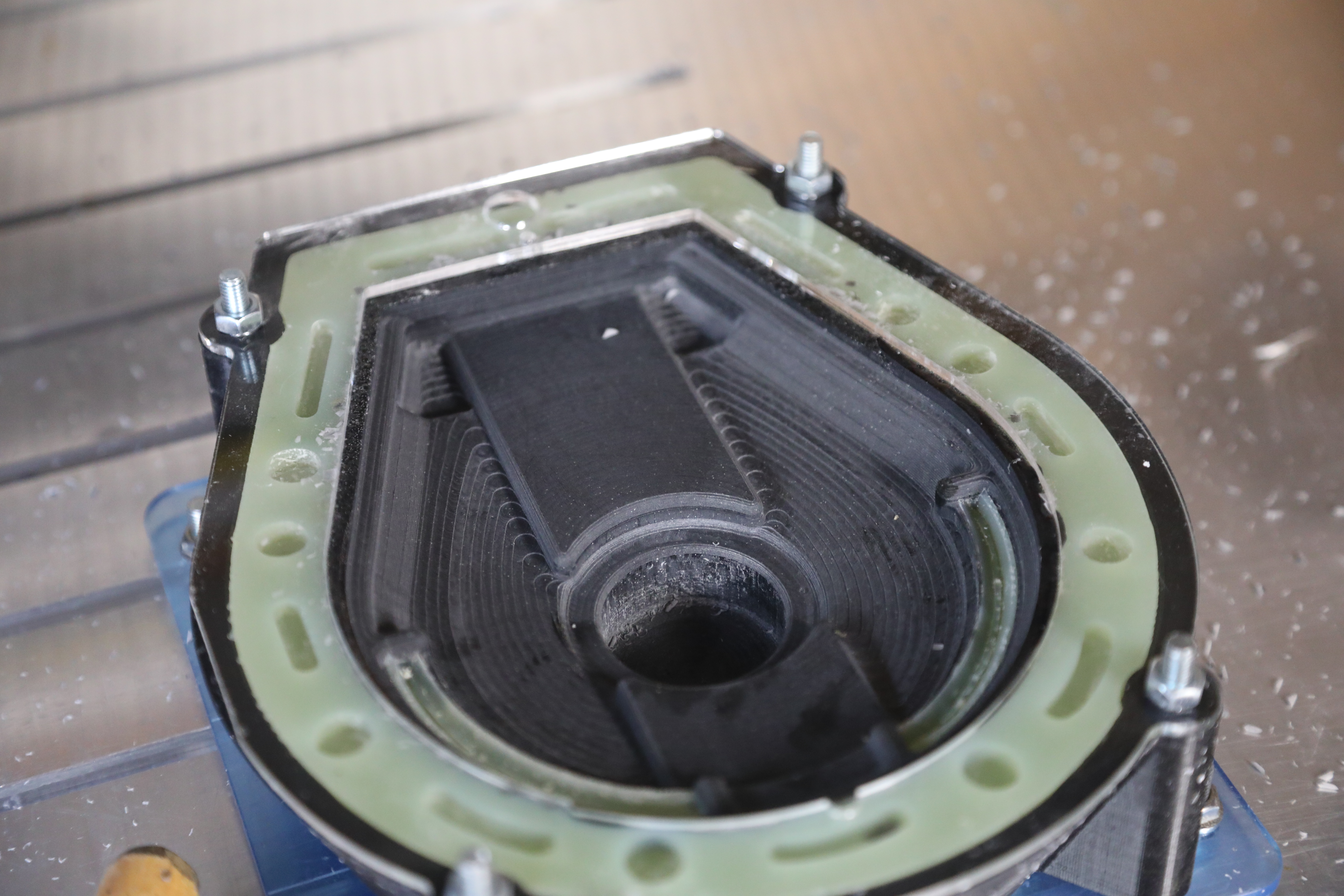

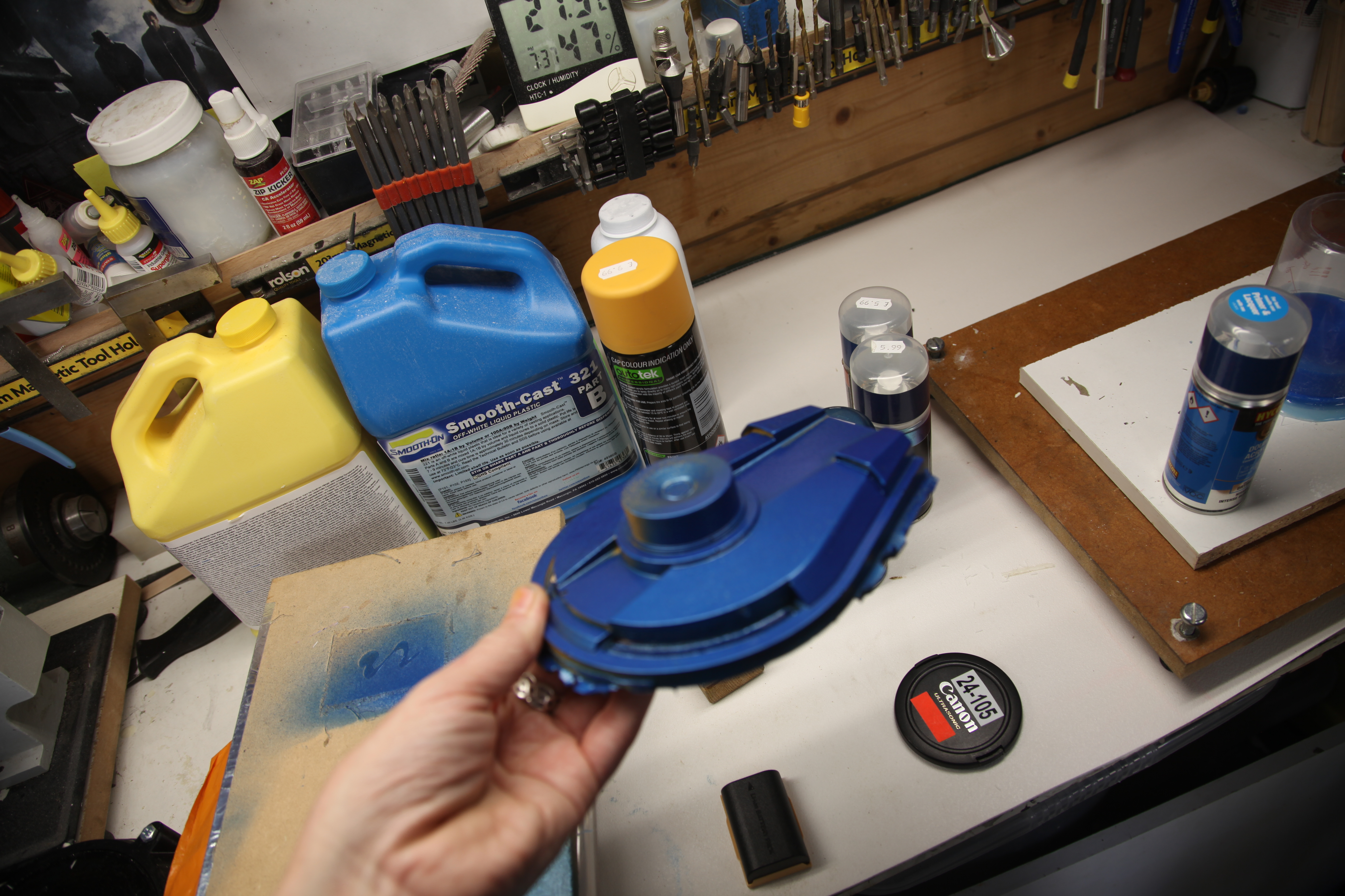

I have a date to go back to work so can spend hobby money again. I started the project designing all the parts so the can be printed on an FDM printer without support and then dump molds made but since then I've got more ambitious in my tiny little workshop. the problem with dump mold is the weight of the final object. I realized as I was designing the mold casing in CAD I could do a dump mold and then go in with the CNC to hollow out the parts accurately.

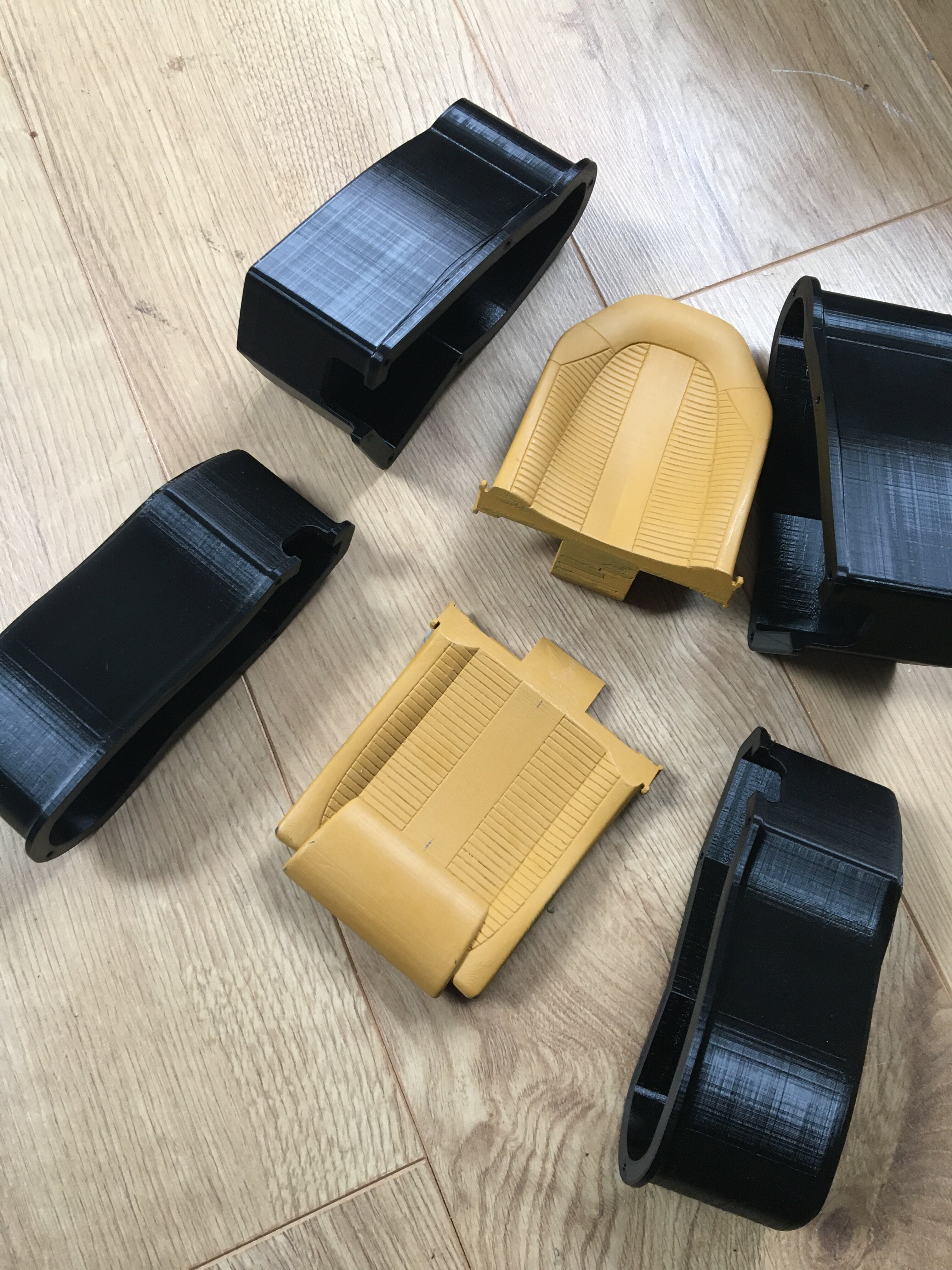

Sorry I've ended up being so busy during covid, Black widow, Dr. Strange, cap Marvel apparently, and some secret stuff. As I've said before this will get finished but in my own time as it's my way to wind down. at the moment it's more about the process than the final thing. I'm sure other people will get there before me but I'm not racing.
I'm still doing a little at a time.
joberg
Those are beautiful seats (y) (y) Don't race, take your time (me thinking: make that model already!!:p) Great work/results cannot be rushed (c'mon man, get cracking!!;):D) I'm patient:rolleyes::p

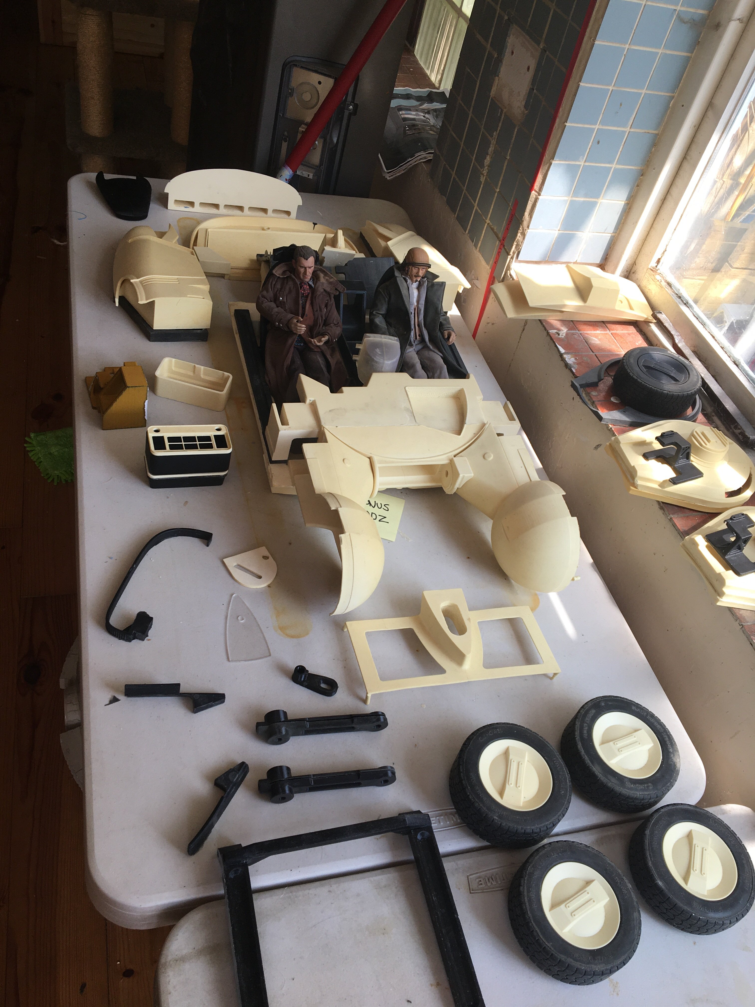

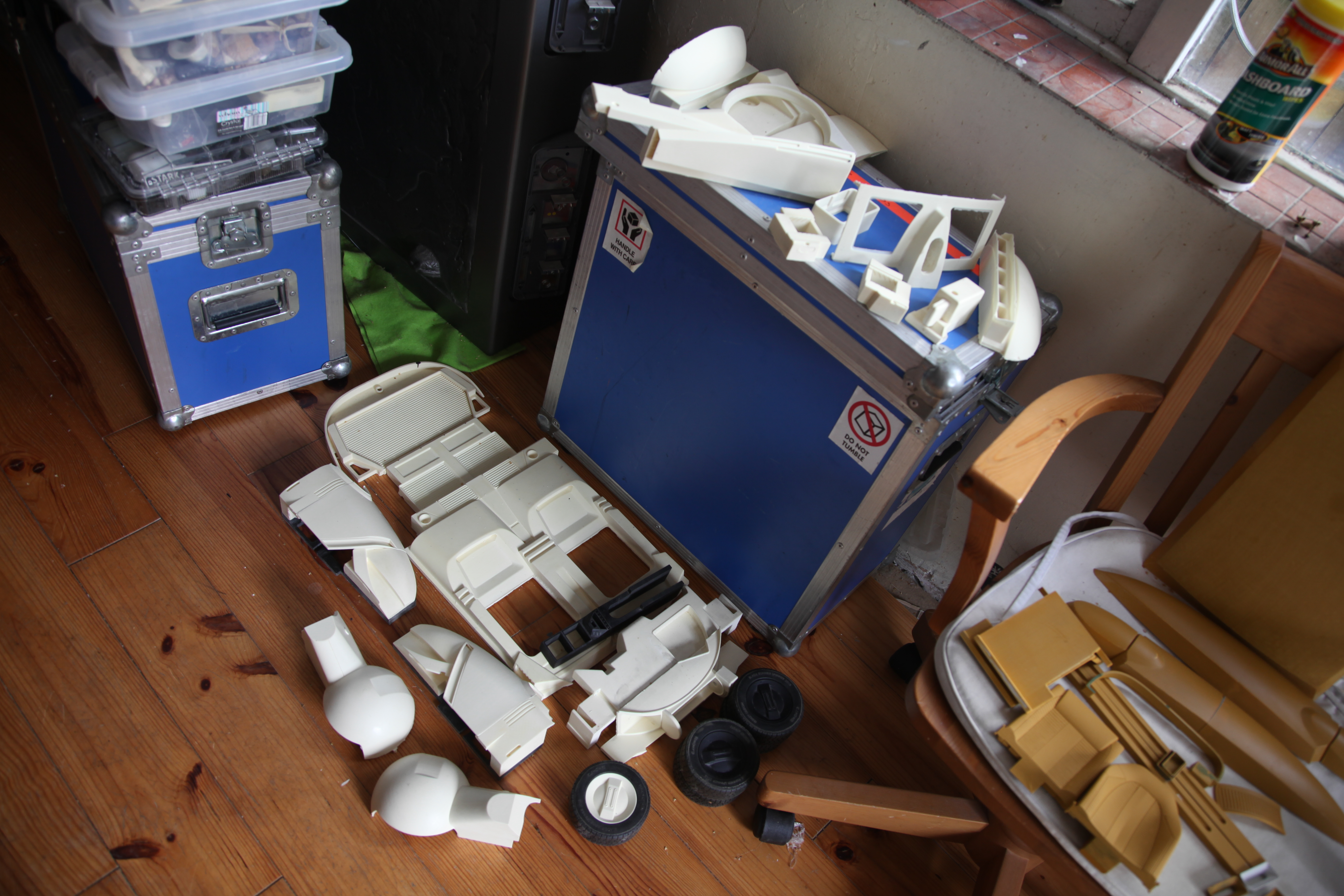

thankyou everyone for your interest. Yes, it did make me feel bad, so in a way of a teeze 95% of the molding has been done. now its down to the wheel mechanisum before gluing it together. thanks to teslabe's help I will be doing graphics on the small screen but I think the larger screen will need to be a translight. For me having the wheels operate is more important and I need the space. there's still a lot to do.
