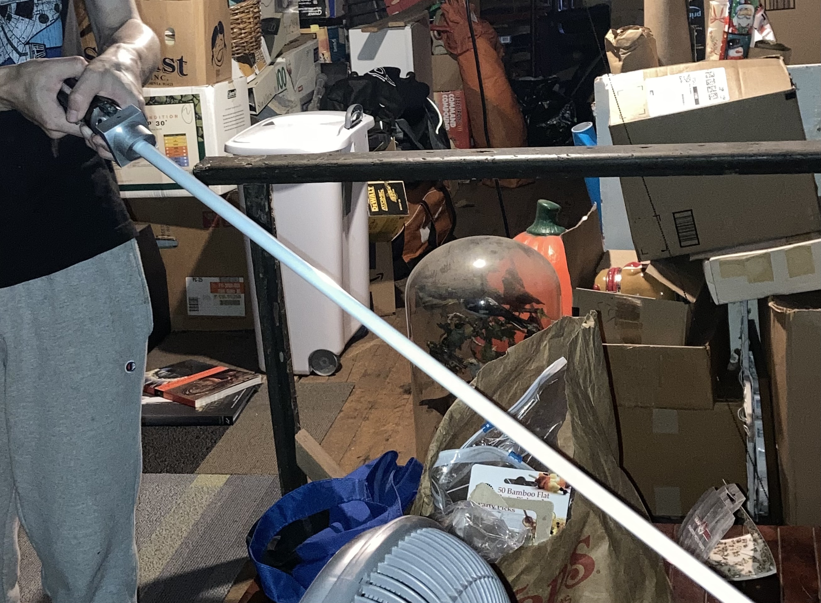

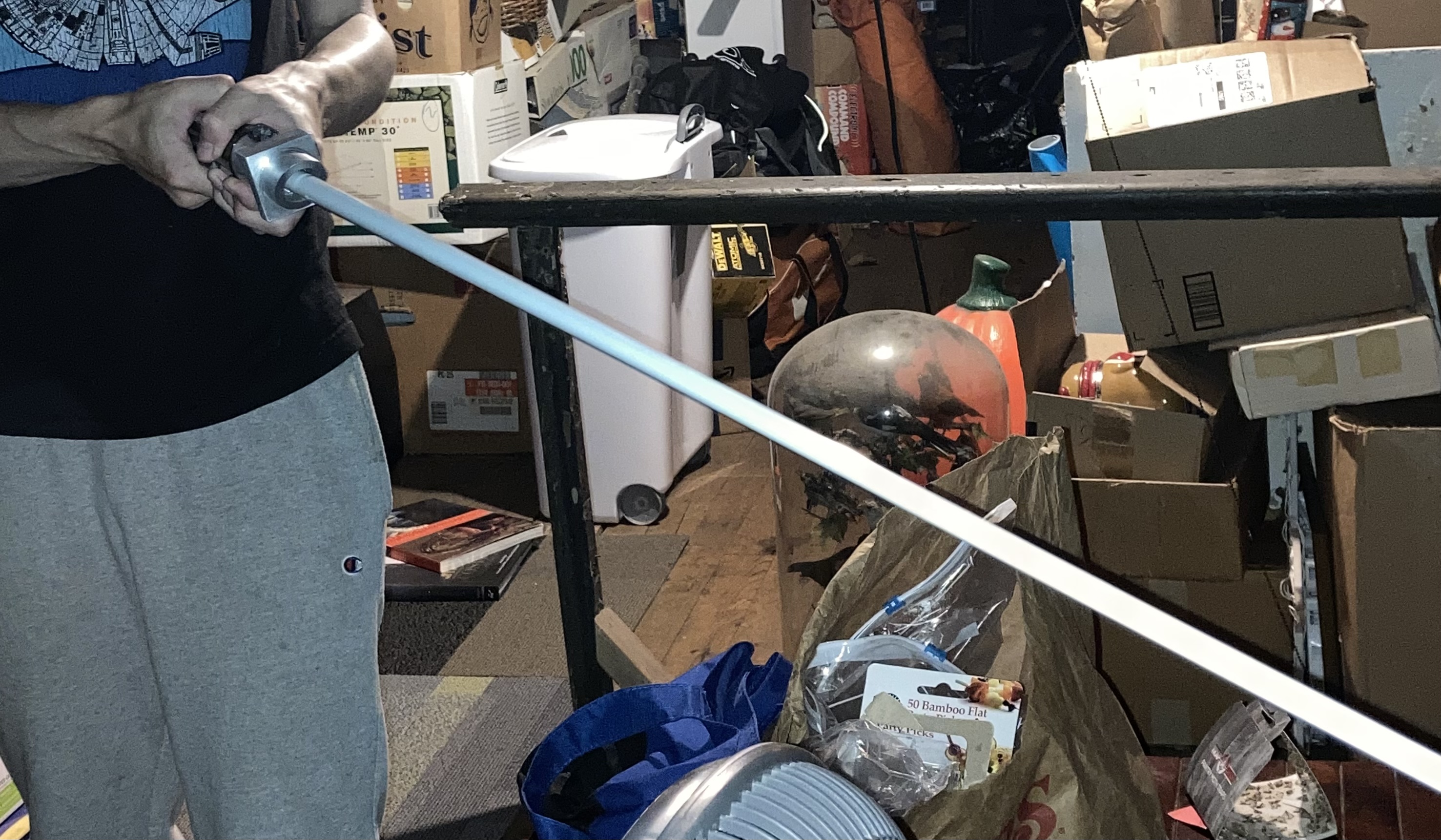

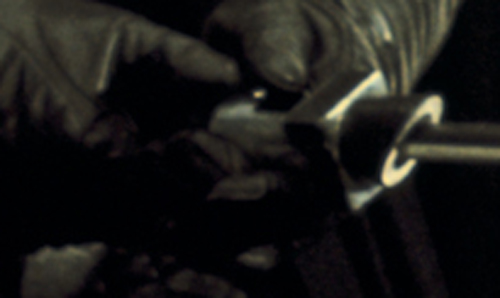

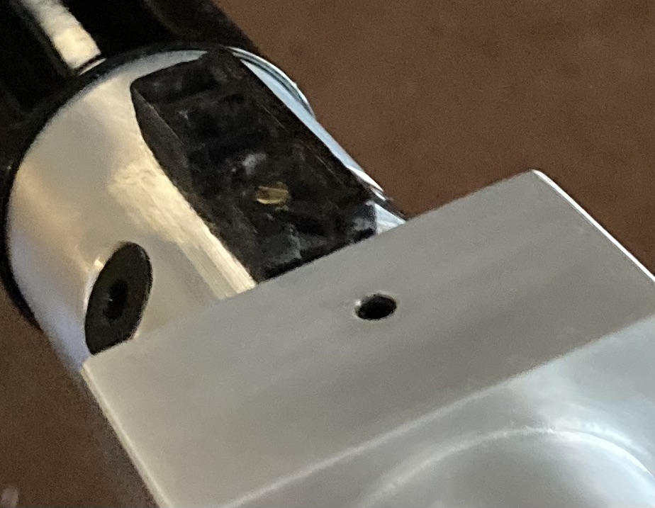

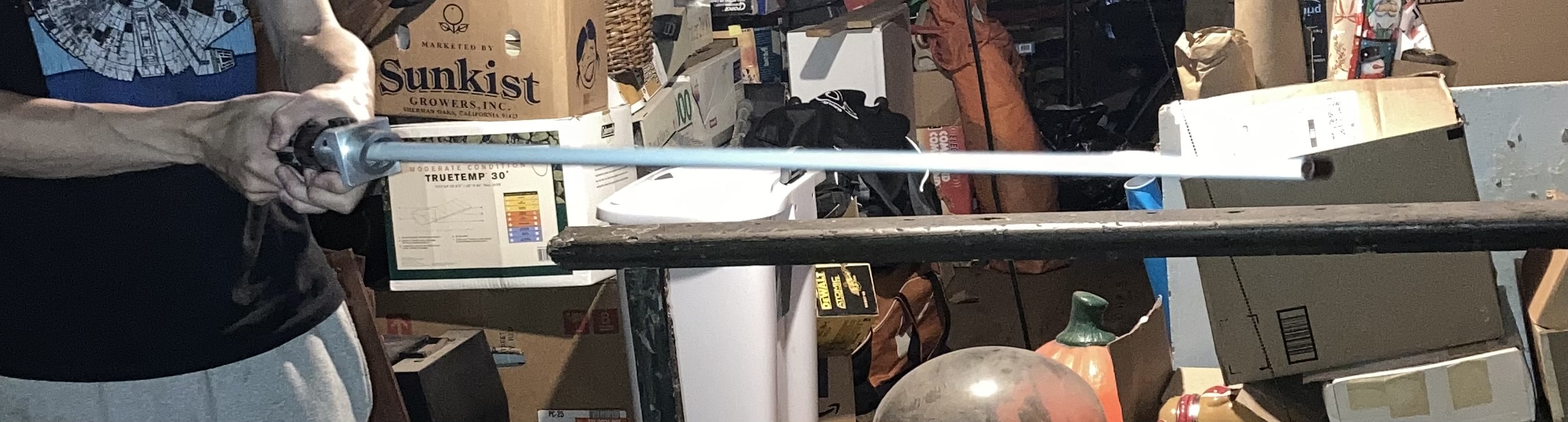

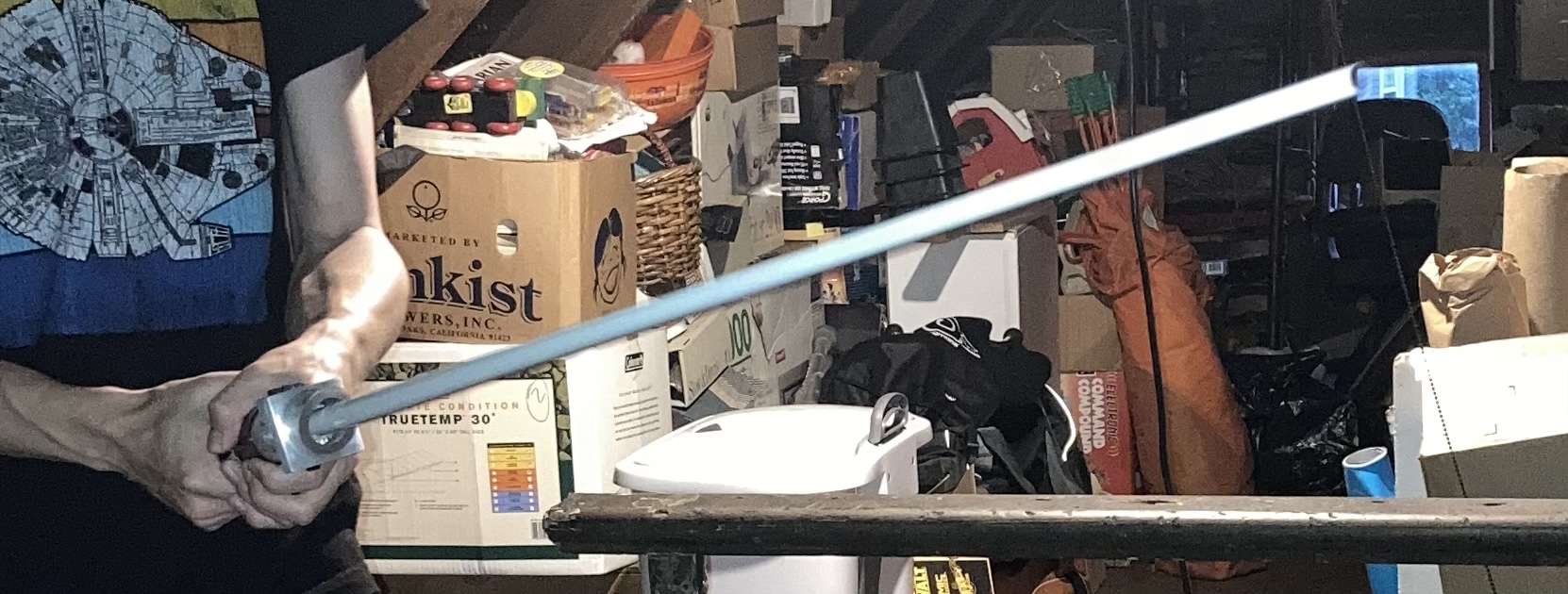

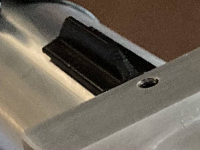

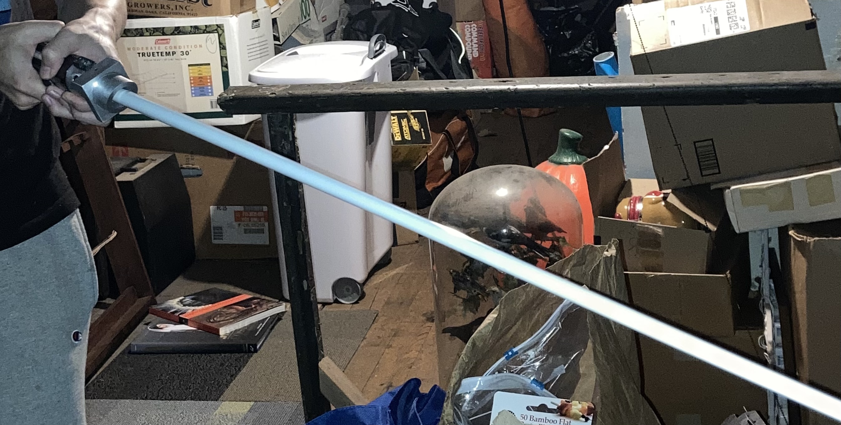

yeah, I don't know! it looks slightly short for the mistery activation box, although I guess this is it. and the carved short grip is clearly visible on the other side on the other photo of this saber. do you think they used a carved grip on both sides at first?
oh and thank you so much for those pics! I first saw your message on my phone and turned on my computer to reply to your last message and forgot to mention the pics! those are absolutely great! they are super cool to model that other mistery part on the shroud, I didn't have such good references of this before :)

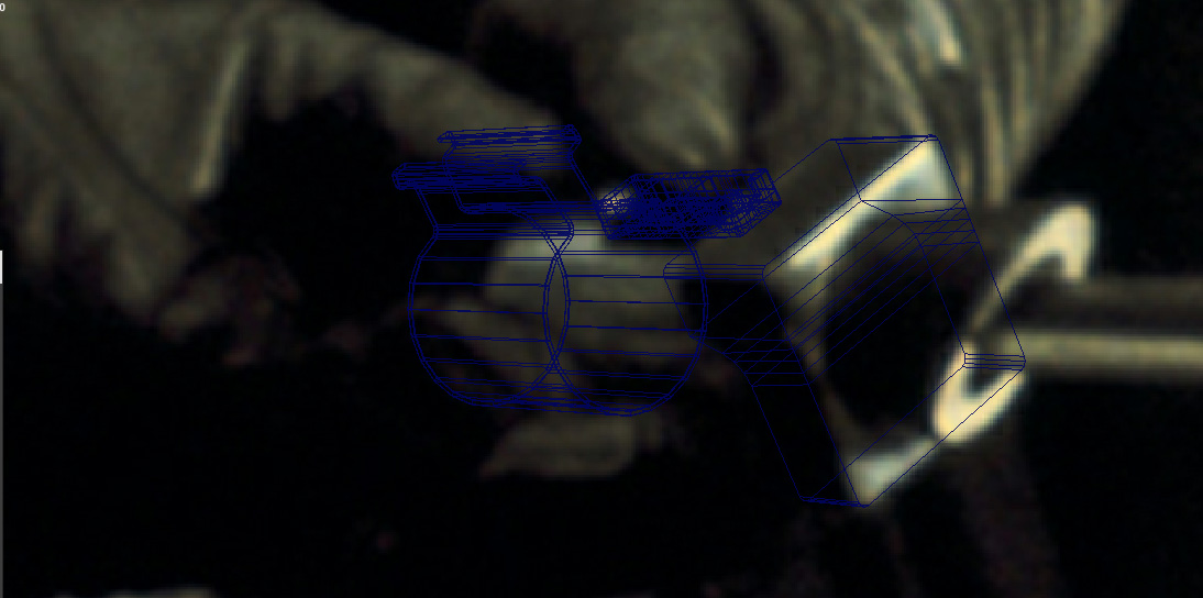

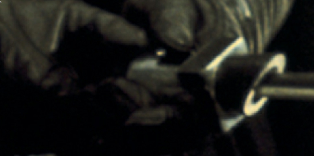

Tom, can you try and mimic that exact angle of the screen shot above with the mystery box on your saber?
I know you were not asking me and I hope I'm not too present on this thread, but I thought a 3D match could be faster and maybe more accurate as I can play with the focal and position more accurately with the photo underneath my 3D model.
well, the weird thing is, I think the length is actually ok for the mystery box and the position is matching, BUT, that's the clamp that is way below on this saber! that's why i thought the proportions were wrong.
Don’t apologize, this is super helpful. You’re right… t track are shorter, if there at all… moving the clamp lower. I think in ESB there is foam at some point or something. vadermania i will deliver today or tonight.
I kept looking at that and the angles were all wrong if that was another piece of T track. Especially because I just made my own…
Yes, that‘s exactly what was confusing me - the position of the clamp. Let me dig into my archive and see what I can come up with.
