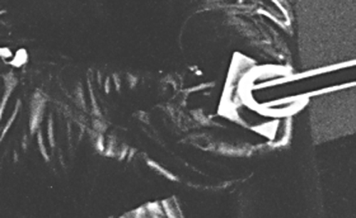

    Hi guys,
    The Barbican is the Vader ANH dueling saber with the square shroud at the top, as notably seen on the Kenner cardback. Yes, there is an image of Vader dueling with a saber without the square shroud - this is the Luke dueling saber with the emitter painted black, as also seen in a Hamill publicity photo. But the one with the square shroud was clearly meant for Vader / based on the MPP belt hanger.
    Photos of the Vader dueling with square shroud in ANH:
    Note the piece of T-track at the top, just under the hood, on the "short emitter side." That is not on the prop today, but was post filming and is seen in the "Vader severed hand" prop, which is a cast of the Barbican, obviously made for ROJ. Some of the other greeblies may have been in place during ANH, or may have been added later (when it was reconditioned for ESB or ROJ), hard to say.
    Other things worth pointing out:
    1. Note the T-track grips are proper OT grips matching other sabers, not slightly different/resin cast grips seen on promo sabers built in the 90s.
    2. Note prominent hole visible in grip area where on/off button would have been, just like Luke's saber.
    3. Note how the rounded radius of the shroud meets the square part in a rough/uneven manner - it was clearly ground down later to better match the other sabers.
    4. The Barbican doesn't show up in any other photos from ESB or ROJ that I'm aware of, but is present in a post-ROJ filming inventory photo along with the Vader Graflex, the hero MPP belt hanger (now in the collection of Stephen Lane), and the Vader MPP dueling saber with allen bolts (MIA today.)
    5. It has a real MPP clamp as you say while the other promo sabers don't. They didn't have MPPs around when building promo sabers later on.
    6. Again, the Vader severed hand saber, which was obviously made in 82 for ROJ filming, is an exact cast of the Barbican. How did they have an exact cast on hand for ROJ if the prop wasn't made until the later promo sabers?
    In vader45's post above you see the Luke painted as Vader saber, which must have been used when they had some trouble with the square-shroud one. Here's a publicity photo showing that same saber in close up.
    The reason the 90s promo sabers are similar to the Barbican is because they were copies of the Barbican. But the Barbican is absolutely an OT-era saber.
    Are there photos of promo Vader sabers being used circa early-mid 80s? I do not believe any "promo" Vader sabers were made until the 90s, and again they were made as copies of the Barbican.
    Best,
    Brandon

    The angles aren't perfect here, but:
    Top - Vader ANH photo
    Middle - Barbican photo
    Bottom - Vader severed hand saber photo
    What other sabers exist in the OT with the very thick walled emitters?
    Brandon

  25. BAlinger15
    BAlinger15 Community Founder
    Trophy Points:
    835
    Yes, as Seth says above - they started the film with a motorized dueling saber for Vader and another for Luke. Vader's had the big square shroud on. At some point, they painted Luke's with a black emitter and let Vader use it for the duel.
    After ANH, at some point the square shroud on the Vader dueling saber (aka the "Barbican" due it first being displayed there) was rounded off to better match other Vader sabers. But I don't think it was used for filming again. I don't think the Barbican shroud was ever used on the Luke motorized saber.

    [​IMG]
    [​IMG]
    Thanks Brandon for these pictures . . . one other piece of compelling evidence that this saber was indeed present
    before and during filming of ANH and as far as I can tell not mentioned yet, is . . . the attached stunt rod which, as
    we know, was partly black and silver due to light reflective tape to create the laserbeam effect as was Obi-Wan's ...
    and Luke's lightsaber :
    [​IMG]
    Since the first action figures* came out almost one year after the release of STAR WARS why then was the next picture of Darth Vader with that ANH stuntsaber chosen for the packaging? Any thoughts about that?
    [​IMG]
    Chaïm
    * See the first episode of 'THE TOYS that made us' :
    [​IMG]
    SethS likes this.

    I don't see how the dueling rod enters into the equation as it is not present on the prop today.
    You want to talk about toy package design? :wacko ;)
    There are a couple things about this new info that are interesting to me. One is we now have a more rounded out picture of the three motorized stunt sabers that were made for each character in ANH, and the evolution that each of those props took throughout production of the trilogy.
    The second is the significance of the ROTJ hand gag casting. It shows us what Vader's ANH dueling saber turned into... As far as we know it was never used again on screen, but for some reason it was finished not unlike a Hero prop. But why? That's very interesting to me.

    Apart from all the points made by Brandon to convince us the Barbican stunt was around in 1976 for the shooting of ANH he could also have pointed out the stunt rod with the reflective tape as seen in both pictures as evidence ... it is an obvious clue it was prepped for shooting.
    Indeed I always wondered why the picture on the packaging used that particular Vader with the stunt saber whereas it clearly did not represent the MPP based belthanger lightsaber :wacko

  41. SethS
    SethS Master Member RPF PREMIUM MEMBER
    Trophy Points:
    2,791
    Looking at the first two pics Sym-Cha posted, it looks like t-track on one side, and a faux MPP release on the other.

  42. russellsch
    russellsch Sr Member
    Trophy Points:
    1,891
    That's what I'm seeing as well.
  43. thd9791
    thd9791 Master Member RPF PREMIUM MEMBER
    Trophy Points:
    3,001
    thanks everyone for clarifying. There are two bits behind the shroud and the bulb release area is indeed copied, but the T track we were talking about is where the front S ports are on an MPP.
    if the current un-IDed part IS the same as ANH, that means they had access to the push button switch used to renovate the stunt-turned-vader graflex way back in ANH. the greeblie on there today is the same as the promo sabers, and it's the bottom plate of the switch. But cut short (one section is trimmed off). The gaps in the perimeter of the greeblie, when used as the bottom plate, look exactly like the gaps in my white push switch for wires.
    Rare-LFL-Lucasfilm-Archives-Movie-Prop-Lost-Photos-Star-Wars-Indiana-Jones-Historic-Visit-Origin.jpg Darth-Vader-Return-of-the-Jedi-Lightsaber-Profiles-in-History-Compare-Energizer-Bunny.jpg s-l300.jpg s-l300.png
    SethS likes this.
  44. dcarty
    dcarty Sr Member RPF PREMIUM MEMBER
    Trophy Points:
    1,980
    I guess we'll have to agree to disagree as it looks like T-Track on both sides to my eye.
