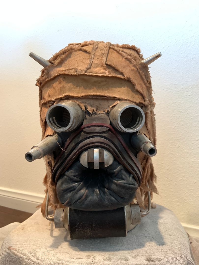

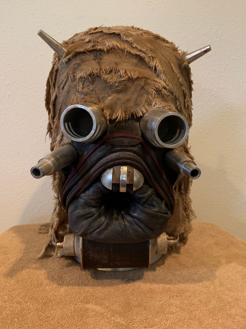

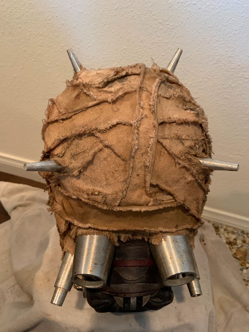

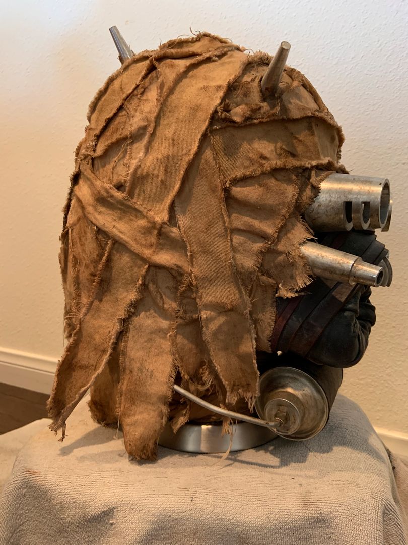

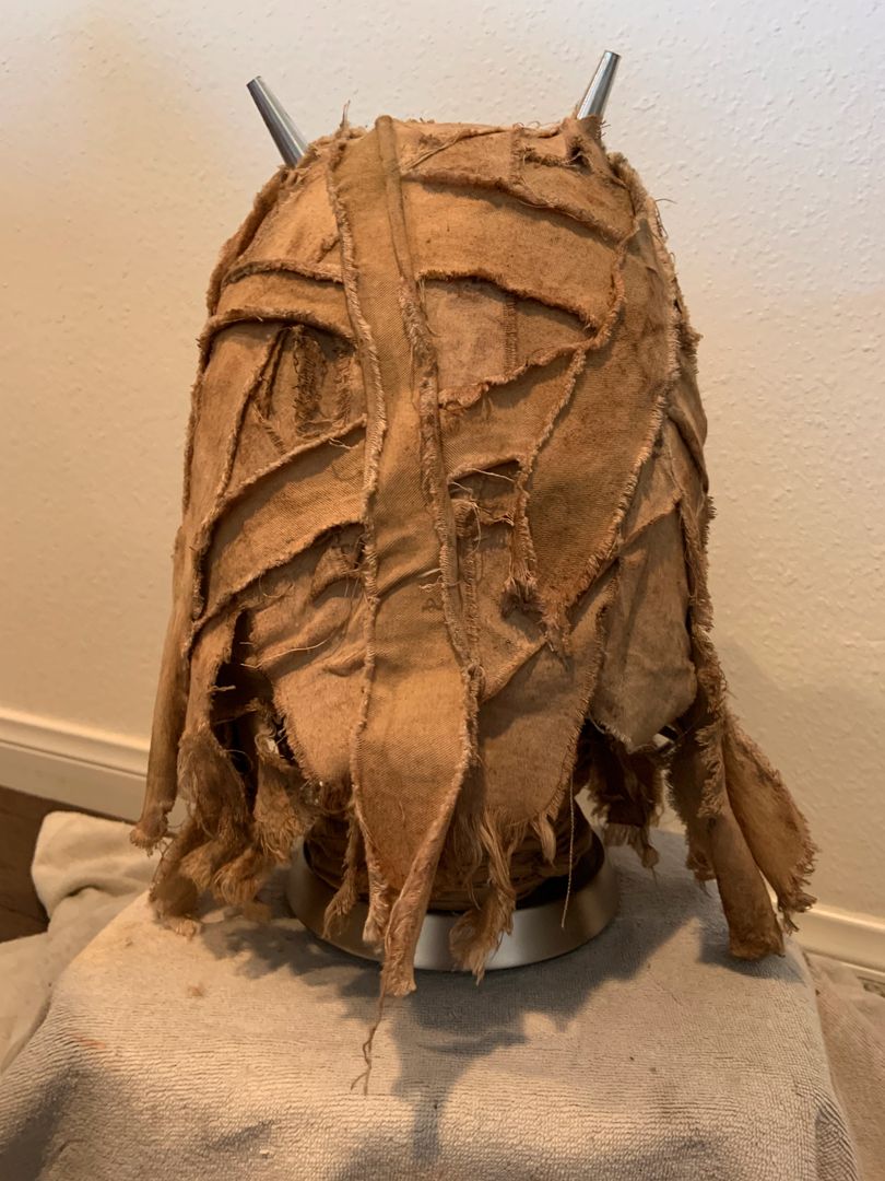

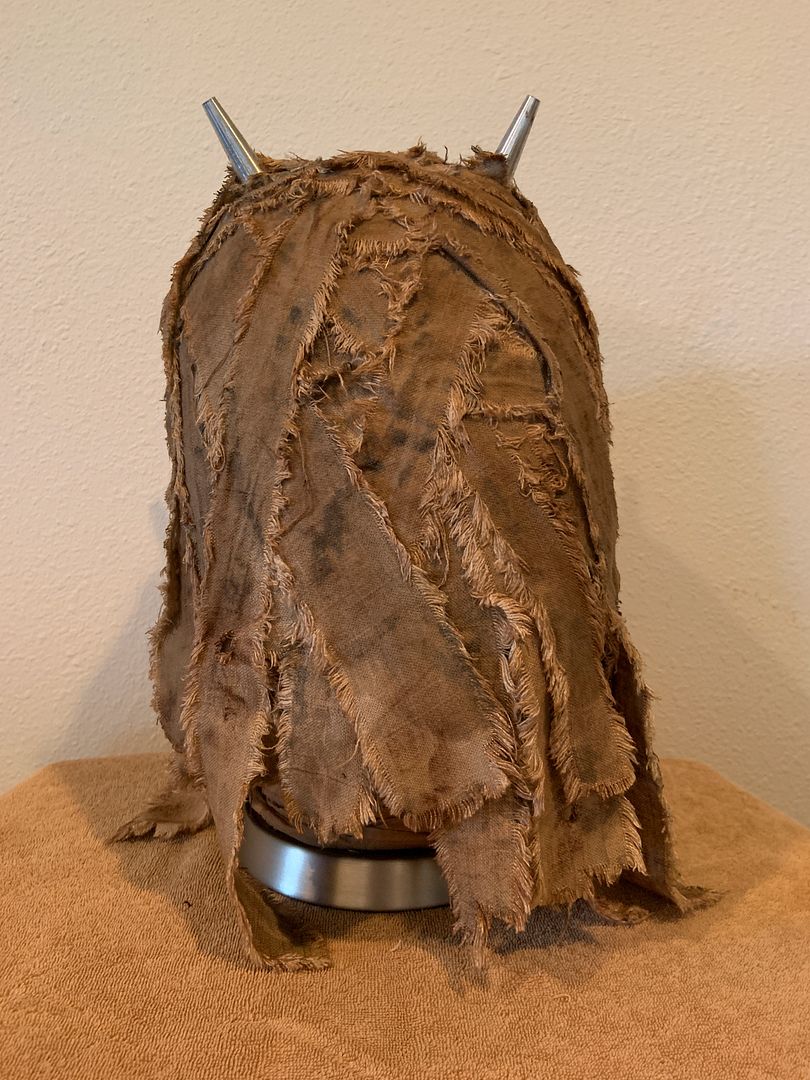

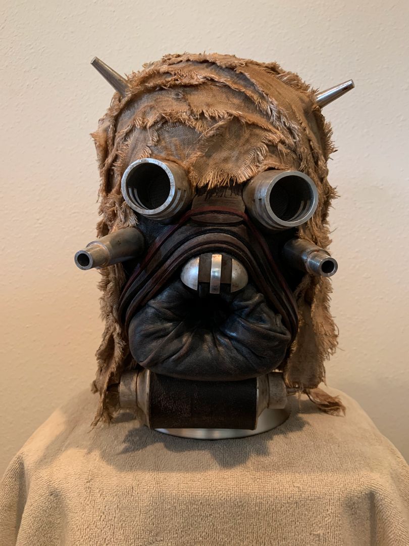

With the whole COVID 19 Stay at Home, I decided to try and make my Tusken's wraps more dimensional vs. so flat to his head & really make him filthy dirty, I like him much better now!

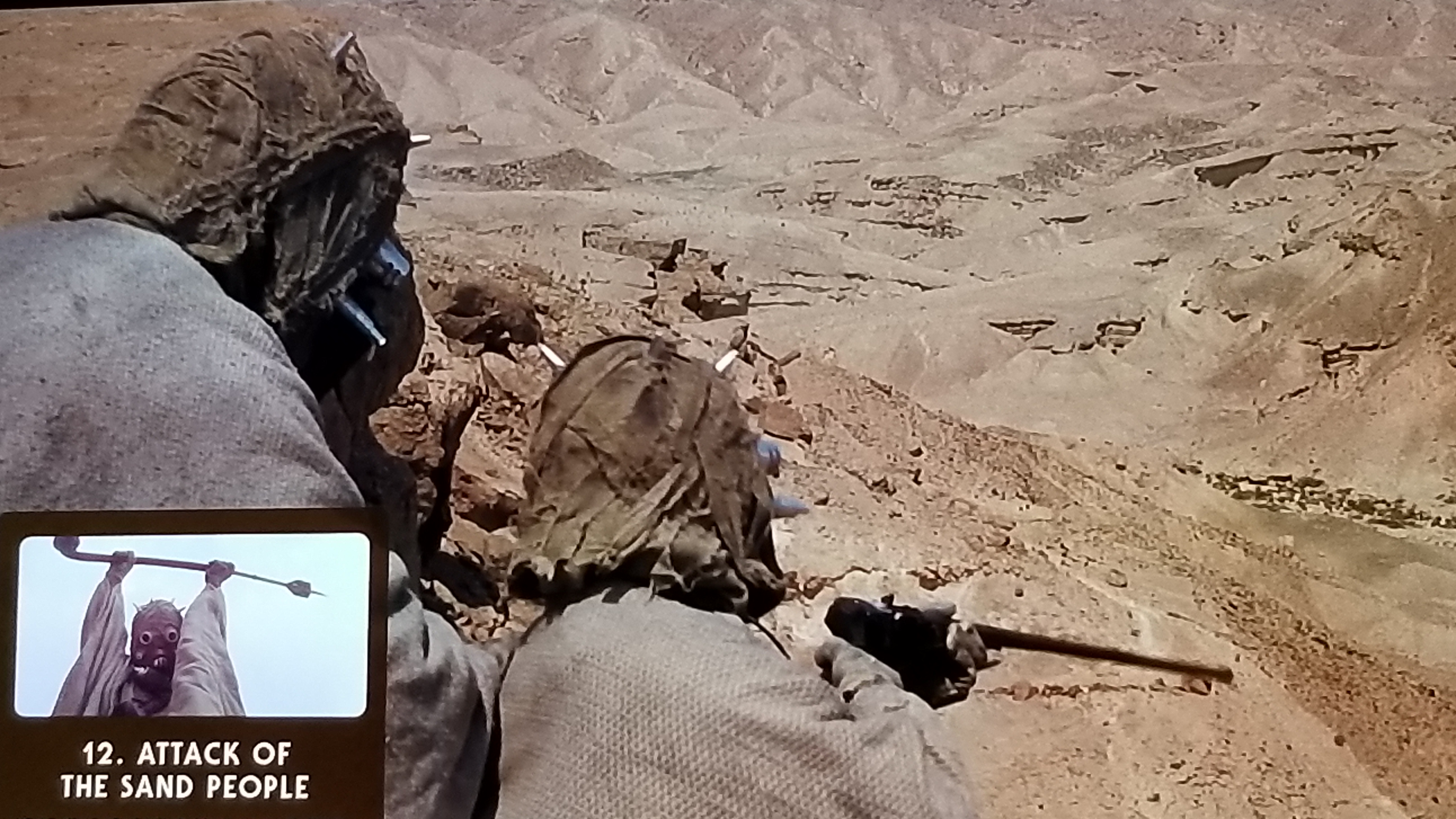

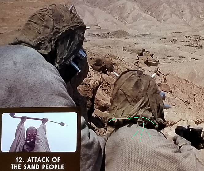

Using this screen shot as a guide for loose and relaxed wraps and how dirty they were

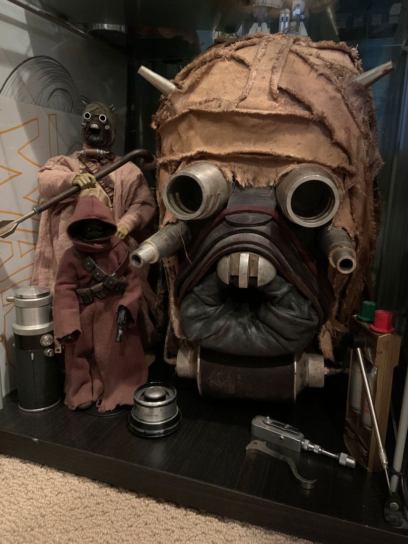

Back home in his display case
Looks great, Chad! A lot more like the screenused Tusken now.
What weathering method did you use? I was so happy building it I completely left it unweathered back then... :rolleyes:
I will go for such a weathered look on my Godzilla mask also but couldn’t decide on a good way to do it with wraps already glued onto the mask yet.
RoCKo your wraps look nice and relaxed! I used tan, rust, and black washes on the leather & machined parts, black & grey inside the tusks and eyes & eye mesh. I carefully used a variable speed drill with a brass brush bit to heavily distress the edges and areas of the surface of the wraps, then I used a gas torch to burn the fuzz & excess strings, then hand distressing w rasp files, razor, and wire brushes. Dark brown oil based pastels & black wash dry brushed to low spots and selective edges & a few fine spatters. I don’t really like the material in the kit as it’s too smooth and the weave is tight but I haven’t found one I like either. Try getting something dark deep inside the mouth too.

it’s a Tusken, you cant ruin him, he’s already a mess! Dive in and make him dirty and really beat up. Most of the Tusken I‘be seen are just too clean and nice, even the last stage of mine was too clean. Look at the screen shots or movie stills, these guys are badly beat up and just nasty to the bone dirty, they’re filthy dirty Sand People, do their character justice and have them look the part!

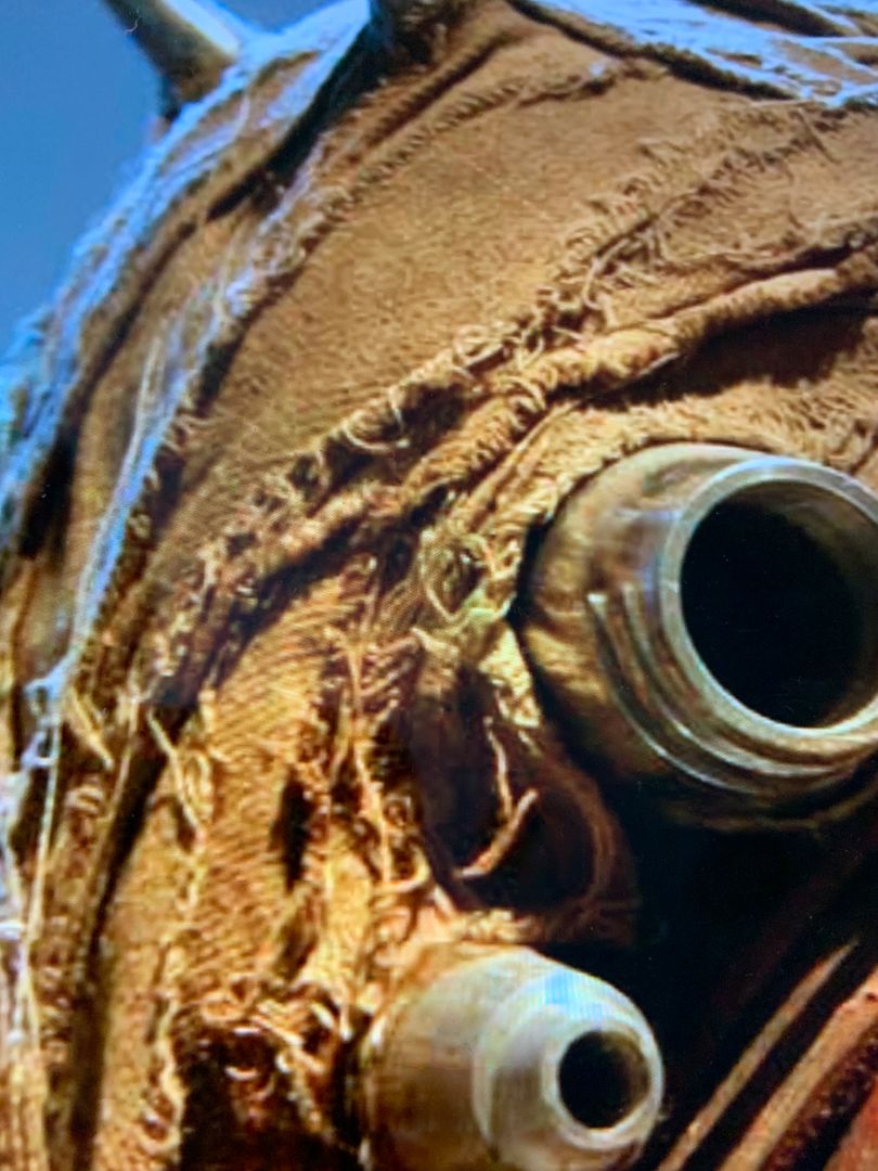

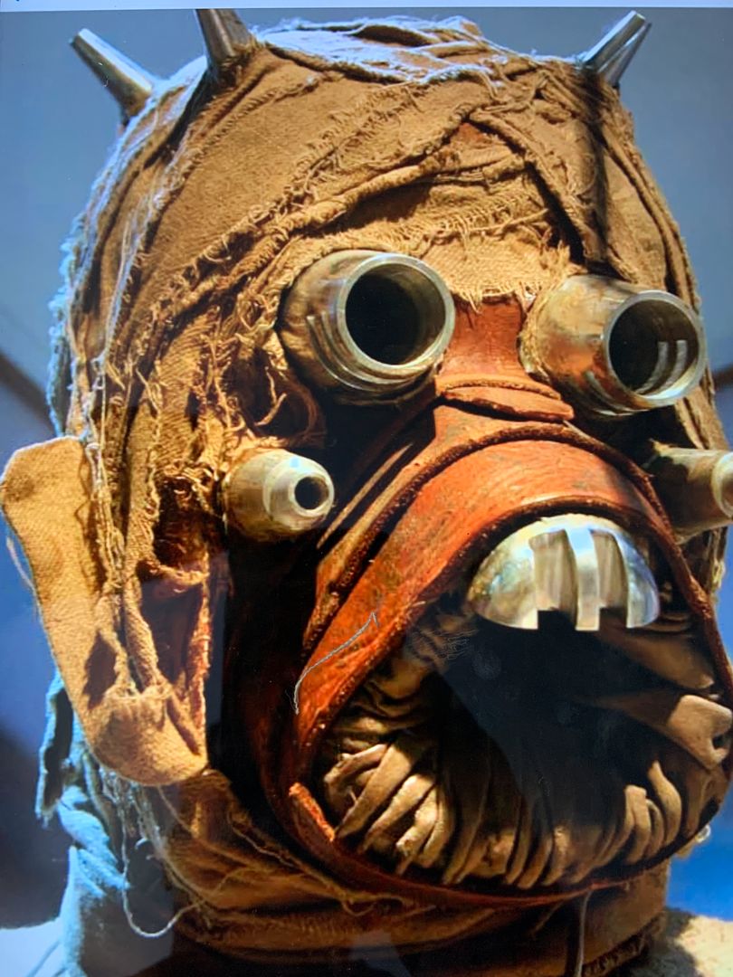

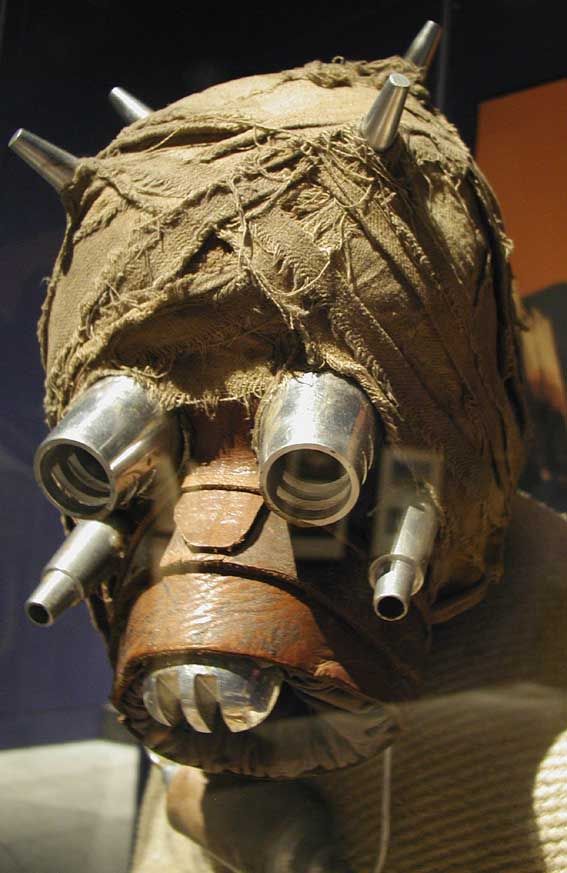

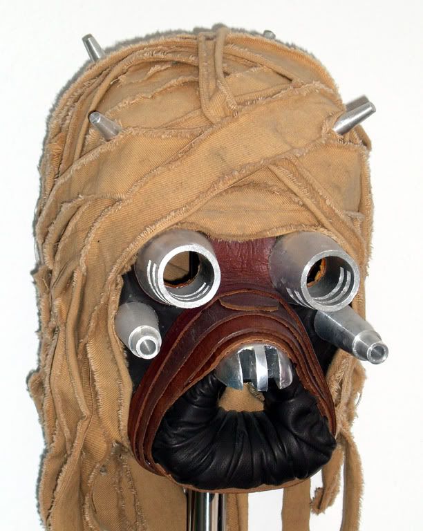

I'm just not happy with the kit material.....here are the screen used helmets
Close up

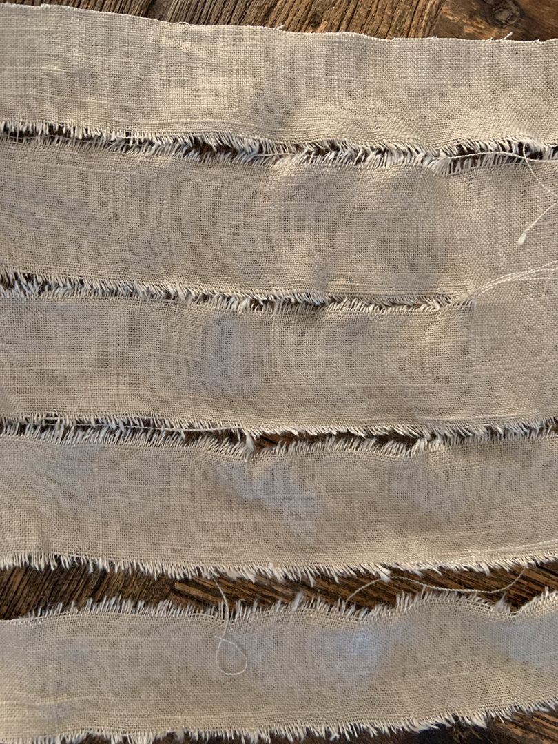

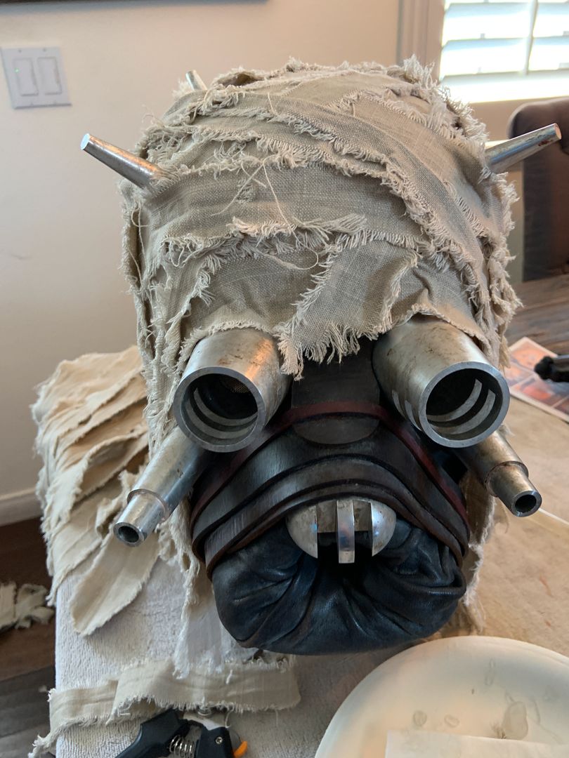

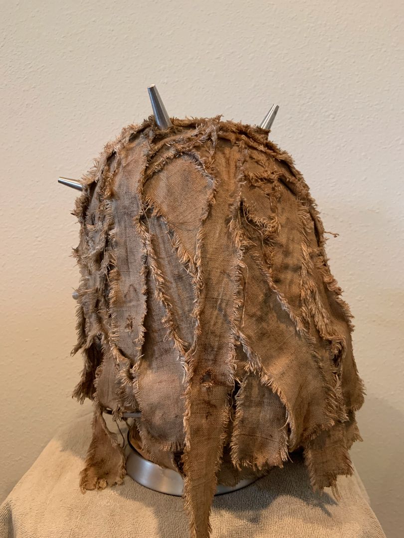

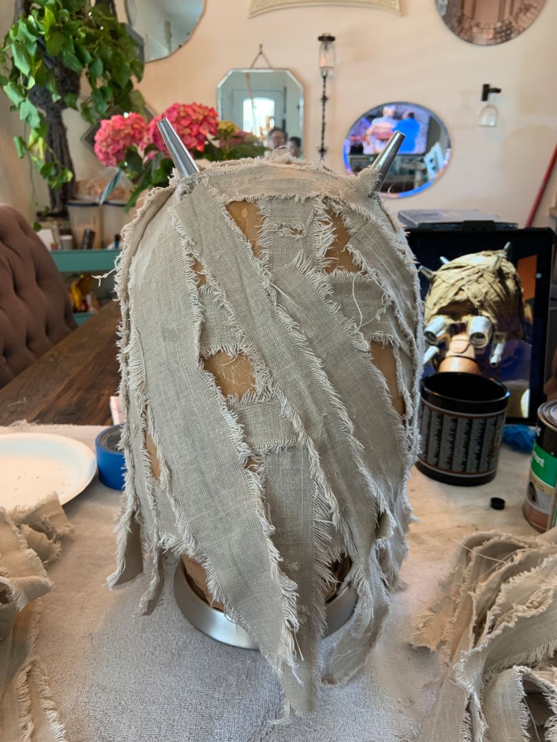

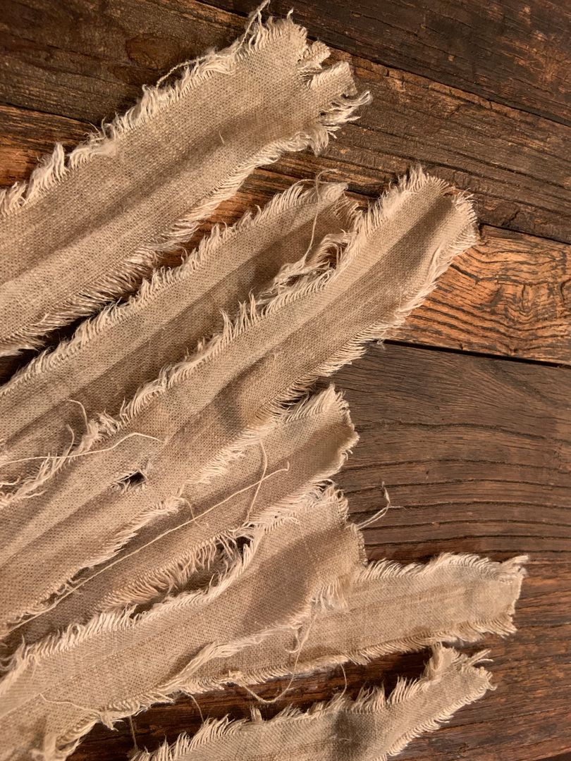

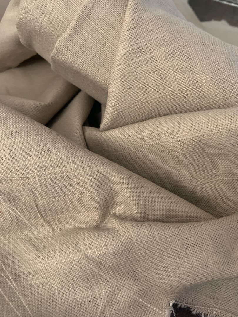

It looks more like linen. So I picked some up, ripped it, washed it, and here's what I got. Next round I need to rip it wider as the wash really frays it
Washed

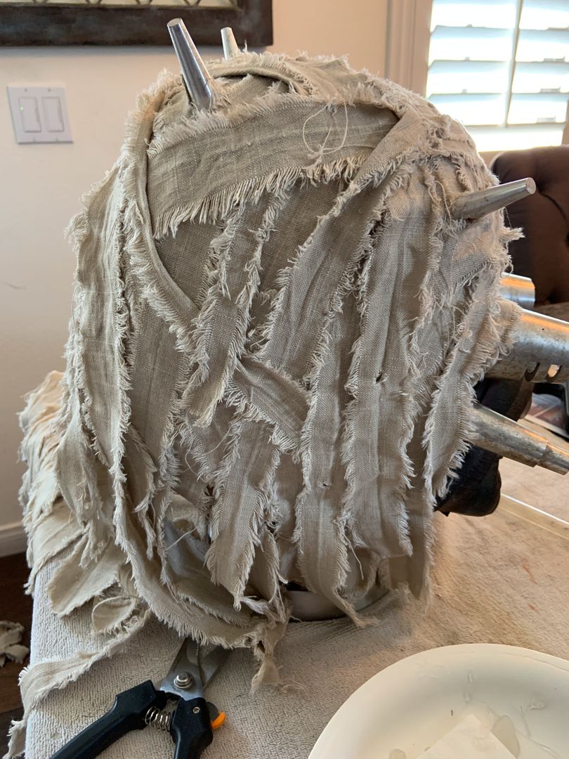

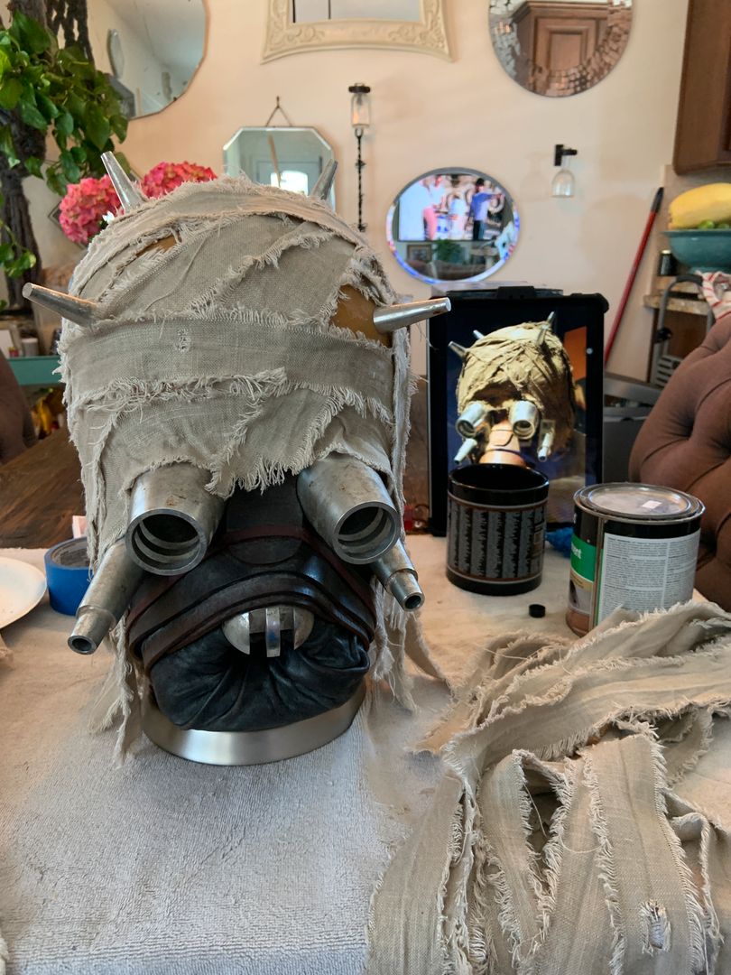

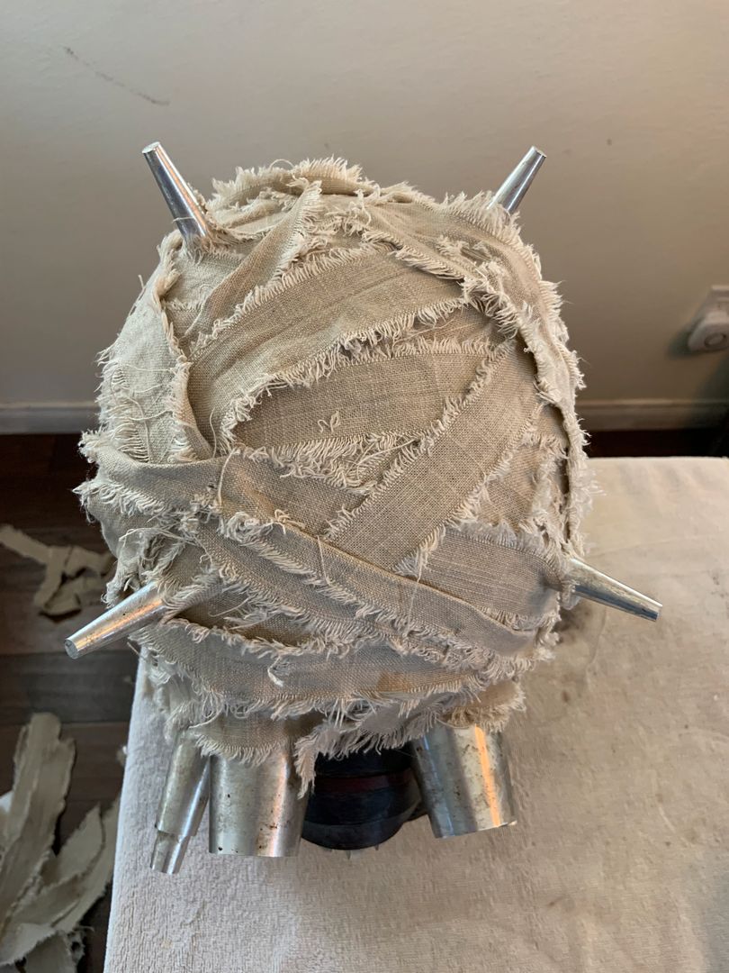

Now to strip my dirty Tusken down to his scalp and start over....

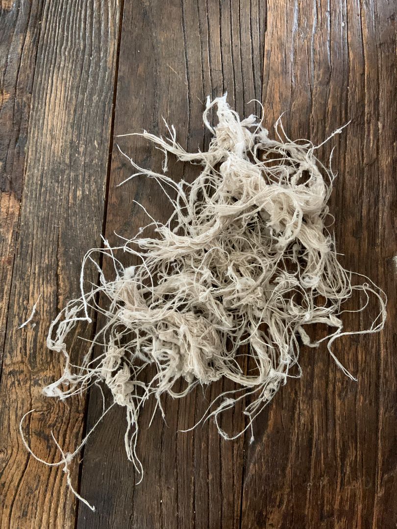

I now have a "Stay Safe at Home" prop to do list of things to finish...... There's a lot of threads after you wash linen!

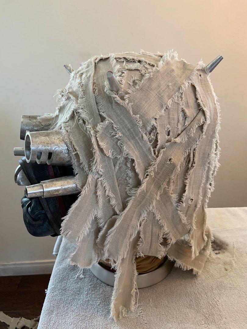

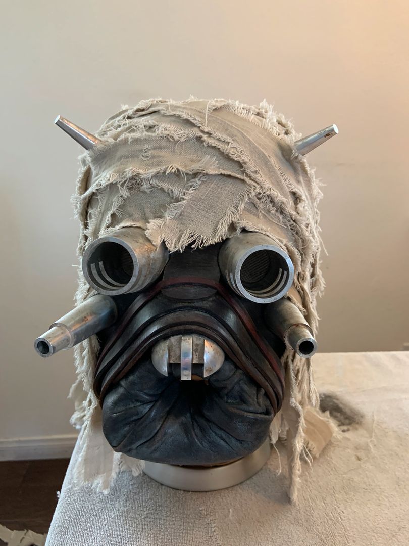

Striped him bald
New linen wraps

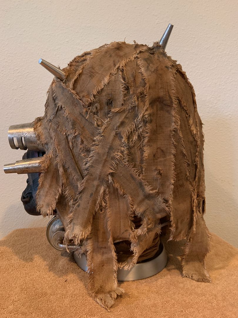

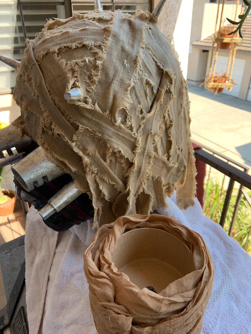

No need to go get Rid Dye....coffee works!
Old wraps vs. new

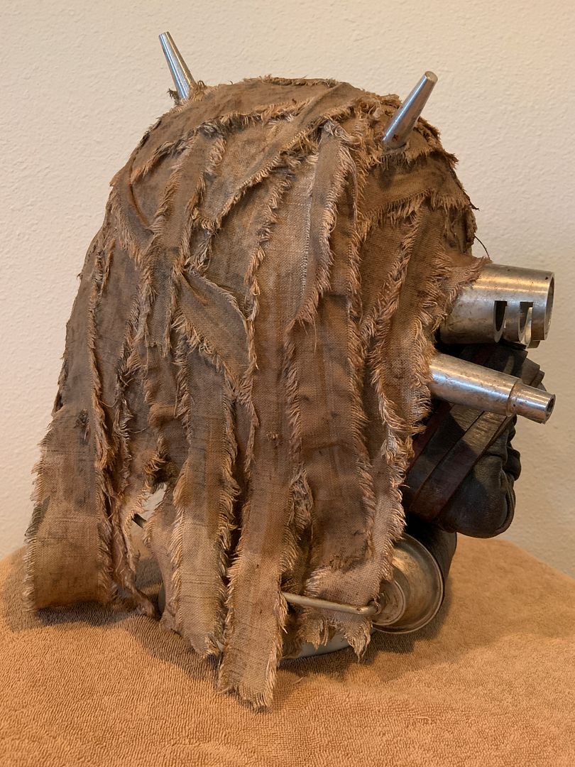

I soaked his new "do" in coffee with a spray bottle. After he dries, I'll start to weather him if the color turns out dark enough. I like this look much much better as the Dockers material never seemed right!

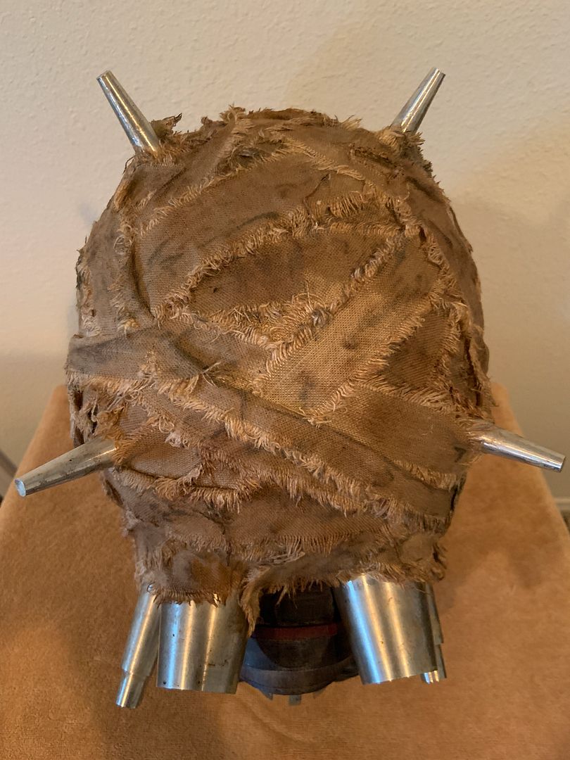

OK, he's done.....says few on this board! Here's my goal - Tusken from the costume tour display

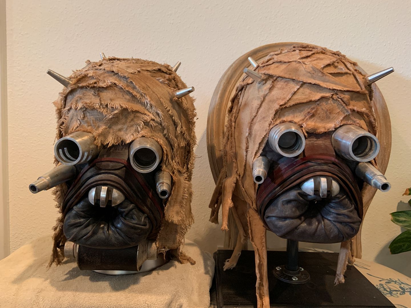

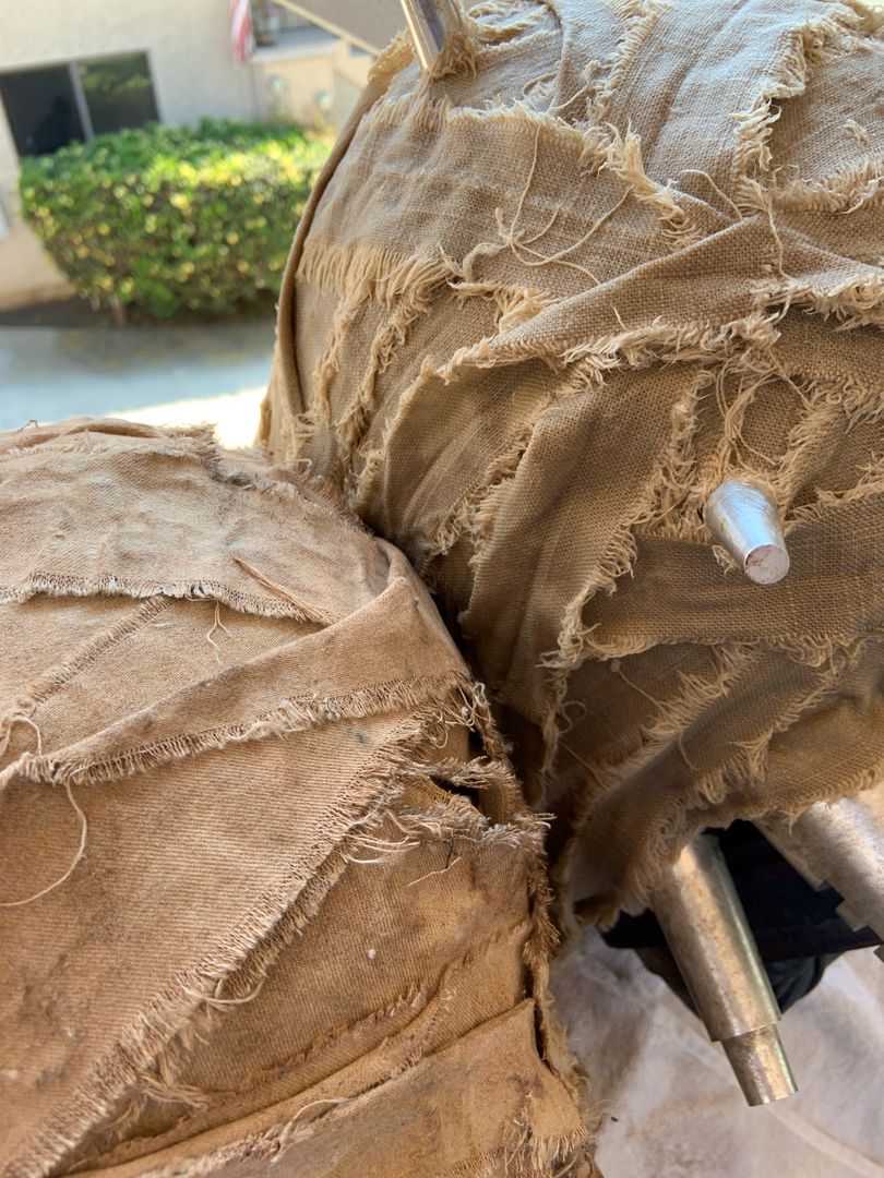

A side by side of the other one I helped a friend with - right side is the kit fabric - left is the new fabric

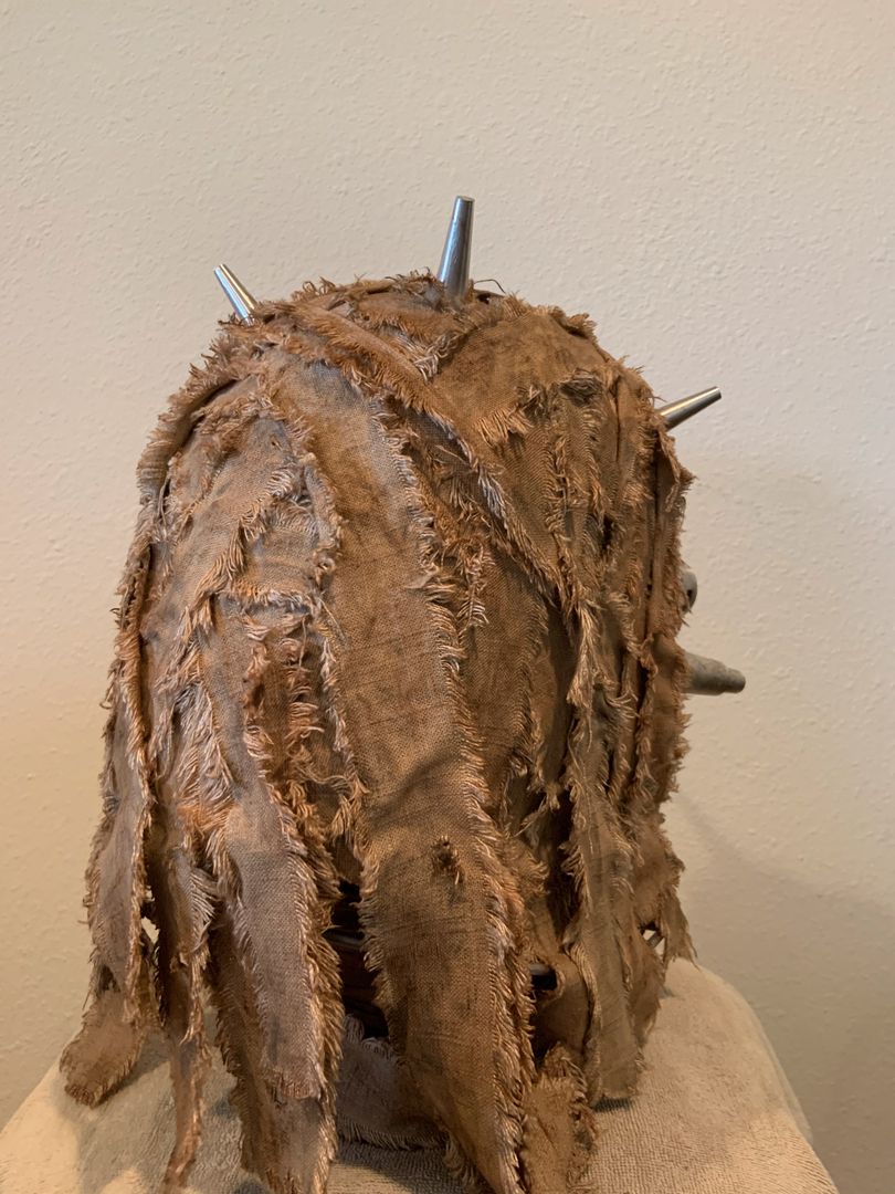

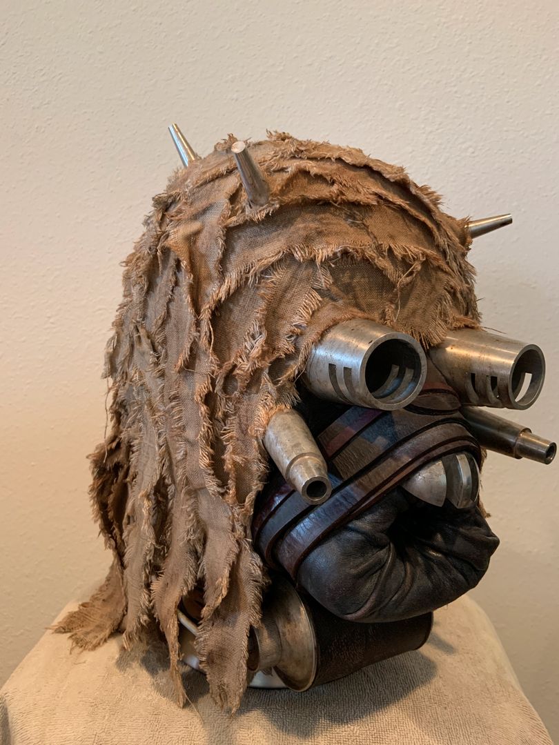

Overall the linen upgrade I did turned out great but there was still something bothering me, he was too fuzzy! After he thoroughly dried out from the coffee dying, I sprayed him down with heavy shirt starch and smoothed down his frayed ends of the material and got them much tighter to the skull. I think he's done and I'm happy! COVID 19 Stay Safe at Home is driving me CRAZY!!!
Any thoughts?
Yes, that looks way better!
While I already liked what you achieved with the new fabric l thought there was something off but couldn’t identify what!
So, really, really nice.

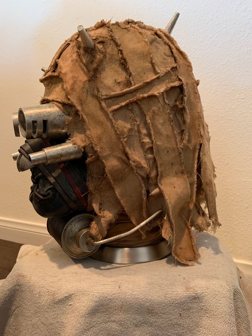

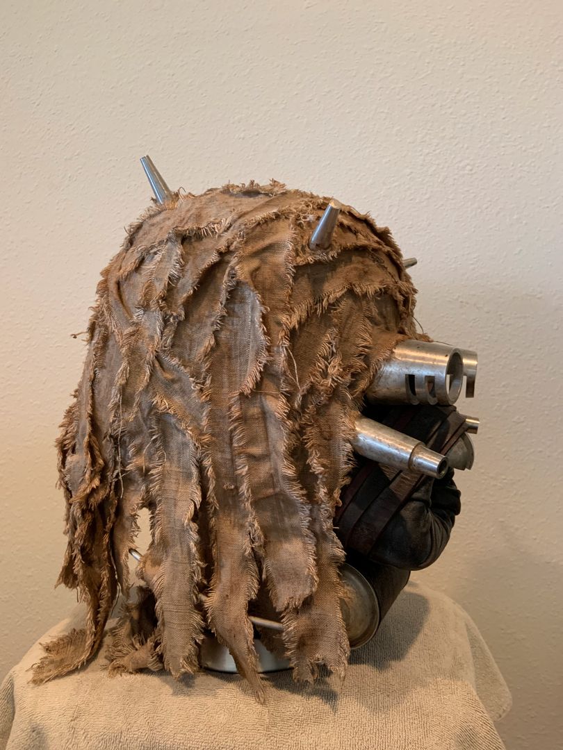

You should glue the head wraps at the bottom inside the helmet or cut them off. They are not unkempt and do not hang loosely over the neck or shoulders.
They are not loose on your referece pic, too.
Maybe some wraps felt of because of less glue or something like that. I added the green line to show the end of the helmet. and 1-2 cm of a wrap "hanging loose" if you want to call it like that is nothing compared to 10 cm wraps hanging of.
And you also can see, that the slightly longer wrap which is hanging of (and its not really hangig of) has a bend and should be glued inside the helmet.
I marked that with the green arrow in my pic.
