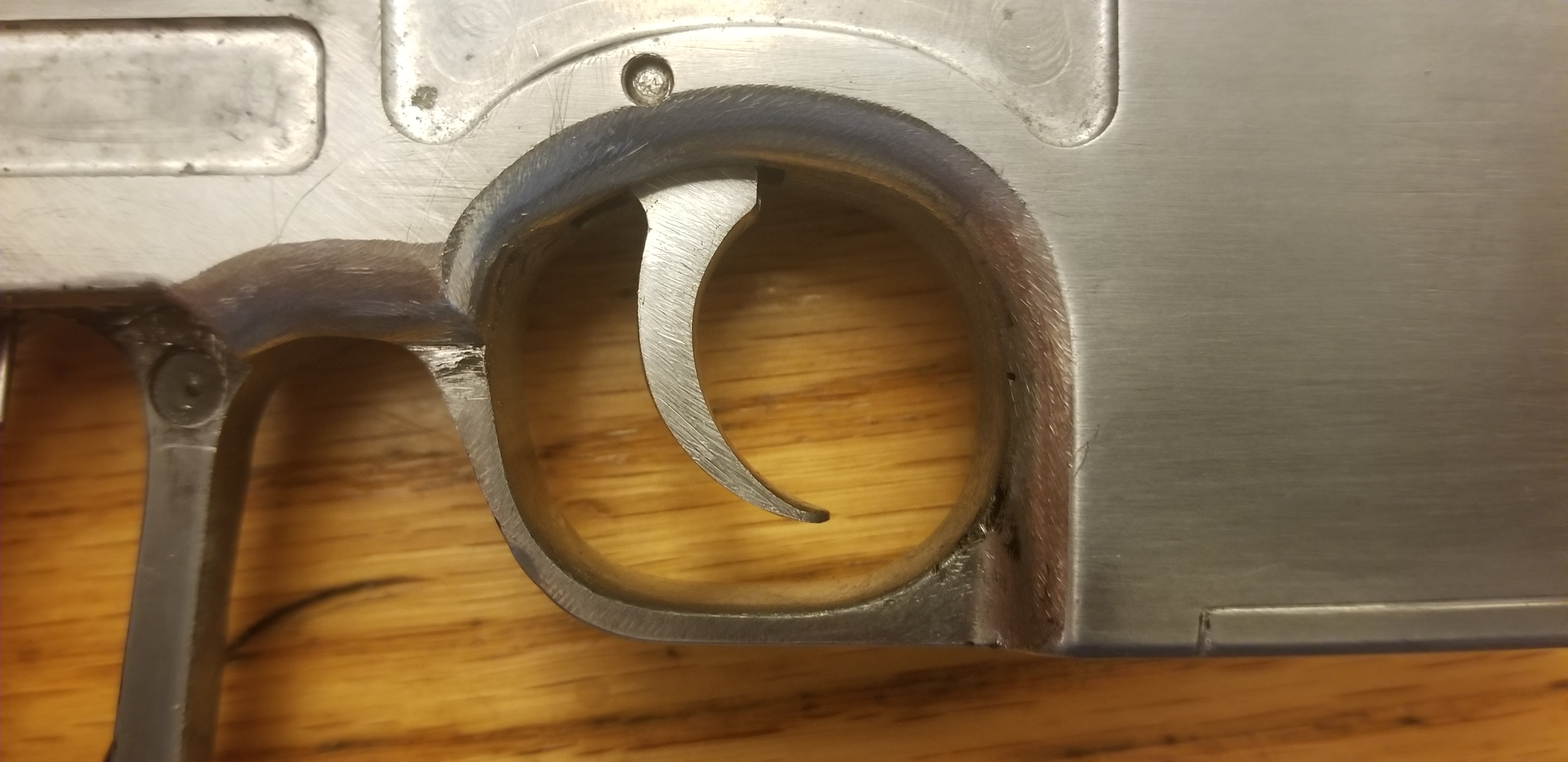

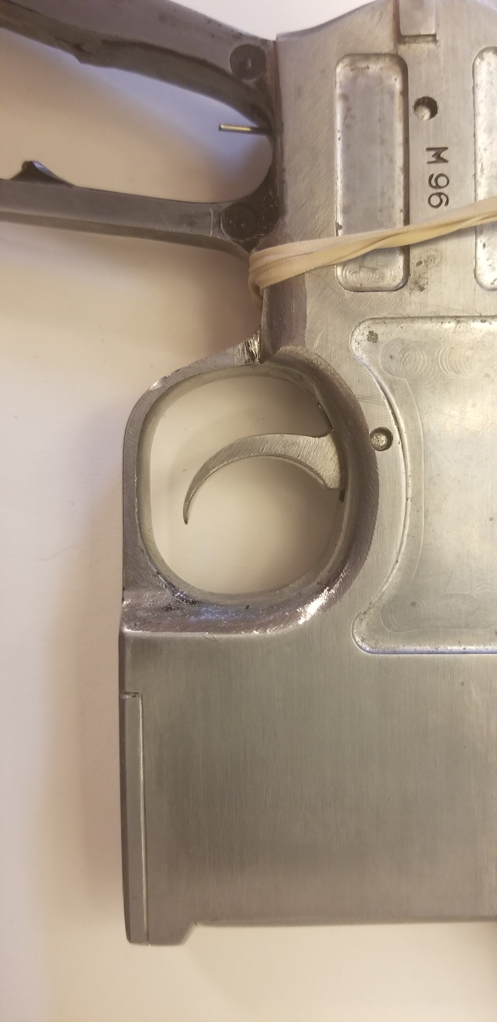

Alright; this is the LAST time I crank about this trigger, I promise; but this thing was kicking my butt for the longest time, so I need to vent at least a little. I cranked on it a bit more and finally got it bent into shape (literally). I used both my MR EE and a real loose c96 trigger as visual templates to get this as close as I could manage (and no; I'm going for an actual Mauser's trigger look; haha). Added a slight rounding to the front edge of the trigger so it no longer feels as "flat", if that makes any sense.
Think kpax is right; redrilling the mounting hole and moving it back a bit may be worth my time after all. We'll see.

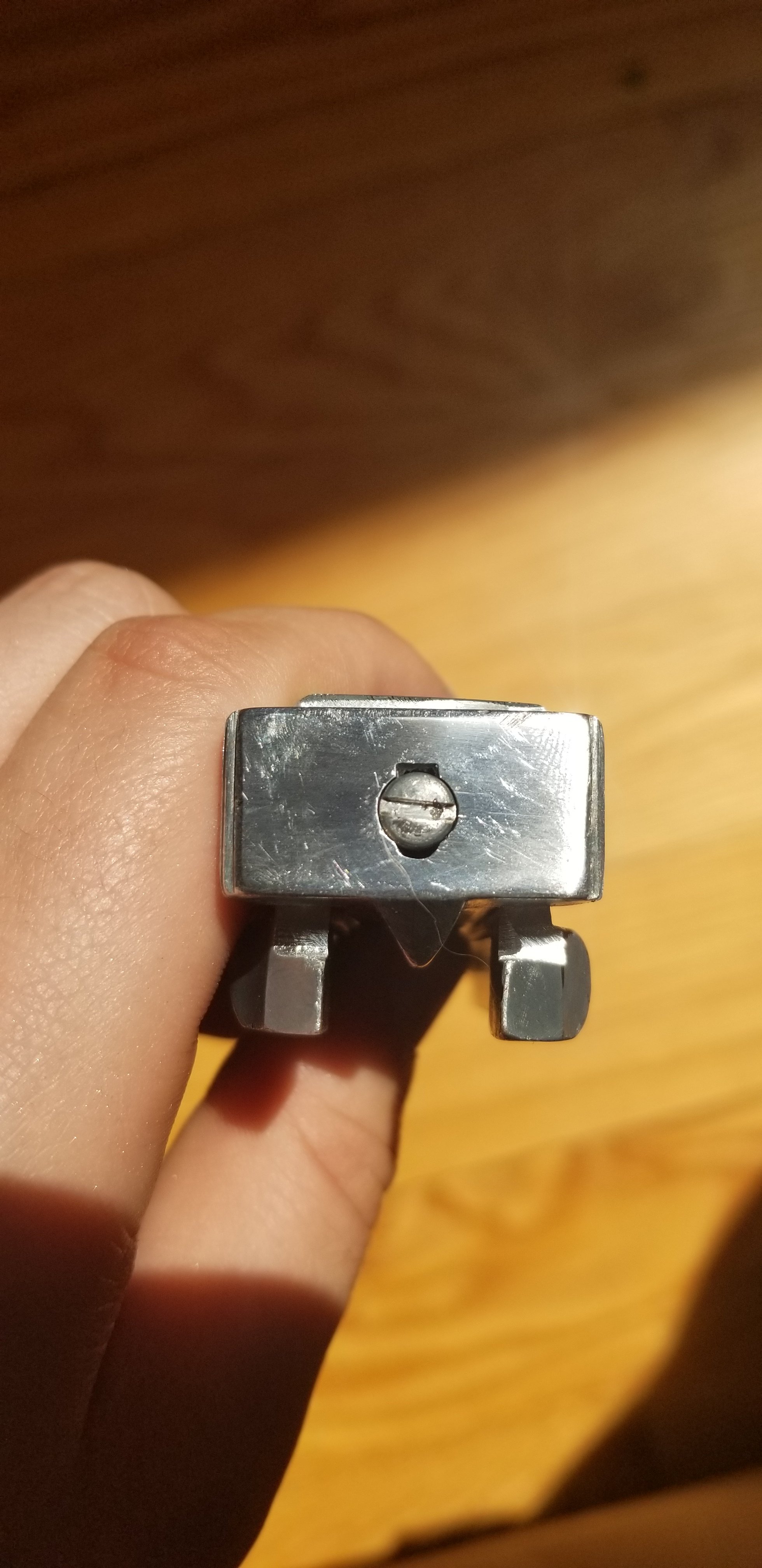

Decided to give accurizing the Denix's bolt a little bit of accurization and attempt something I hardly see done. Brooke out the needle files and opened up the opening on the rear of the bolt to match an actual c96's more closely:

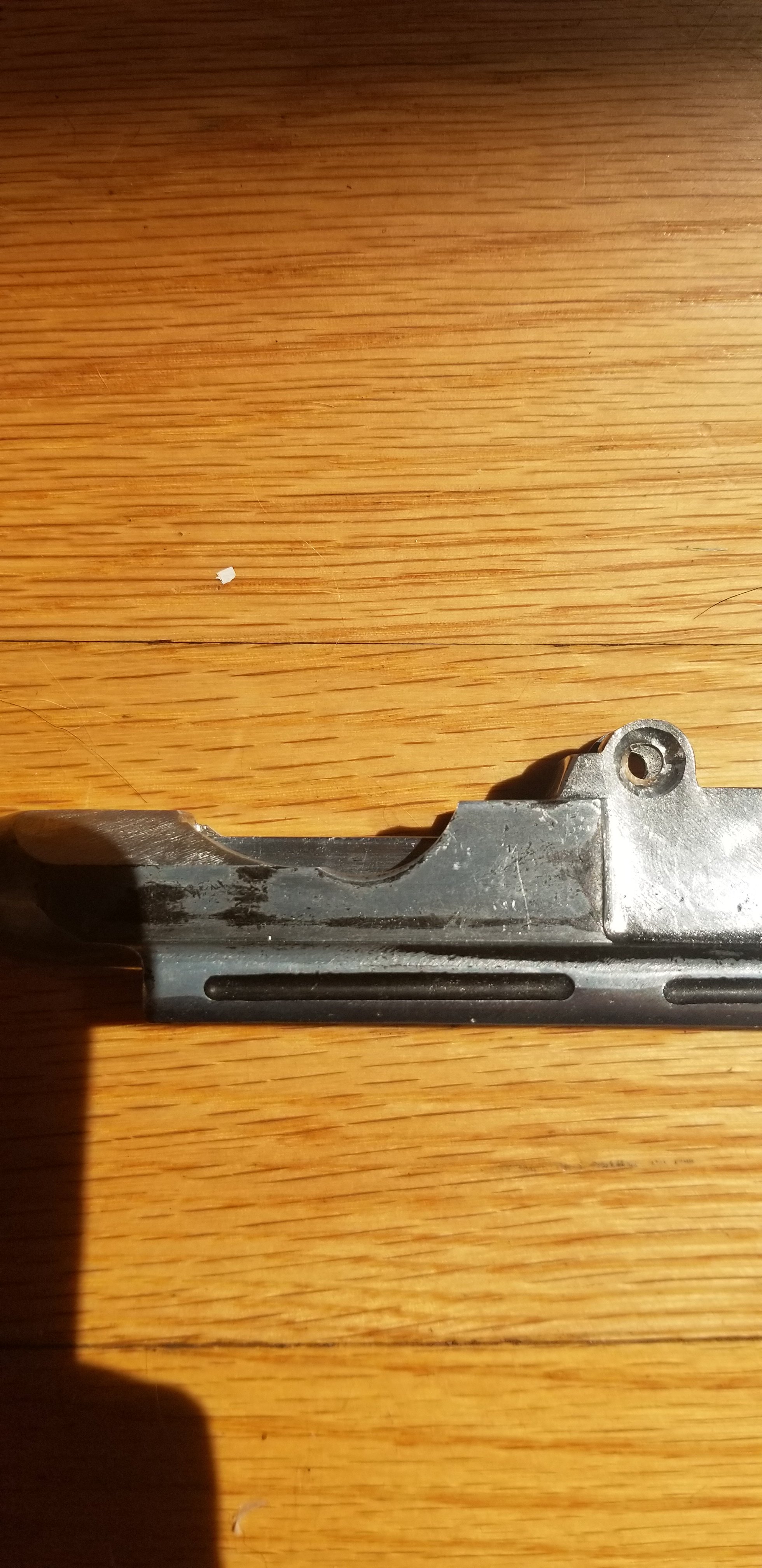

Did hit an air pocket in the pin while filing the notch, but its small enough to not bother me. Also still cranking on getting these ejection port scallops angled right/raising the bolt as high as I can:
Also took a countersink drill bit and recessed the slide pin holes on both sides.

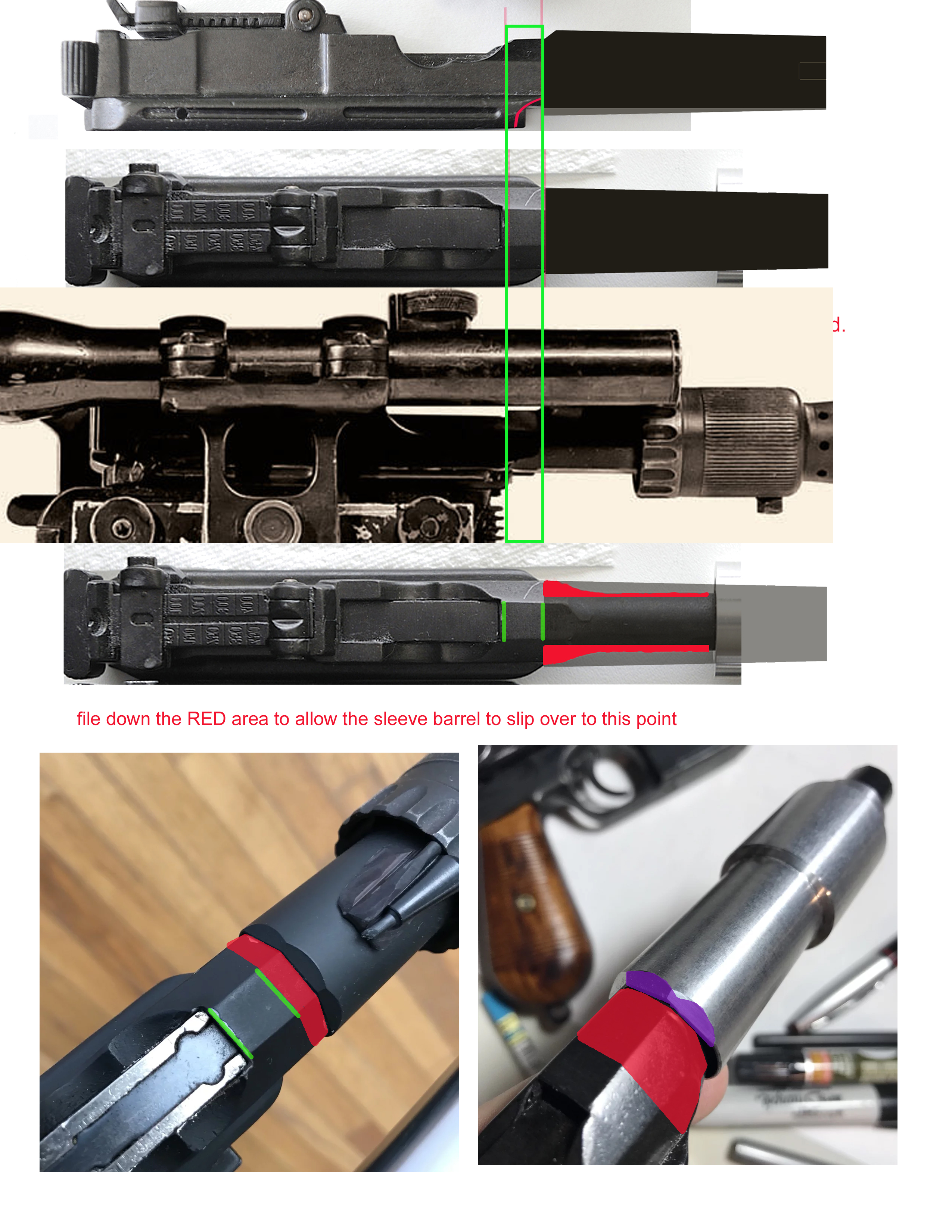

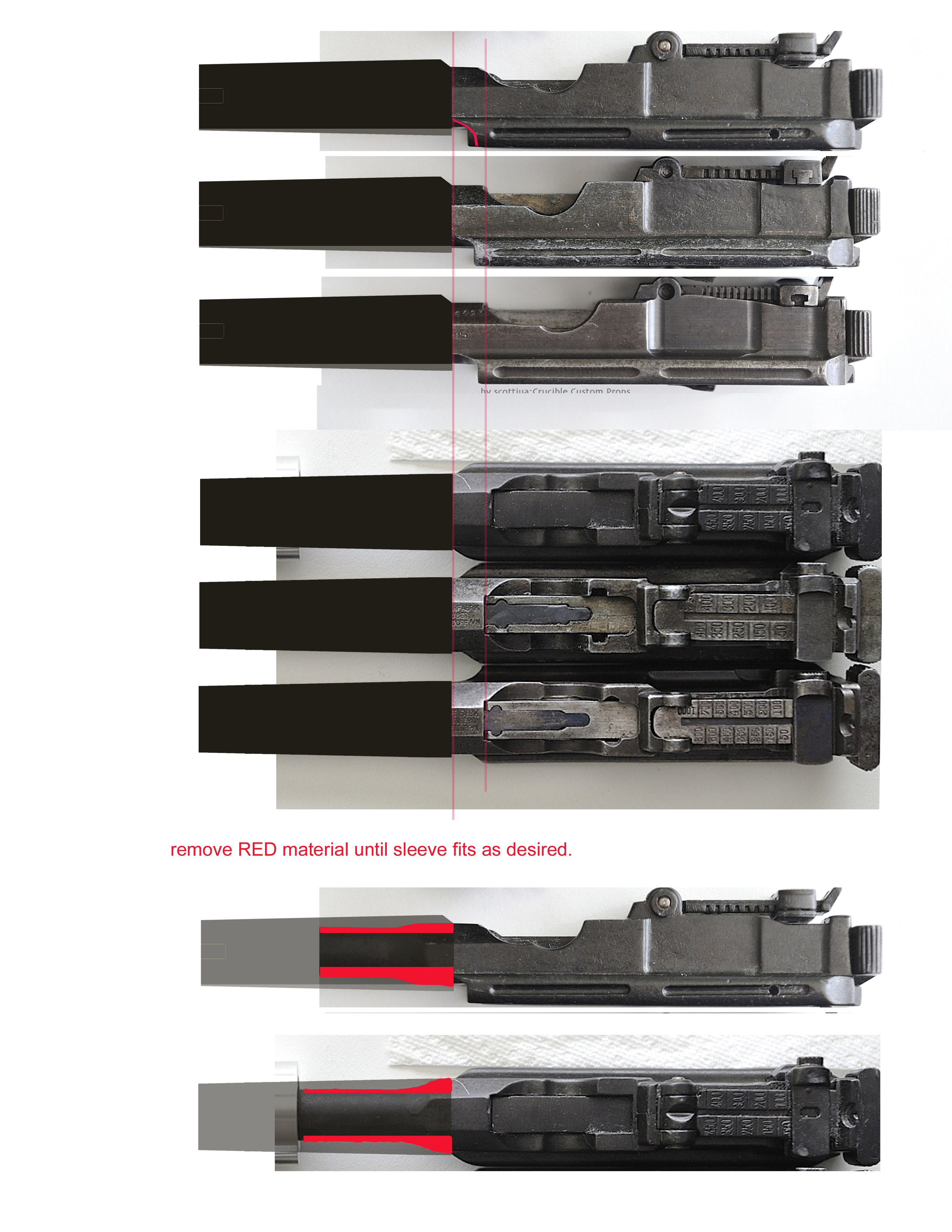

Also; would anyone here be able to lathe down the barrel of a Mauser to accept a bull barrel? I know that Scott and Field Marshall do this nowadays to their Denix, but Scott's not available ATM from what I recall. Specifically; I'm looking for somebody to lathe down the off-center, round bottomed barrel of the MR Elite Edition. The MR's barrel is mostly off-center, with an inch-long portion at the very tip centered for the Flash Hider to rest on properly. Can take pics if needed; but this would be a HUGE step checked off for me.
Why not just file down the rear of the receiver to accept the bull bbl? You seem to have the skill. Just go slow. Remove a little at a time and test fit.
Once you file enough, you can set it straight in place using epoxy.
Maybe these guides will help?
