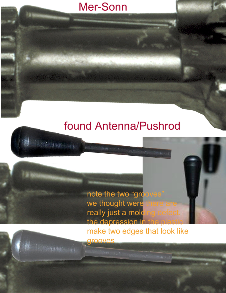

Here is an Antenna/Pushrod post comparing the MerrSonn close up to an actual "found" molded plastic Pushrod from the original model kit.
The moulding defects in the plastic create a "depression" in the plastic which is actually a sunkin area near the top of the head. There are other "rings" around the head and rod due to the mold being old and unpolished.
The sink marks create an illusion of the two grooves we thought were there due to the lighting. Note the comparison of the images.
So now we know they were not grooves or glue... just an old mold.
Lights can play tricks!

Nice observation about the rings/recesses, Pat. The pushrods appear to have been molded from two molds, one for each pushrod. So you may have just found which one of the two we're seeing on that particular Merr Sonn blaster. Very cool!

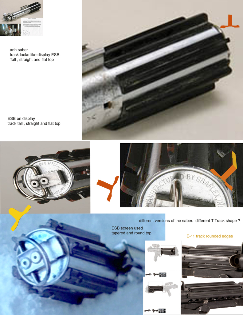

I was looking at the T Track and had some questions and observations.
I noticed that the track is shown several different ways in different images from screen used and display and stunt props. the detail I'm interested in is why some show the "blade" as being tapered and rounded and some show the blade as squared and flat topped.
Are there any photos of the MerrSonn blasters from the top view? Are they in the SW collection and still extant? Love to see if that is really the same track on those and the HS Hero as are on the sabers and E11.
Were there different types of track? The HERO Luke seems to have the straight walled blade with flat top.
The ESB sabers seem to have both.
