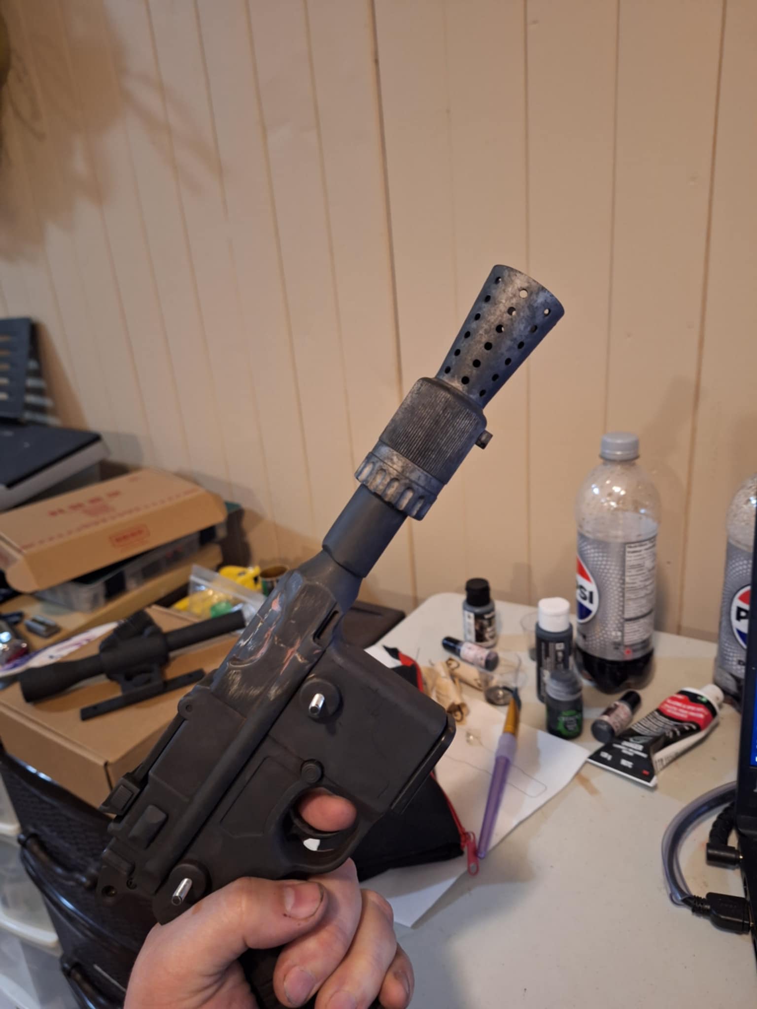

I'm almost set to start paint on an ANH style DL-44 prop I've been working on bit by bit since Feb. It's a mix of 3d printed parts and a core Nerf style mauser I bought on Aliexpress. Is there any specific paint colors and finishes people have been using to paint a DL-44?
For the main body I was thinking satin black with graphite powder rubbed on it. The front grill. Being semi-gloss black. The scope mount being base silver with semi-gloss black over top but with silver revealed in sections. The muzzle is going to be dark Aluminium. And the scope itself a mix of satin black and metallic brass.
Is this on the right track at all?

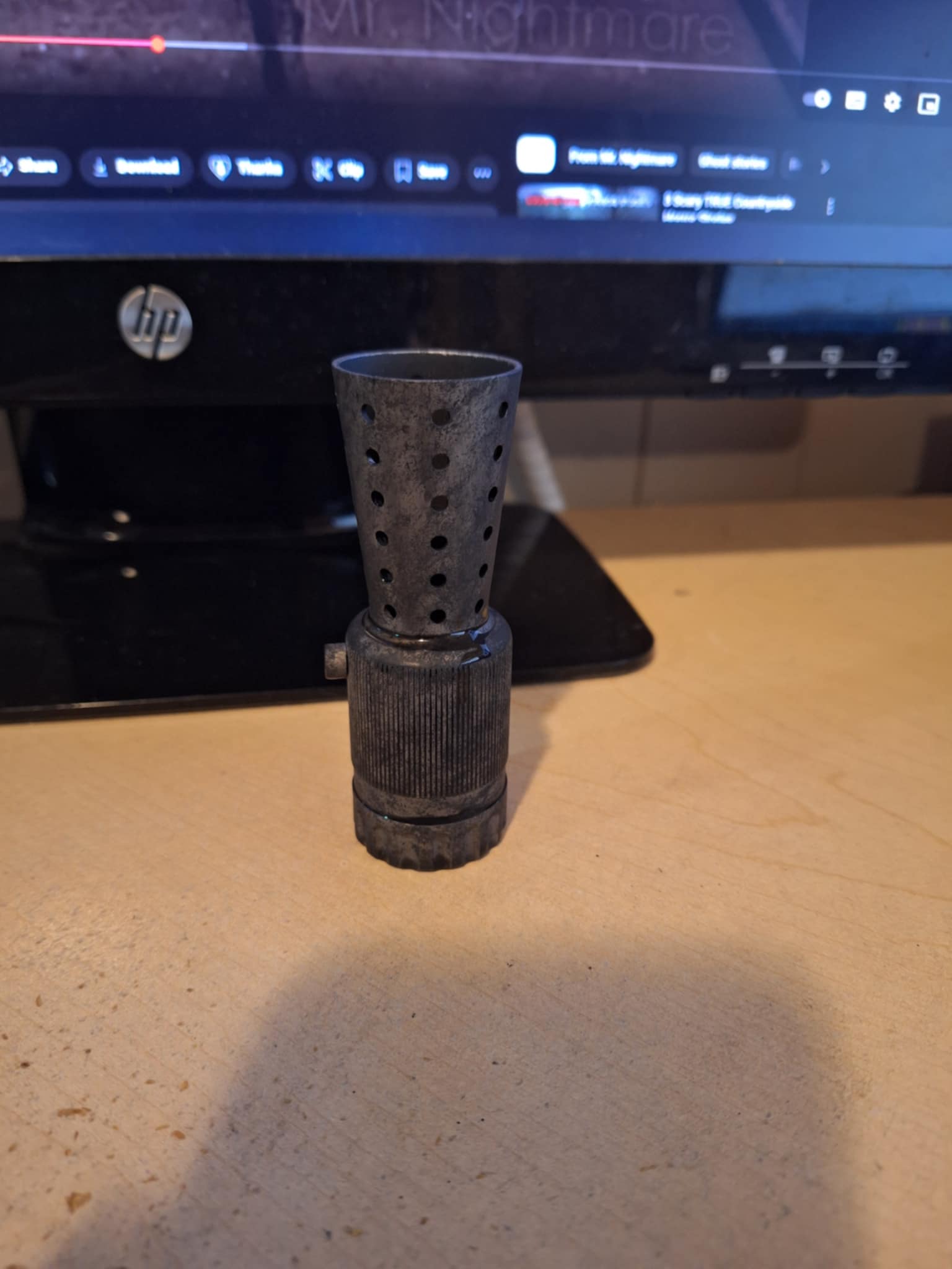

The bolt, hammer and lock frame (including the "takedown latch" below the hammer) should all be bare steel. I think you could use the same dark steel paint on those as on the flash hider.
Even though it is attached to the lock frame, the safety is "blued" steel (i.e. black) like the body though.
Then be sure to use a dark wash in the grooves of the hammer and the knurling on the flash hider.

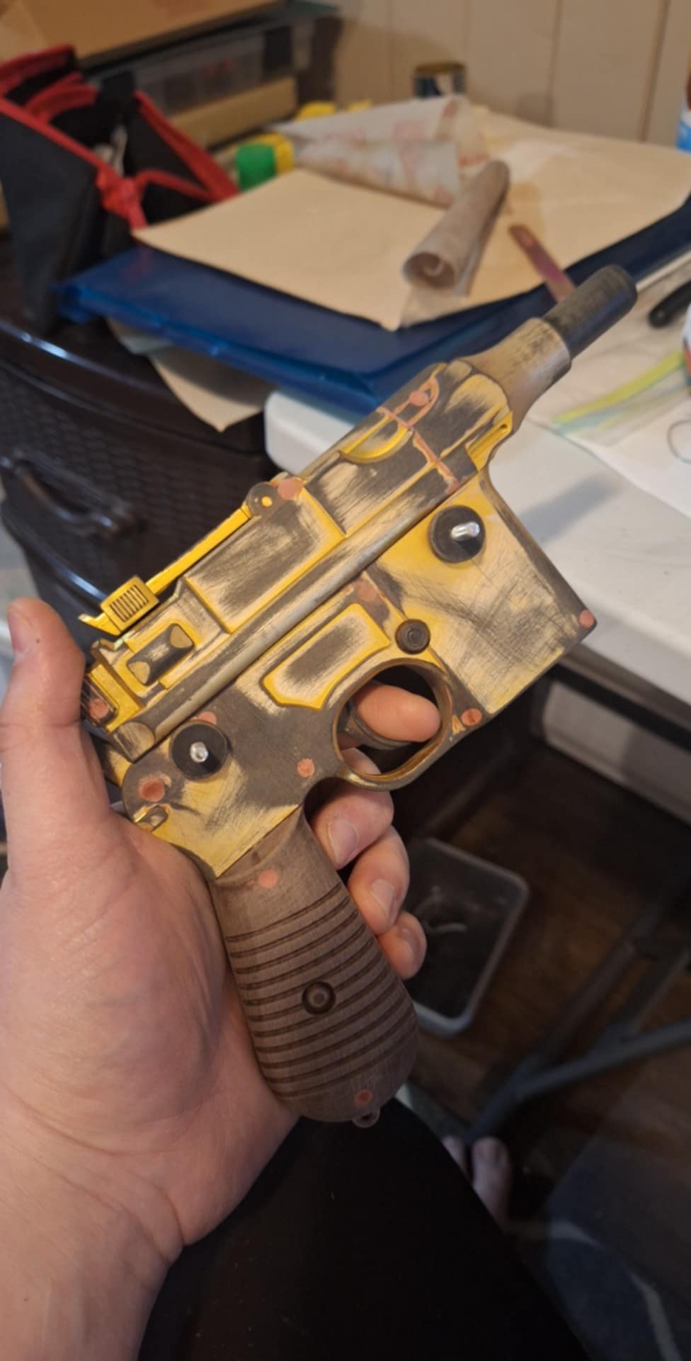

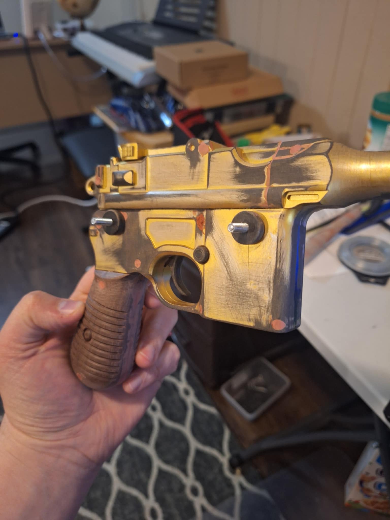

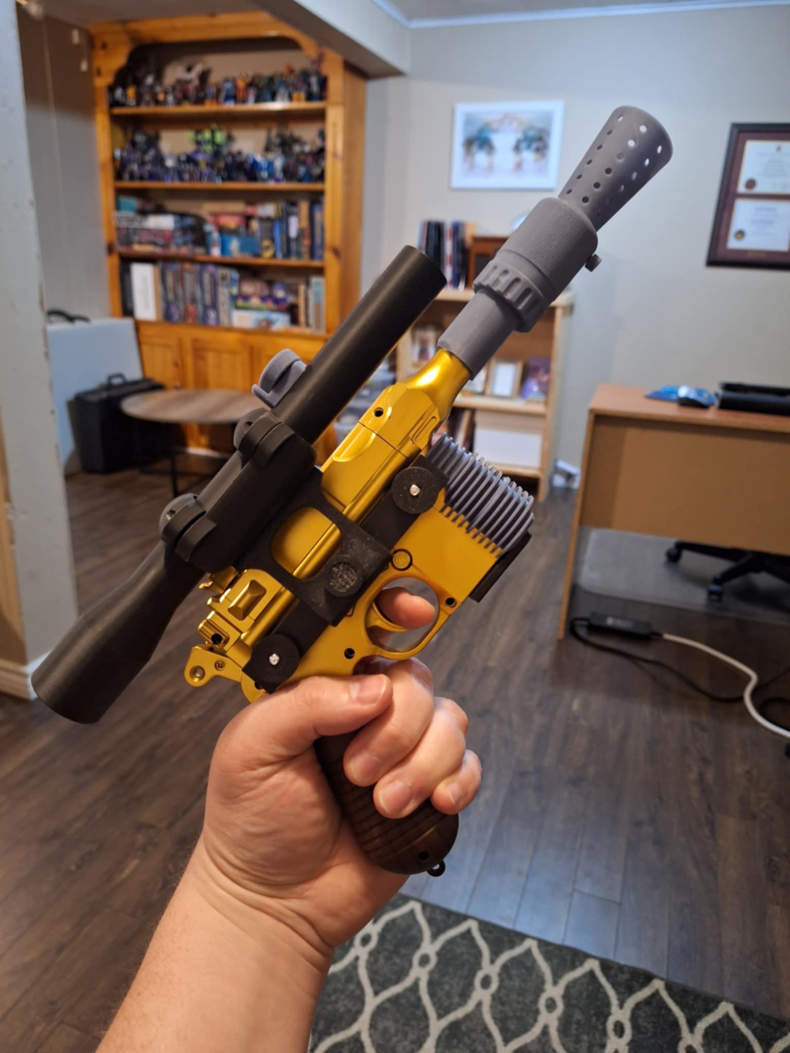

The shell I'm working with isn't the most accurate, but its close enough for what I can get in Canada considering how restrictive gun laws.
The bull barrel will be sitting a bit closer to the main body on the finished version. I'm just waiting for my friend to get the updated piece to me.
