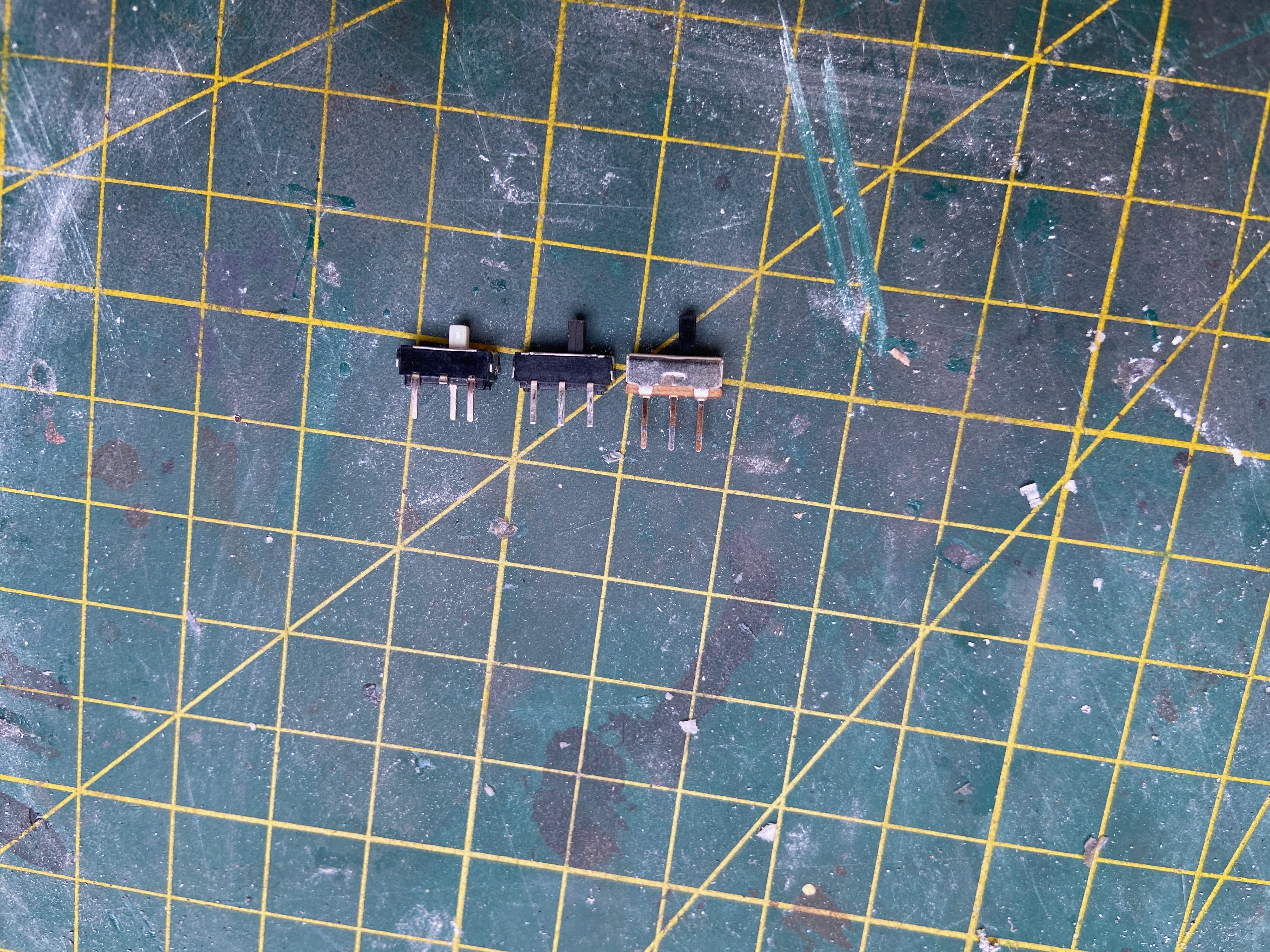

The switch can be tricky to find, especially one with a long enough toggle/lever that's white (which is movie accurate). You might have to settle for a black one and paint it as I did. You only need 2 positions - 'on' and 'off' - so an SPDT will work fine. The important thing is the overall dimensions, since the space for it to fit into is tiny, and the toggle/lever being long enough to project through the aperture enough to be accessible.
The switch dimensions need to be around 8.5mm x 4mm x 4mm max. Try searching for an 'SS-12D07 micro vertical slide switch' and you should get quite a few results, although most will come from China. Here's one result on amazon.ca. For safety, get one with the longest toggle - you can always trim it to length with side-cutters.
For an example, here's a pic of three of the switches I've used successfully (the white-toggled one is the most accurate but is a bit tricky to use in place as the handle is slightly too short).

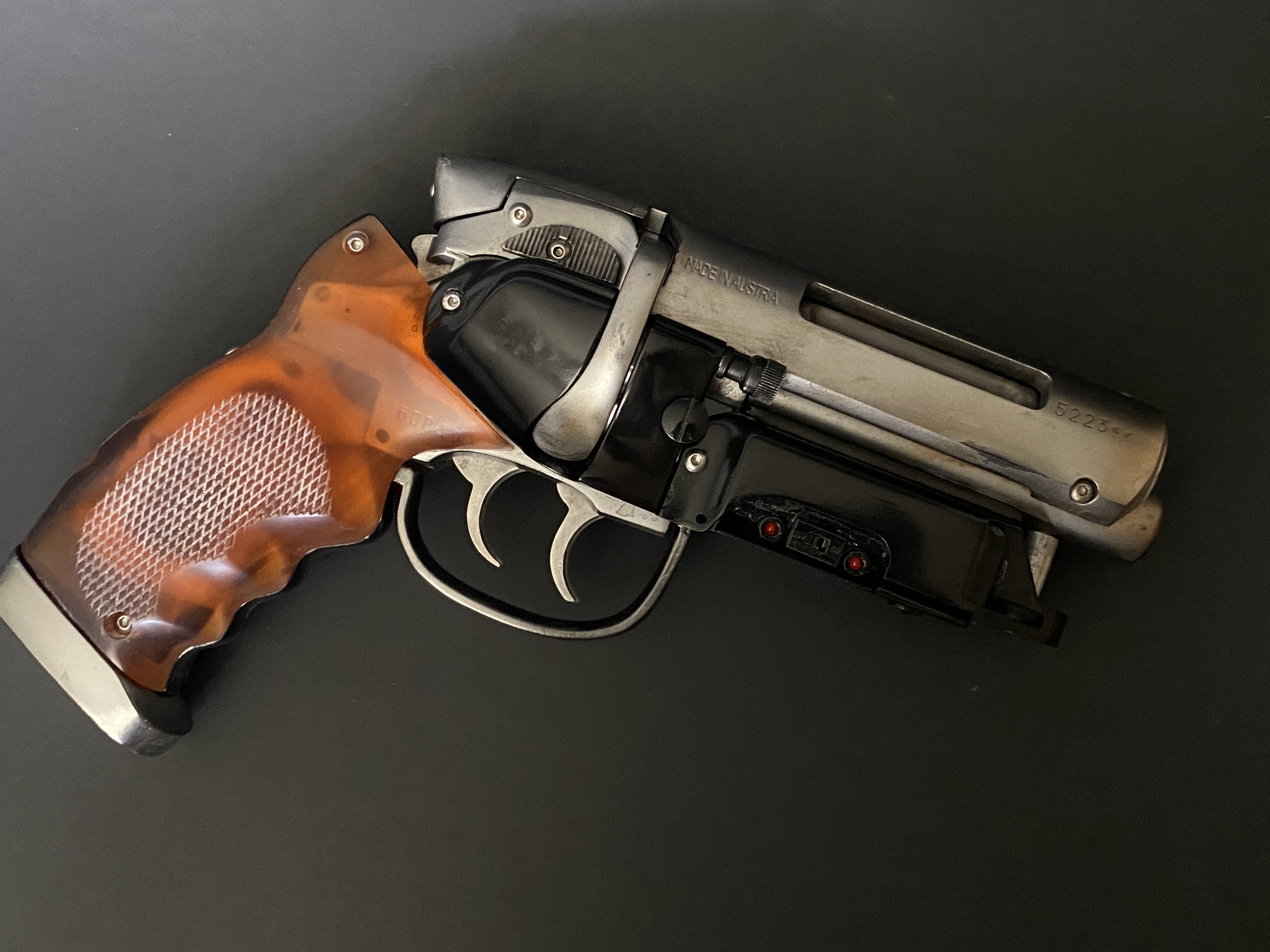

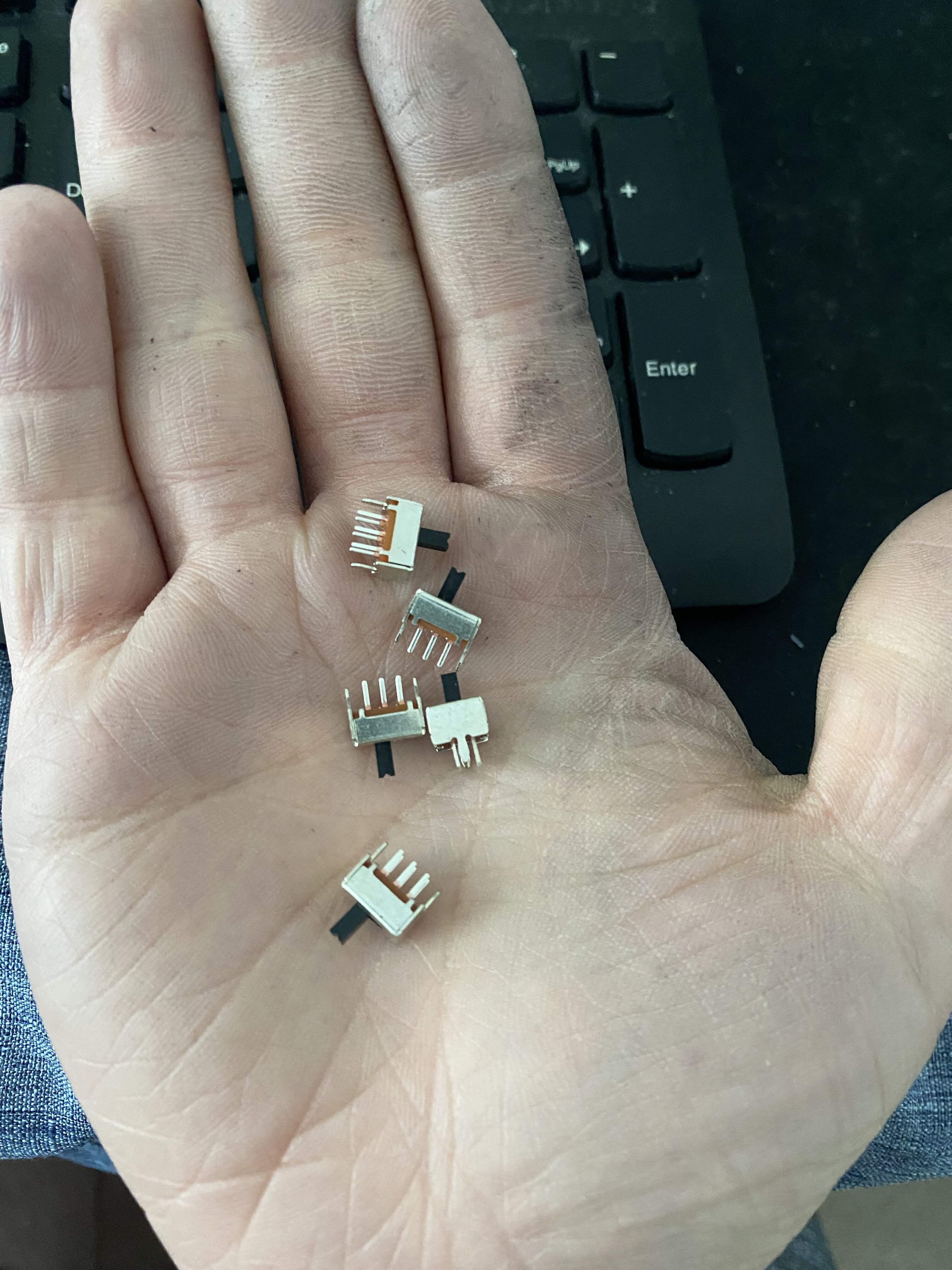

Hey Imagehunter-- I have some spare switches that fit Anders blaster, and I believe I might even have magnets as well. if you cover shipping to Canada I'd be more than happy to send a switch and magnets your way. Feel free to DM
View attachment 1731372View attachment 1731373
Thanks, that's very generous. I just ordered some though. Thanks to wayouteast for helping me find them, they're on there way and I should have them tomorrow. I sincerely appreciate you though, I'm sure one of my fellow builders could use them.
By the way that's a beautiful build you did there.
