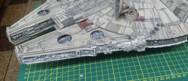

Tried to avoid it... but I could not stand watching those too tall sidewalls, so in a moment of madness and insanity... I disassembled my falcon, cut the height of the curved sidewalls, cut the height of the walls of the internal details (remember, this is the cutaway version) and developed a plan to scratchbuild the mandibles outer sidewalls. Yeah, yeah, I probably lost my mind :lol .
The fact is, I have set everything back in place now but the mandibles outer sidewalls, that now I'm scratchbuilding. I used a scan of the perfect grade booklet, printed at the correct size, attached on the new sidewall base, as a guide to place the new greeblies. Let's see how all this will end. Wish me luck.
Work progress so far.....
Middle zone almost finished, I used primer in order to appreciate the progress. I'm using kitbashed parts, wire and cardboard of different thickness.
Due to the limitations of the AMT cutaway kit beacuse the interiors, I can not shrink the height too much. It should be 1.5 cm height, but that would be too destructive for the interiors, so it had to be 1.7 cm. The original sidewalls are 2 cm height.
The new height looks much better even if it is not exact.
The work you've done so far looks spot on greeblie wise
Well, nice improvement!
Fits perfectly in place

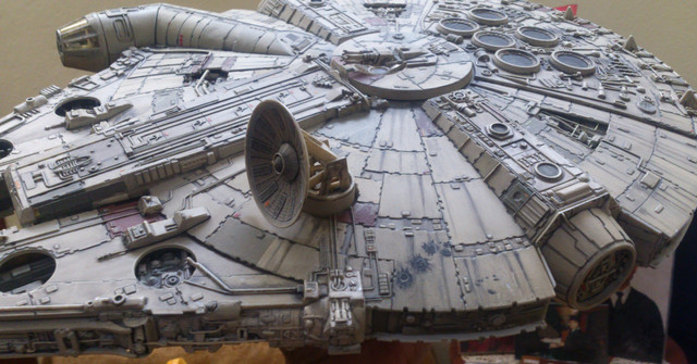

Now starting the wheathering process
The new height looks pretty nice, even with 2mm of height excess

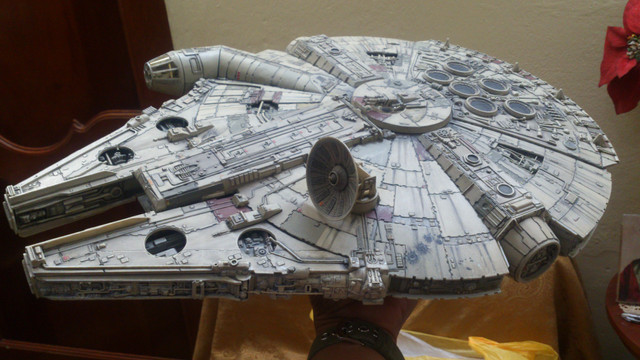

Well, starboard mandible sidewall is completed.... now go for port side!
I made the same attempt with the side walls the 2nd and 3rd one, though you did a far FAR better job of it! I'm very impressed. Once I discovered the upgrade stuff though, I abandoned trying to mod the stock parts.
Thanks, but I had a great advantage... the bandai perfect grade release! tons of detailed pics and booklet scans, I could not do it without that
