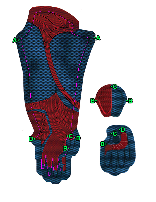

I'm trying to figure out the hands on Sonjou's pattern (Raimi base) Especially the thumbs. anybody have any useful ref pics, or know of any tutorials? I know there are a few people here with experience working on the raimi suits.
Any help is greatly appreciated =)
What are you having trouble with thumb-wise? That's one of the easier sections on the suit.

Nick. I'm mostly having trouble with placement. I'm pretty sure the thumb goes in that little oval that's on the top piece, but then what are all those other seam lines? which ones do I sew the palm to?
If you can post a picture of the pieces, I'd be happy to photoshop a quick guide together for you to help clear it up!
-Nick
Thank you so much for the help.
This should clear things up...I hope. I had to flip the palm piece since you included the left palm for the right arm.

Let me know if you have any questions.

Thank you so much for that guide on the arms / hands, Nick! I've been trying to look for info on sewing it and haven't had much success.
