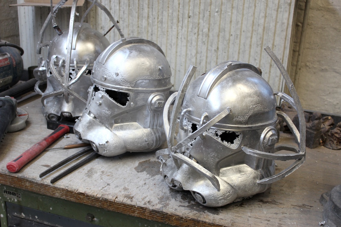

so, today we cast bronze and aluminum and of course the helmets were cast too. unfortunately the surface is not really perfect everywhere. some areas are looking really rough and i don't know why, so don't the founder. well its not as bad as it looks on the photos, but means a little bit more work: sanding sanding sanding. and welding. just started a little bit today, but that will be my job the next few weeks. on the other hand, all the deep areas and fine details are looking well. thats good. the cast in nuts are working also very well, so i can screw in everything perfectly. i already got some visors for welding to put in as lenses and orders a green mirrored motorcycle helmet visor for the free helmet.

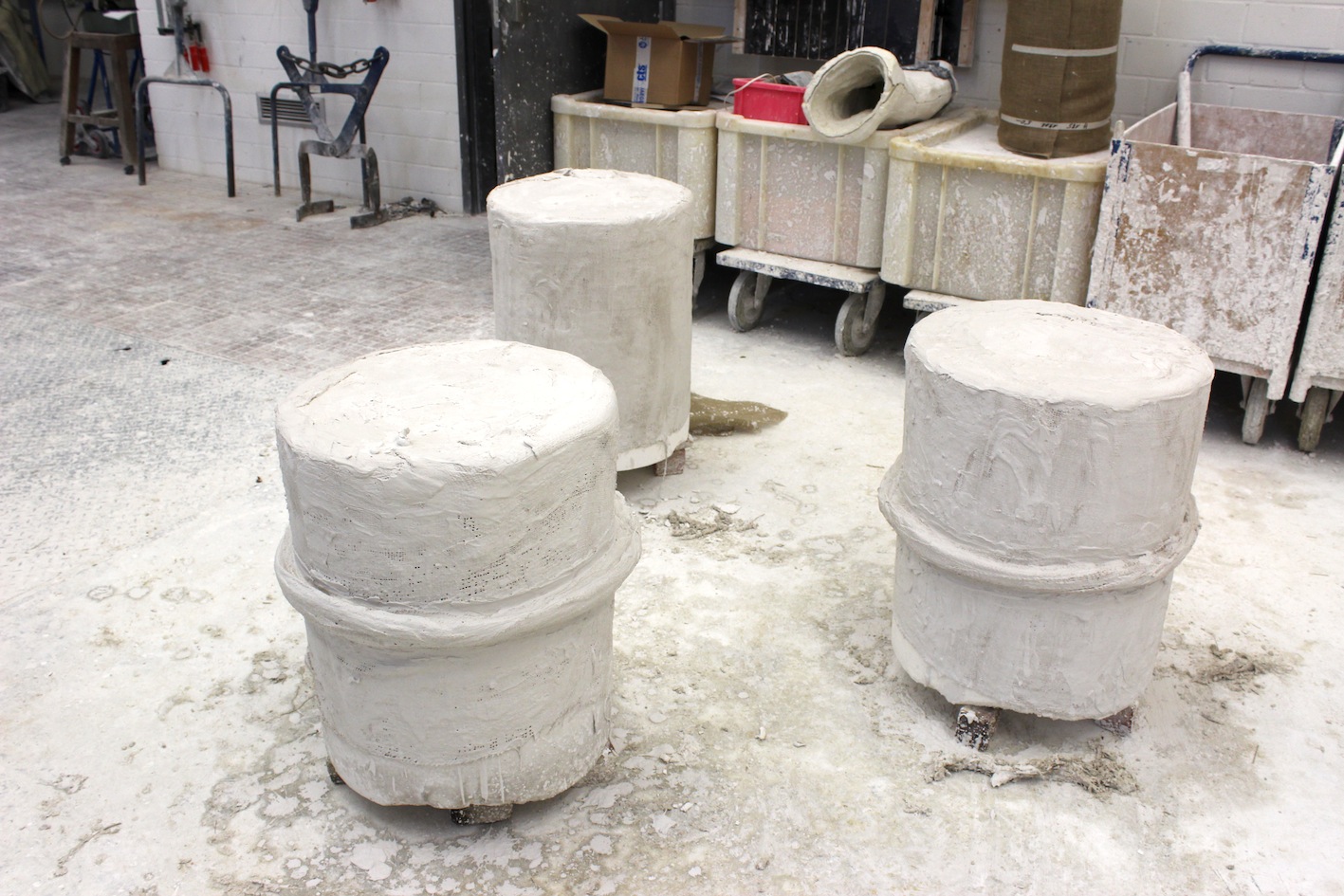

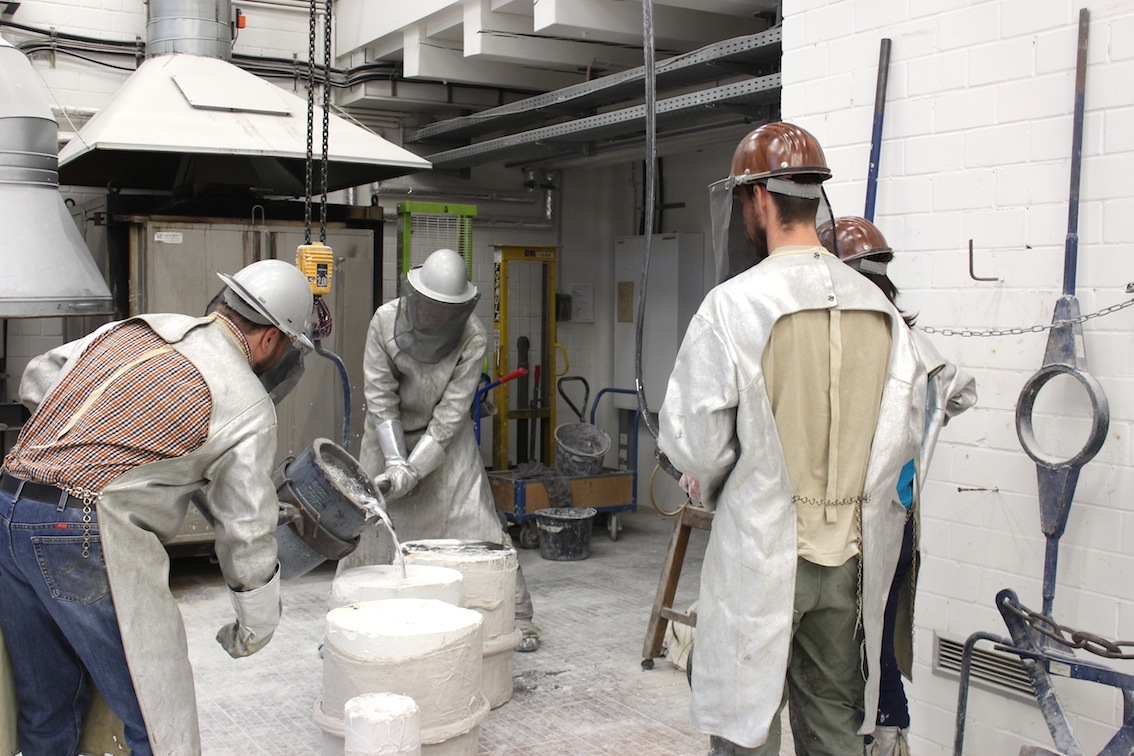

after we ve put all the molds out of the oven, we had to pack them into jute drenched in fresh plaster to stabilize the molds. as i said, the material is pretty soft after the burn out process.
while preparing the molds, the aluminum is melting in our induction oven (without any flames, just by induction. pretty fancy)….
after the plaster is hard, we can lay the molds to the side and vacuum clean the funnels.

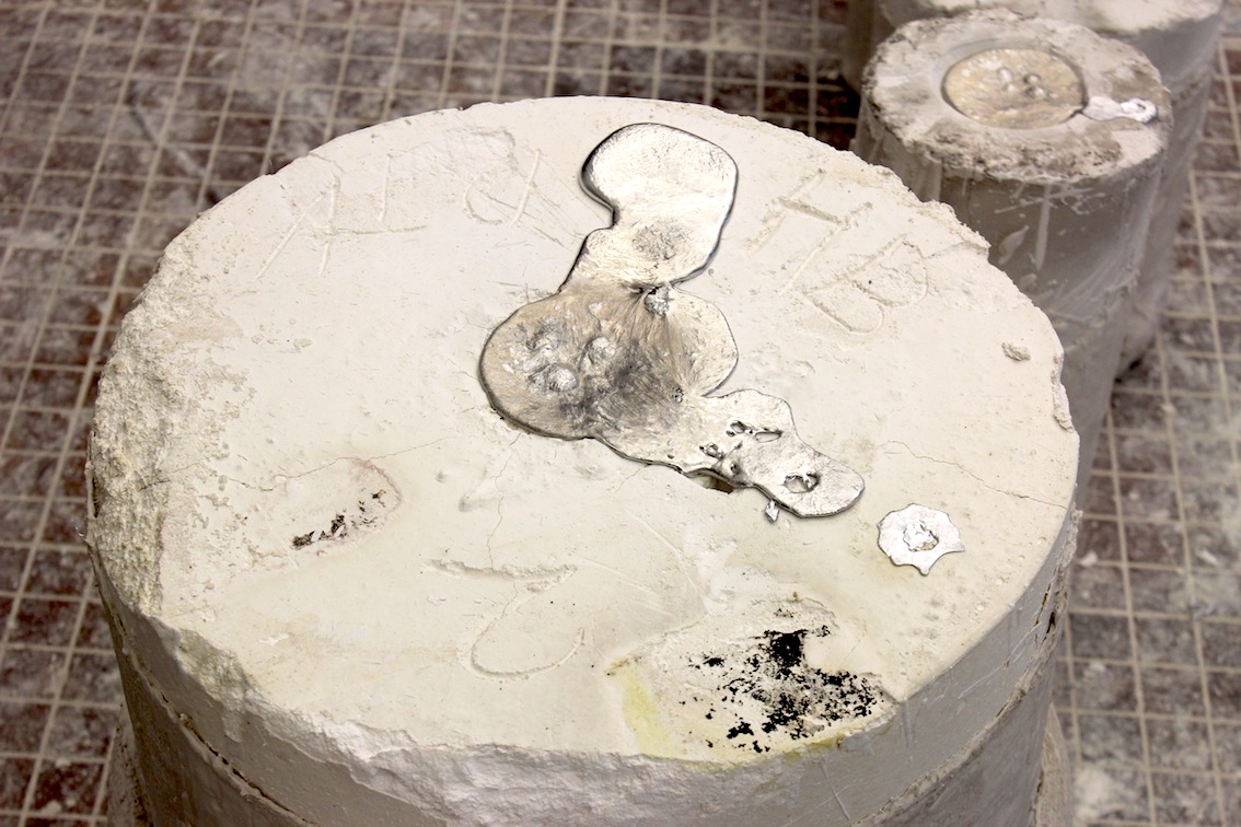

than we cast the liquid metal into them.
the molds, filled with aluminium.
30 mitutes later the metal is already hard and we can break up the molds.

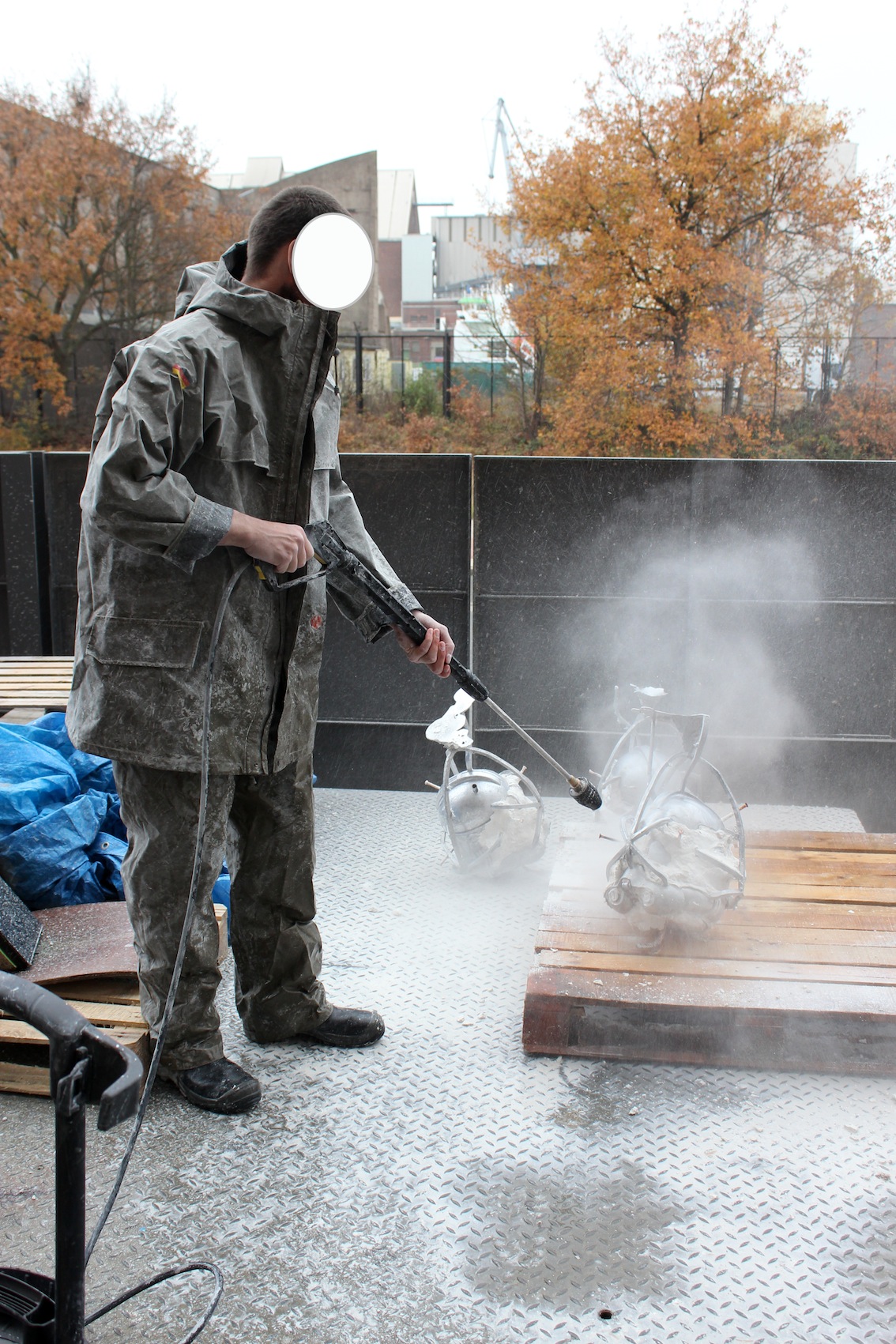

to clean everything up, we use a high pressure water cleaner.

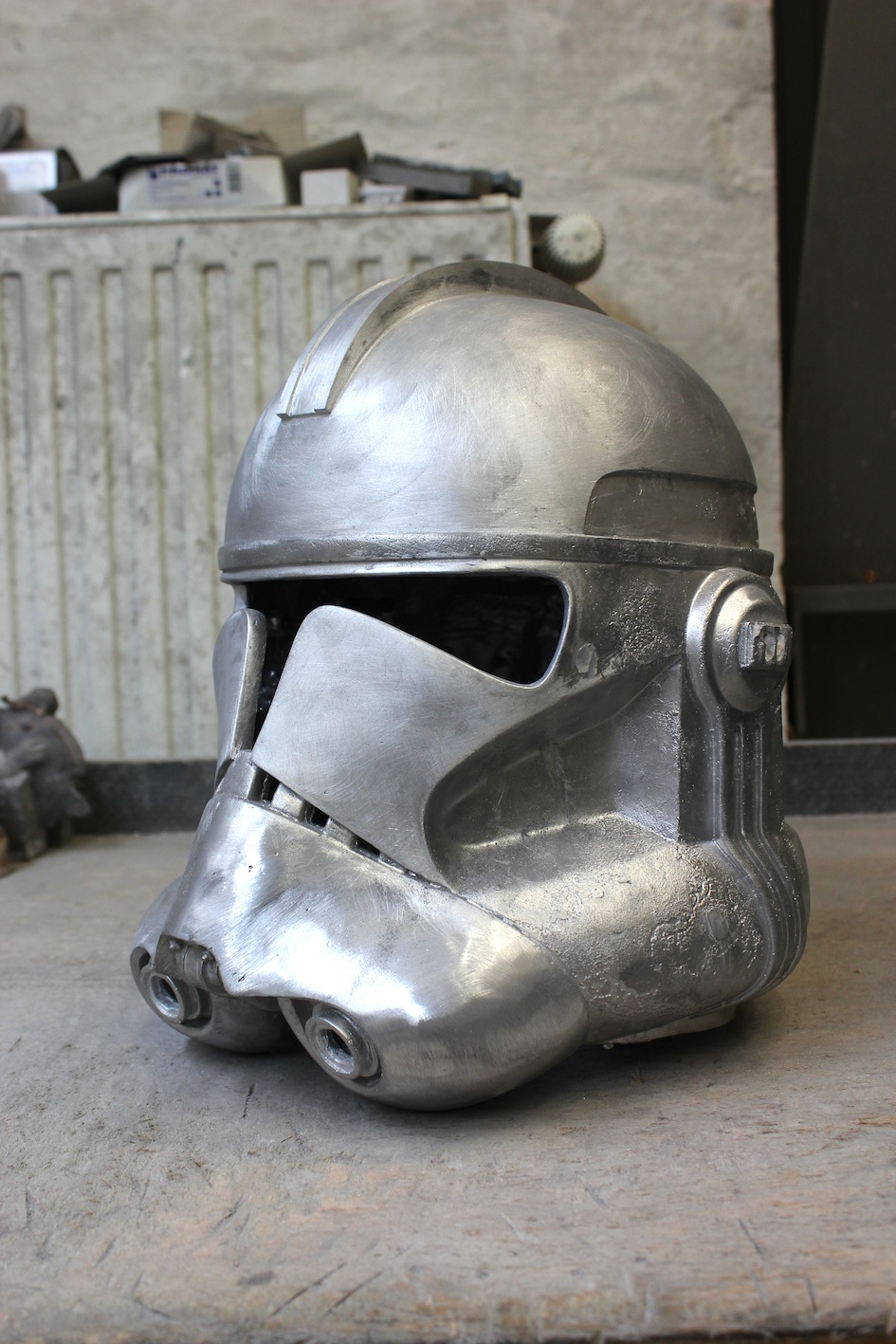

the aluminium helmets
now i had to cut off everything, i ve had put on the helmets first in the wax.
still fits my head. lucky, because sometimes a cast can be smaller up to 2 percent.

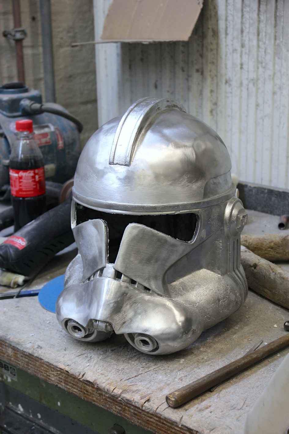

now i ll have to make the surface smooth again.
well, as i said, I'm a little bit in anger that the surface is so rough, but at least, you may imagine what it will look like at the end. i can already imagine the look of the free helmet very fine. in my opinion, the alumium fits very well to the movie.
the one i ve started with should look better and better every day i work on it. so ill post the progress every day i think.

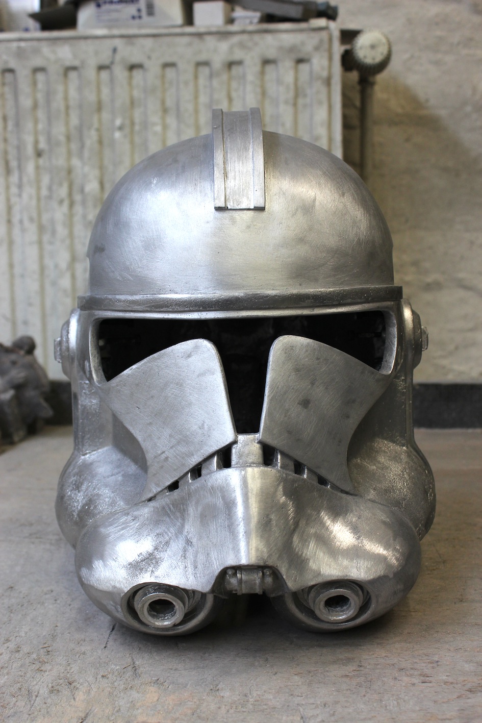

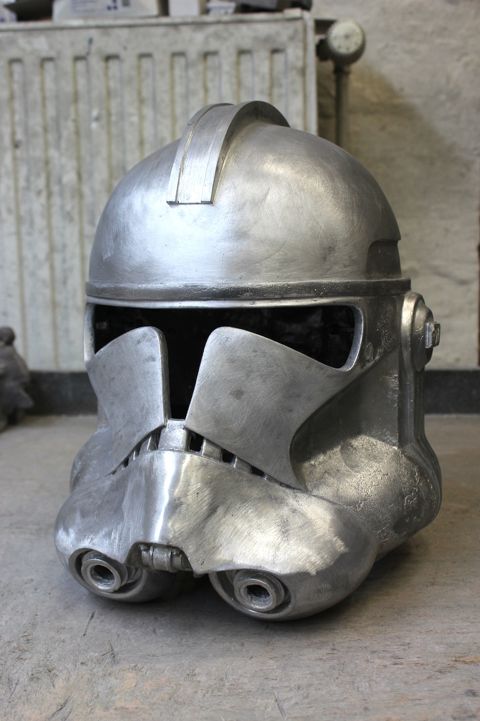

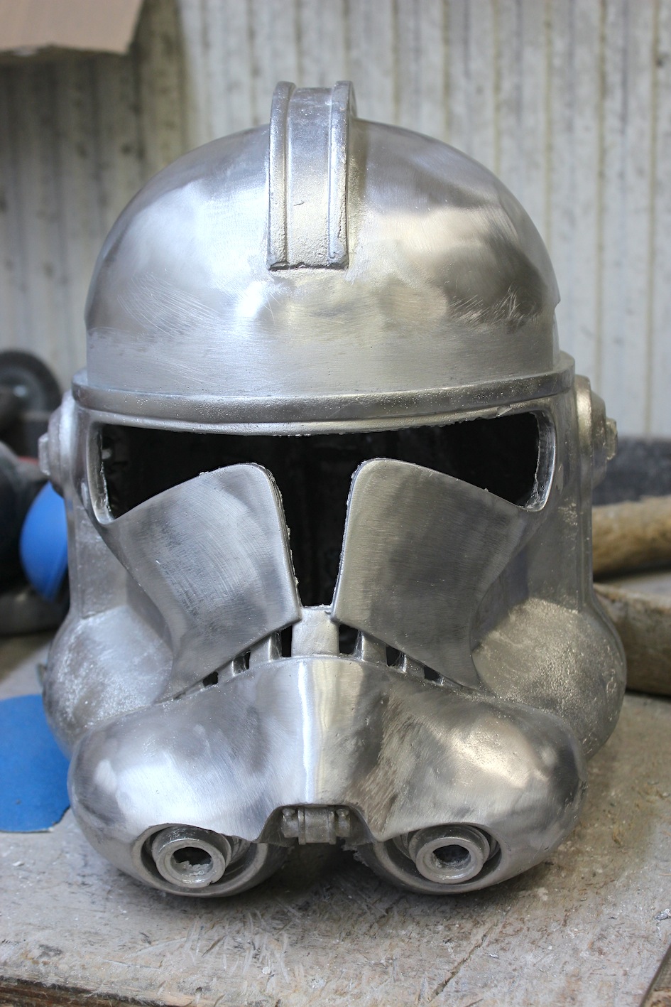

the results after a day of sanding:
dome is mostly done also these part on top. the area around the visor is done too. so i guess in about 1 week i should be done with the metalwork. hopefully. i hope i can colorize the 501. and the shock trooper in middle of december.

Absolutely amazing! What are you using to sand all the detail sections of the aluminum? I'm working on an aluminum knife prop at the moment.

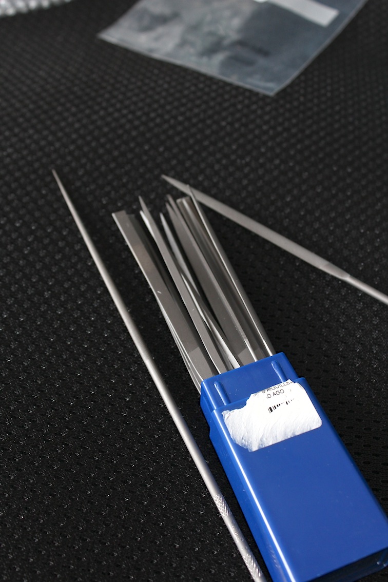

so i just use normal sand paper for sanding starting with 80. for the bigger areas i use also an angle grinder but at least its always handwork to get a smooth round surface, especially for the dome. for the sharp details i use files (i have to get a special aluminum file though). i ve got some special files for goldsmiths too for the details. these are very good and you can work pretty precisely with them. they also don't stick too much with the aluminum too, as files normally do very fast. thats the main problem with aluminum though. too sticky with the tools. so sandpaper is always better. i ll post a picture of the mini files below. yesterday i also bought a green visit for motorcycle helmets for my gree one. and i already have 2 protection visors for welding which matches perfectly. absolutely black from outside and you can see through it pretty well. all made out of polycarbonate which is a little bit more resistant against scratches and 2 to 3 mm thick. should be pretty stabile. the fabric for the interior is just an 6mm air mesh in black, what all the other stuff is laying on.
here are the little files...
