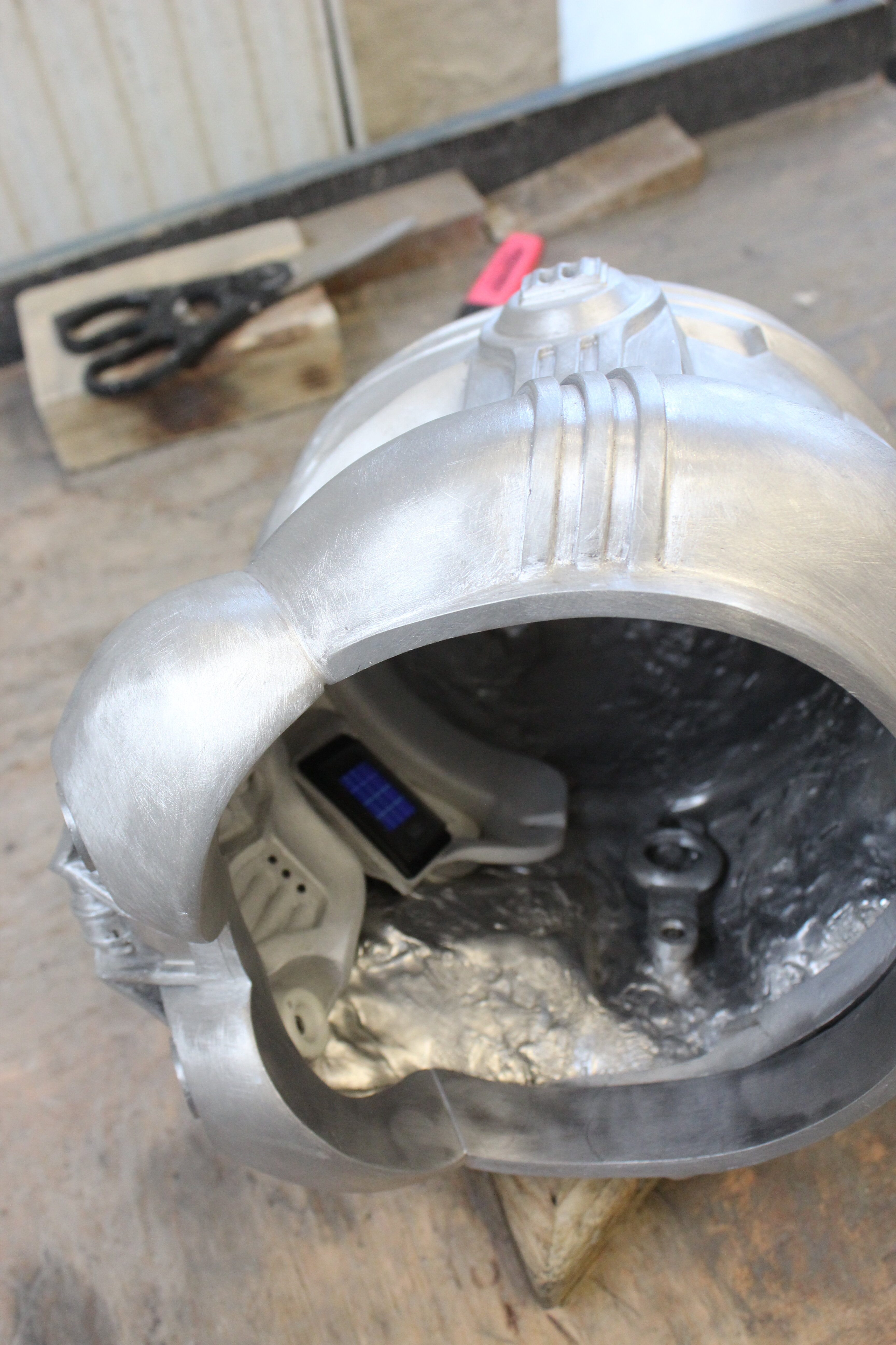

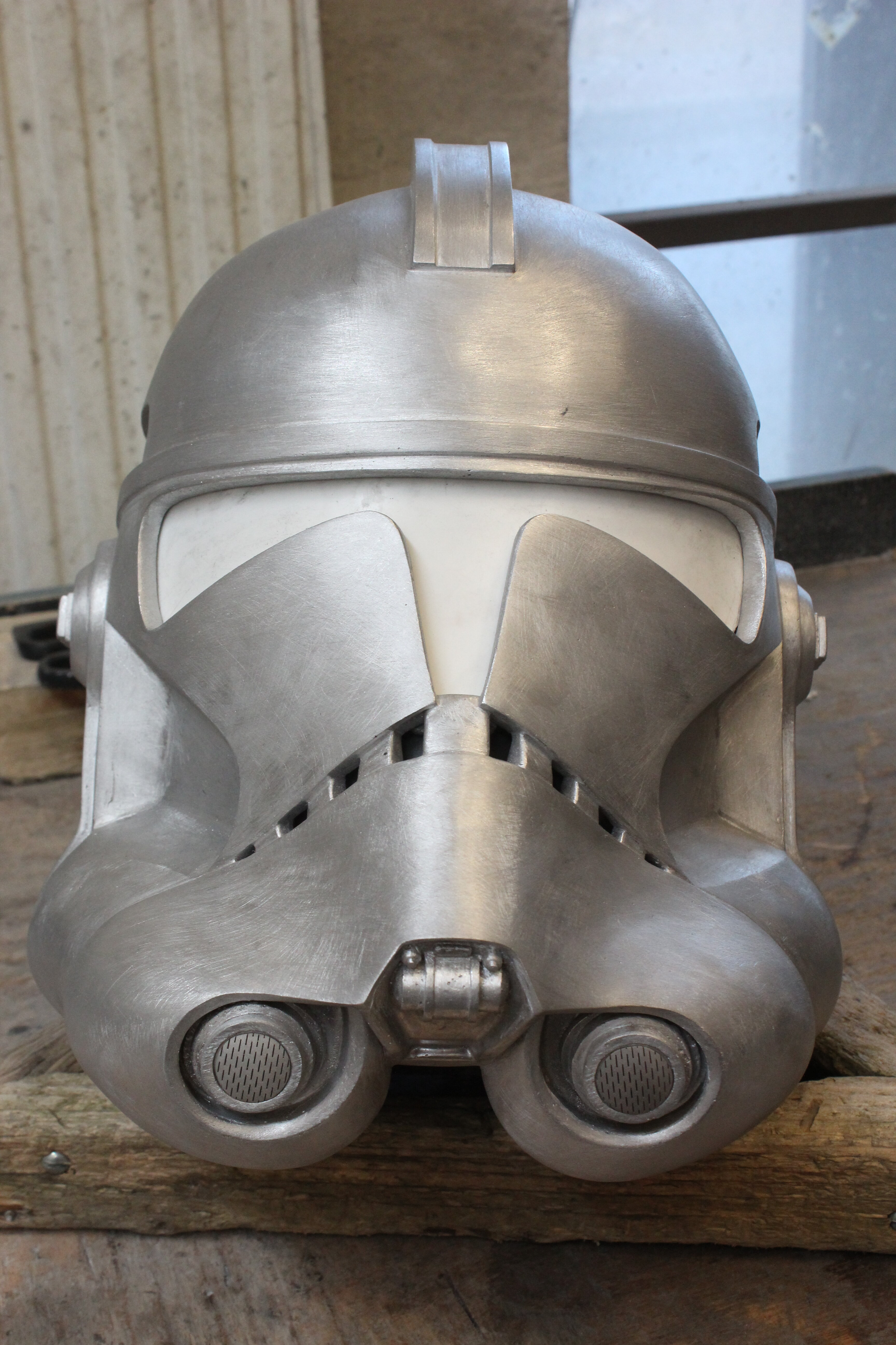

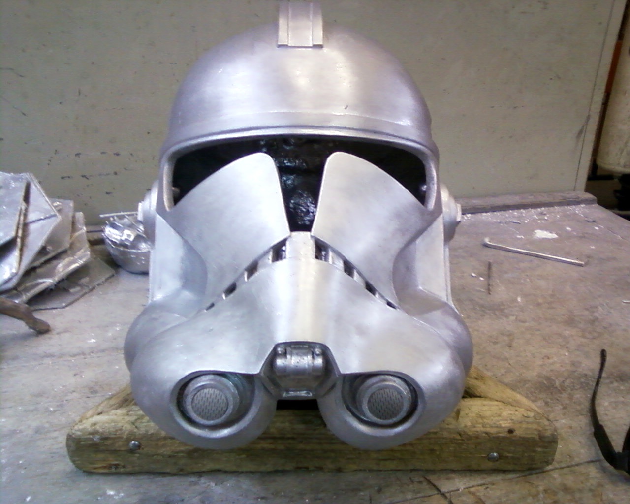

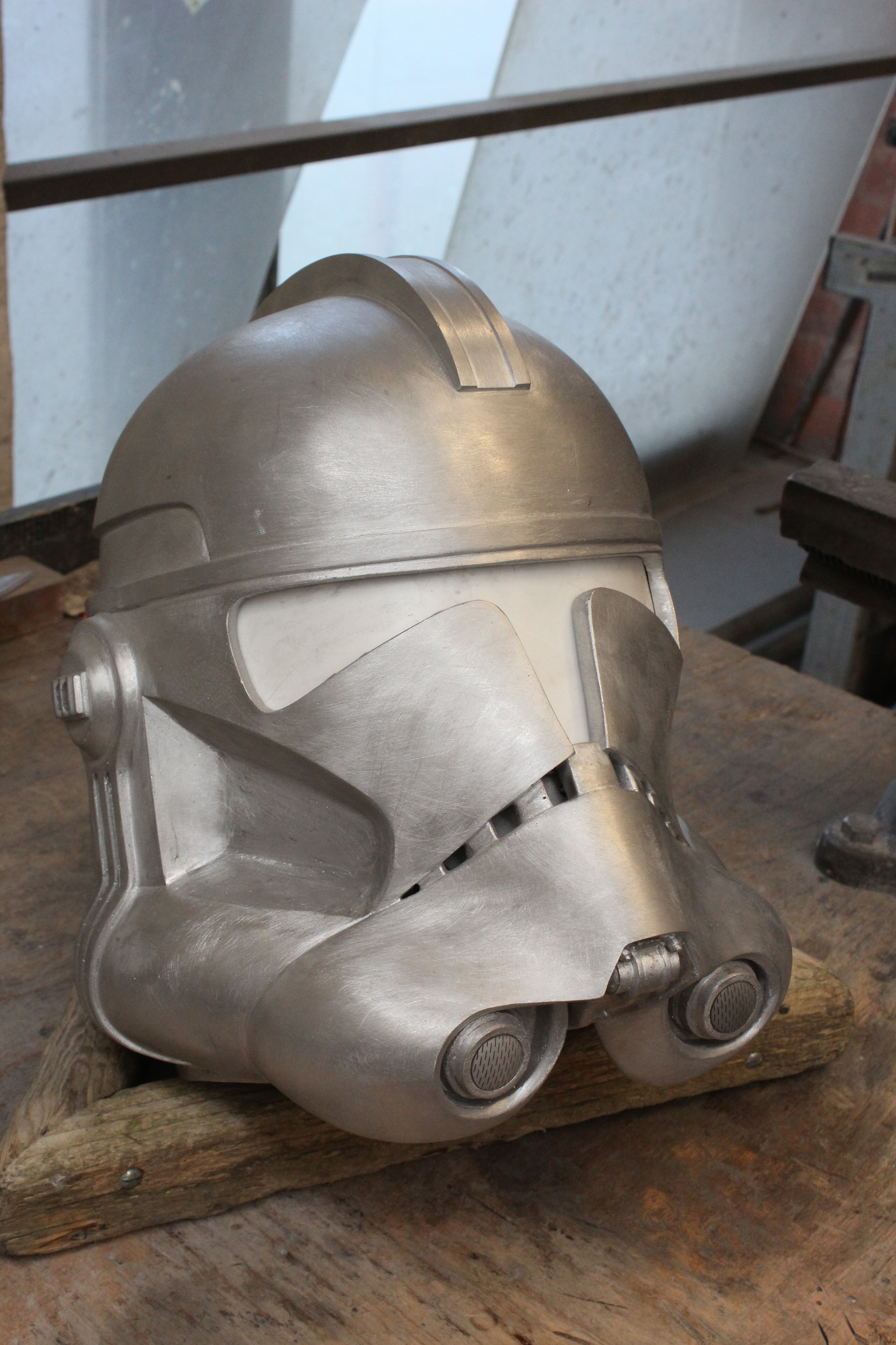

I ve sandblasted and filled the helmets today. just a few pictures of them sandblasted because the surface looks not realy like aluminum this way. you may imagine already how all the grey parts will look like in the end. the mictips, the teeth, the ears and the stripe over the black brow will stay unpainted.
Now I have to wait for the paint I ordered a few days ago. hopefully it will arrive at friday so my friend can paint it at the weekend.
I also build a small neckring that just fits above the real one and can be fixed with 2 screws. this will hold the fabric of the padding in place at the entrance of the helmets.

I was just a little bit lazy these days. no possibility to paint the first helmets as I said so I worked a little bit to finish the 3rd. nothing realy new there tough but I just tested to polish the aluminum on a little piece. you can't really polish aluminum though, but the result comes pretty near to the cgi helmet in the movie I think. another piece I worked on were the little grit covers for the mictips. my first solution were these normal grids made out of aluminum with round holes. I thought I could file out the material between two holes to make it more screen accurate, but now realized that this is gonna be too incorrect. so I found a company making laser cuts using dxf files. So I draw a screen accurate grid and ordered some of that cut in stainless steel. should look like that hopefully:

... you can't really polish aluminum though...
I'm confused by that statement. I have polished aluminum before, several times. The first time was to a "mirror" finish. Heck, just rubbing in Mother's metal polish over aluminum using a microfiber cloth will do wonders.
Re: Aluminium cast Clone Trooper Helmet
yes, you are right. sorry:) well, it depends on what alloy you r using. in my case its a special alloy for art foundries when Im informed correctly. when trying to polish it, it looks always a little bit dead. but in my opinion perfect for the helmet.

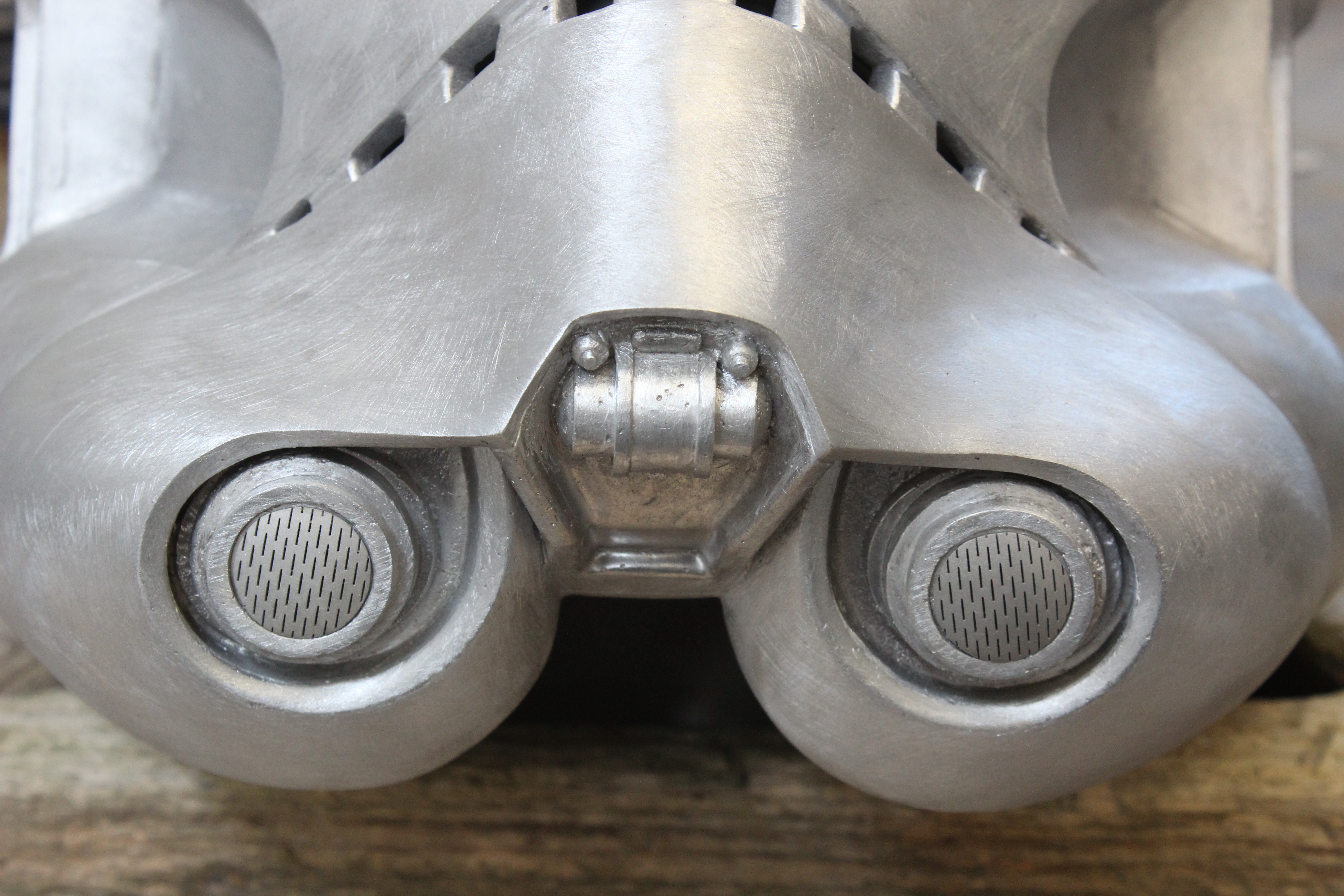

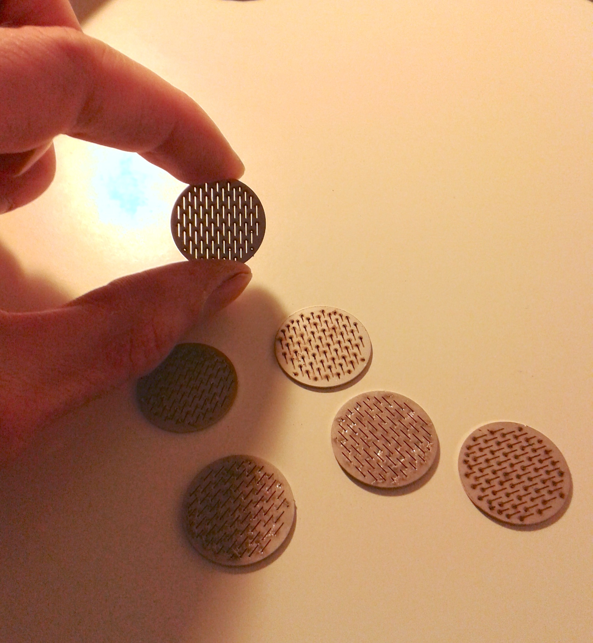

Mictips
Hallo again,
well, nothing exiting since the last update… the 3rd helmet is almost finished with the metalwork now so I can start polishing it this weekend hopefully. my friend will come back on monday than so we can finally start painting than too. but one little thing: my laser cut mictip meshes arrived today and I m pretty impressed. It s not really as planned though, because all the holes are a little bit to small. I thought the laser would be 1mm in diameter, bit it was much smaller. But maybe it could be a little bit more accurate to the original. The circle is a little bit too bit because of that too, but I can sand it down to the correct size easily. Well, I ll see how it looks like, when I cleaned these up a bit and put in the bulge. but for now I m happy with these parts.
Yeah, the holes look a little too small, but the precision of the cuts is impressive.

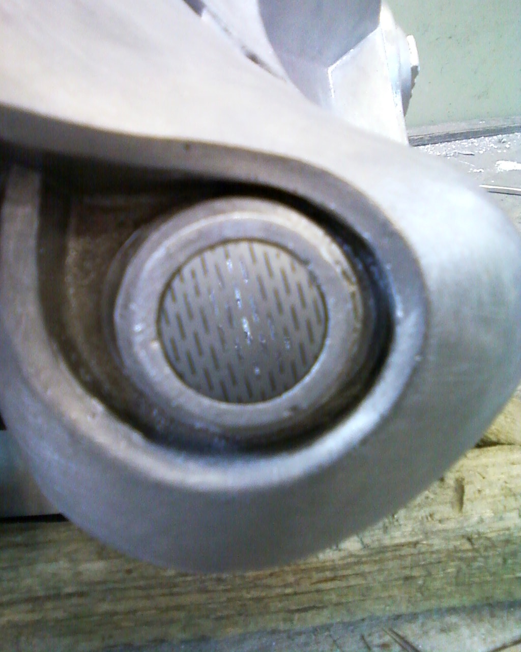

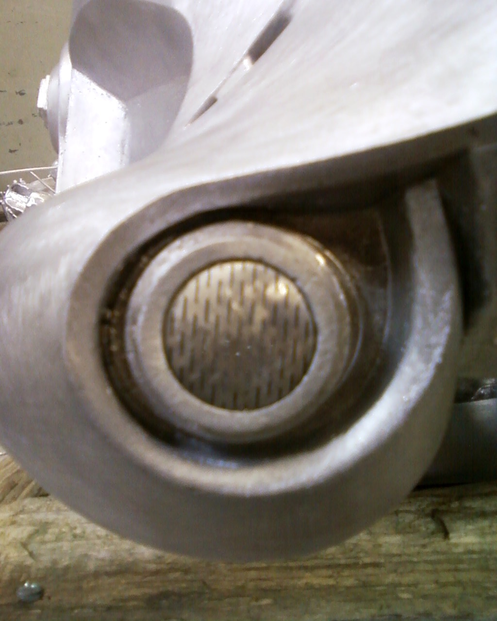

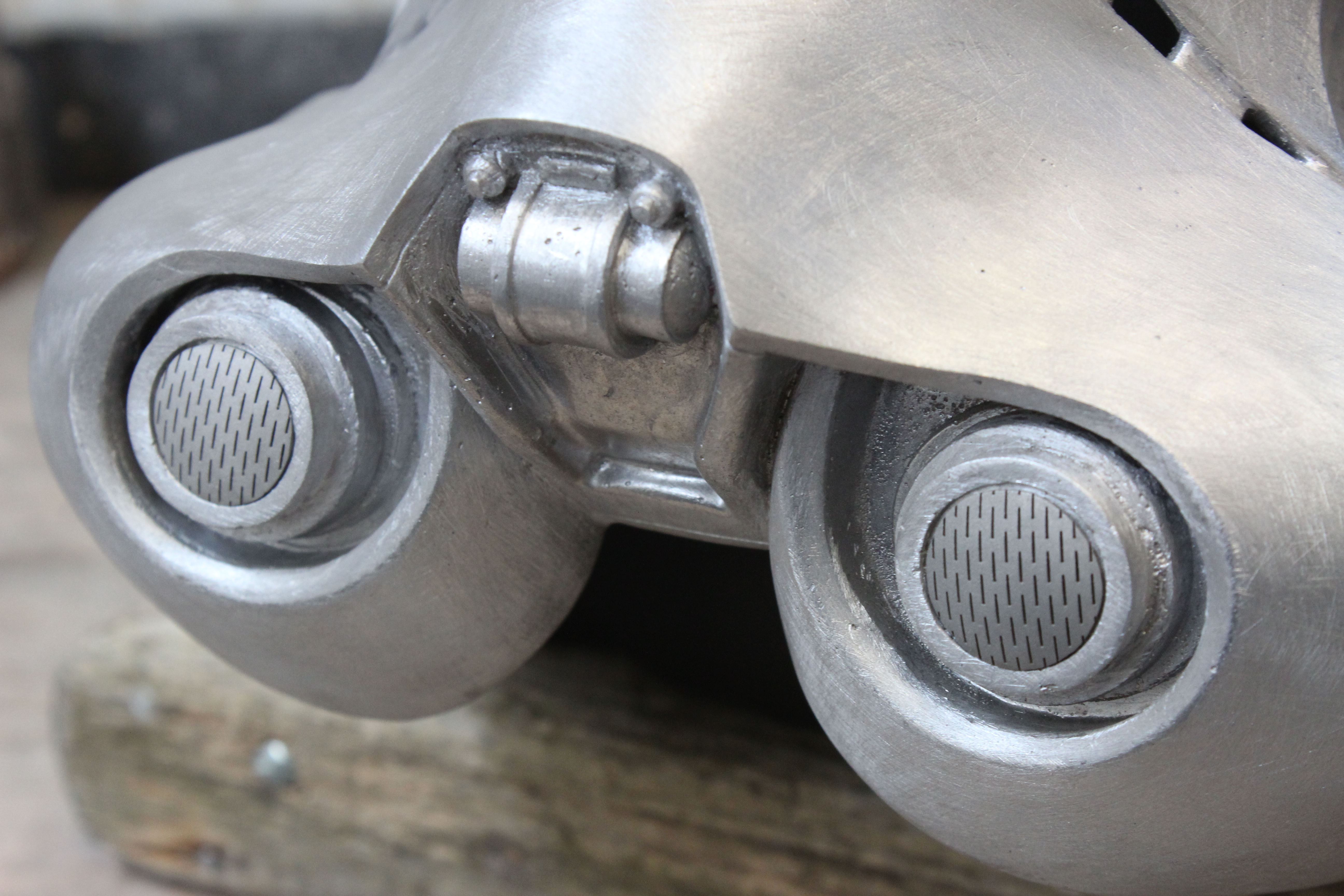

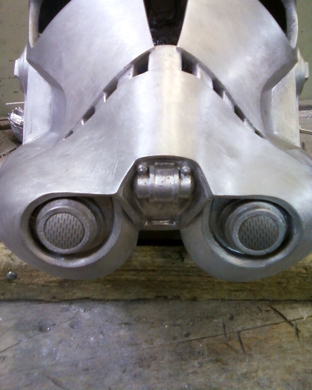

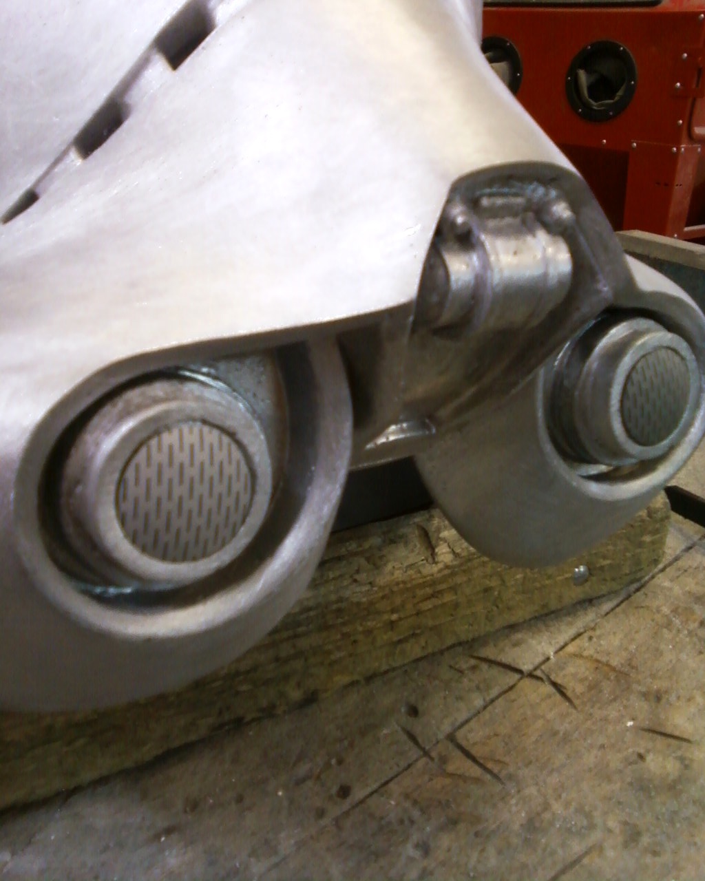

So, I finished one pair of the mic tips today and I think I m pretty happy with them though the size problem with the holes. I ve cut down the diameter so the number of holes isn t correct anymore, but the hole thing looks good for me. here some low res pictures with the mobile phone:
left side sanded a little bit, right side sandblasted
I think I like the sandblasted version most, so here some other pictures with both sandblasted:
the quality of the photos is poor, but I ll make better ones tomorrow.
as you can see, the holes are still a little bit to small, well not much though. but they also would have to be a little bit closer to each other. Well, as I said for me it works good. Its absolutely unique now and I think I won't spend this much money again to produce other ones.

thank you:)
here are just some few better photos...

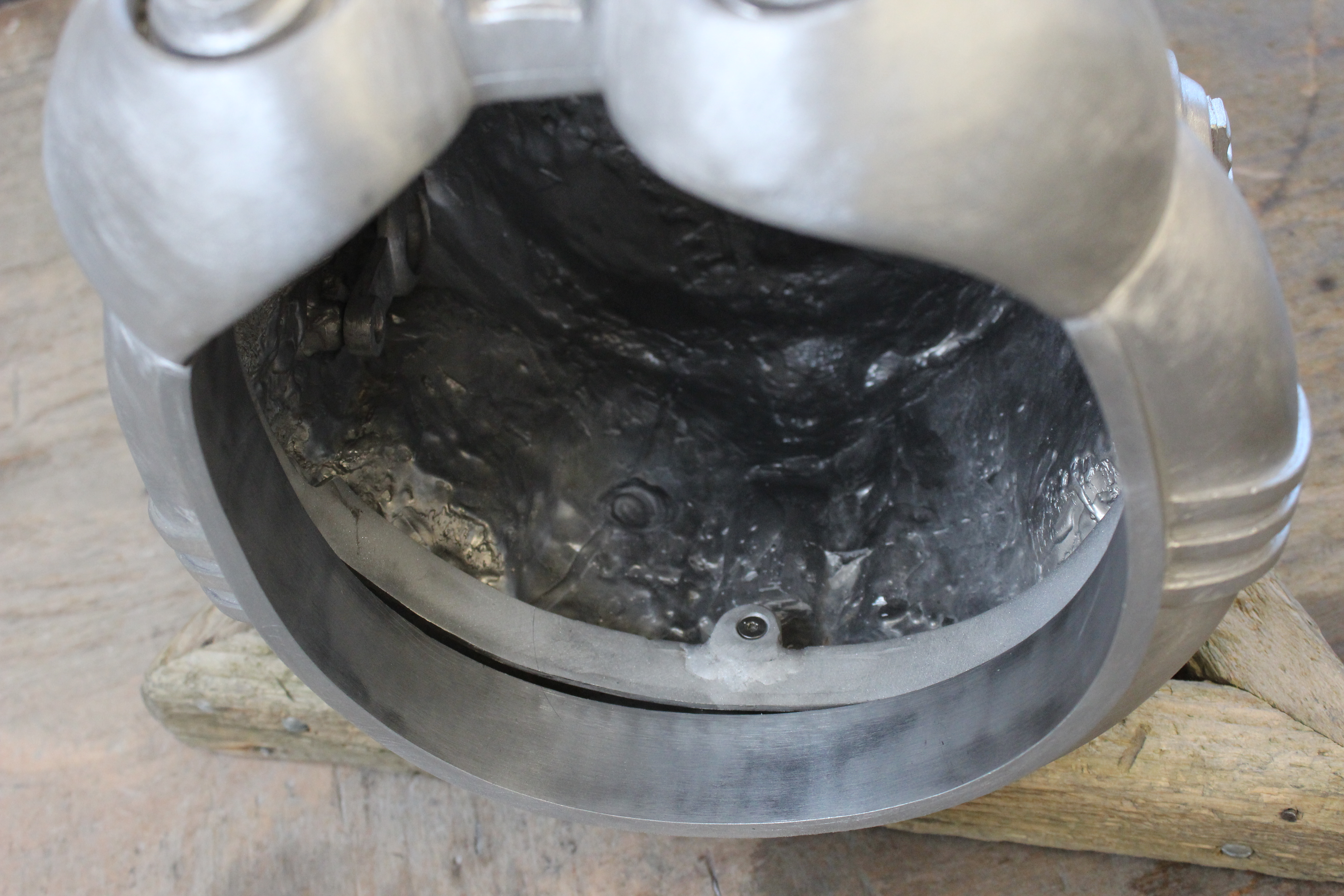

this is the inner neckring to hold the padding in place later
