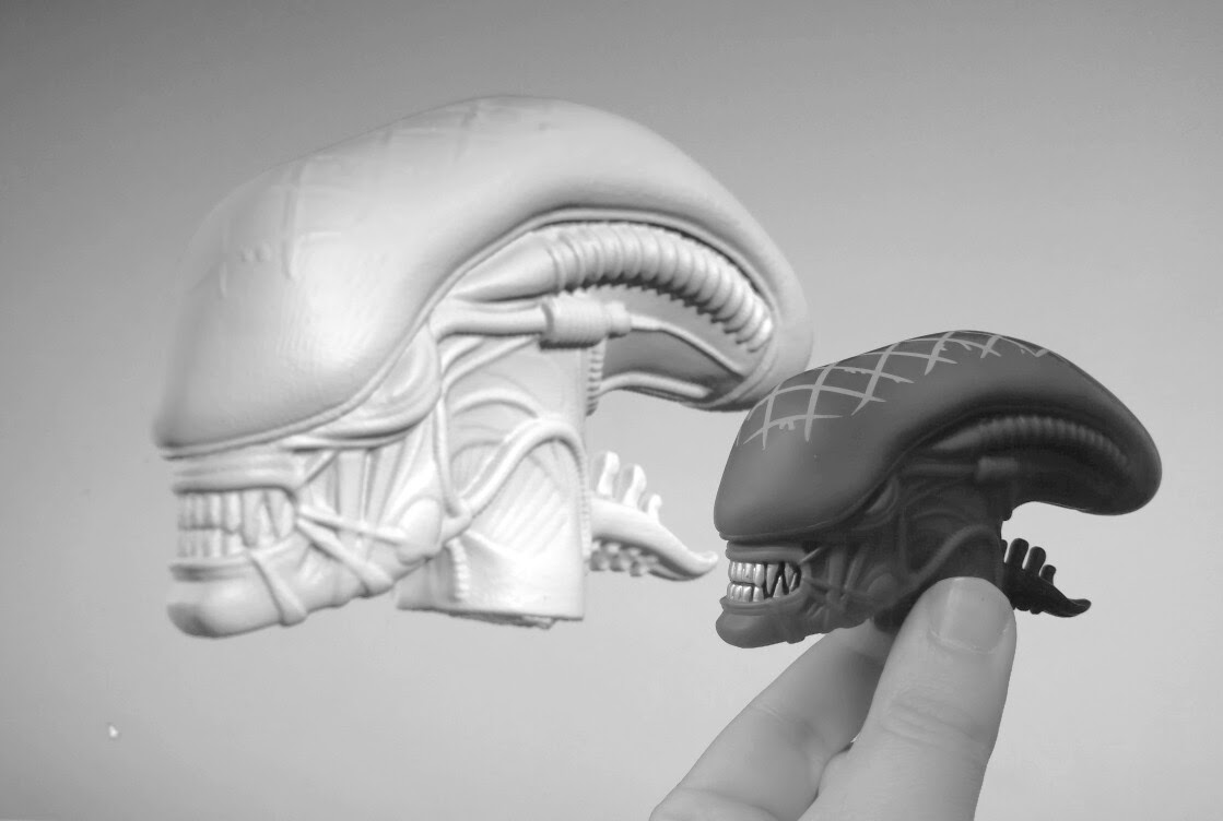

3D Scanning the head from the Action Figure
3D model comparison vs action figure head

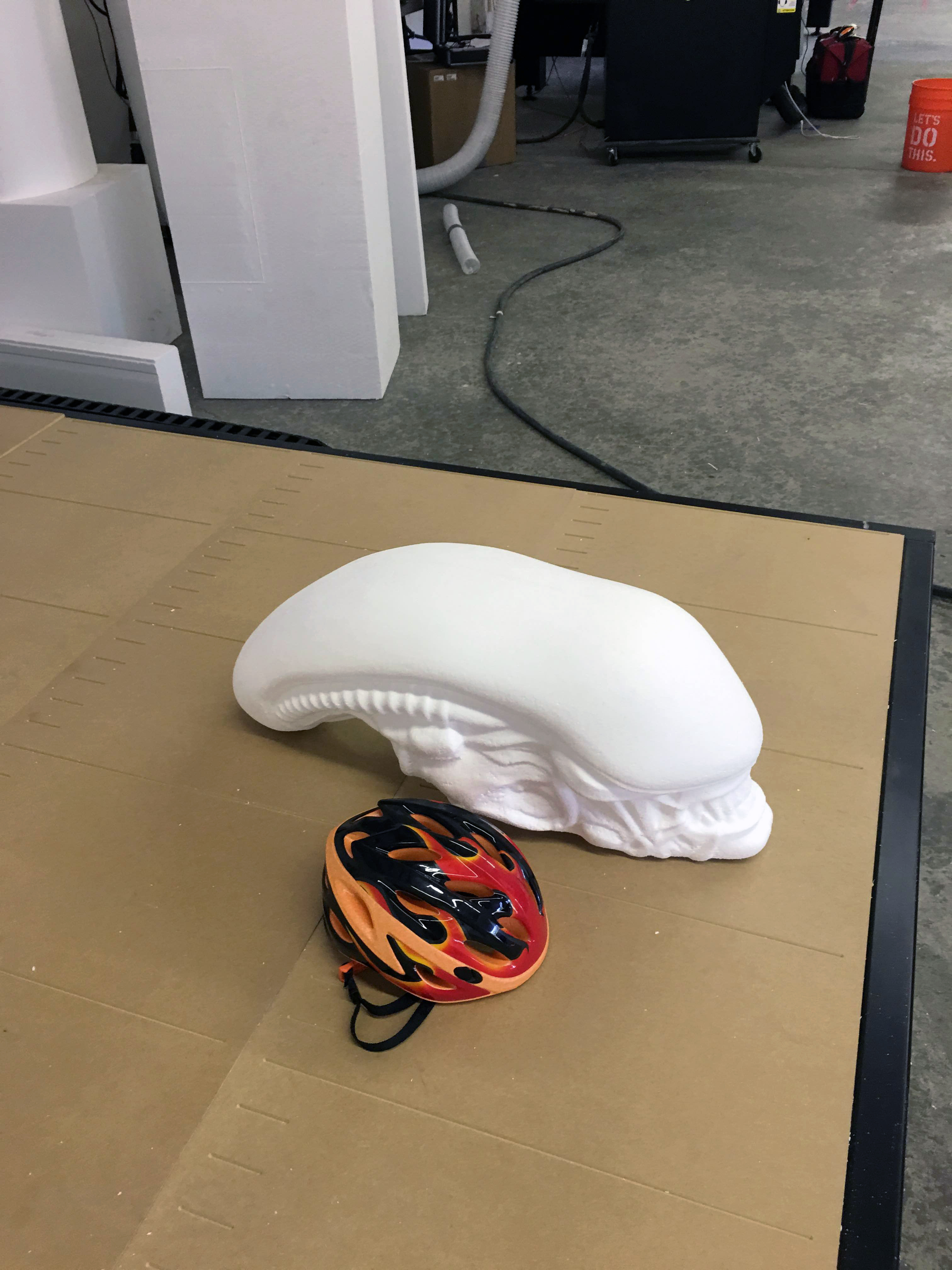

First half of the head being cut out on the 4axis CNC foam router

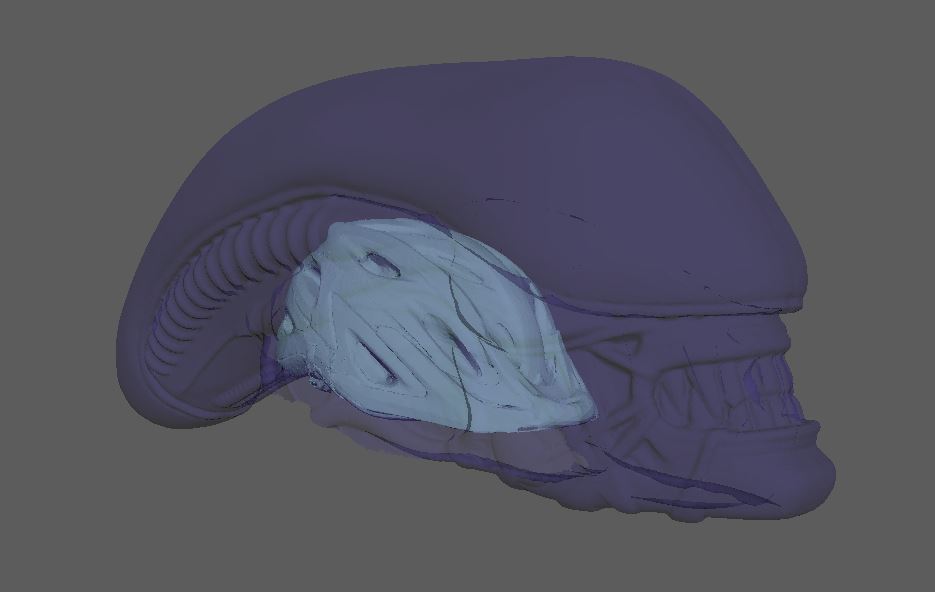

3D rendering showing how the bike helmet will fit inside the Xenomorph head
Another view of the bike helmet attachment
Xenomorph head beside bike helmet (size comparison)
Another comparison of the helmet and head

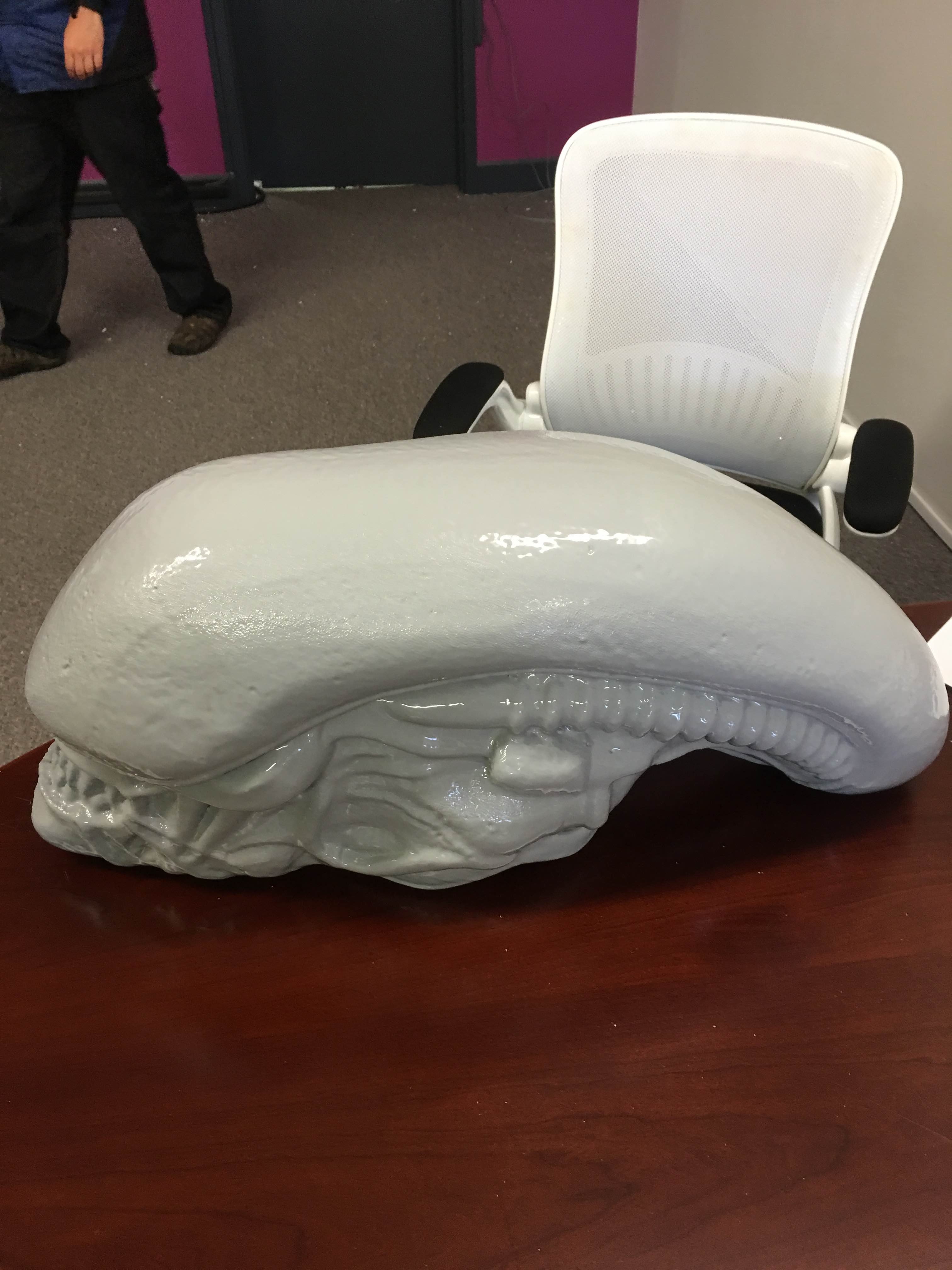

Here are a few updated pictures of the head piece. Please remember that this has been scaled to fit a young man that is about 44 inches tall :)
This shows the piece after we added a hard coat called Polyurea, same coating used in in truck bed liners from companies like Line-X and Rhino Liner. This adds a very durable impact resistant coating to make the prop last a long time. We'll be prepping the prop for paint and starting on it later this week or beginning of next week. Looking forward to showing everyone the finished prop!

Thanks cavx :) The coating is polyurea, a modified two-component polyurethane system. We heat up the coating and use special pumps to pump it out of the sprayers we use. Here's another video showing what an 1/8" coating can do. Its the same type of coating as line-x/rhino liner coatings. link: https://www.youtube.com/watch?v=aR4eRpekjnY
