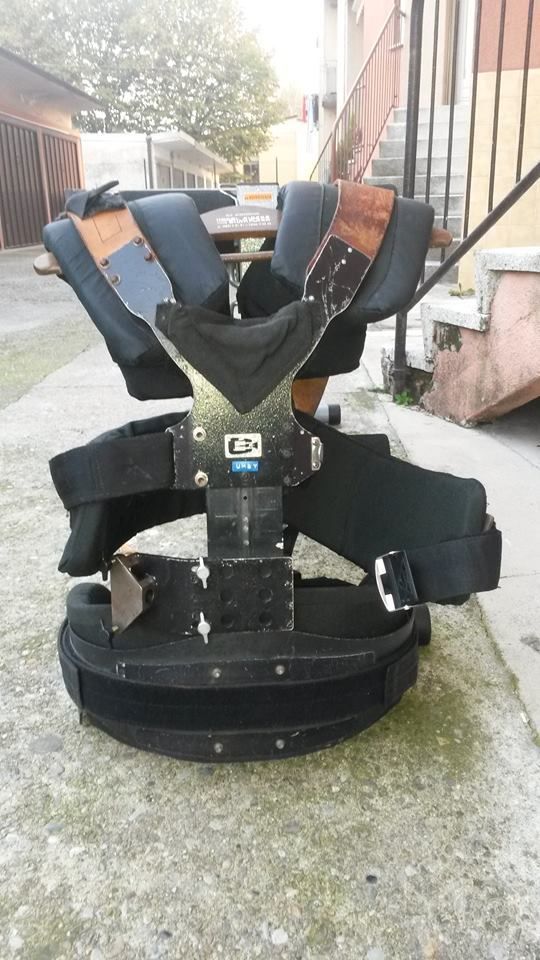

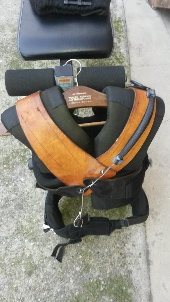

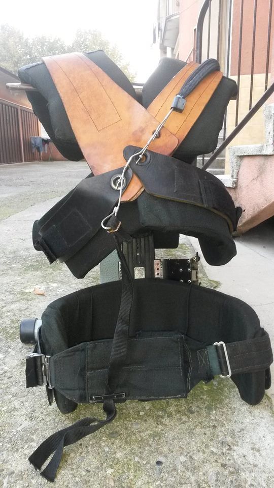

This is my third and final Cinema Products model III vest. I acquired it from a seller in Italy and couldn't pass it up because it's in terrific shape. I now have enough vests to comfortably do two M56's in the long run and also to have a spare, which pleases me. I will flip the connector for the steadicam arm to the correct side once I have a chance to actually unpack the vest and mess with it (these photos are from the seller before he shipped it to me). I've heard plenty of stories about people having issues shipping into and out of Italy, so I was relieved when the box showed up yesterday.
More updates to come when I start building the headset and gun (when the weather improves).

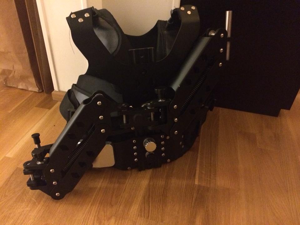

If you don't me intruding, this thread has made me finally get going on building a smart gun of my own- one of the last couple of firearms I need to complete my Aliens collection. This will be a budget build for me (as far as is possible with this weapon, haha): airsoft mg42 (arrived yesterday), china-made steadicam (CAM TV 2.5-20kg variant of which I found one very cheap locally) complemented by a few 3d printed parts (headsets and such nuless I can source real ones) and authentic items (already acquired the foot peg mounts and bike controls)
Here's the steadicam I'll be using:
I'll be doing some modding to bring it a little closer to the CPIII. A lot of the vest will be hidden by the armor, wiring and other details and I will add some parts to the arm to accurize it a bit. I'm usually a stickler for detail accuracy but in this case I couldn't justify the extreme cost of a proper CPIII so while I'll never claim anything close to screen accuracy, (something I feel folks do much too often around here these days) I hope to make it close enough that most people will not register the inaccuracies.
