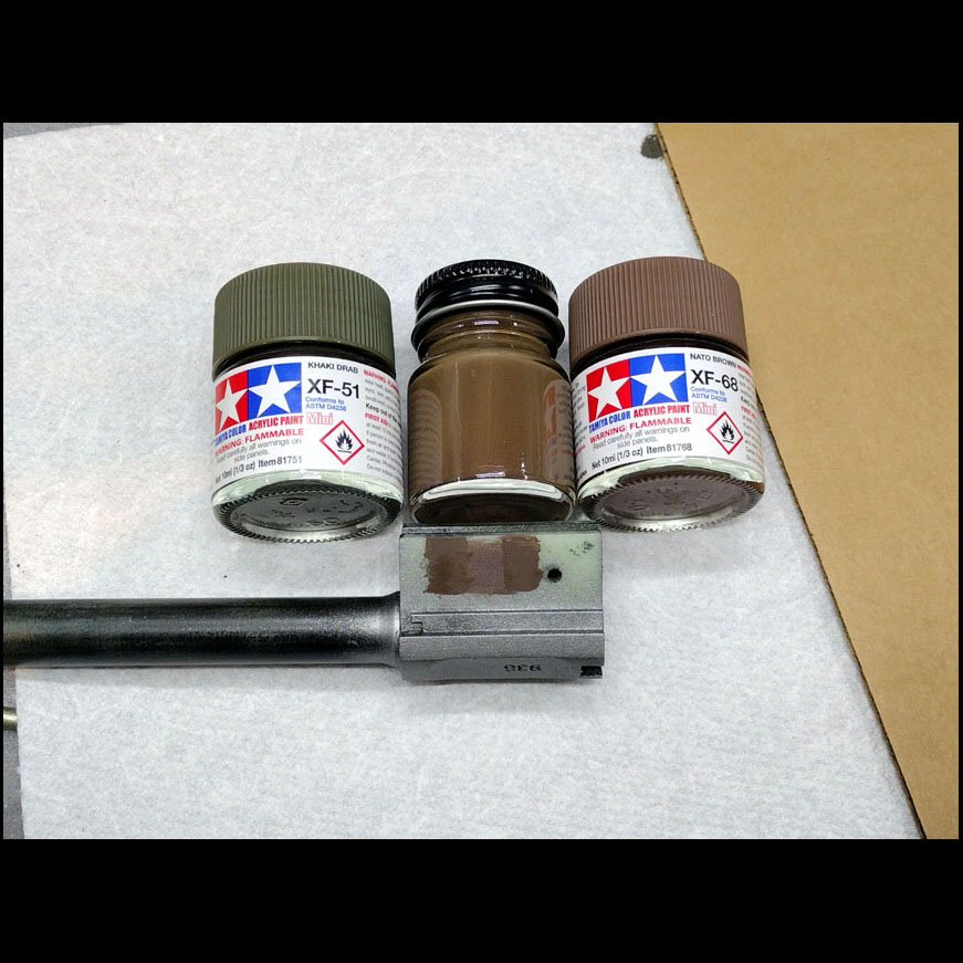

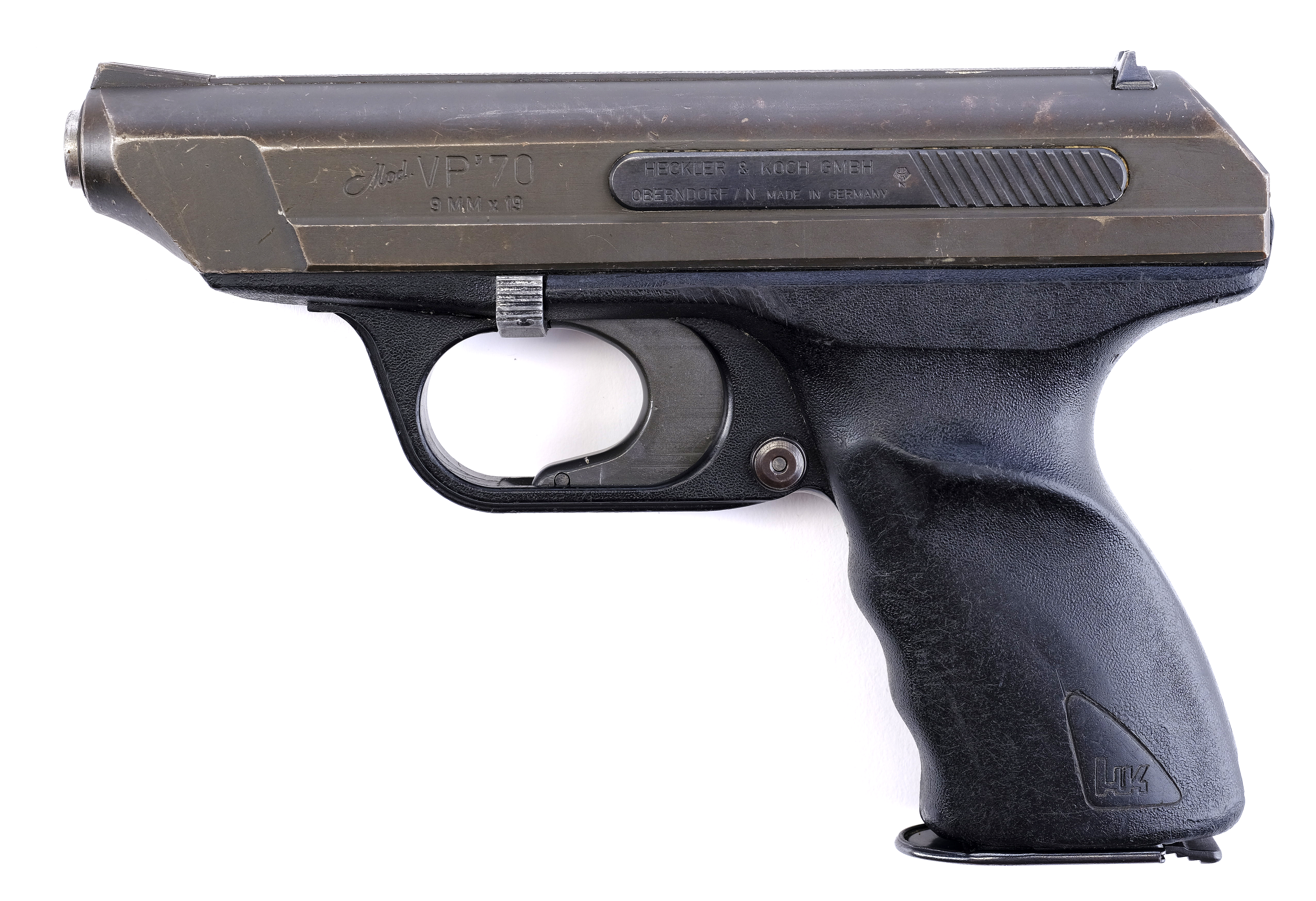

This was my primary reference for the color. Understanding that this was NOT a hero prop, and it's been weathered during production and possibly had color shift since production.
After a fair bit of mixing this was my formula. Appx. 35% XF-51 and 65% XF-68. This was by eye, so not an exact value. If mixing again I'd start with 40% XF-51 and expect to mix in additional XF-68 until it looks good. REMEMBER that the color will shift as it dries, and may shift when cleared too. So have a hair drier handy when mixing to test samples!

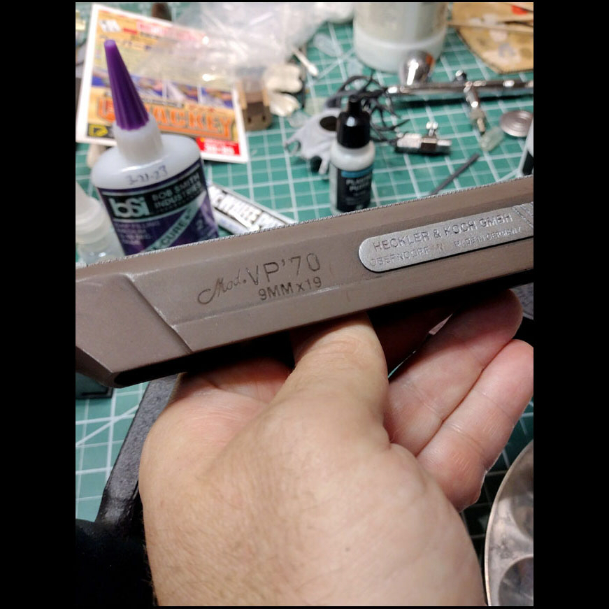

This is my VP70 painted and without any clearcoat. It is slightly weathered, including an extremely light Starship Filth wash and wipedown. This pic was under slightly warm light. The color shifts slightly browner.

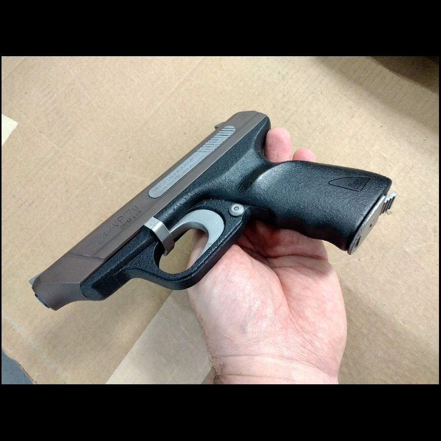

Also under slightly warm light, and maybe slightly over-exposed.

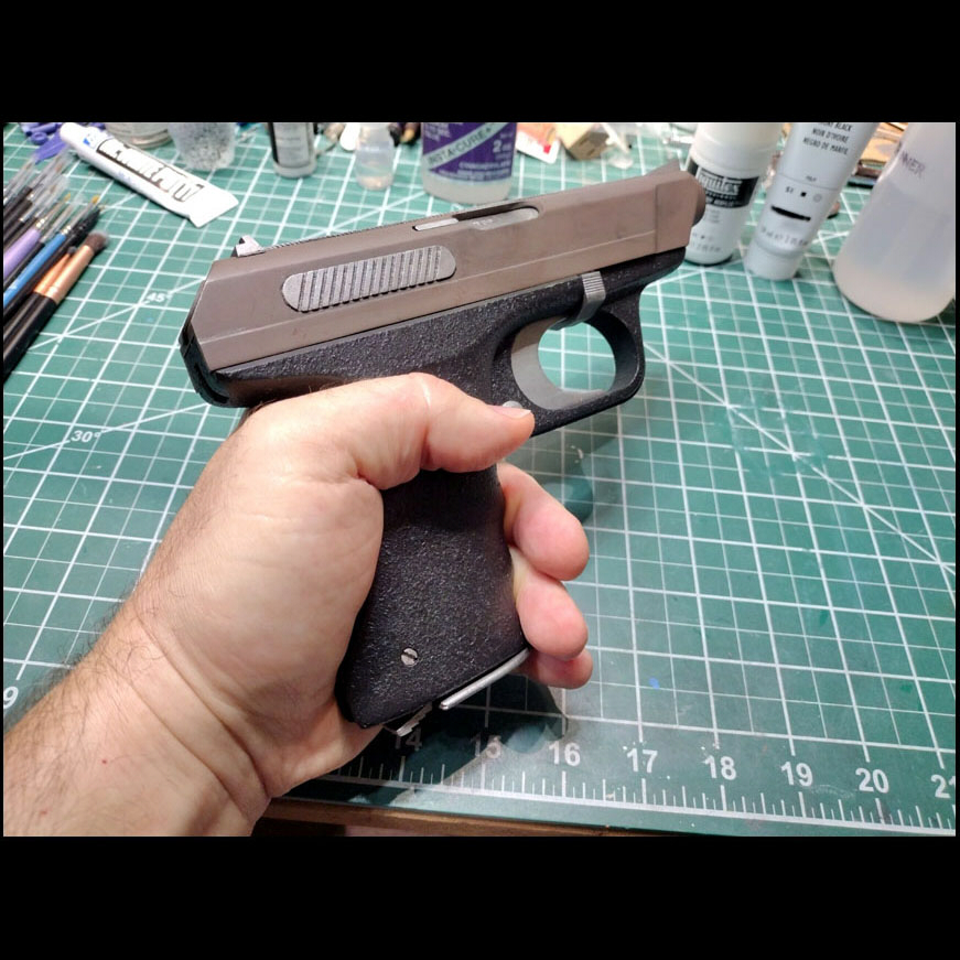

And under a cooler day light (combination of skylight and cold LEDs). Notice how it shifts greener.
