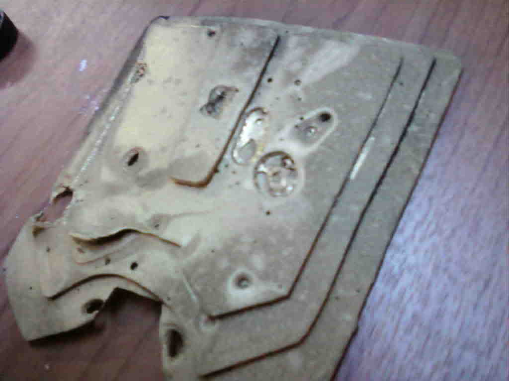

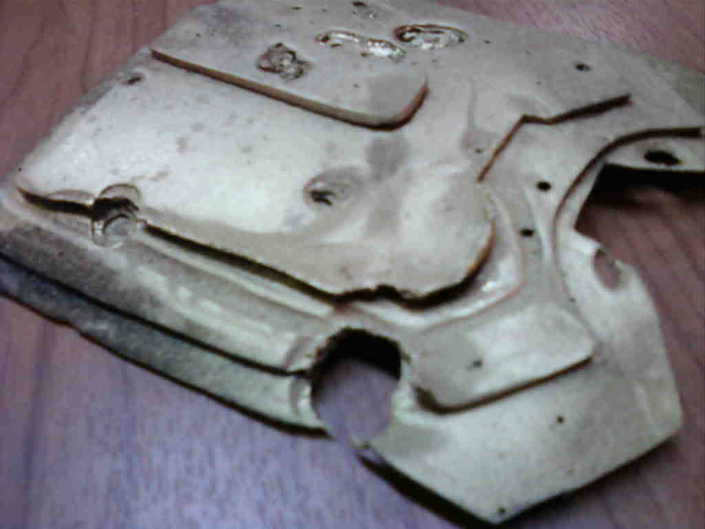

Well we figured something out, penetrating catalyst, gas, brake fluid, acetone, and xyline(sp?), and mineral spirits don't work. However-
When we sauldered it, It didnt work out as well as we hoped, and we tried dropping hot saulder on it, and it kinda melted it but left saulder in the hole.
Break thru happened when we welded on a steel bar next to the foam. it meltedit rather well, and did a good job making the armor look scarred, but alas, it did not yeild sufficient results for my original intentions.
This is what we managed to do to it, painted gold to show contrast in the melted parts and whatnot.
This side is what happened to it when we sauldered it.
So over all, a general failure thus far :) . LUckily my dad works at a plant that researches polymers, so he can get me TFC, a very aggressive solvent that they use to clean down to the molecule. :p
But on the plus side, I think welding and grinding next to a piece of armor so the sparks will fly would really make the armor look nicely damaged.
I think it looks good as well, but I didnt achieve the melted effect I was looking for, but I think I'm going to definitaly damage all the armor pieces like that
