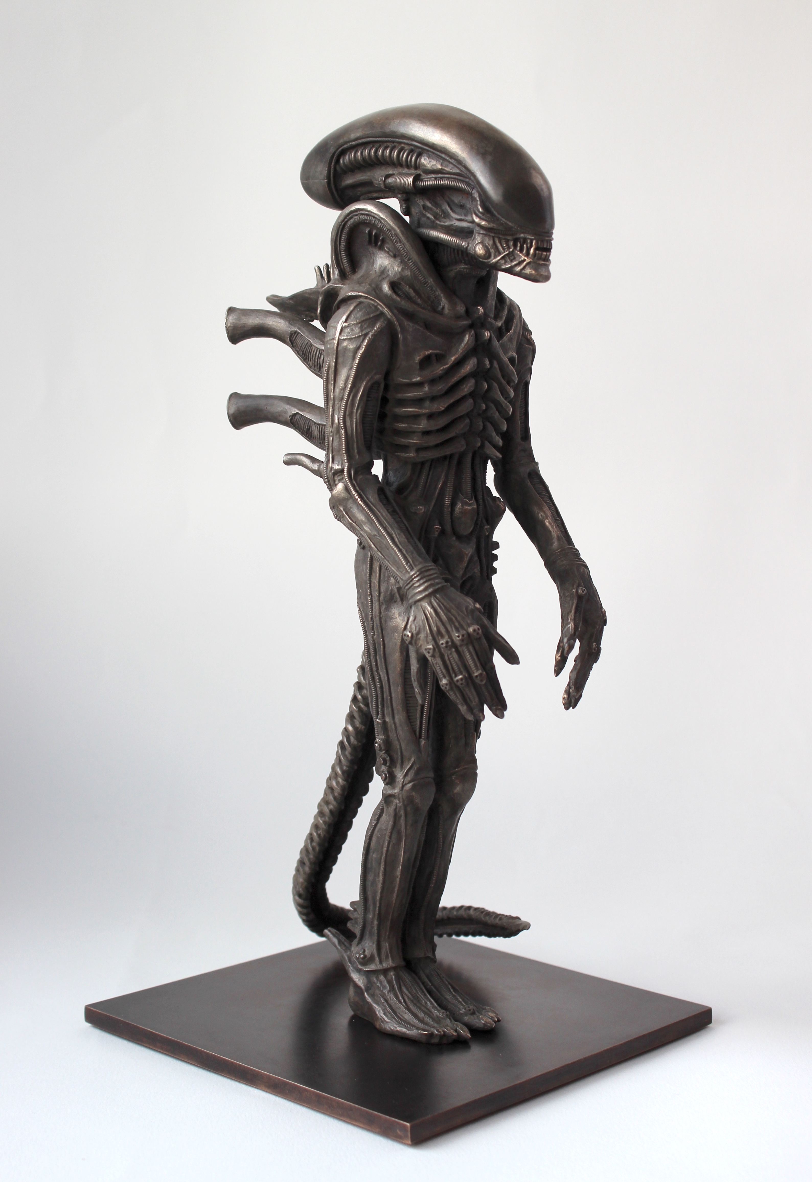

second cast is finished. this silver-nitrate is a really nice chemical. really like the color of this patina. this one has the giger museum pose, even though it represents the movie suit, not the giger sculpt. Because I am a little bit weird with numbers on my sculptures and I will probably keep the first cast, that one is officially numer 2, cause I like even numbers more than odd... anyway this results in the second cast is now marked as number 1. HB20 is my signature and year 2020. The base is black with some bronze marbling and more classic than the first cast and gives a nice contrast to the statue. I also sanded the patina particularly away at some points on the back and the inside of the hands to imitate the latex where the paint was rubbed off.

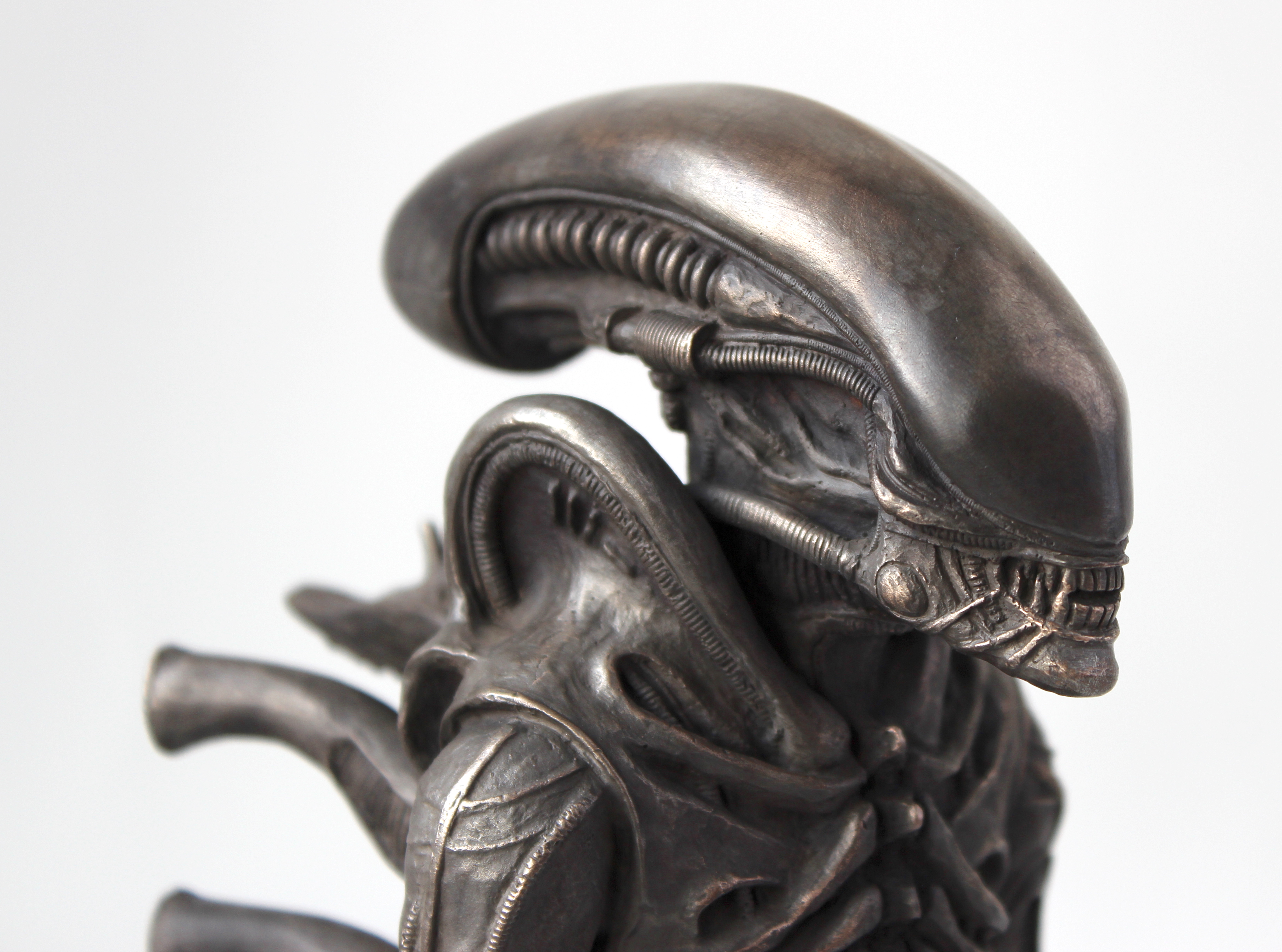

finished the third cast today. the stainless steel teeth worked very well. I gave this one a very deep black patina to contrast the teeth. The black color is a little bit hart to photograph but it looks very nice and so 3-dimensional.

looks a little bit brownish on the photos, but its actually really graphite black...
The black with the silver teeth is the way to go.
both got its advantages and disadvantages. the black patine looks very nice and brings the sculpting pure to the viewer but is not really screenaccurate though. the silver-patina looks more like the suit in the movie and looks also very nice. the steel teeth are great, but also a little bit inaccurate because I´ve cut them into a big screw. the sculpted all bronze teeth come close to the original for the small size of the figures. but I already have made 4 steel teeth so there will be at least 3 more aliens with these. I ll make the next with steel teeth and silver patina.

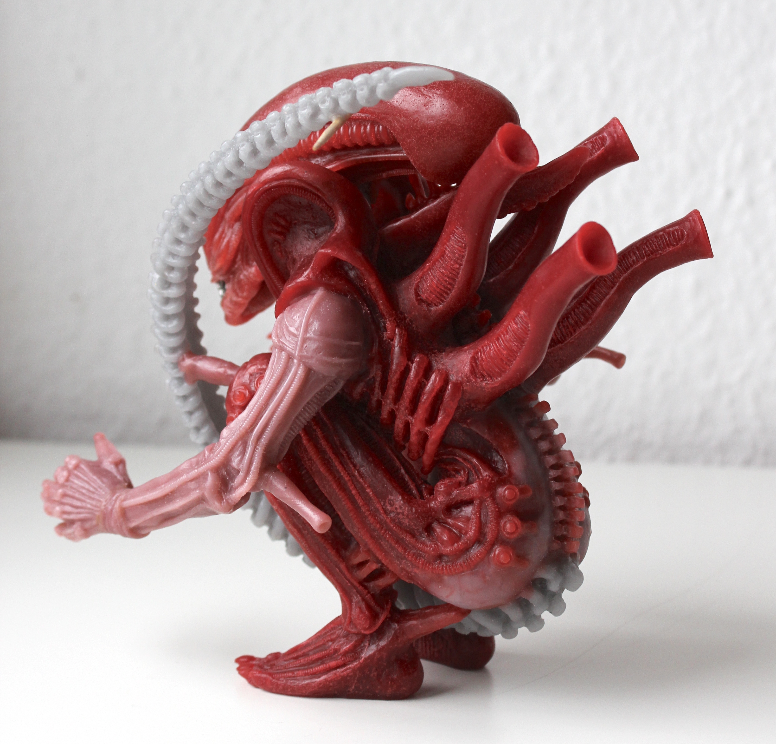

After the hot summer month, were I was not able to work with wax at home because it was not stabile enough at this temperatures, I started sculpting the next Alien some weeks ago. It is a crouching version this time an a mix of these two promo-photos:

I hope the crouching one will be cast next week so you can see the finished result in the next two weeks. Maybe I ll make it to cast one more this year, but not sure about it. The year is almost over though. Anyway there will be minimum two more versions with steel teeth. Next will be an order from a friends friend, who wants a pose close to the Kotobukiya ARTFX Alien, with a kind of walking attack pose.
Had time to finish the crouching version today. The mold had a little too many cracks so I had a bit more work with this one, but this could happen anytime in bronze casting.
