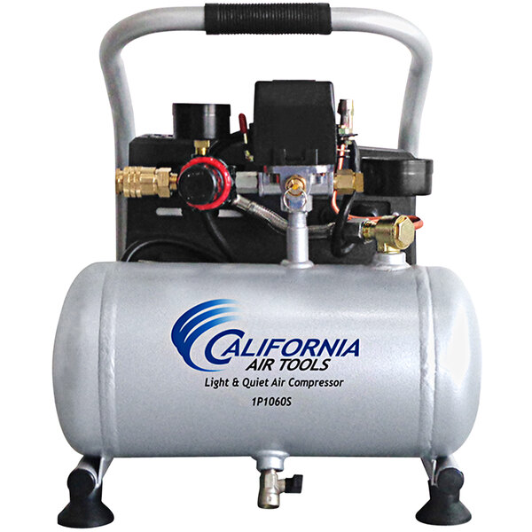

This is the compressor I have.
It's a great little compressor and super quiet. However not nearly big enough for my bigger spray guns.
