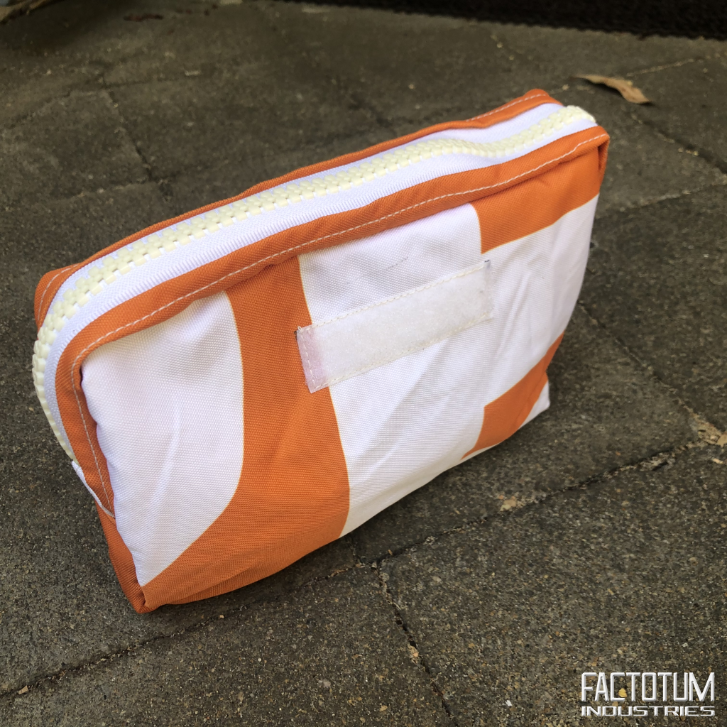

So I got around to having a crack at the EDC Pouch (large) in mid January and figured it was time to share some photos.
Hope you enjoy!
edcpouch001.pngedcpouch002.pngedcpouch003.pngedcpouch004.pngedcpouch005.pngedcpouch006.png
Hope you enjoy!
View attachment 1280793View attachment 1280794View attachment 1280795View attachment 1280796View attachment 1280797View attachment 1280798

I've sewn 3 of these bags so far, and while each one is getting better, I'm still having a hell of a touch time attaching the larger side panels to the top/bottom strips so that all of the corners line up and look crisp. I've found a few videos on youtube that show how to round a corner like this, but I'm still struggling. Did you happen to take any photos of your process of attaching the outer panels and the top/bottom pieces?
I’ve found a few things help :
* Make sure the templates / cut fabrics are accurate
* Too many fabric clips (I assume you are using them) are never enough
* Tension is crucial in not having the alignment of the two panels creep
* Doing a temporary sew at key anchor points helps (and just over sew)
* Some corners don’t work as expected - I’ve had luck with unpicking them, making them look better (poking with the end of a pencil) and over sewing
* Putting a diagonal cut in the corner of one piece sometimes help it bend / form better (especially when I was using PVC coated canvas)
* Ironing a shape in (if the fabric supports it) such as a fold or angle can help everything line up
* Coffee, good light and patience
* I can appreciate the search for perfection but don’t get lost in it - the bumps and blemishes add character and authenticity
Happy sewing!
