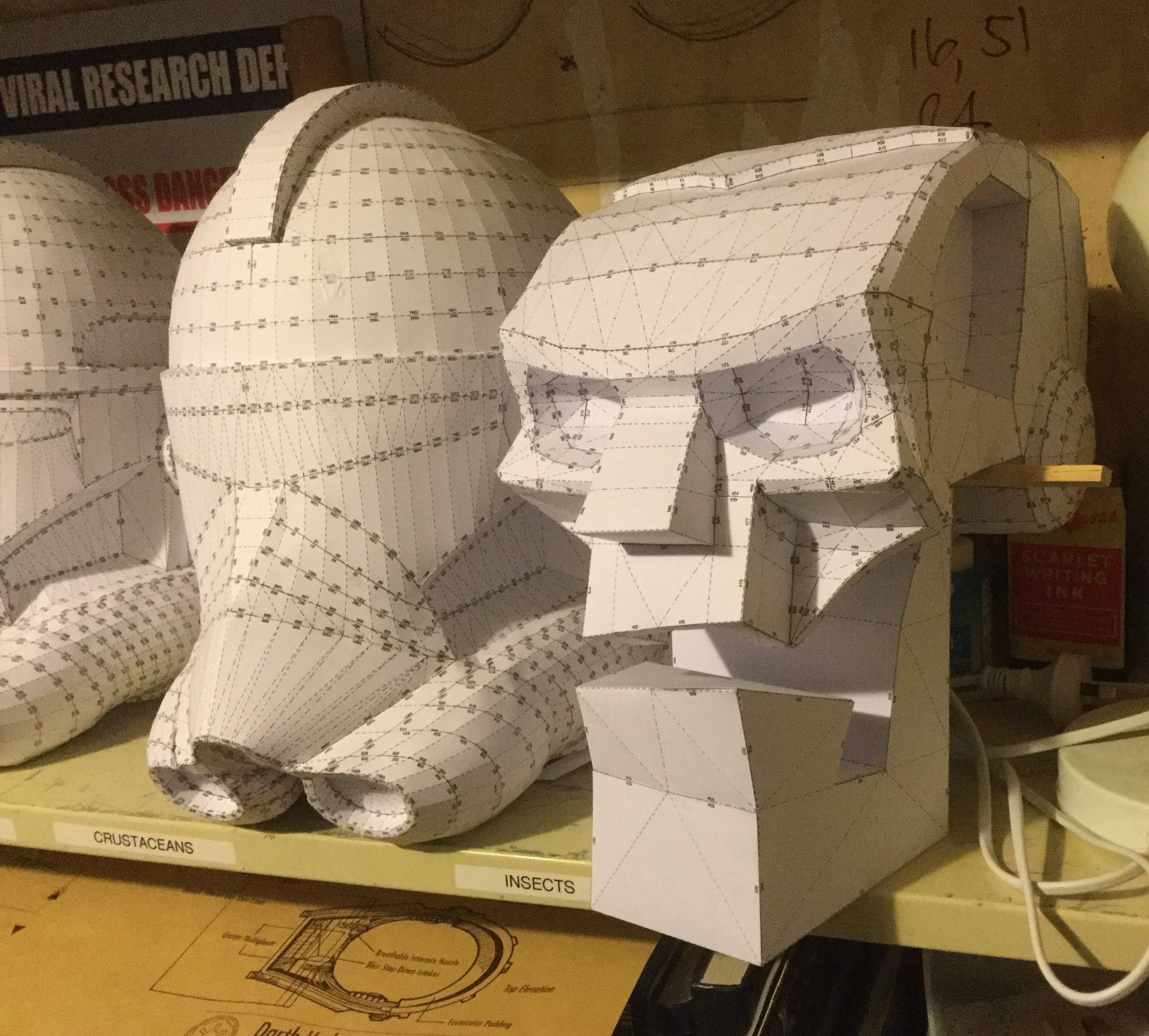

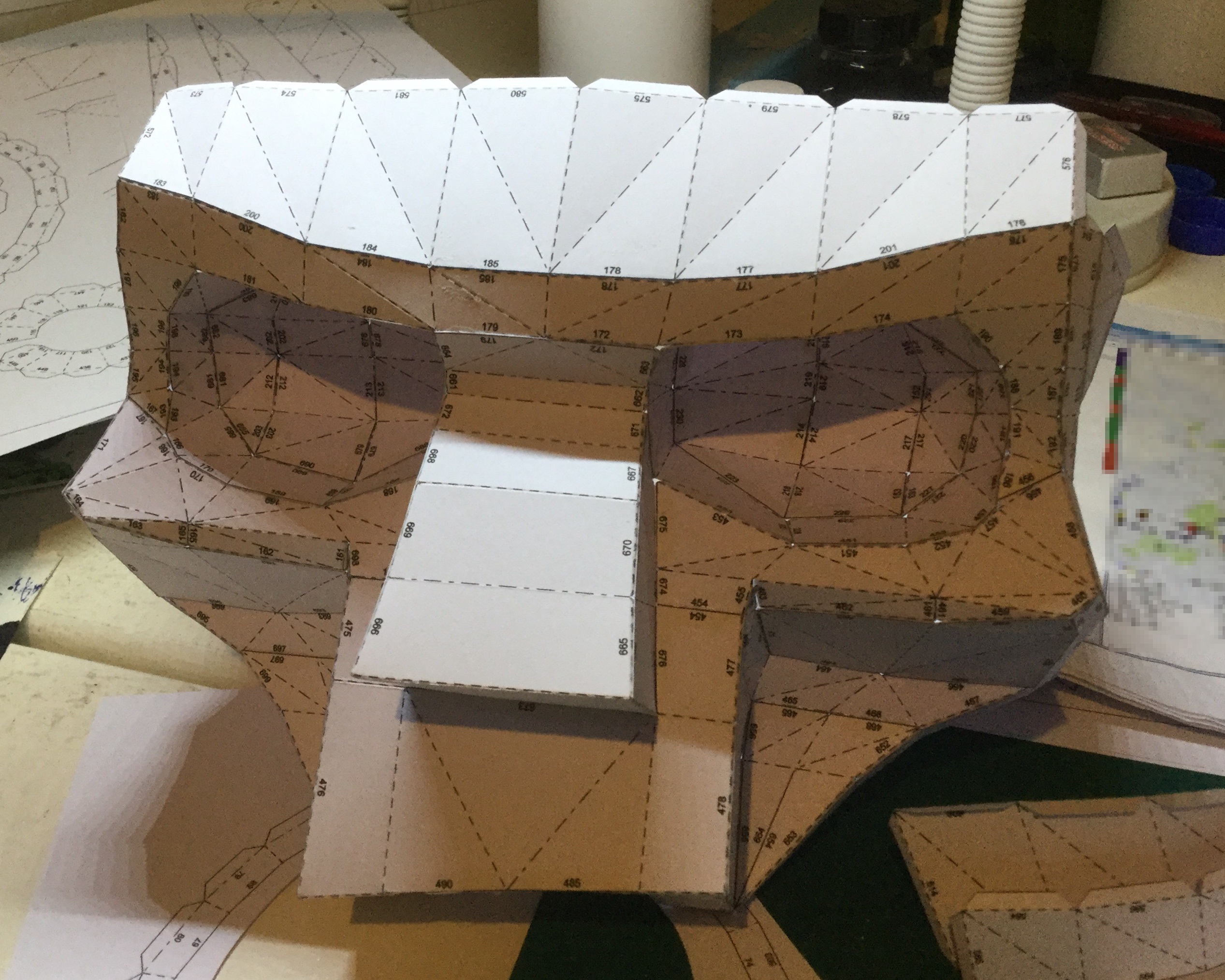

Just finished with paperwork. Not perfect - i feel a lot of sanding in nearest future)))
I think i must start building post.

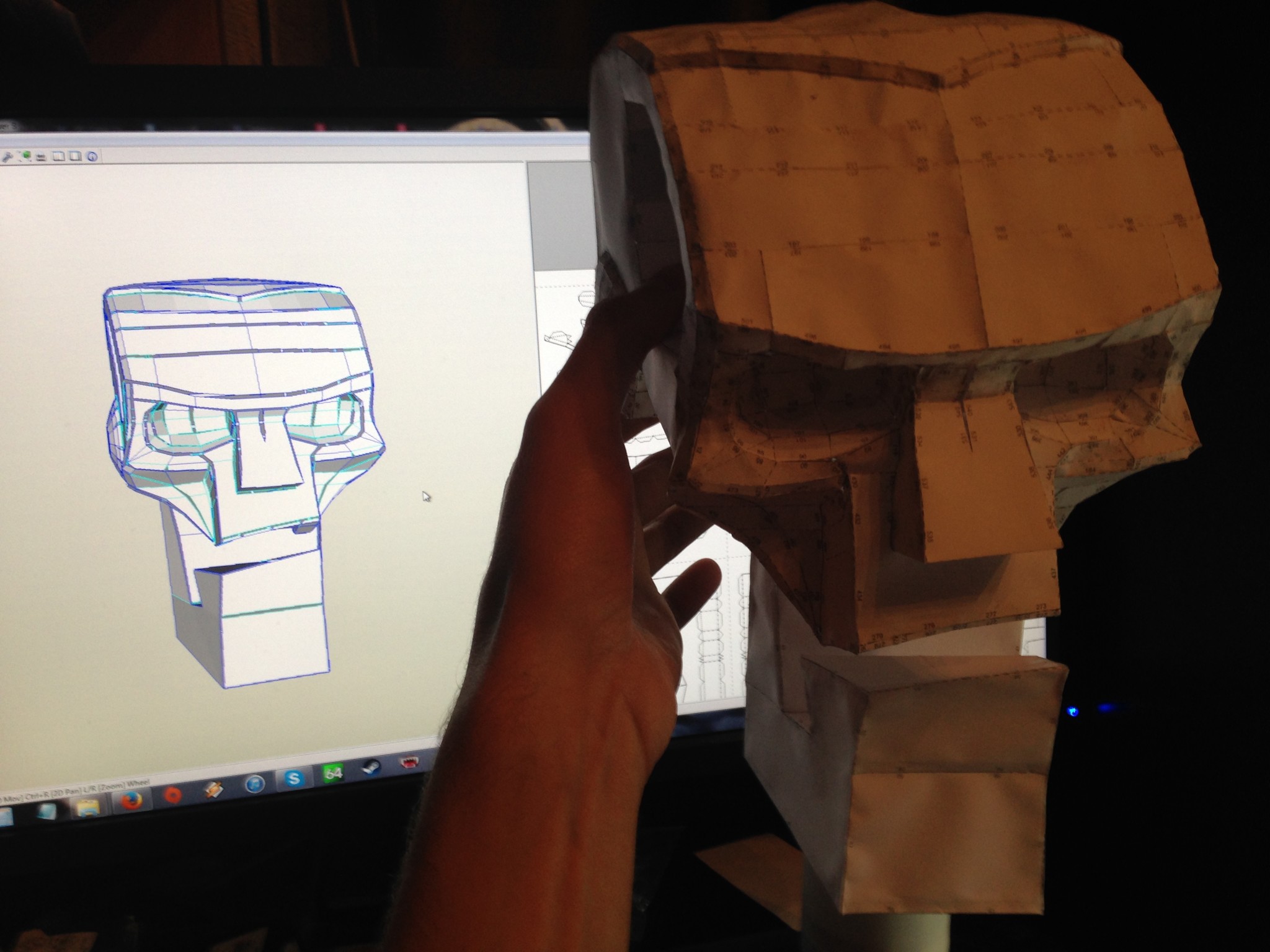

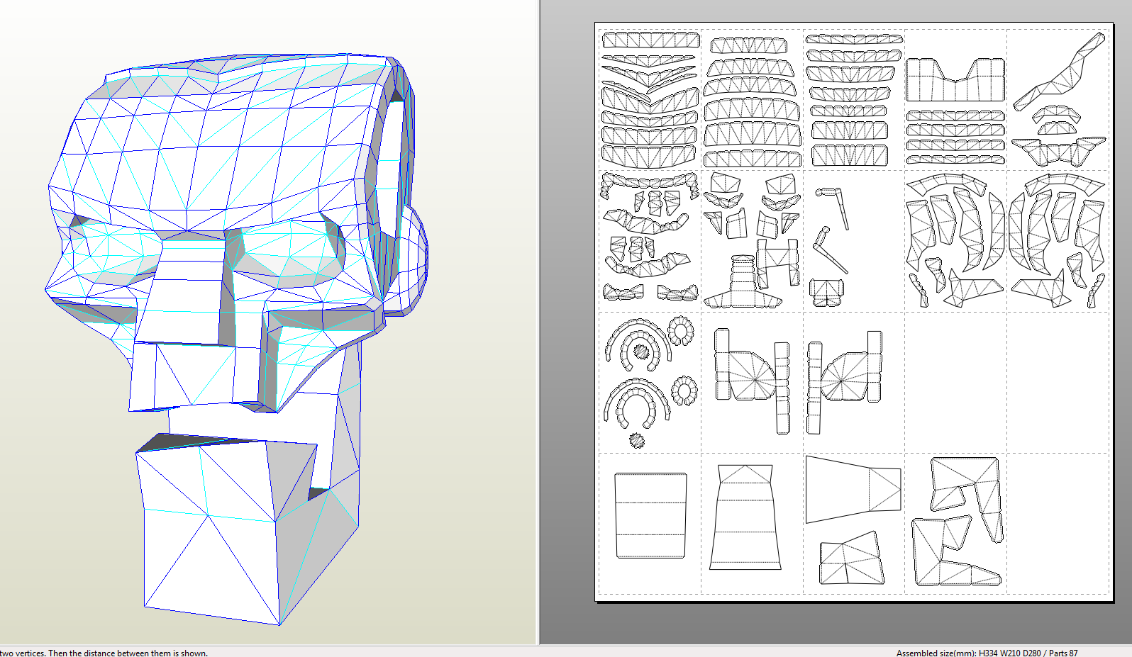

I've redone the pep file by changing most of the quads into tris. Also I deepened the eye sockets to help with inserting eyes, LEDs or whatever.
I wasn't happy with the quads that were causing distortions during the build. A couple of years ago when I modelled the file I didn't realise that triangles are best for pep work - triangles are always flat, while quads can often be curved - this results in stress in the build, tabs coming unglued, etc. Apologies to anyone this has caused problems for. I've also scaled it up by about 5%.
The files are unlocked as usual. Happy pepping.

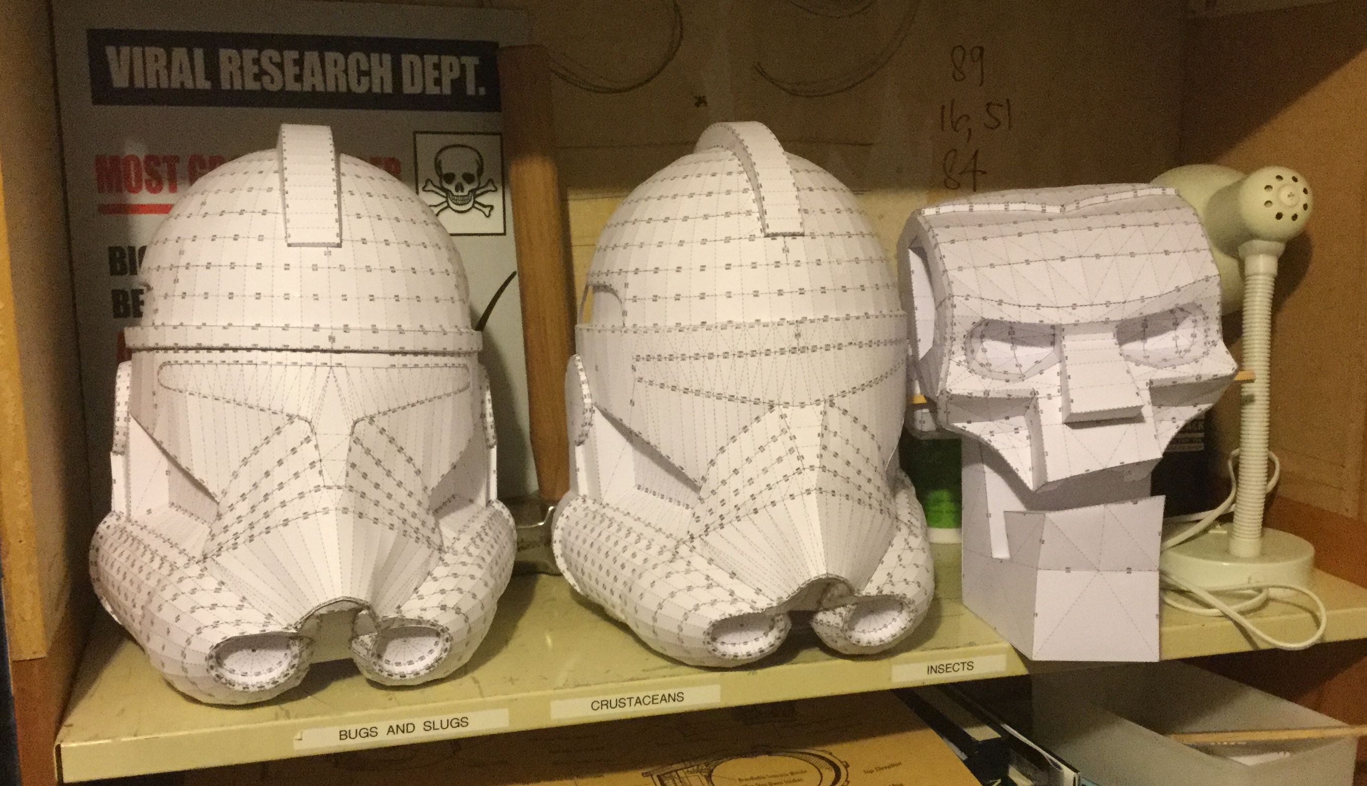

It's finished the pep stage - just in a queue of 10 finished peps waiting on fibreglassing, then it gets to join the ten or twelve partly completed ones in the shed...
I made it quite a bit larger than the real deal as you can see by the trooper peps beside it. It seems to be more aggressive and intimidating at the larger scale.
