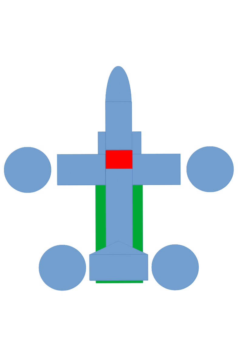

OK, here's one of the figure of the plan I have been using for this model build to see the proportion balances and arrangement of fixture.
It's usually in my PC and I haven't disclosed it till now but, well, let me convert to GIF images and put them up here.
Fig.1 is the original plan of the arrangement.
Fig.1
As you know, I added the tilting function for the cockpit recently.
So I extended the front main fuselage about a little more than 2 inches. The red part of the fig.2 is the extended part.
Look, the nose section is looking obviously too long as compare to the total proportion.
Fig. 2

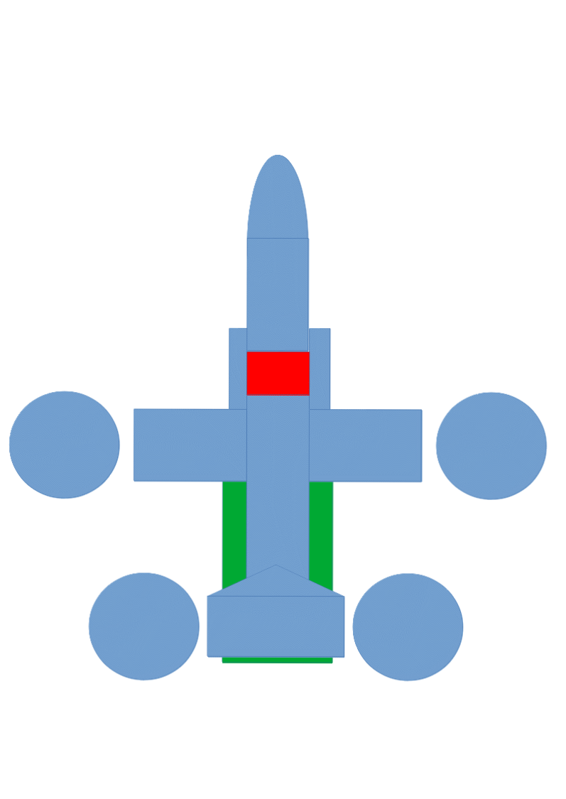

Fig.3 is the adjusted arrangement. Move the wing toward the nose about 2 inches. I think it's fair enough. As I wanted to make this model taste like a bit aardvark or anteater, I think this portion is fit for that. However, I'm not gonna fix this soon. The green part of each figure show the possible volume of attached attack vehicle. I want to see the total proportion when I actually build and fit the vehicle beneath the fuselage. Then I will be able to find the final arrangement.... I hope.
Fig.3
I'm not a trained professional industrial designer at all. Every time I build the model, I do the things like this. I mean, drawing some sketches, knead the clay or something. There is no final plan or assemble instruction in a fancy box. Crawling inch by inch in the darkness. Looks awkward and maybe just a time consumption. It's very masochistic....I like that. That's why I can continue to live with one single woman for more than 30 years.

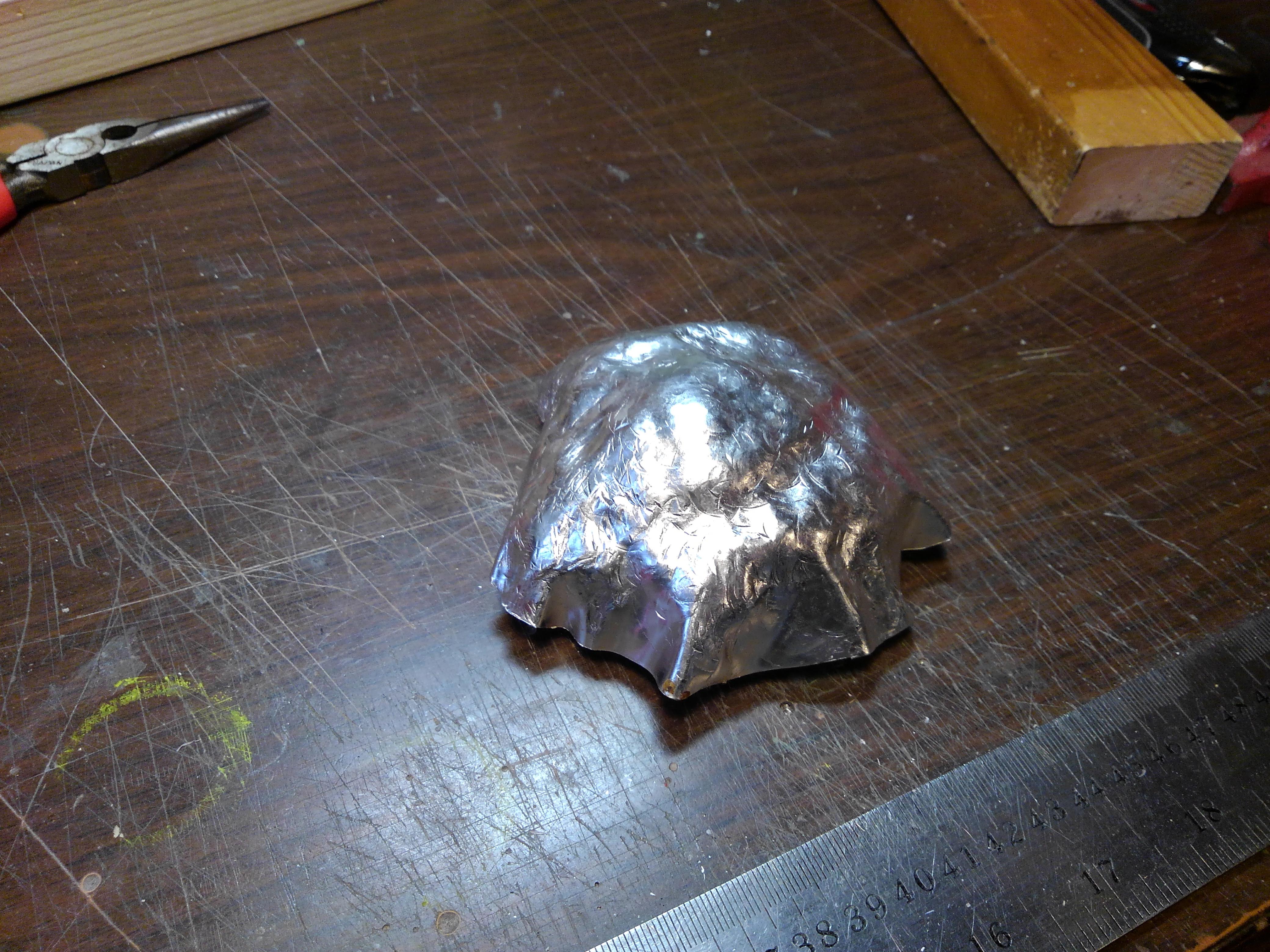

Making a nose radar dome.
There was a several idea for the nose end design.
1. complicated one. Like it of a AH 64 Apache or Huey cobra.
Or something like a nose cowling of recent motorcycles.
2. Usual pointed nose.
3. Round nose.
I drew several sketches for the complicated nose but didn't look any good to me. The pointed nose was not bad but it's not that wild look and raises an another issue. Nose section will be stretched again.
So that, I chose round nose. Very short big radar dome. Like the one of A-7 Corsair or A-6 Intruder. I love both aircraft so much.
If I had to make a pointed corn, I did vacuum forming though. But I thought I can make it with hammering again.
Using a 0.8 mm thick aluminum sheet.
Last time I did this was almost 2 and half years ago and was a smaller one.
I already forgot to cut the sheet in a circle at the first place. :lol:
Ahh..:oops:
Cut off the excess and hammering again.
Then, sanding.
I put it on a turntable (Actually it's a diamond disk sharpener) and stick it with a hot glue.
Looks OK to me.
Test fitting.
Fixed it on a collar.
The cross section of the tip of the nose was slightly elliptical, so some adjustments were needed.
Looks like rather a nose of Japanese older Shin-kan-sen bullet train than A-7.
How do you like it? I think I like it. It looks wild and violent.
Thanks for looking!
katsu
