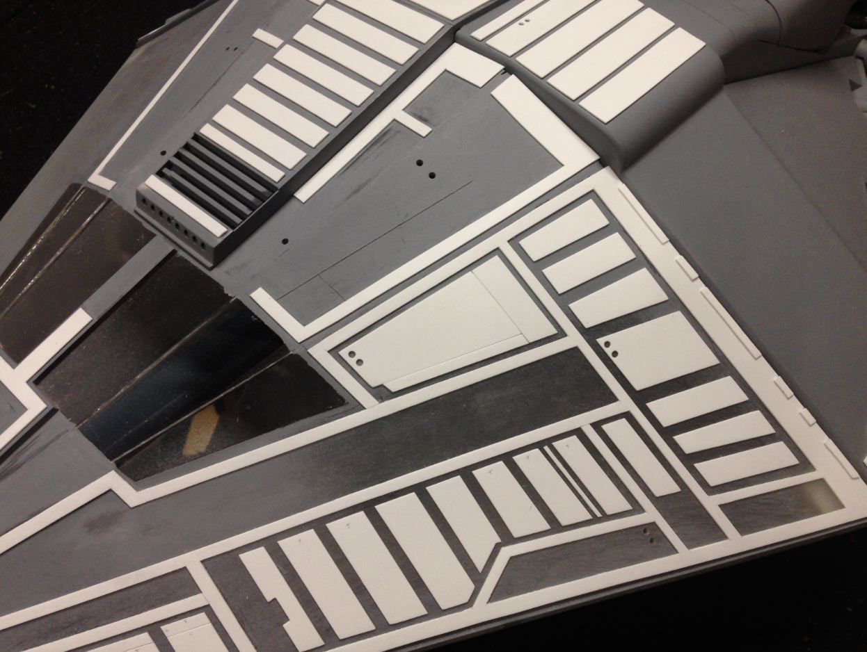

Had a productive weekend.

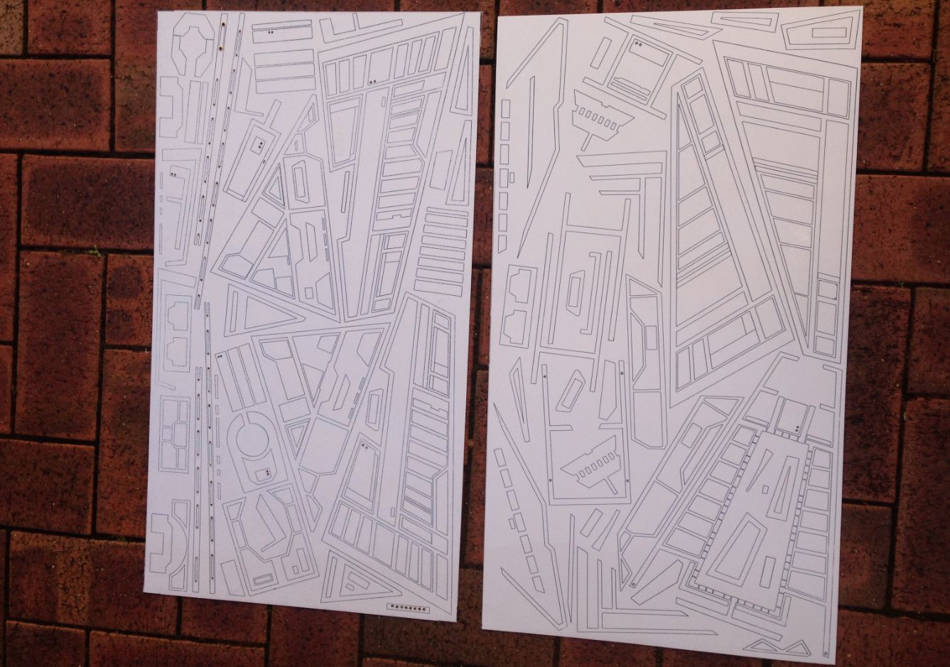

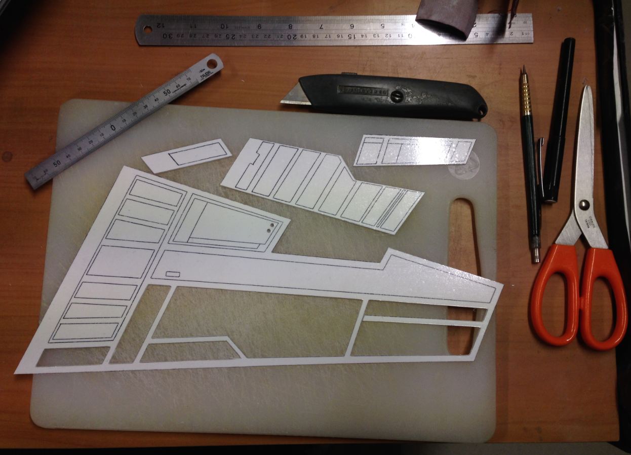

I managed to get both sheets of the styrene templates (which covers the entire ship) transferred over to plastic.
I then spent the rest of the weekend cutting them out and sticking them on!
I have to say, I'm quite enjoying the process.
It's time consuming - due to the sheer amount of parts, but with a refreshing beverage and some good tunes, it's quite therapeutic! lol

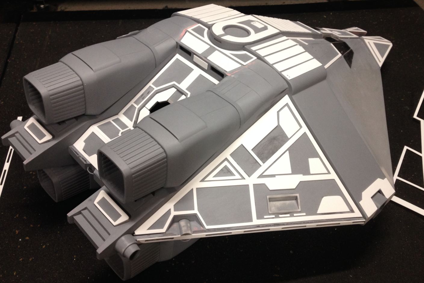

I've made a good dent in the plating for the top front half and hopefully I can find some more time during the week to continue a little further...
The plating is coming along just fine; this is going to be a hell of a model when finished:cool

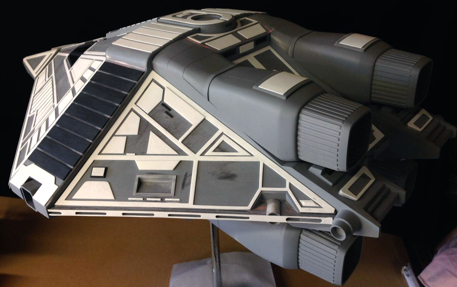

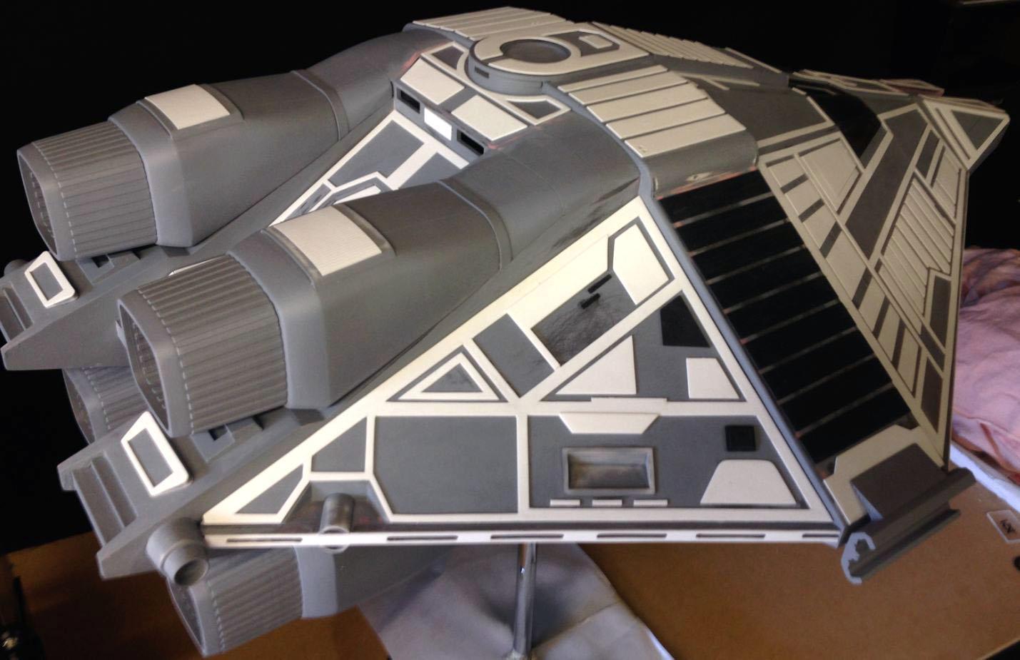

Continuing to add plating to the top of the ship.
Currently working on the rear quarter panels and the airlock area.
It's a time consuming process to make sure that everything is located correctly (to match the original).
The full sized paper templates I had printed are a big help in this regard.
It's reassuring to see everything is fitting as it should.

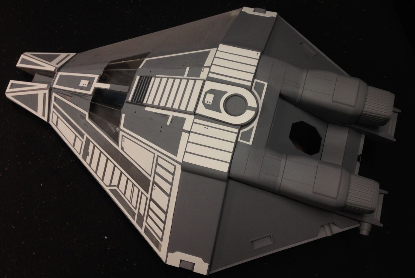

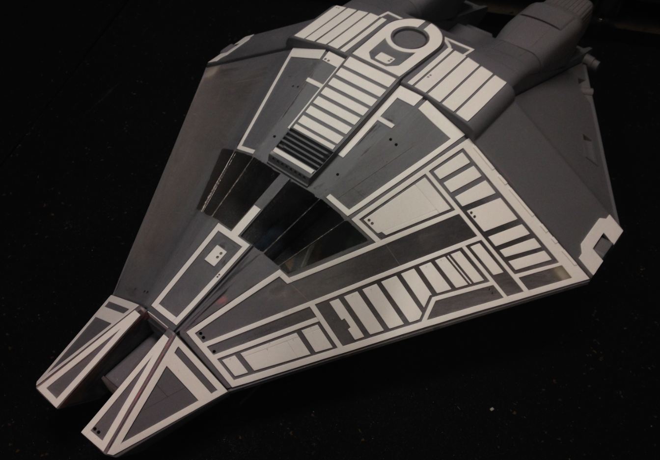

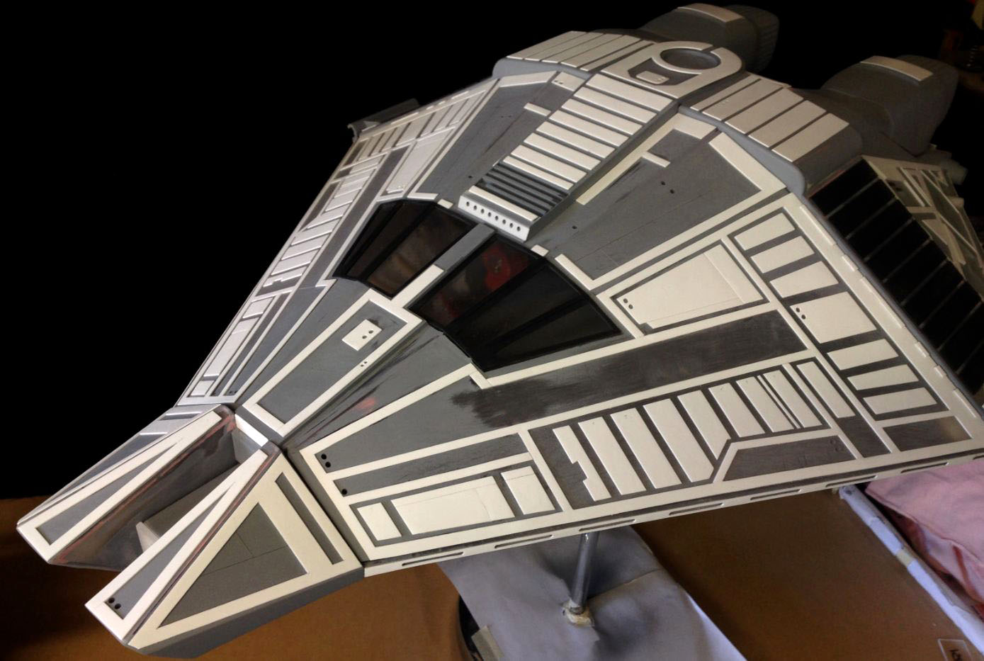

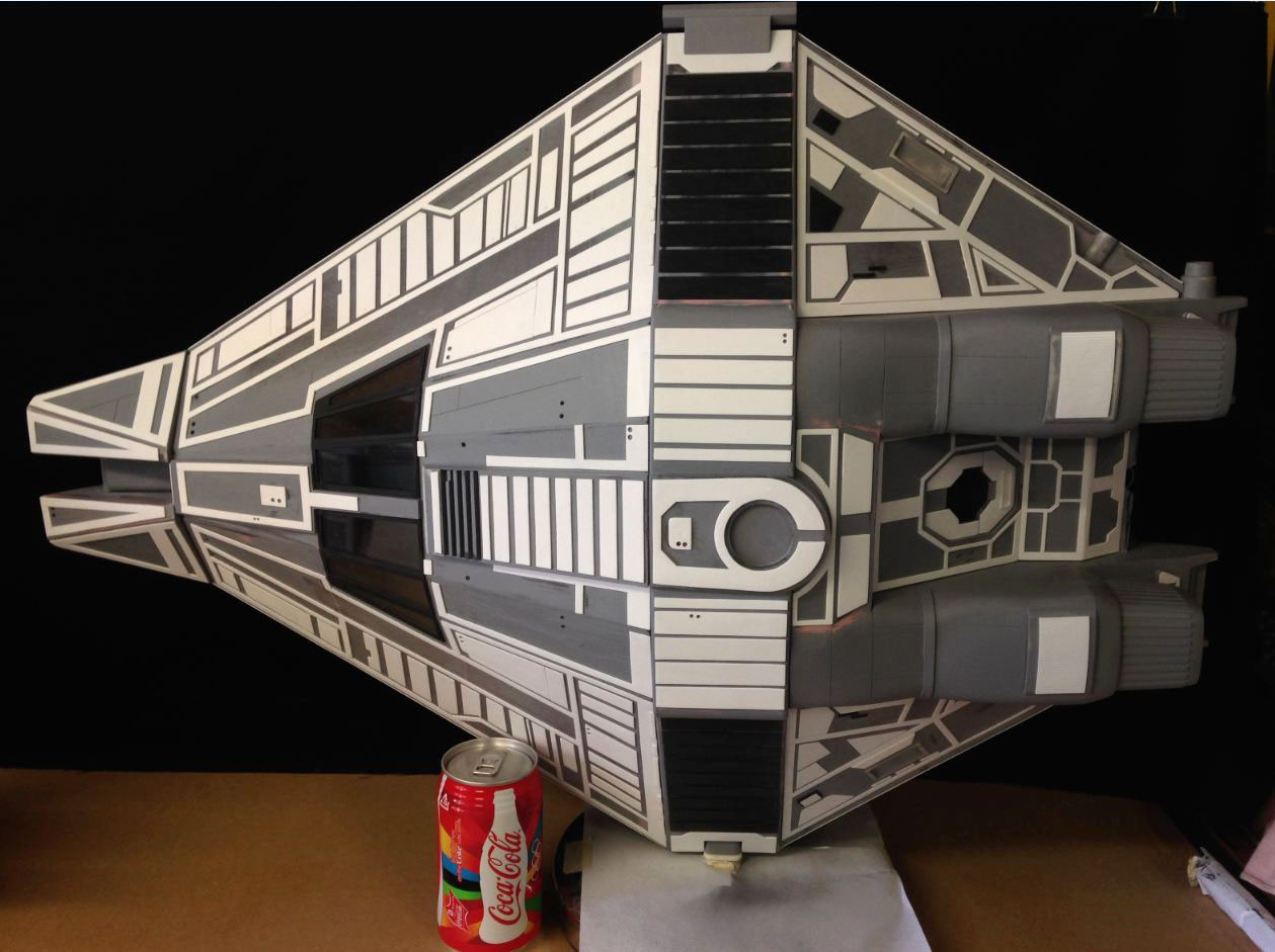

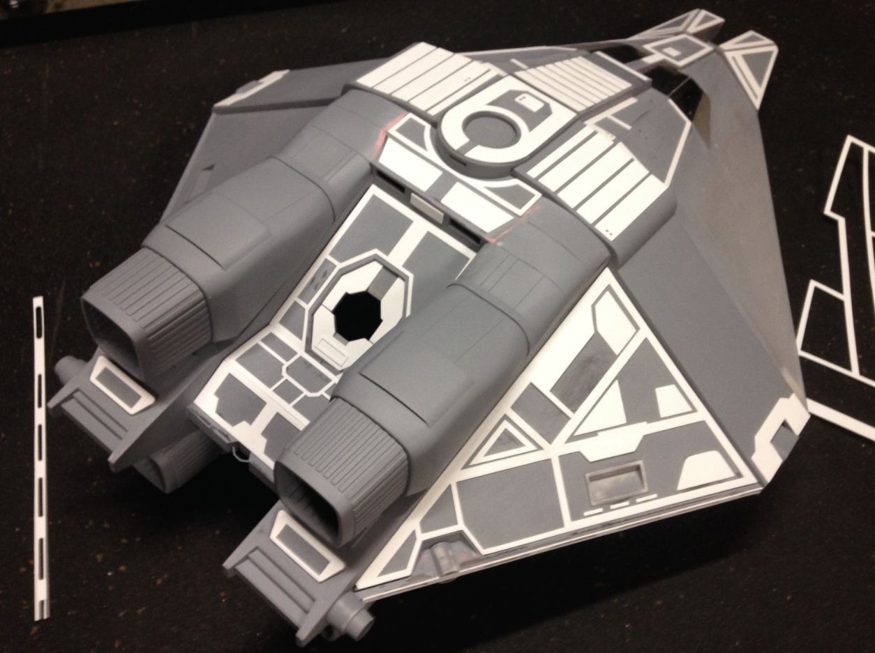

The plating for the top of the ship is now complete.
Not much to write about as it was just a case of cutting, sanding and gluing into place (repeated over and over!)
I'm happy to report that it all fitted, matching my templates and the CAD/photomatched model.
I have glued the clamps to the armature plugs and attached the "Evergreen" sheeting to the top of the engines - as per the original.
I've included the obligatory Coke can for scale in the last shot and a pic of the original model for comparison.
I'll move onto the plating the underside next...
