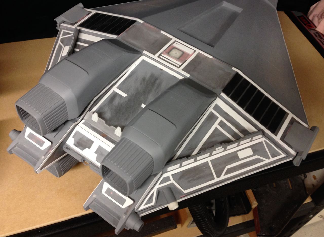

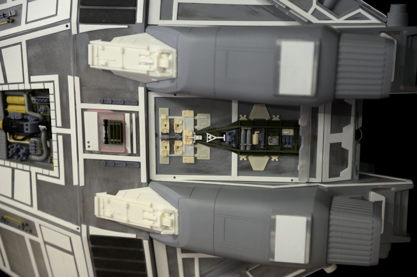

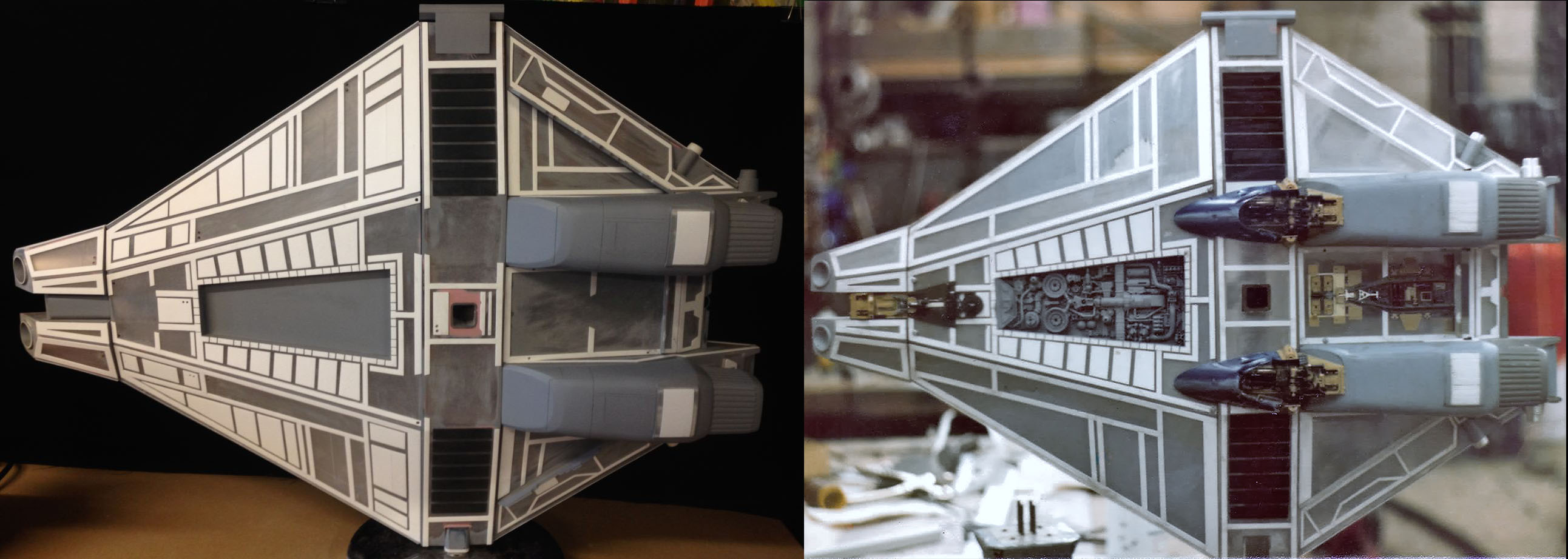

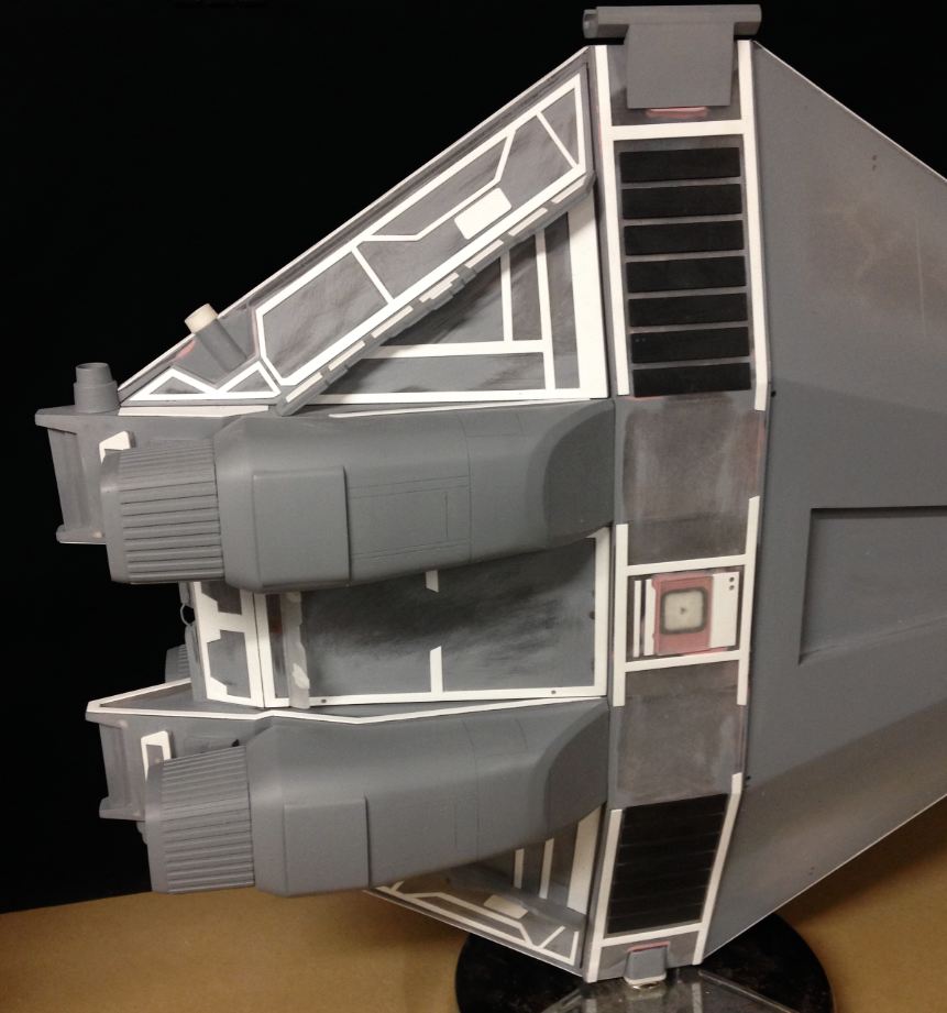

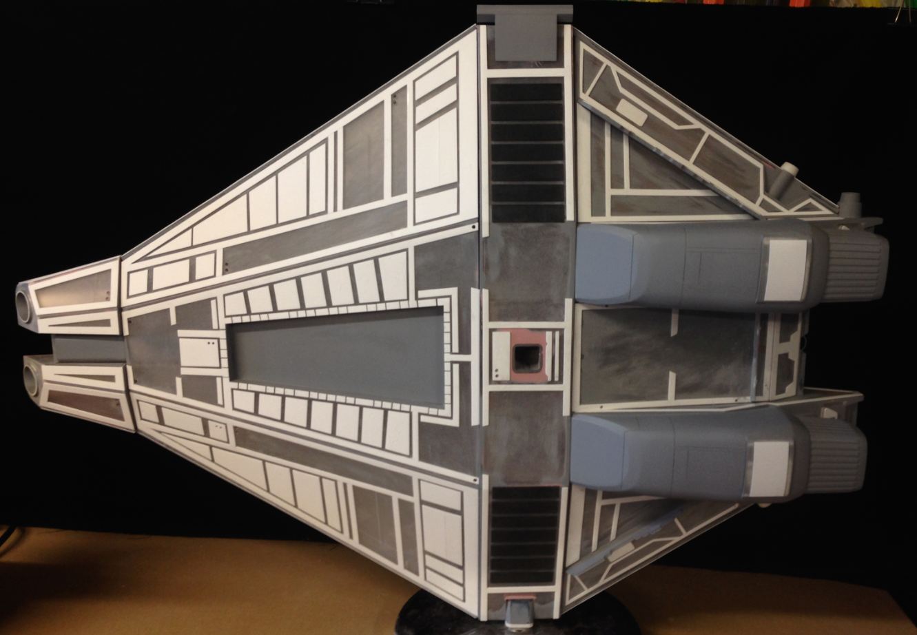

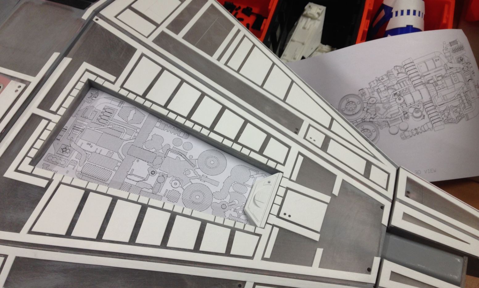

Work continues on the underside plating this week.
I've started at the rear and have made good progress so far.

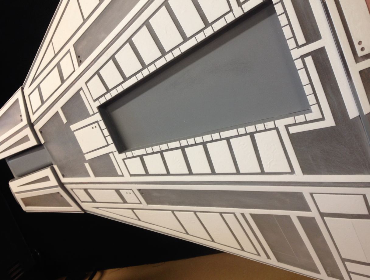

The central armature cover plate is now in place, but is hard to see as it isn't painted and still looks clear (the pink is glazing putty underneath).
The panel between the engines is removable and fixed in place with magnets (the original was screw fixed - note the four holes in that panel).
This will allow access to the airlock interior (which is also removable) so that it can be detailed at a later stage.
I'm hoping to get the rest of the plating finished off over the weekend.

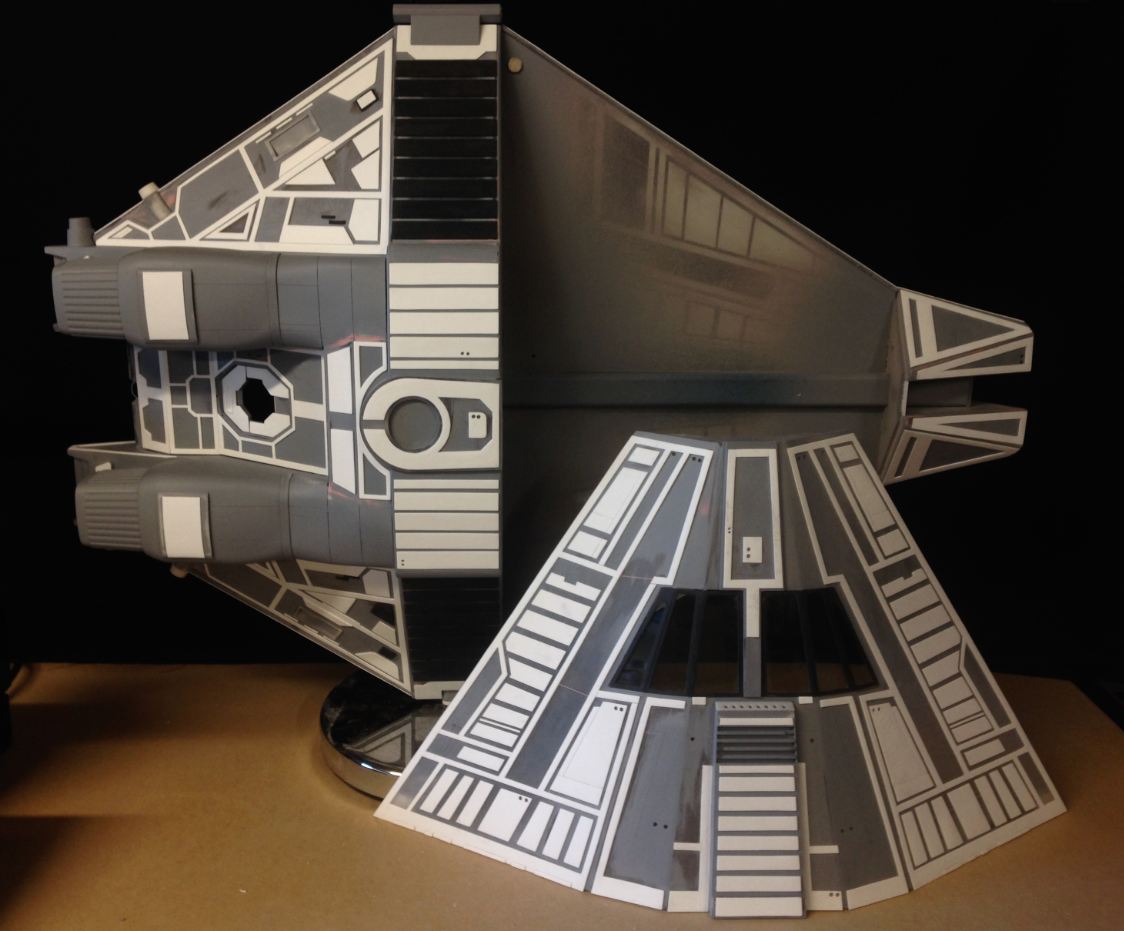

And the styrene plating is done (thank God!).
There are a LOT of pieces that need to be glued on to this ship (be warned anyone that decides to tackle it!)
I am glad that this stage is now finished.

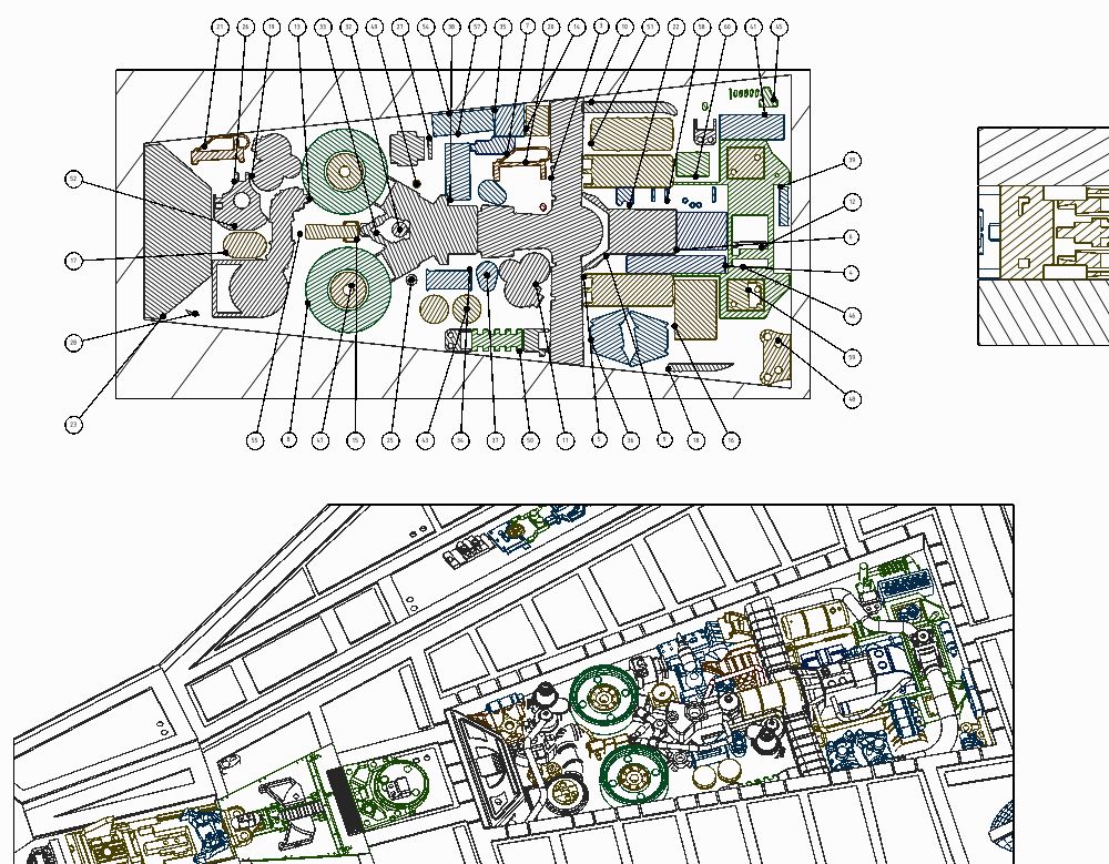

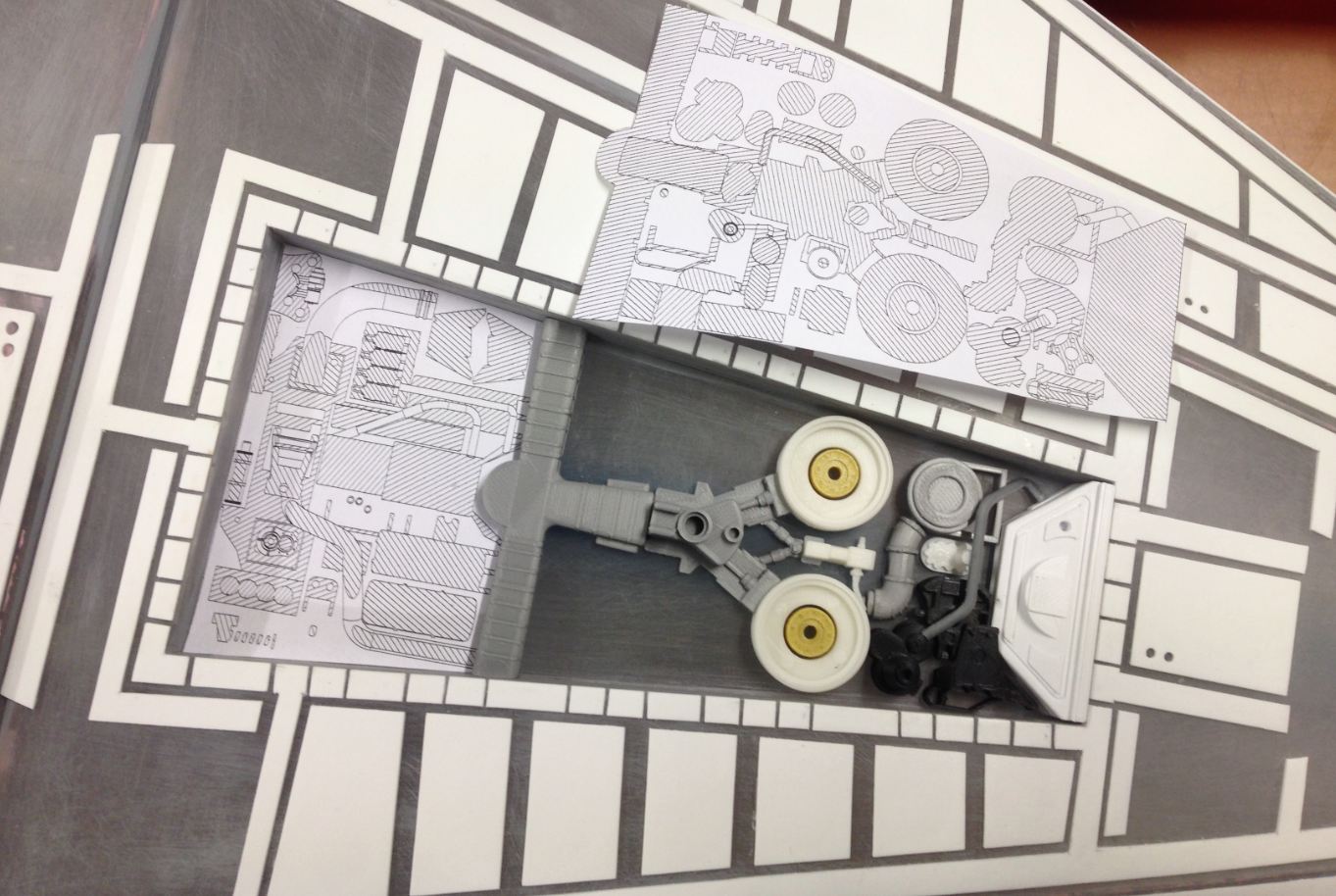

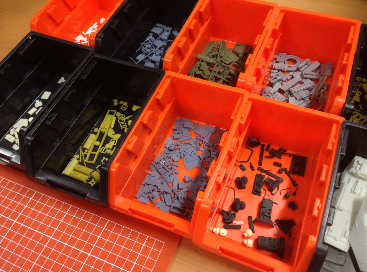

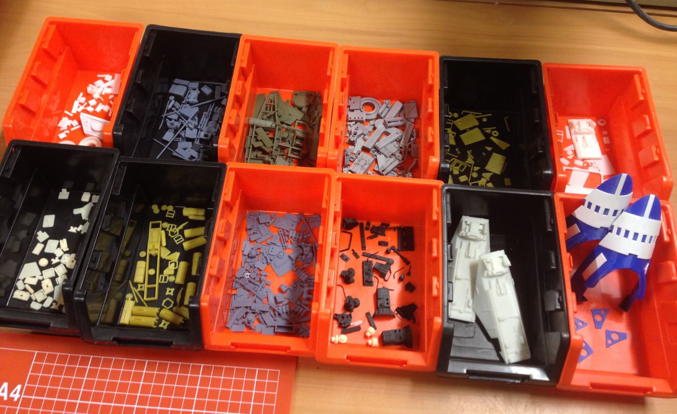

I now need to spend a bit of time mapping out the kit parts so that I can produce template layouts, similar to what I have done for the styrene. Once again, there are a lot of parts! Should be fun though

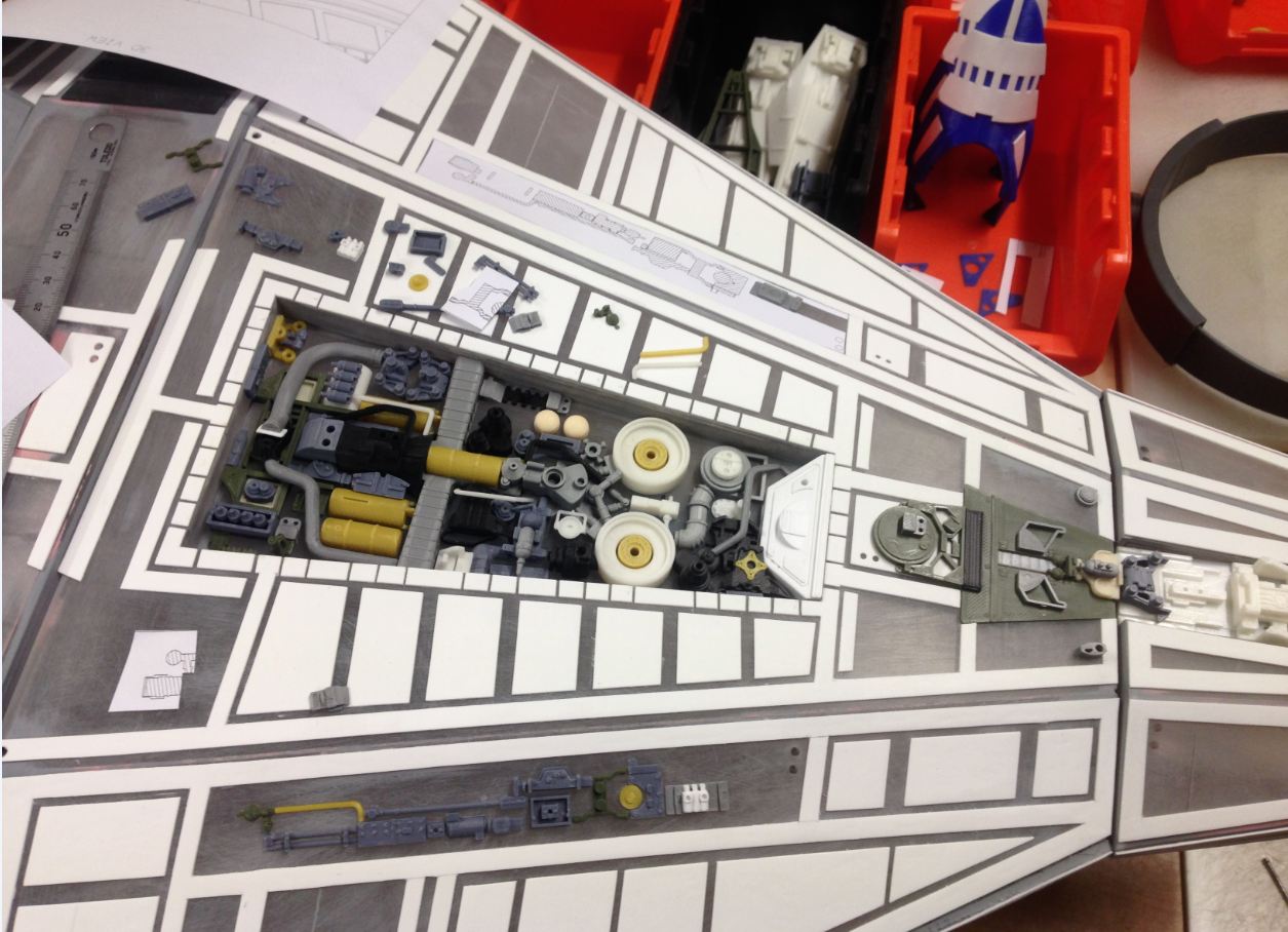

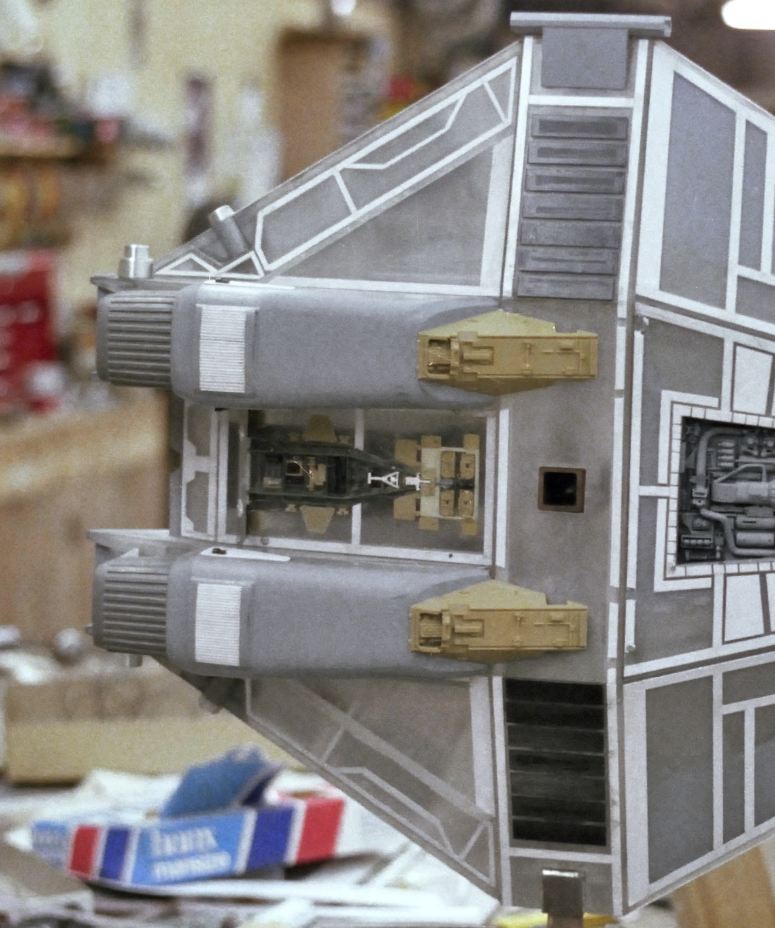

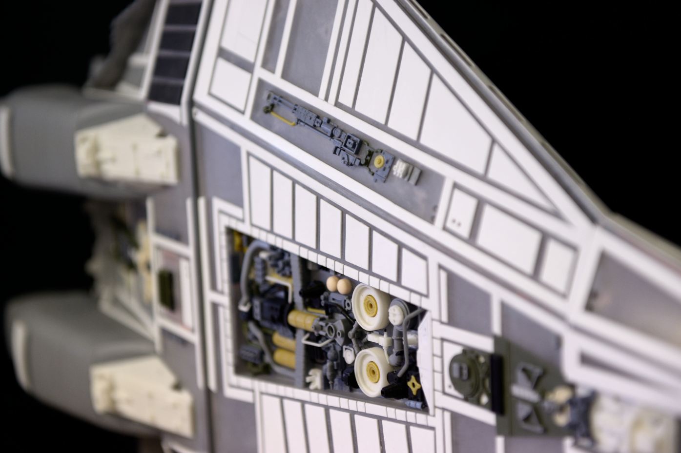

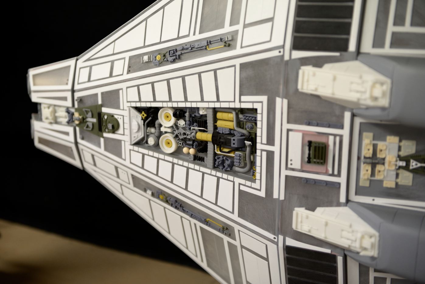

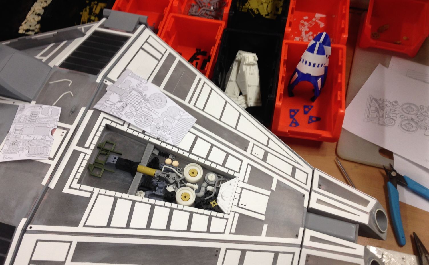

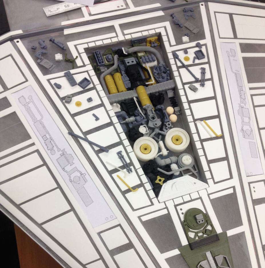

I started with the most detailed section of the shp - the underside engine area.
Everything is fitting together nicely (the 1:1 templates are are big help for this).
Just taking my time getting everything in the right spot - and having fun too!

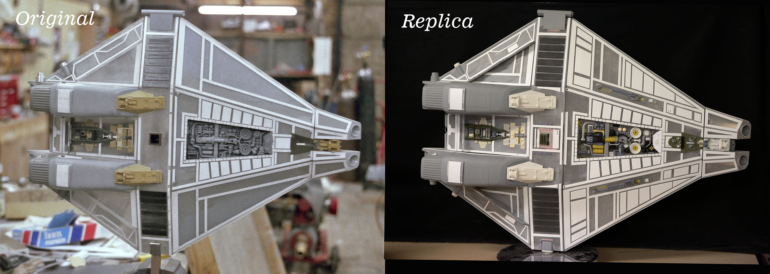

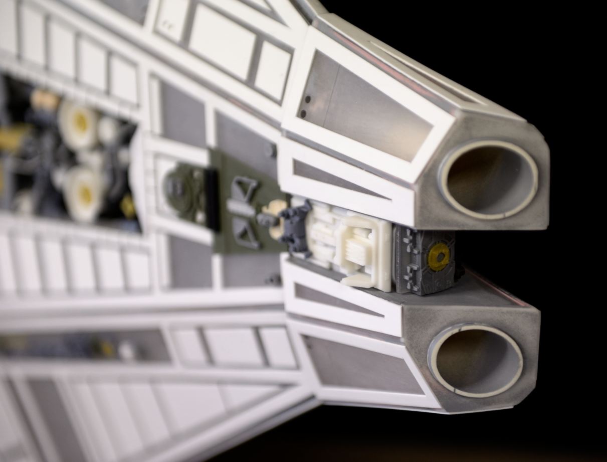

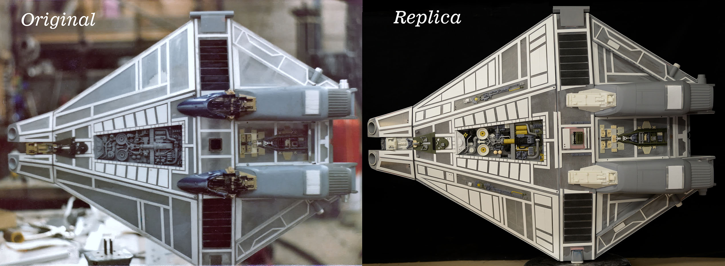

Here it is completed, along with the detail strips on either side of it.
Between the "nose", the armature cover plate and the rear between the engines is also finished!
Very happy with the progress so far.
