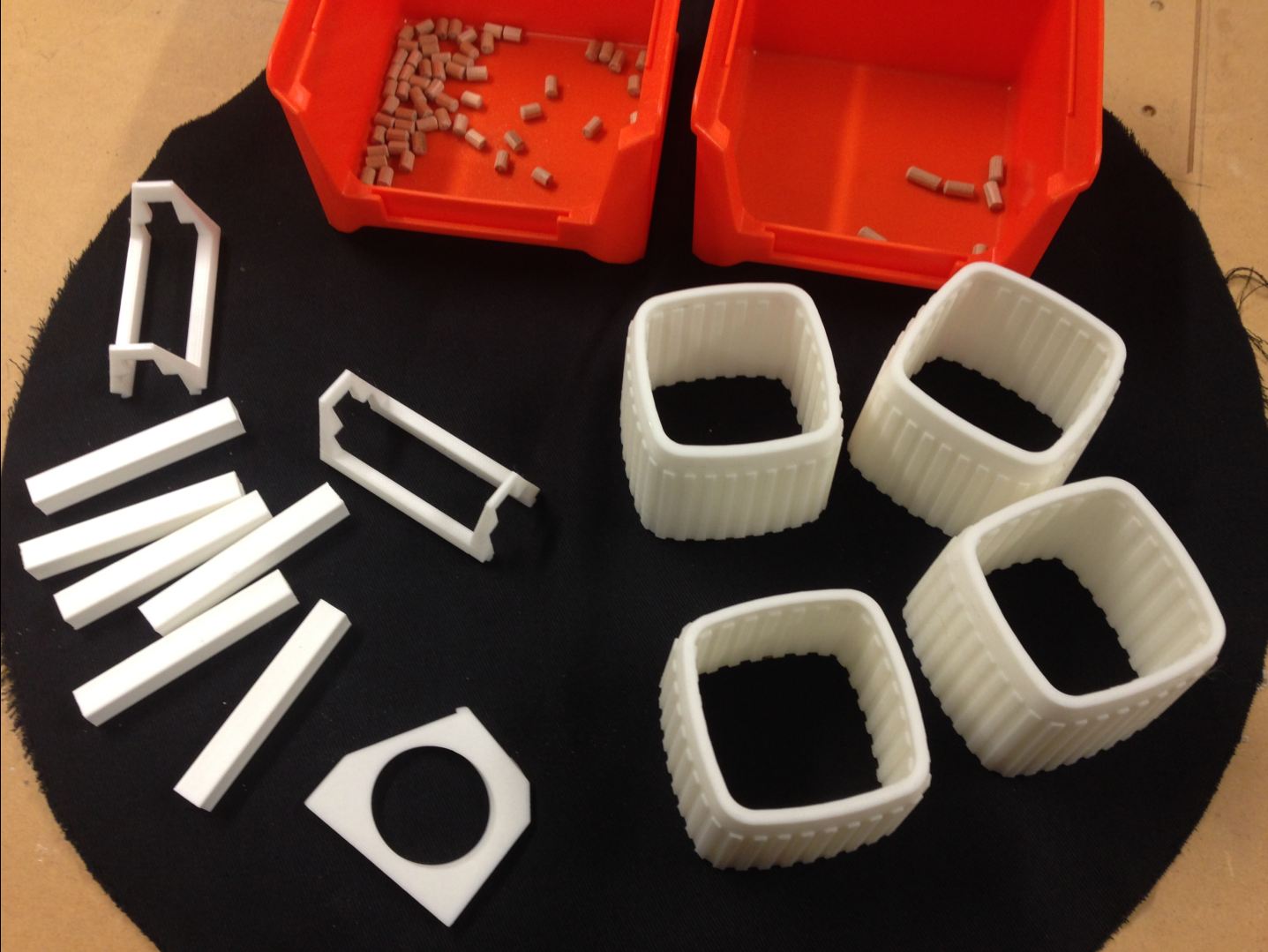

I've started to organise the bits and pieces I need to actually start the build *finally*!
I have ordered the steel for the armature frame. It will be 25x25x2.5mm square section - as per the original model.
I have made up the 60 odd guide dowels I need and have started compiling the 3D printed parts.
There are a few pieces of off the shelf styrene tube, pipe and sheeting used on the original - I now have those in hand too.
I have all the model kits used on the ship apart from two, but there is only a single piece in each of those kits - so just two pieces I dont have yet...
I am currently working on producing the patterns for the acrylic and styrene sheets so that I can have those cut.

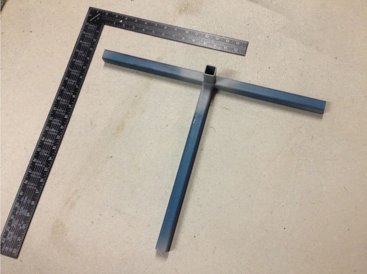

The armature is done and in hand:

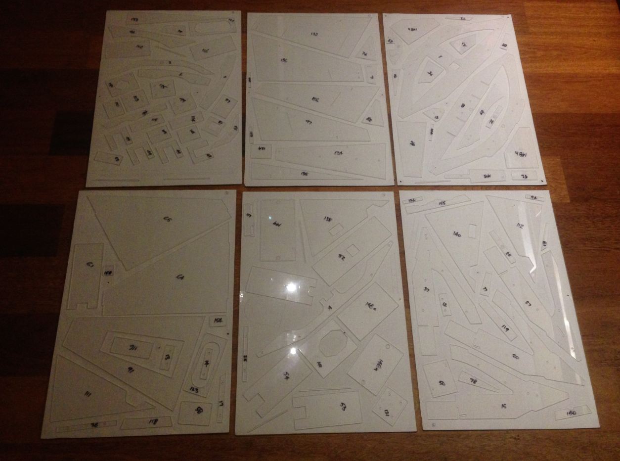

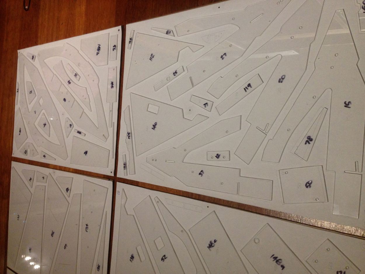

The 3mm acrylic has now been cut and is my hands.
After looking at this ship in the digital domain for years (literally), it is so cool to see it in the physical world.
I'm really looking forward to being able to start the build.

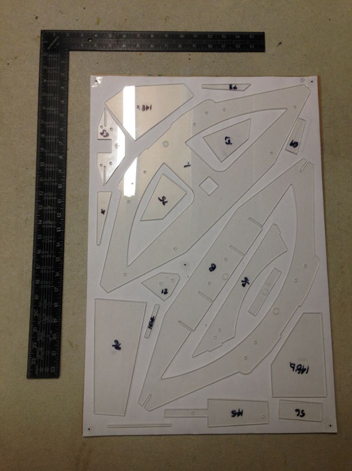

The acrylic parts look fantastic. They are super sharp and very accurate.
I had all the parts printed 1:1 on paper and have checked each piece of acrylic over the top of the print out.
Included in the files that were cut are all of the tiny holes that were drilled over the ship (and there were many), and all the engraved panel lines too.
This means that they will all be located exactly as per the original (the benefits of having a photo matched CAD model!)
The parts made from the other thicknesses of acrylic will be cut later this week.

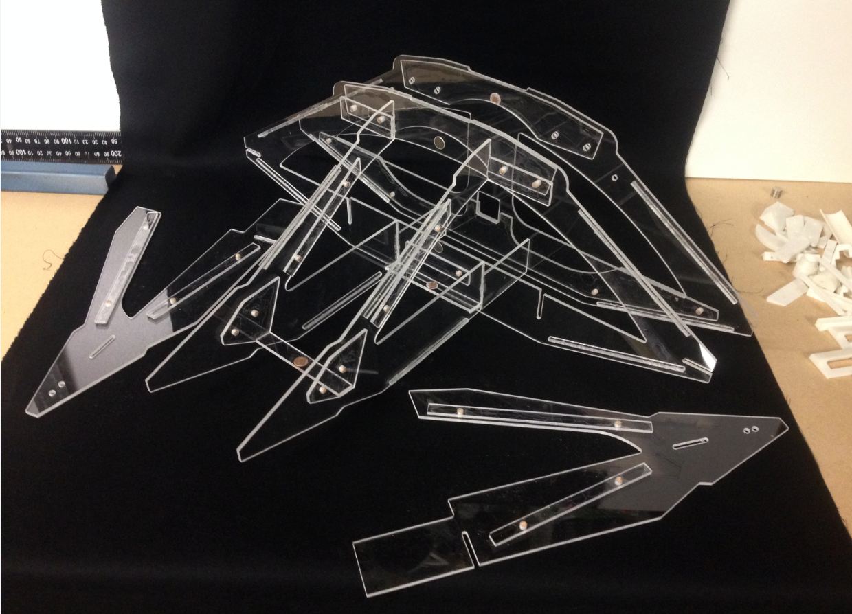

All the acrylic parts are now in my hands and the build has begun!
Is it wrong that I'm having this much fun building it? lol.
Everything is just falling together so far.
Hopefully it continues...

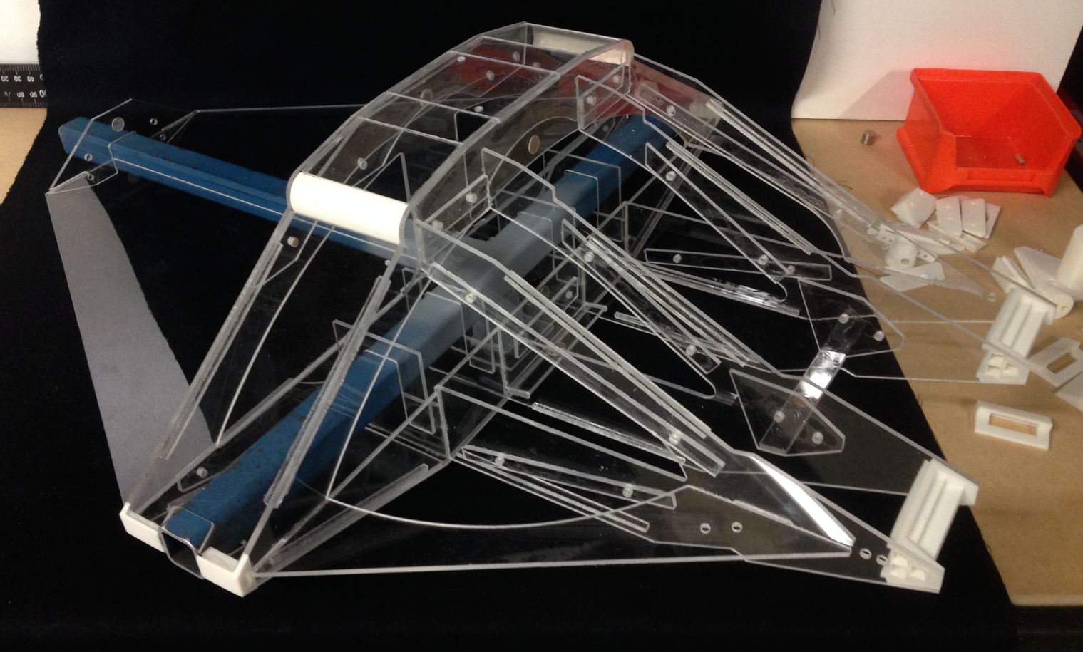

Going to call it a night, but this is my progress after a couple of hours:

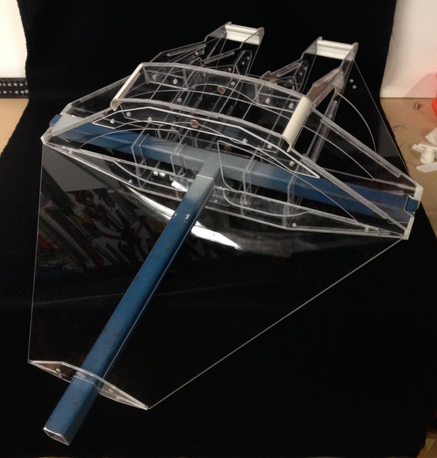

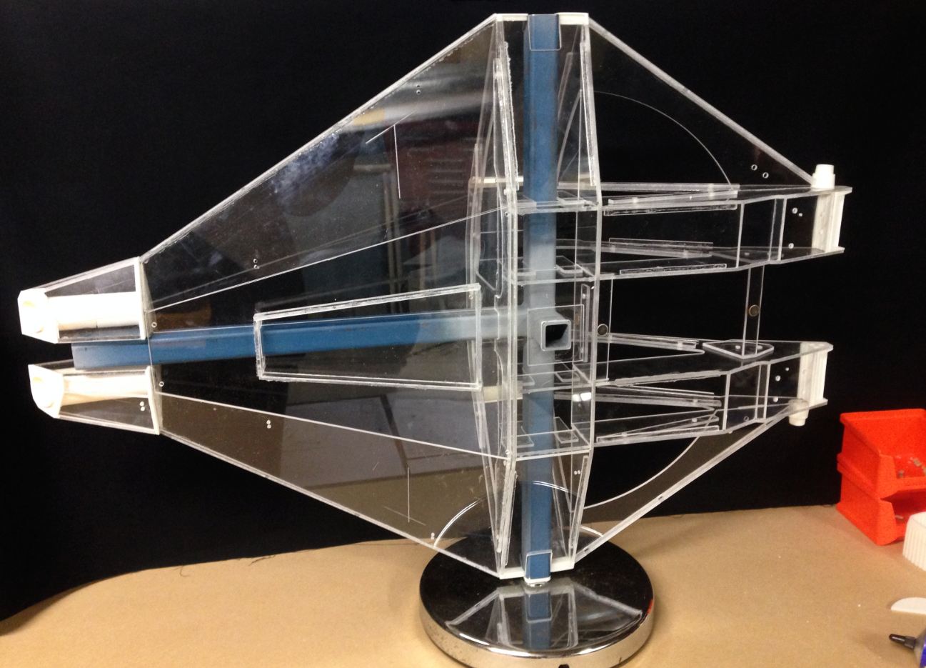

I spent another 1/2 day on the ship today.
The armature is now built in, and the ship is very sturdy.
I will look at organising a way to mount the model via the armature to make working on it easier going forward.
The 3d printed parts have worked well in combination with the acrylic and everything is fitting together as it should...

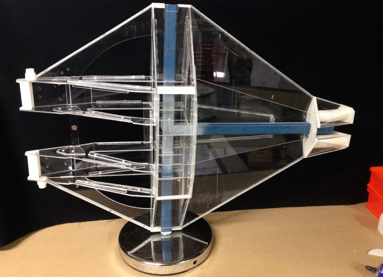

I manged to find something to hold the ship while I work on it - an old lamp stand.
It's weighted at the base and has a ~15mm dia metal upright.
I printed a small plug that goes into the armature with a hole to fit over the upright to make it more snug.
Seems to works well.
You have to use what you have available!

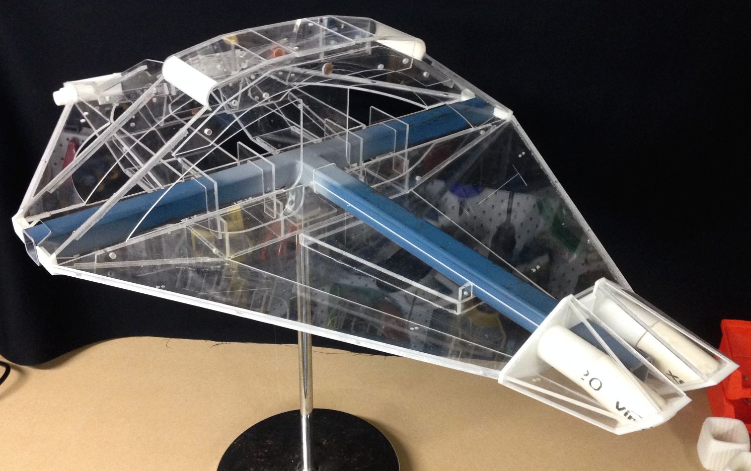

The ship is progressing well.

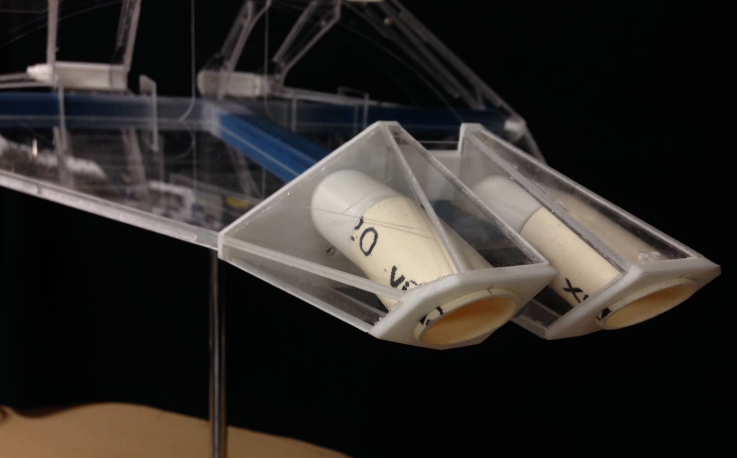

I have fitted the nose section and the 3d printed parts worked well there.
There is a hole in the base of each "nostril" in case I decide to add lighting later.
I've added the panels to the underside at the front (where all the "important" stuff is).
