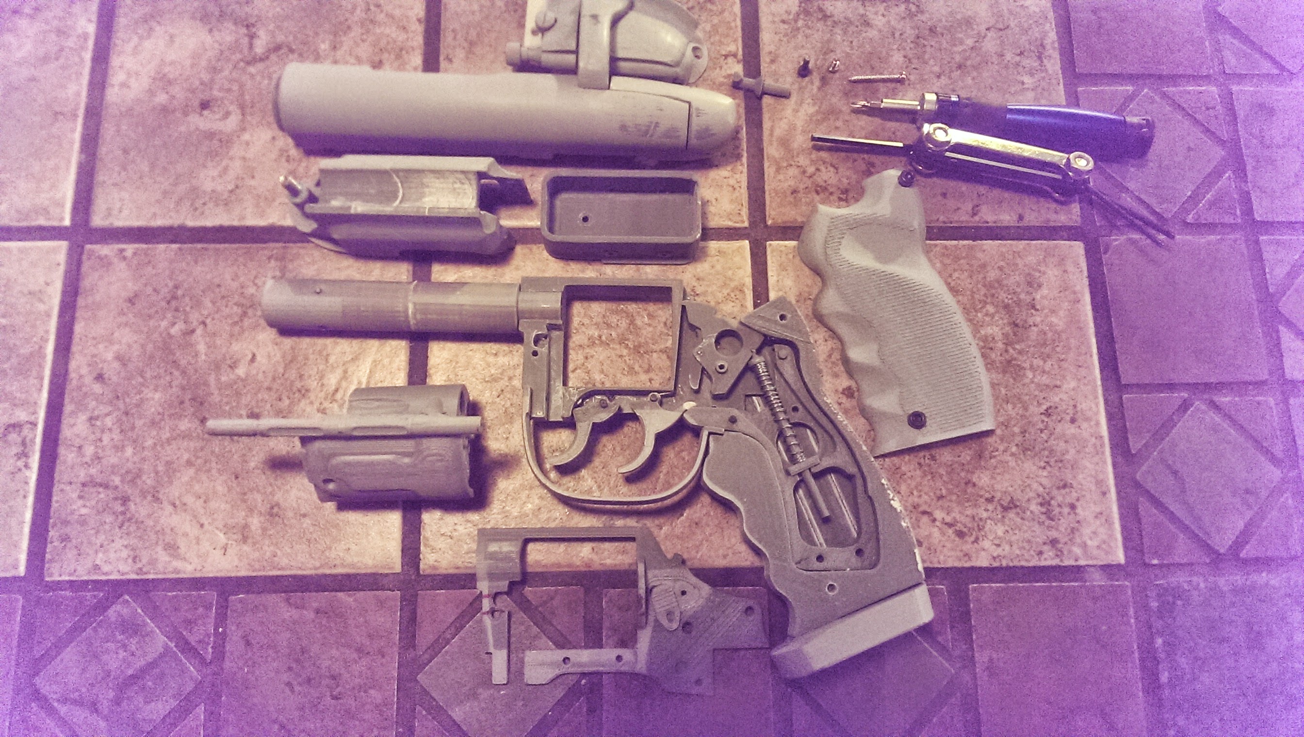

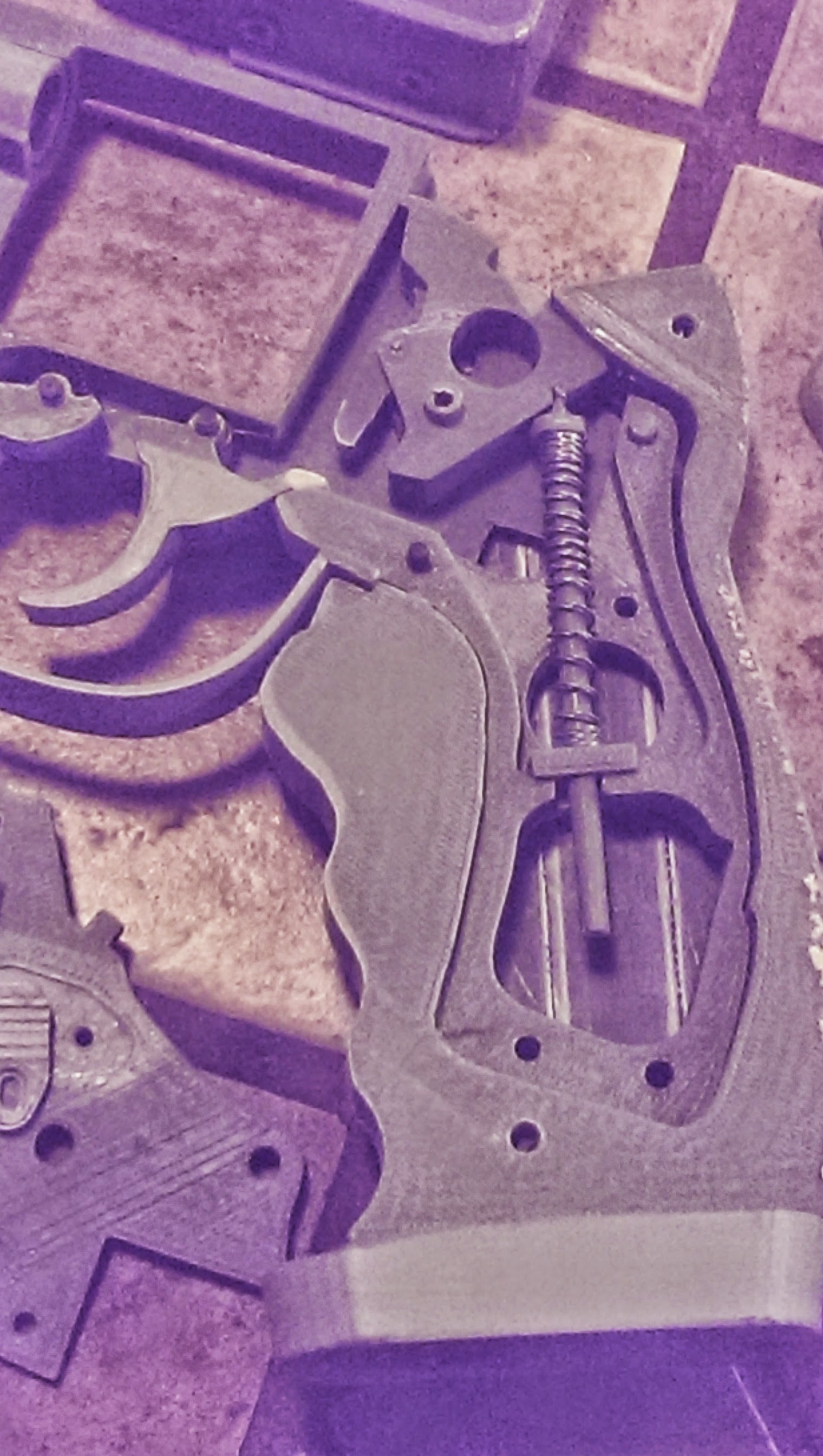

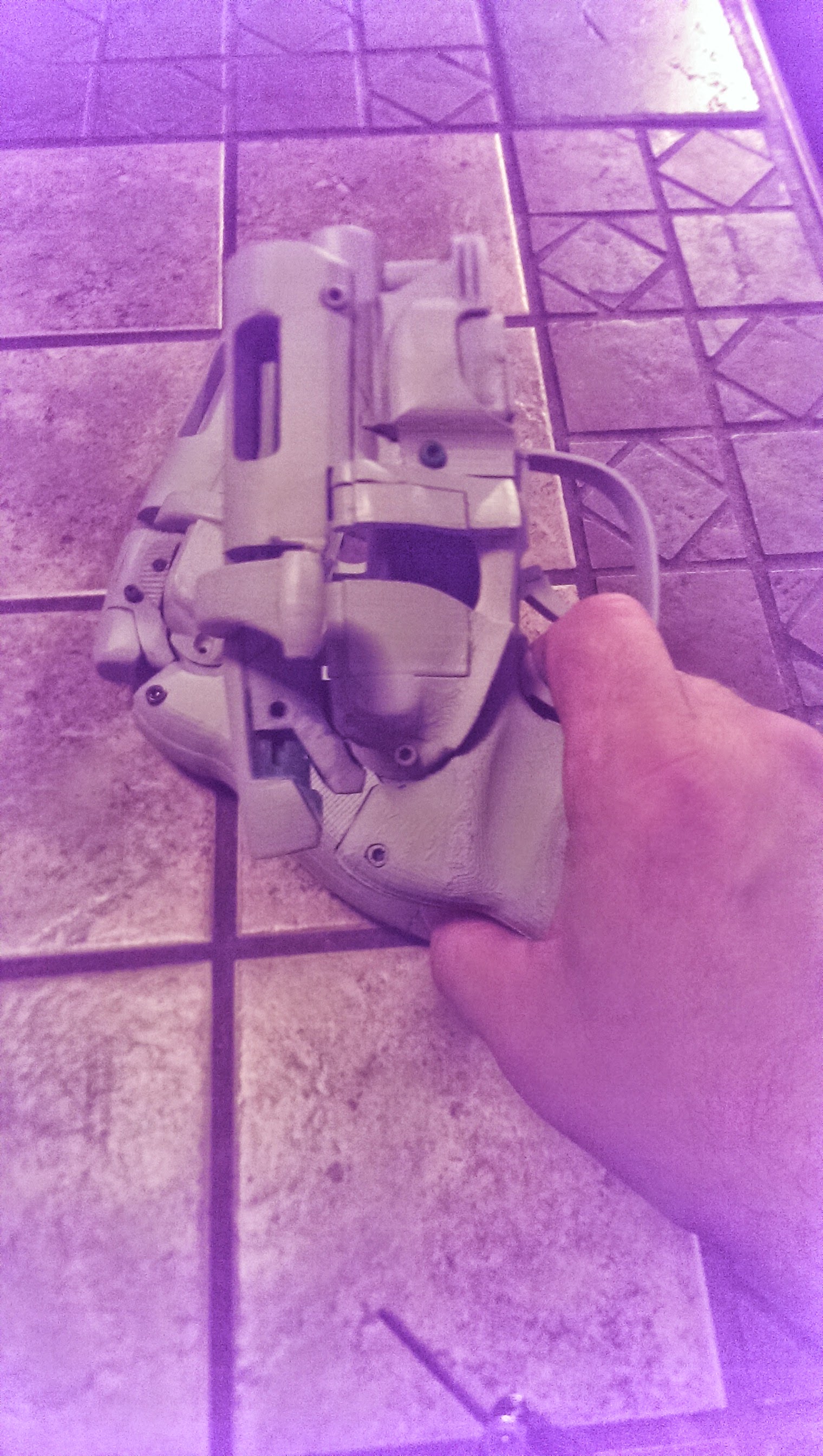

Sorry for the delay. As requested the internal workings of the hammer. Please excuse the image quality. My HTC One M7 is in dire need of replacement.

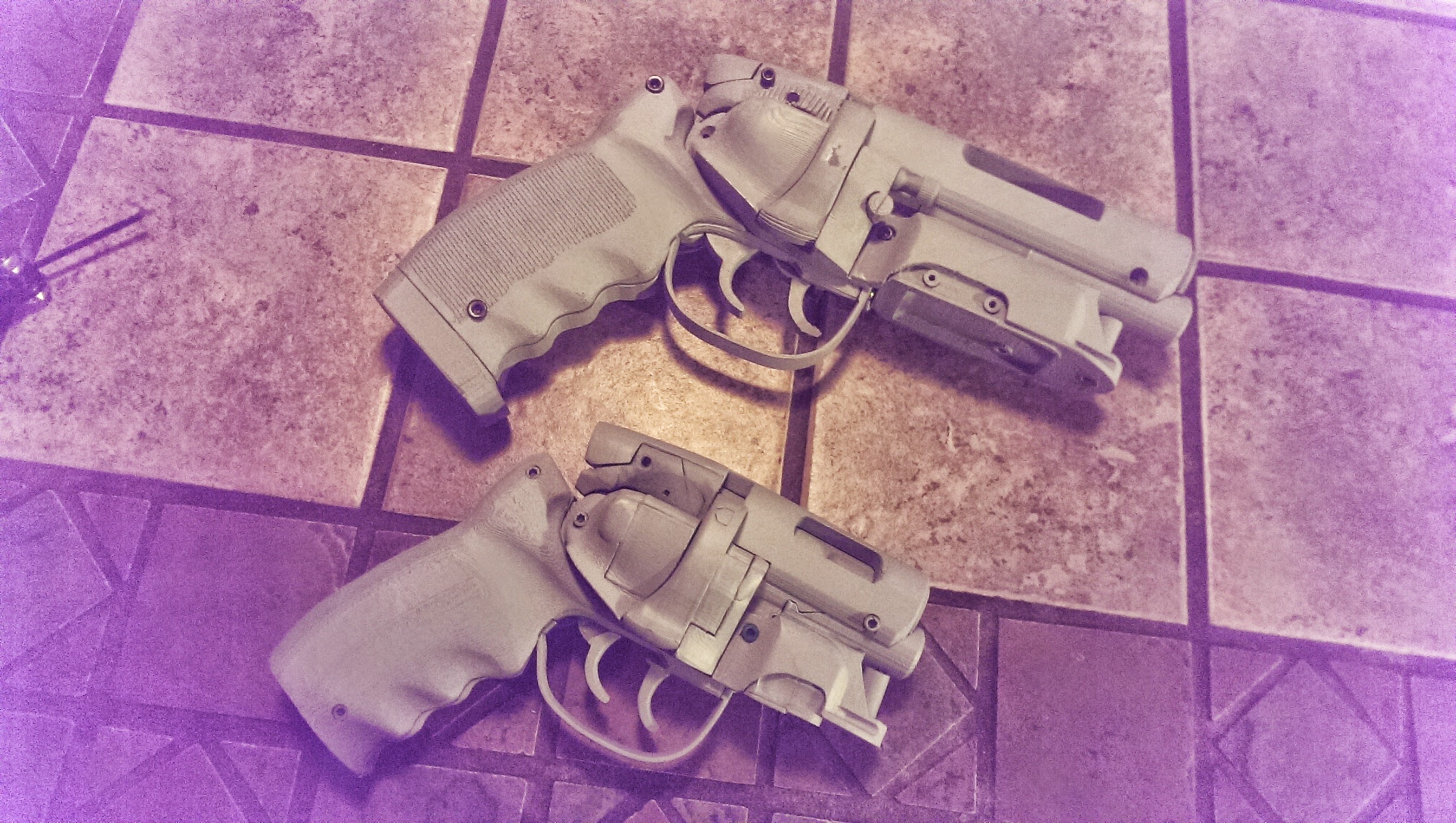

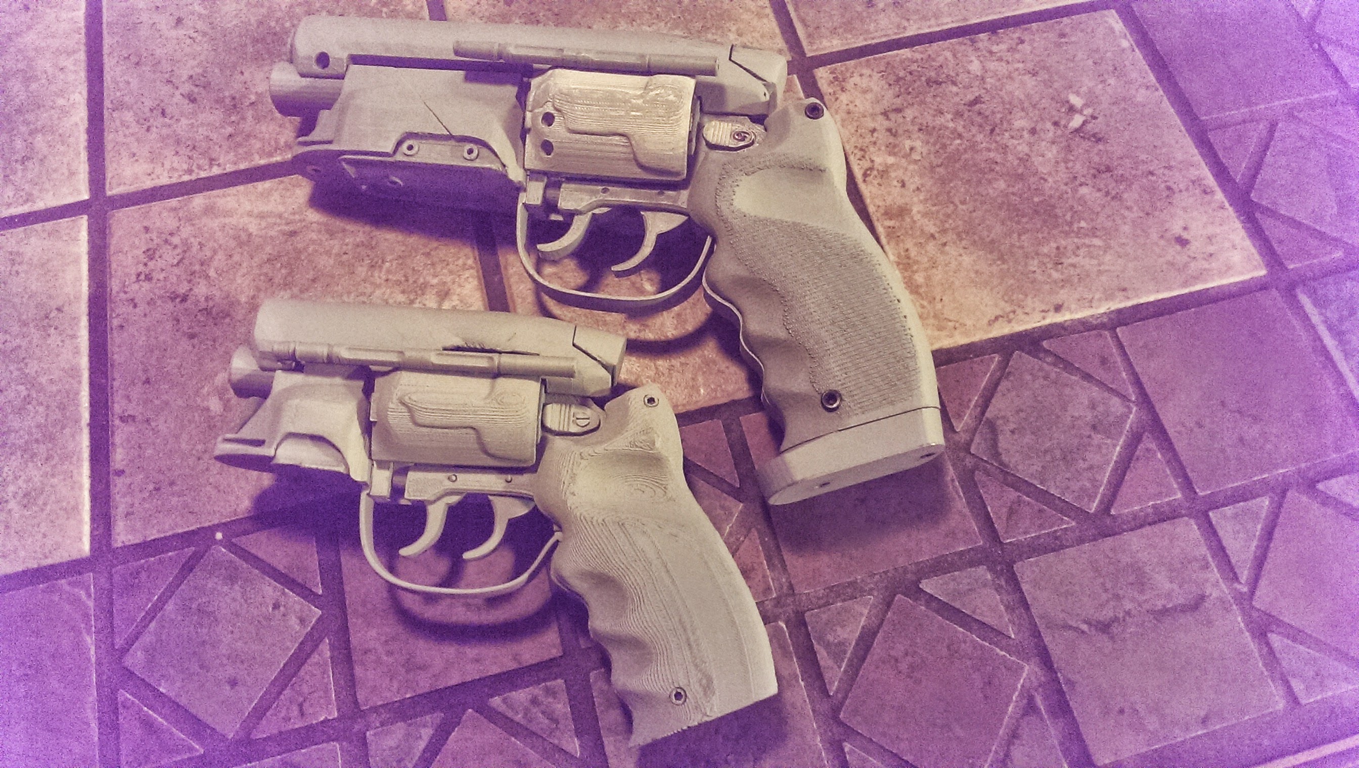

On other fronts, instead of just ditching the original which by my calculations was too small I decided to turn it into a snub nose revolver.
Hope you guys like them. Lots of finishing work left to do. All comments and criticisms welcome. Thanks for looking!
A snub-nose PKD: very clever. Rick Ross has made some of those as well.
I just researched his versions. Inspiring work to be sure! It'll take me many moons to achieve those kinds of results.
Also, I just discovered your site Mike. Very cool stuff!
Very good job on that BR Blaster mate! Snubs were also made by DaveG on Propsummit.com (as well as Rick Ross, mentioned by Mike;))
I knew I was forgetting someone, but I couldn't remember his name. He's Goldberg Arms, right? I should have just checked my files.

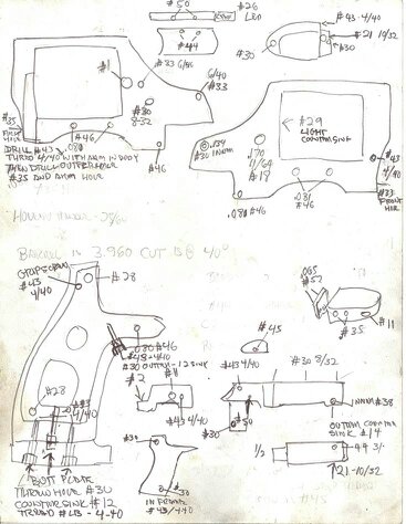

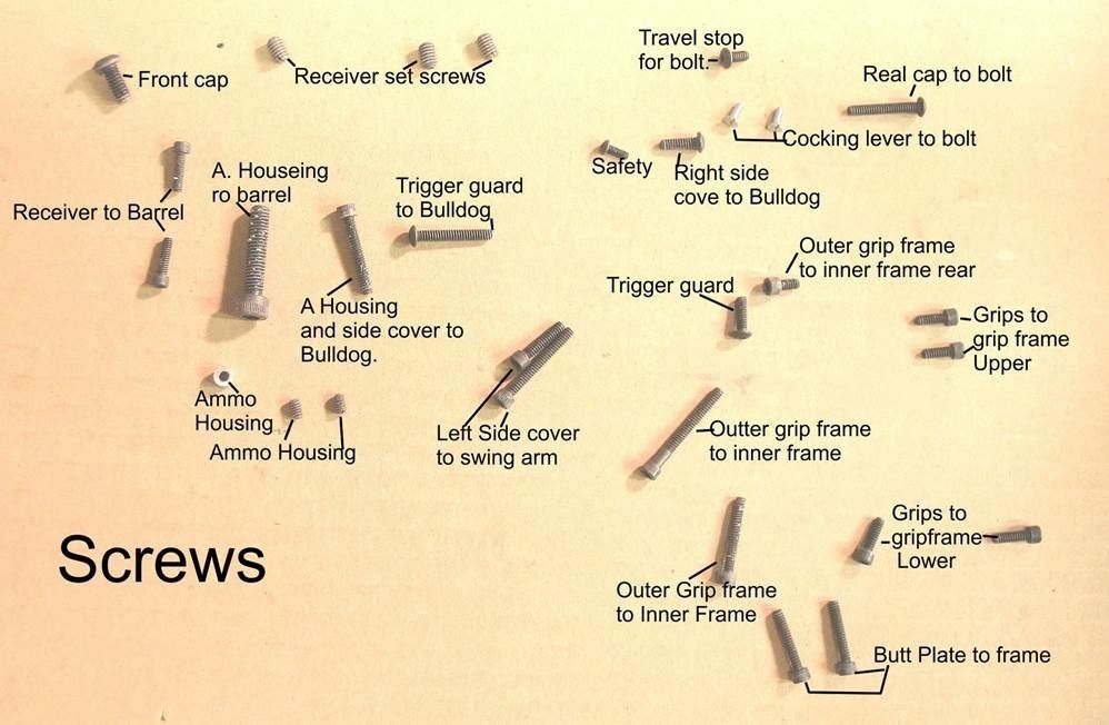

I've been on hiatus working on other 3D printed projects but am now getting back to the PKD. Does anyone have a list of all the screws incorporated in the blaster? I've been searching and have not had much luck. Thanks in advance for any help!
Close as I can get to a list. i'm having to sort through these myself right now..

Sooooooo. After having received these I realized that the original print was not under scaled, therefore, the second print which I've just about finished was way over scale. I don't know why I doubted the first attempt but it really did look small to my eye. Anyhow, the grip fit the original frame perfectly the holes lined up and the profile is spot on.
Now that I have a physical part of the PKD I'm going to make a third print that will be the final and most exactly scaled version. I guess the larger one could be considered the BFG of the Blade Runner universe.

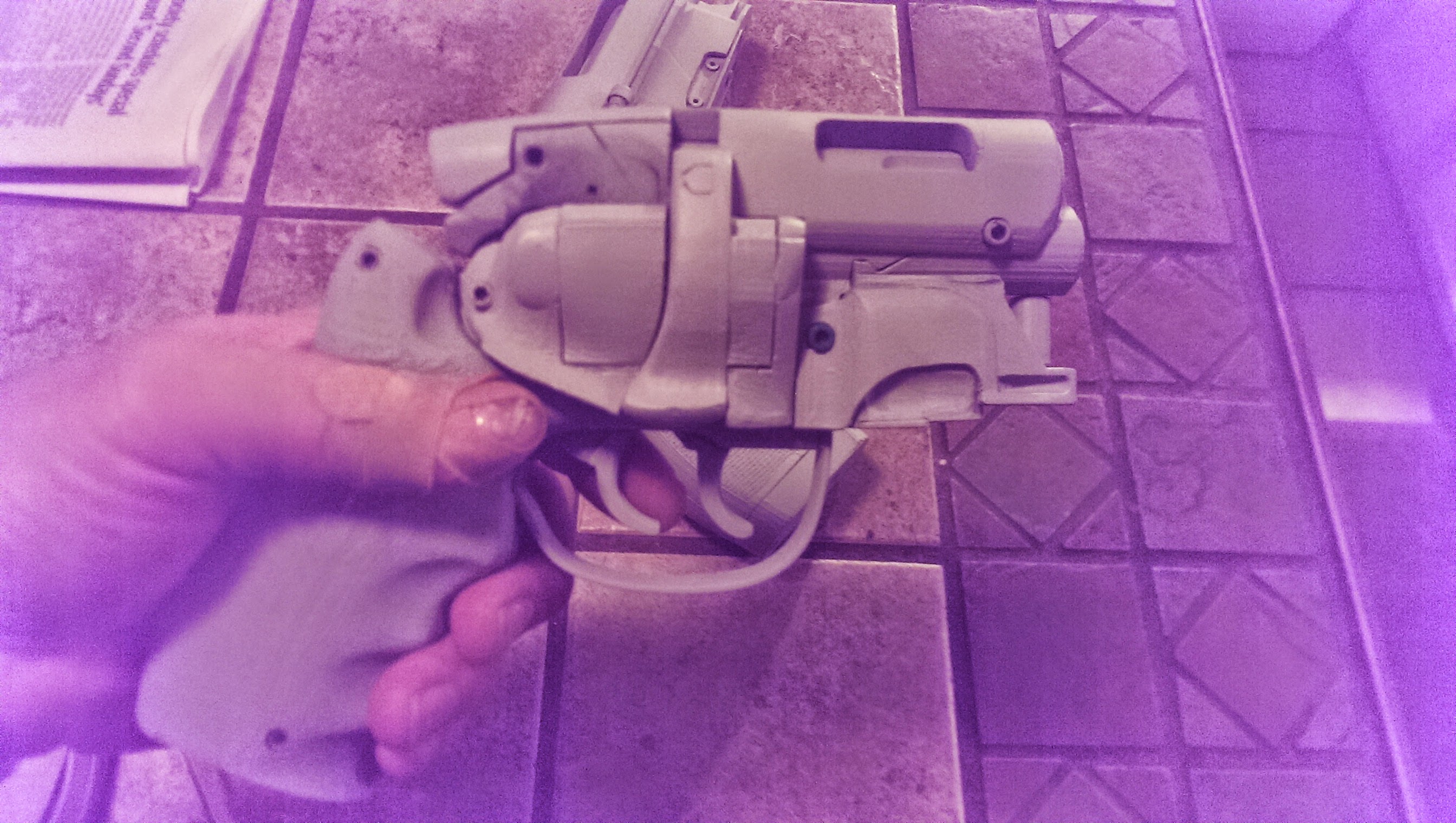

Your welcome man. hard to tell from the pic. but you may want to give your cylinder thumb release a pinch more room. looks kinda boxed In on the snub...
Good eye. I completely agree and will make the adjustments.
