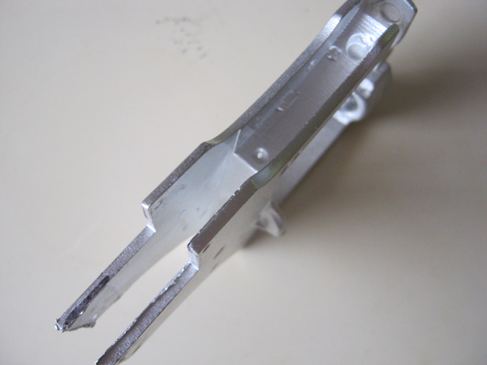

Trigger and hammer for an actual bulldog. the trigger spring function's slightly different from the YouTube demo.
Sean
Inner housing of a cast bulldog frame. the small little divot hole on the corner ledge Inside Is were the springs tension works the trigger. I think the tomenosuke spring system my defer a pinch. not sure on that.
View attachment 465602 View attachment 465603
Thanks so much sean. These are exactly what I've been looking for!
