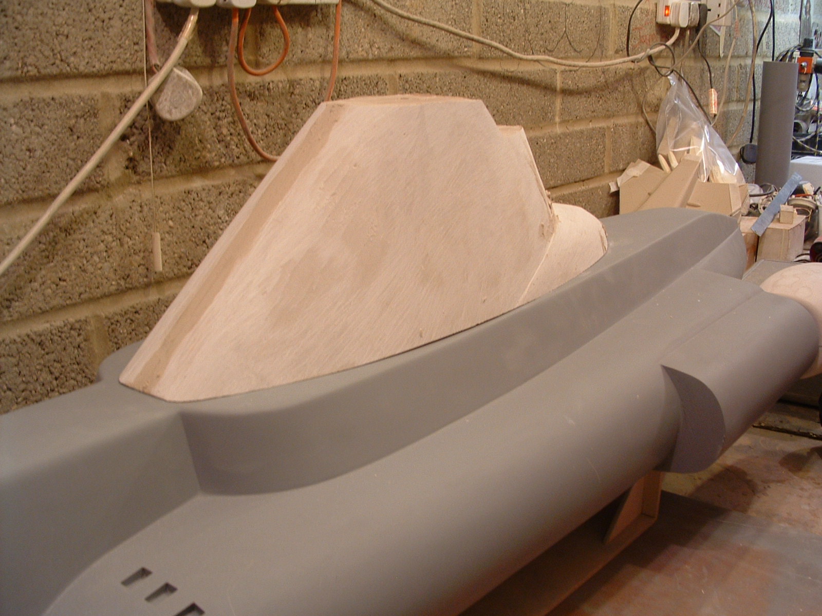

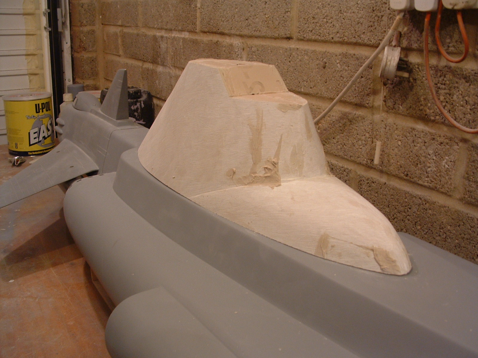

Basic shape of the conning tower in plasticard. Then filler plastered all over it then screeded :)
All the plastic taken out and and surprisingly enough its turned out quite nicely. Still a bit of sanding to do.

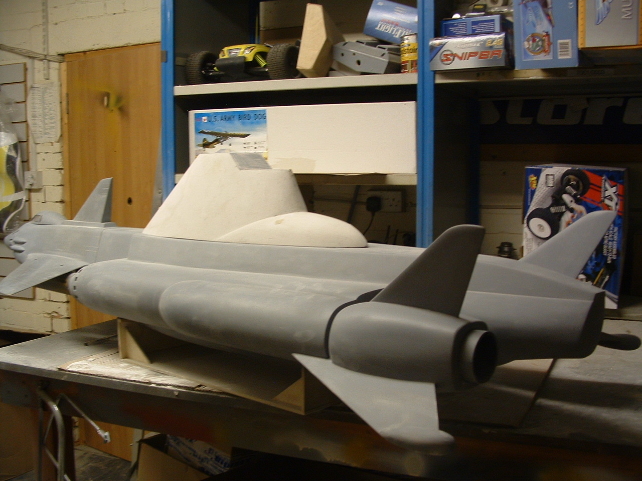

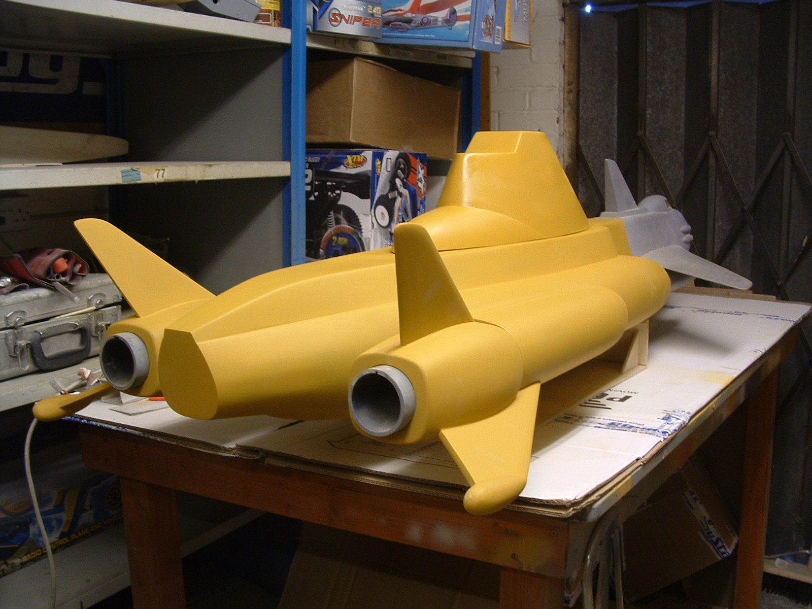

Skipping ahead a bit, I have made the engine pods removable so that during transportation I dont damage the fins etc.

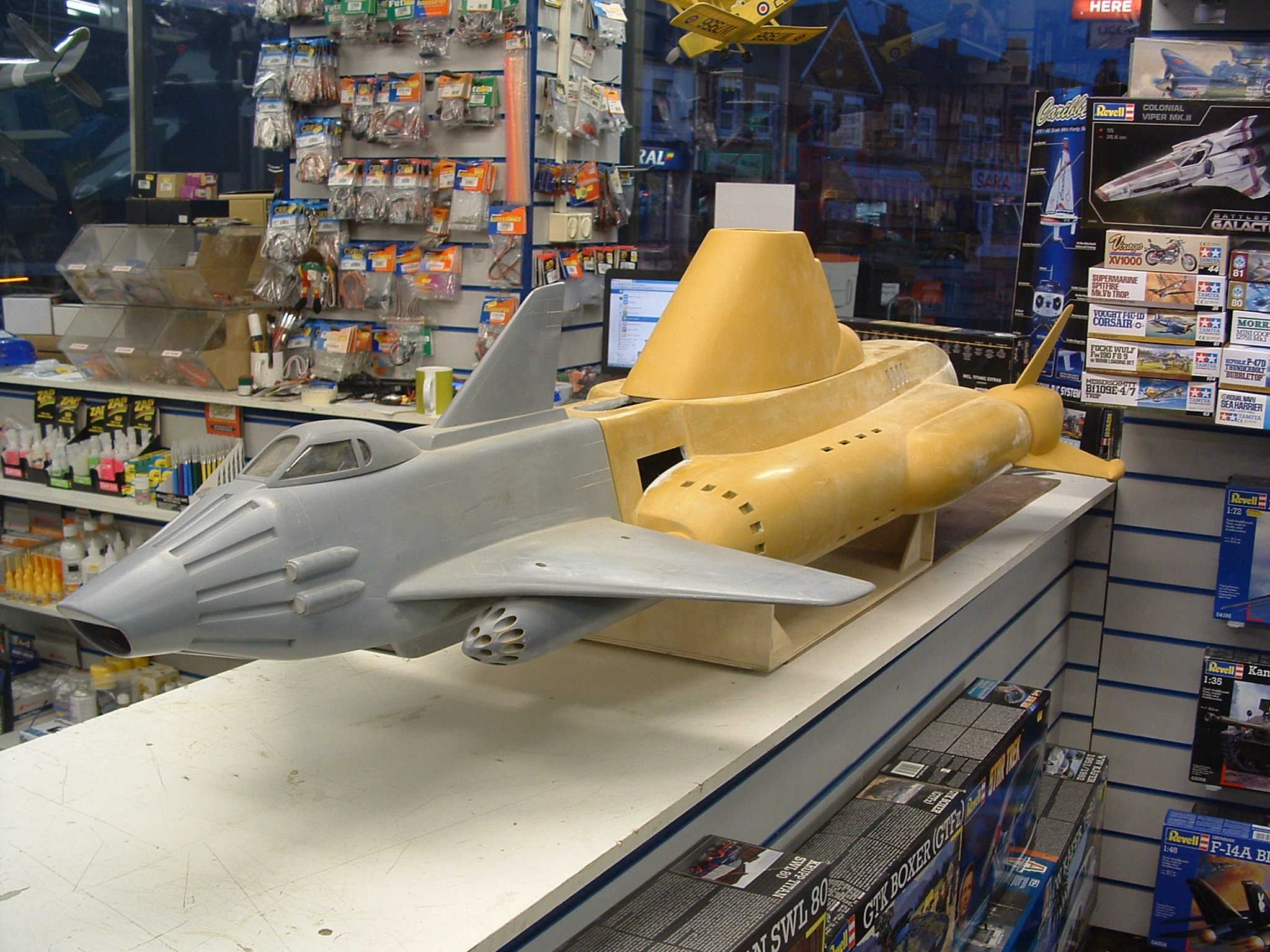

So thats all the major parts done and assembled now. All thats left is the small details and scribing, oh and I still have to finish the conning tower And install the jets :)

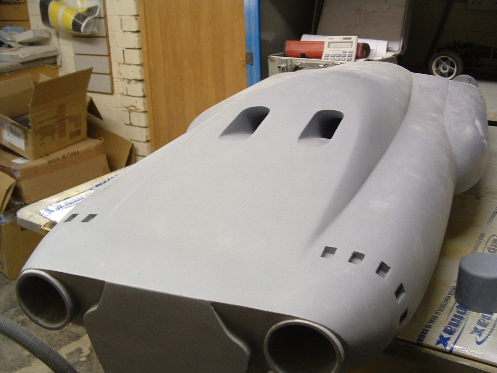

Today I installed the water Jets so once plumbed in I can concentrate on all the small detail parts.
Almost there now. 6 feet of Skydiver to go please :)

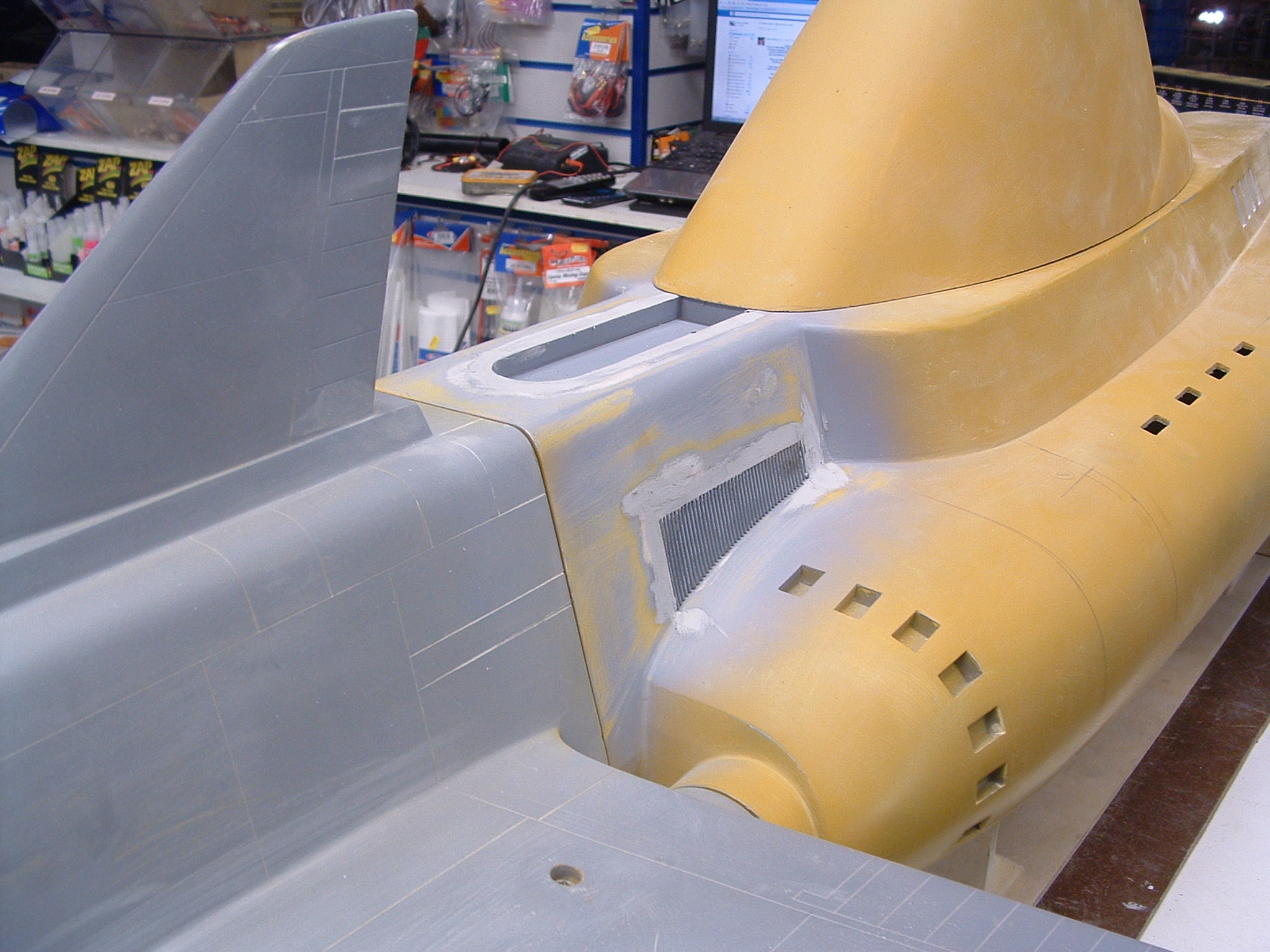

More Holes, need to build the inserts that go in or not as the case may be.
Someone is doing a Interceptor:eek...would like to see that for sure. Btw, that SkyDiver is looking crisp and eager to see it painted!

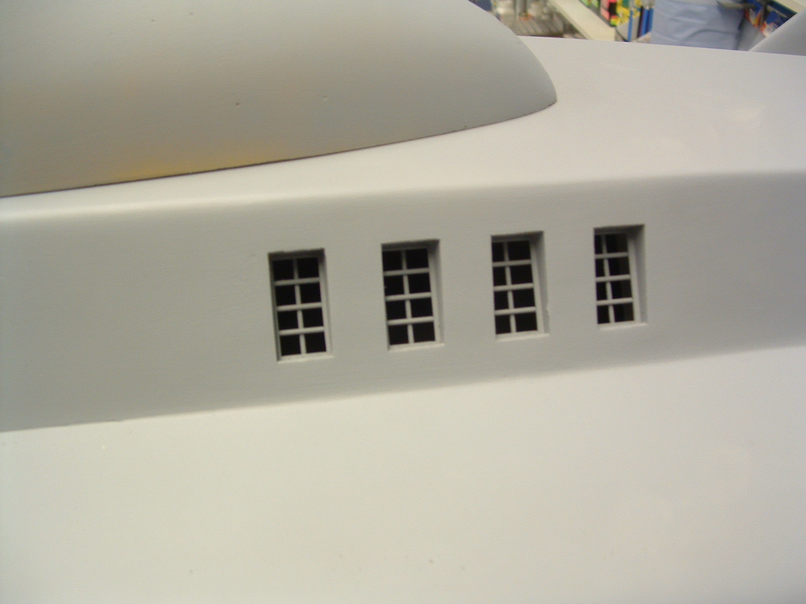

Side and top inserts in just need cleaning up a bit.

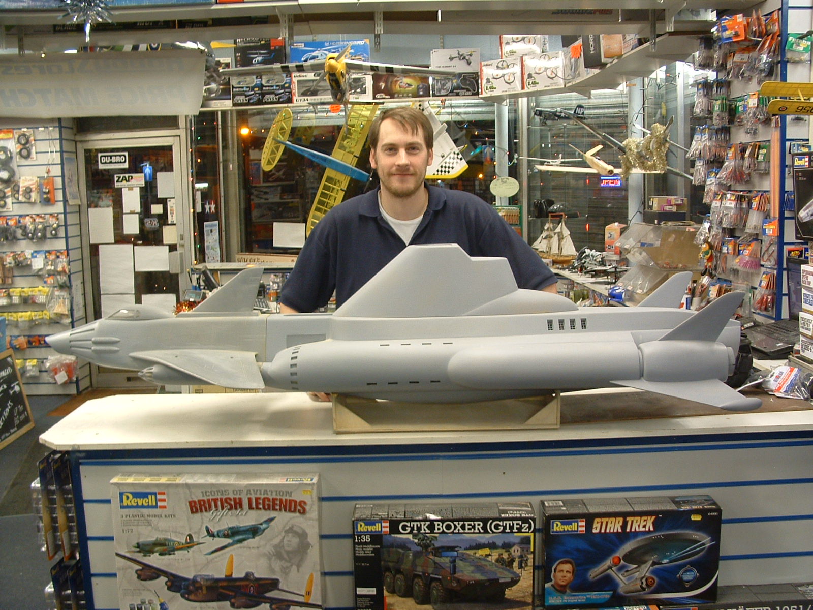

Inner fins done and a side on pic of it and John to give an indication of the size of the thing.
Hi! Great looking model but I have one question.. With the lengths you have gone to for accuracy, why change the underside so dramatically? The episode "Sub Smash" shows numerous shots of the underside for reference.. and the intakes are clearly not there. I have always assumed that the grills on the front of the engine pods were the intakes.
Rog
Rog
When you trying to make a model of a Sci Fi subject and try to make it work as seen on the show, sometimes you have to make allowances, I draw the line at having Propellers and rudders were they are not on the original. The intakes shown are for the water jets to power it on the surface, the Positioning is to assure the ship can rise up as much as possible to simulate Sea skim. The Grill has been added but will just be for show, the "Real" Inltakes will have the Light bank covering them while the Model is on show. I will post more pics asap.
