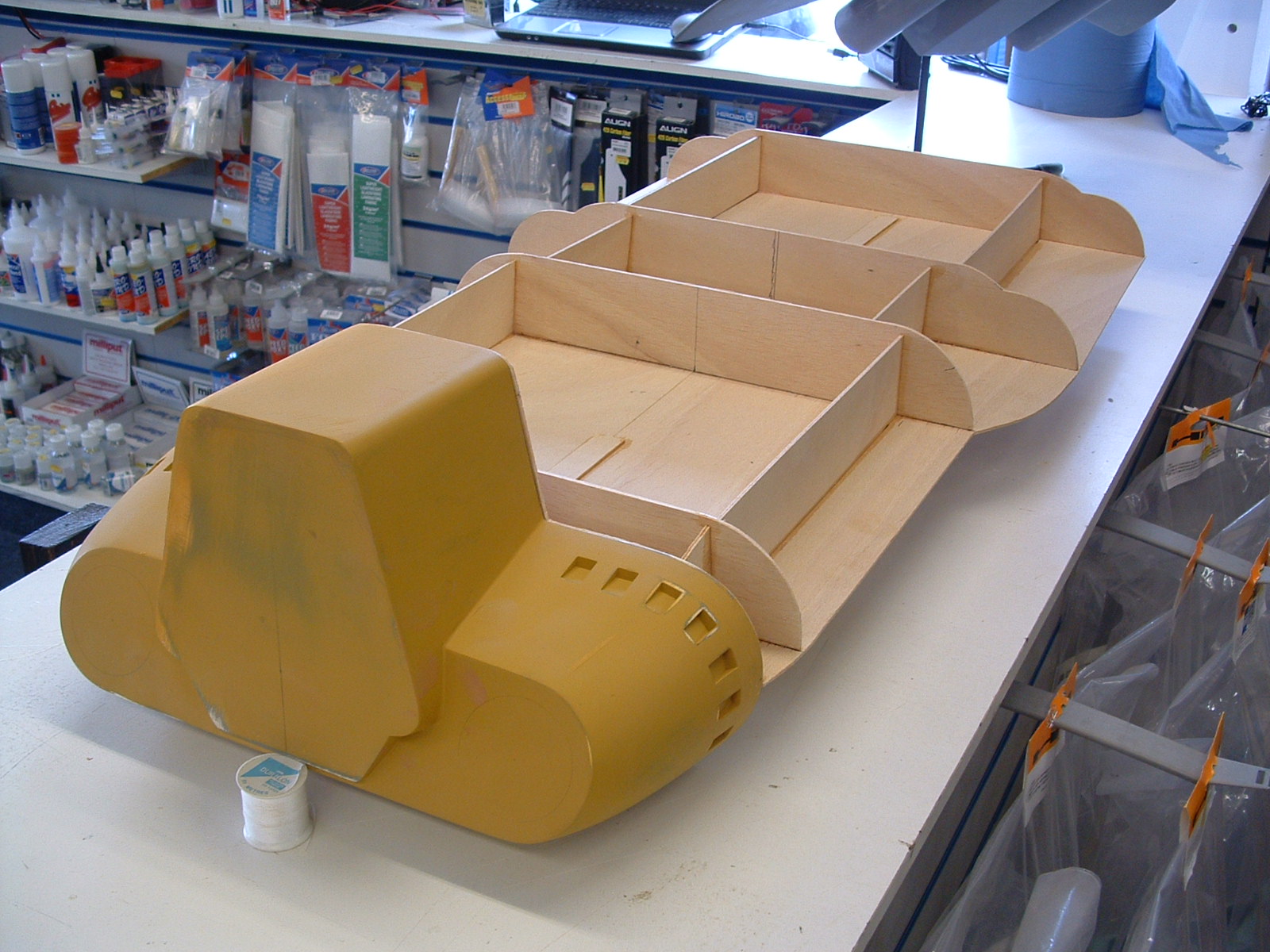

As it turned out I couldn't be bothered with waiting for the tubes and engines so with careful measuring I started on the interface, As with all big projects they all start with a small step and this is no different. The front interface will be a complete part with top and bottom so there is no ambiguity about size spacing etc. The rest of the sub body will be a top and a bottom hull with a stern end part. Pretty much like the 5 footer.
Almost there now with the front end. Just needs finishing up with a bit of Primer and such.

Front bit done now, tubes will go in after moulding.

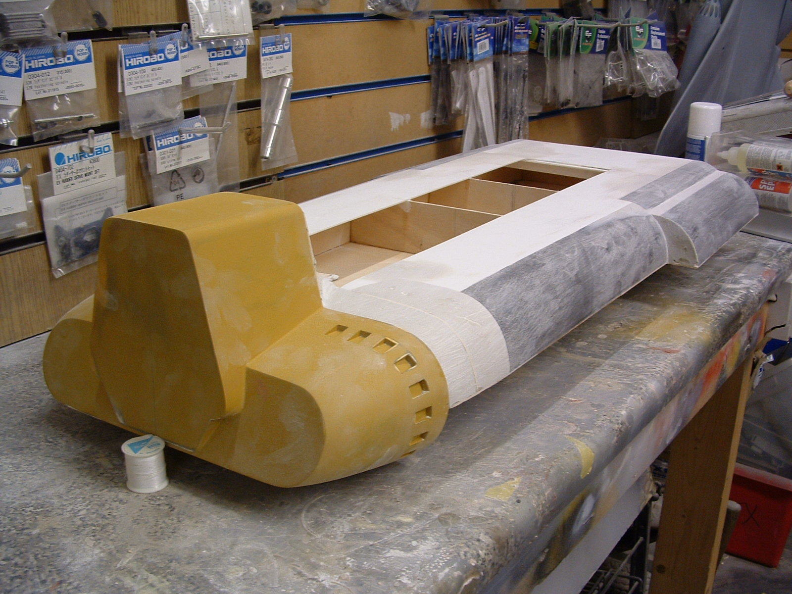

Had to re work the front end and so here's were I am with it today.

Done the bottom hull, just the back tail bit to do then the main hull is done.....end of the week I think.

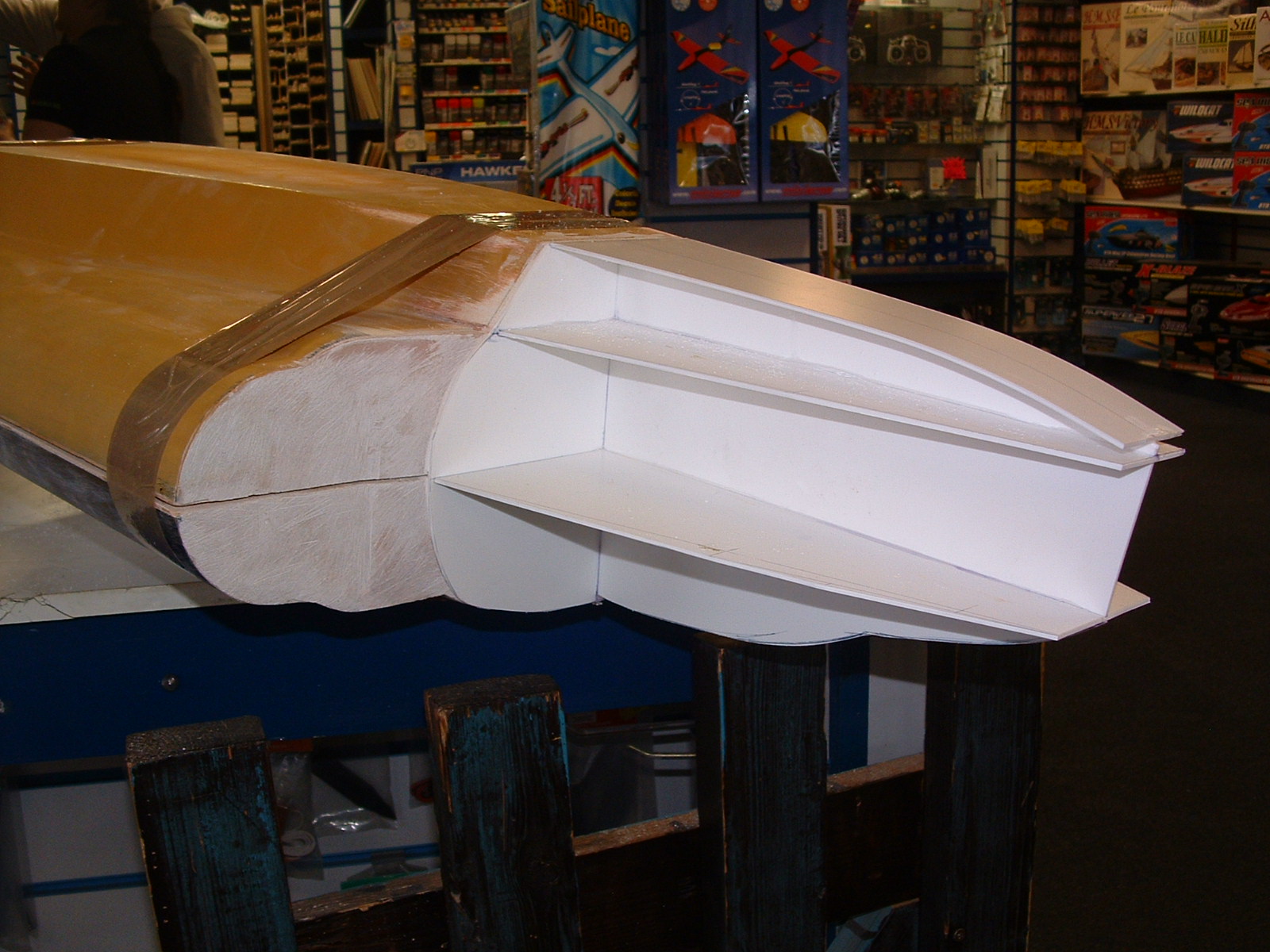

UFO alive and well here :) Ass end, Got to be blocked out and filler Job.

Filler is a wonderful thing.

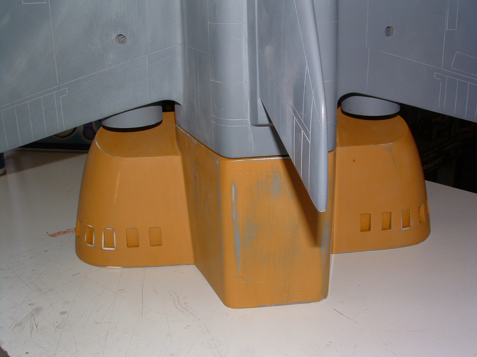

The four main parts just needing final finishing.
